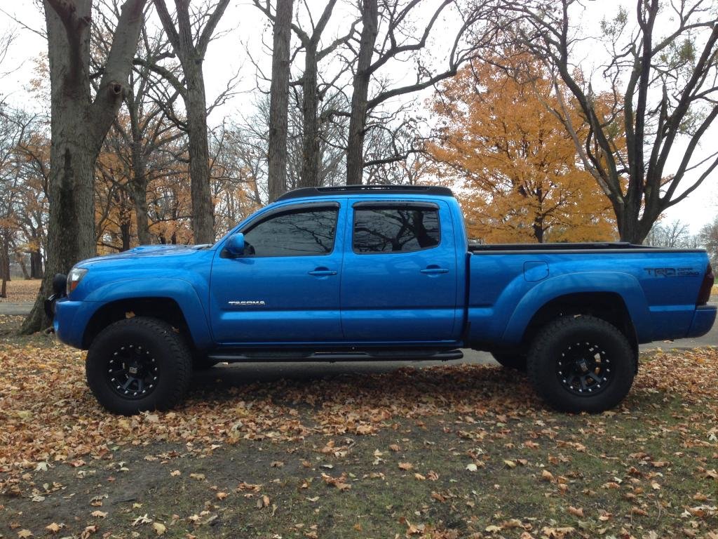

    OME 3" lift up Front, LR UCA's, All-Pro Expo leafs in back, 17" XD Addicts with 285/70/17s, OEM Roof Rack, Westin Light Bar, Relentless Tailgate plate, Weathertech's, Blue Sea Fuse Box, Iggy's Switch Holder, Pioneer avh-3300bt Radio, LED Interior/License Plate Lights
    UCA's don't really have anything to do with ride quality, they just allow us to align the truck to factory specs so they travel straight down the road.
    You have a few options, first how much off-roading do you do, and second you have to decide if you want to cut the frame or not.
    If you go with a drop bracket lift, you are correct that you can keep the stock UCA's, but you can't really go back to stock without cutting out the new crossmember and welding the old one back in or fabricating one.
    You can also go with something like an OME setup using 885 springs and their shocks, or you can even put their springs on the 5100's you already have. This will allow you to move them back to the 0 setting and still get 3" of lift via the spring which should improve the ride slightly but it will be rougher than stock for sure. In this case it would be beneficial to get aftermarket UCA's to get your alignment correct.
    You could also go with coil overs like Fox, Icon's, Kings etc. and crank them up to get the lift. These would ride the best but also be the most money.
    As for the rear, I wouldn't recommend going with blocks, the leafs on the stock tacomas are known for not being that great. You can either do an AAL or a new leaf pack, All Pro and OME both make leaf packs as well as Deavers.
    As you can see, there are a TON of options, it depends on your needs and how much you want to spend. You can pretty much piece them all together as you would like. I currently have OME 885's and Light Racing UCA's up front with All Pro Expedition leafs out back, and I wouldn't hesitate buying the exact setup again.

    They are 285/70-17's, it is right about 3 up front and 3.5 in the back, I bought the truck the way it sits for the most part. If it was to buy the leafs again, I would probably go for the non-expedition pack as I dont usually haul 500lbs in the bed so the ride would probably improve a bit empty.
