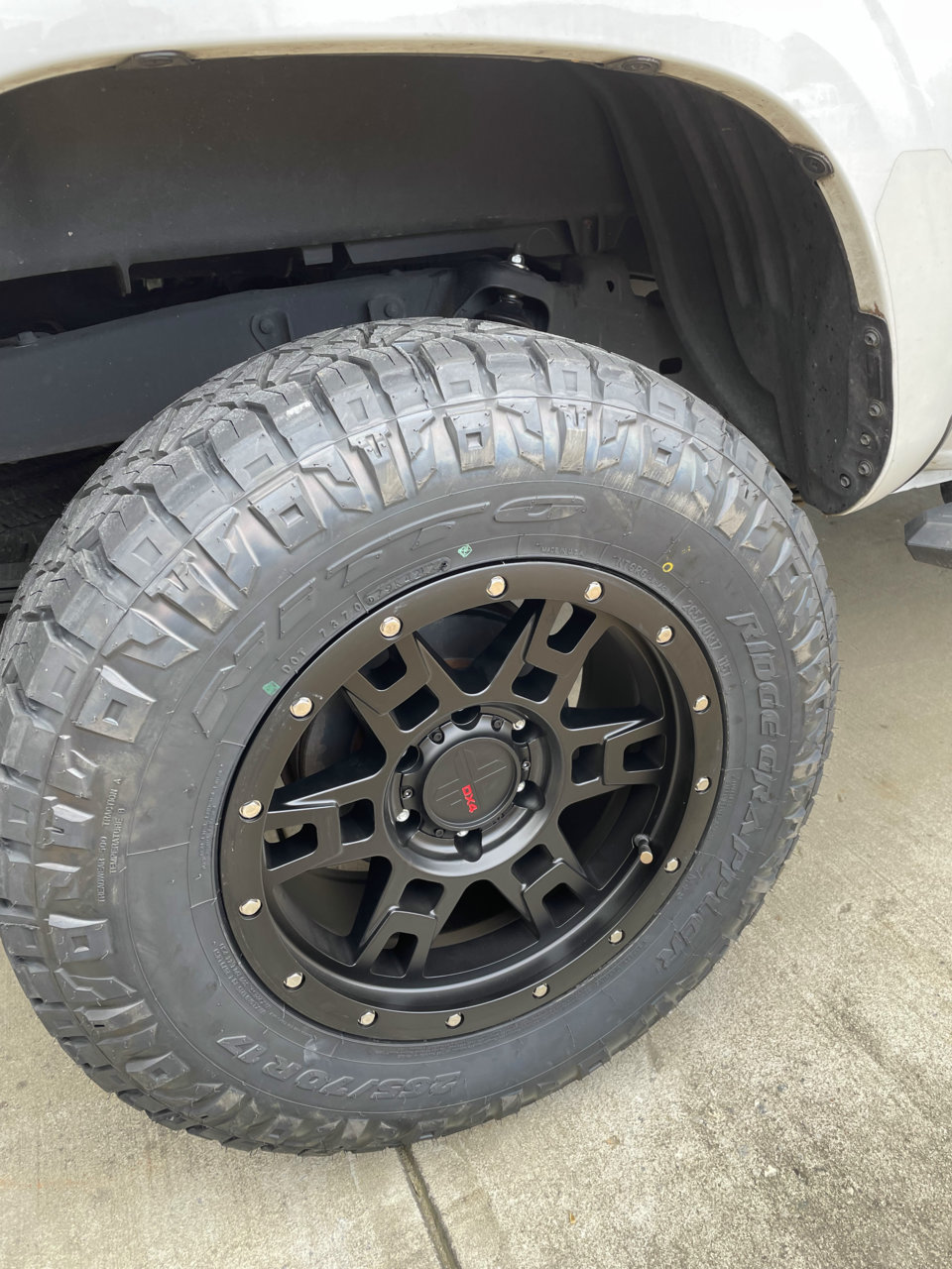

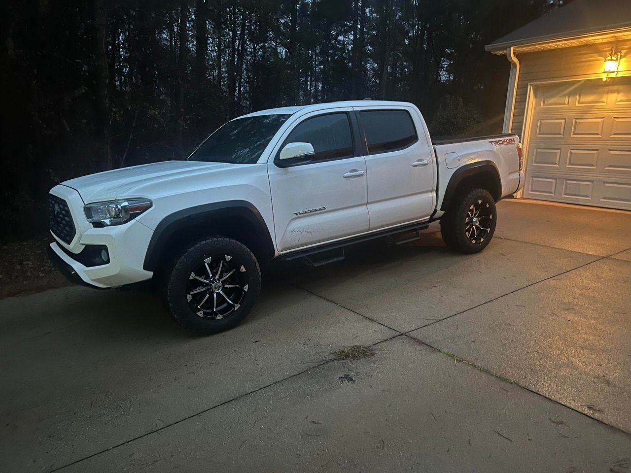

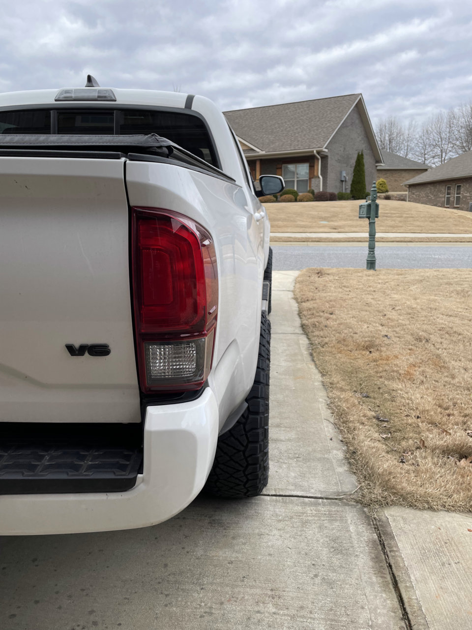

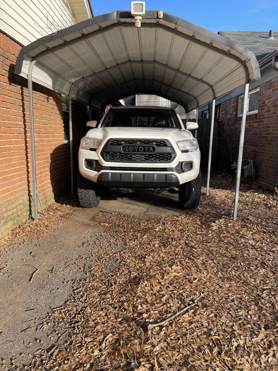

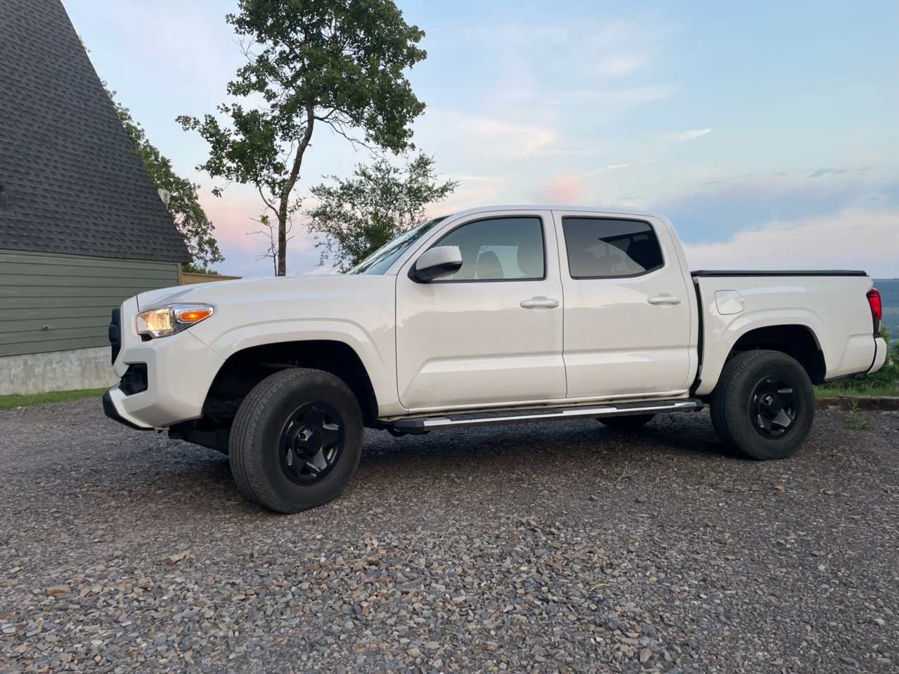

    So I went with the 265's, the tire selections for 275's were minimal. Wheel: 17x8.5 with -6 offset. Tire: Nitto Ridge Grapplers 265/70r/17. Pretty happy with the results with the 2" lift. Drove about 500 miles after alignment, no issues on the highway and there's not as much noise as I thought after switching from the stock wheels & tires. Here's a before & after picture to compare. Thanks for everyone's input!

    Those 265s with off-set look good...that's what I'm looking for.
    The 275s would be good with a TRD Lift...still want a little pokey with my BW Fendys!

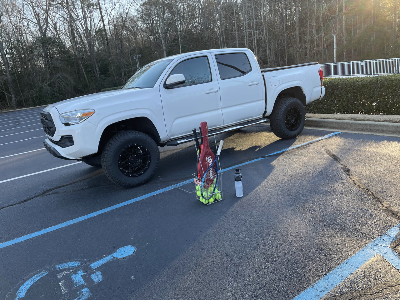

    bed cover, 18 inch xd wheels, 265-60-18 tires
    318356736_650991910092714_8949070265428936348_n.jpg 265-60-18, no lift and no rubbing. xd wheels, predator tires
