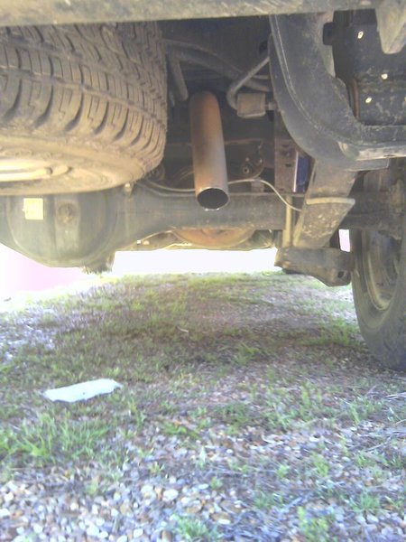

    Mine is dumped right before the axle. This takes a good bit of tubing out of the equation as well as several bends and I like the sound it gives bouncing off the pavement combined with my Flowmaster 40. I had the same setup on my '94 Dodge street truck. Check your local state laws on where the exhaust can dump though. Texas laws just require it to be behind the passenger compartment. So anywhere under the bed is fine for pickups.

    cut mine right after the muffler and used an old piece of the curved piping i cut off as a turndown... got a muffler shop to expand the tubing to fit over the pipe closest to the muffler and welded it on... no change in anything that i've noticed except that it looks way cleaner in th rear now

    Just installed a Magnaflow with turn down before the axle. 2.5" dual inlet / 3" single outlet. It does have a drone when I drive up hills, and when I'm constantly on the gas pedal. Quiet when you are at cruising speeds. Not sure if it will get annoying when the snowboarding season comes with all that mountain uphill driving. Wait n' see.
