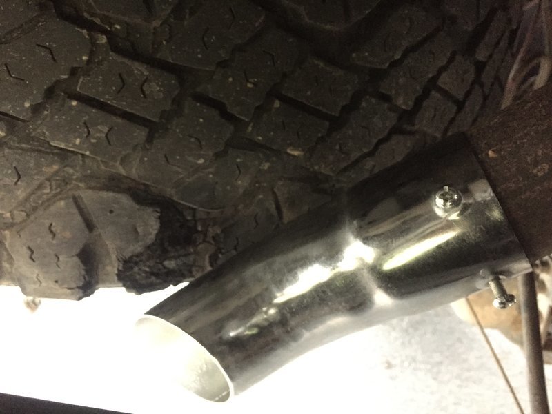

    I cut mine after the axle with my spare tire off, but I cut it too short. It burns my 265 75 16 spare tire, so I had to add a stupid tip. Will get a more permanent solution welded on at a later date. But don't do like I did, measure twice, cut once.

    That tip isn't awful...

    This is the exact image I'd been hoping to find. Thank you! I'm trying to shoe horn a 285/55-16 in there and need to chop the exhaust and hanger, and was wondering if i would need to divert the exhaust. Got my answer thank you! I'm going to try to weld on a piece of what I chop off for the elbow...
