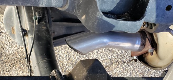

    Sorry. I was going off that pic in your post showing the tailpipe going up in this post / no quote in there:
    https://www.tacomaworld.com/threads/chopping-the-tacoma-exhaust.632324/page-4#post-21748894
    For me, I was not concerned after work was done. The right side axle housing was only slightly warmer to the touch. Then in another chop thread, someone posted that they had to reverse the mod because their housing was too hot to touch and their U joint was spraying after long hot runs. So, I rechecked mine with similar results. Just a bit warmer near the outlet. I even got down there after a 1hr trip up a mountain pass in hot weather. It felt no different. So IMHO, the lines on the back side of the axle are no issue if you have enough downturn, like mine. If you just chopped it without a tip, then I would worry and fix it.

    :) I figured that man, all good. Going to grab a pic now, it's before it but the tip of the tip
    hits the axle so my worry was it was beating on those 2 lines but while moving I can't imagine
    it's doing much of anything.
    Here's mine... Now that I'm looking at the pic, it seems fine
    tonered likes this.

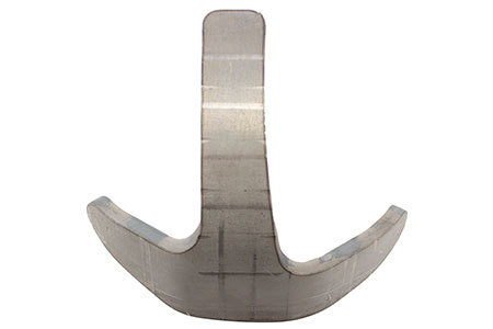

    https://www.tacomaworld.com/threads/singletrack’s-‘dad-shred-build-thread’-i’m-just-doing-it-for-the-kids.619250/ Sos offroad sliders (kickout + filler) Sos offroad full belly skids (steel) Sos offroad front recovery point Sos offroad concepts HC rear bumper with bedside kickout tubes Marlin Crawler LCA frame brace kit Trail Gear rear diff cover Bilstein 5100 + OME 885 Total Chaos UCA BILSTEIN b110 OME Dakar standard pack Wheelers Ubolt flip kit Wheelers Superbump f/r Wheelers SS extended brake lines FN five star 16x8 -25 Milestar Patagonia MT 315/75r16 Custom projector retrofit (acme super h1 + morimoto 4300k) Baja Designs S2 sport ditch pods on CBI ditch pod mounts Amazon AMAK rock lights CMC CB radio hardmount
    That is the trail gear weld on cover. It was hilarious trying to find which specific one would work but all I can say is this. My truck is a 2008. It has a factory rear e locker. And this particular design of trail gear cover fits perfectly and it said on the description “does not fit trucks with factory e locker”. Hahah. The first one I bought which should have been correct indeed was a very poor fit
    Jerneyman likes this.

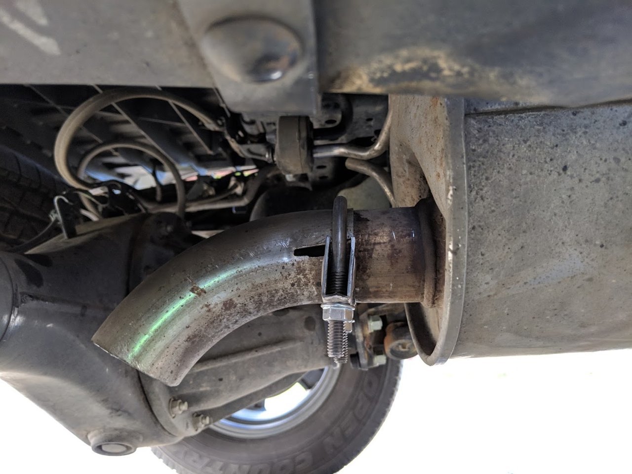

    This is about how I did mine. Left a little more of the down turn though. Only time I can smell exhaust is when it’s running in the garage. o_O

    Good point there. Even at startup, the only time I get a whiff is when I'm rolling backward out the door.

    Nice. That’s the one I’ve been looking at but that exact statement was the reason I haven’t bought it. I don’t think there’s a difference between the e locker housing and the regular open diff housing as long as they’re both an 8 inch. Maybe trailgear made a mistake? :notsure: Oh well. I’m gonna order it. Thanks dude!
    G.T. likes this.

    I ended up with the Ruffstuff weld on version. Taken allot of hits and the diff is still perfect.

    Used a gas axe and some leverage in a vise to get the profile perfect - 10 minutes-ish - and then just flapper wheeled the dif and sprayed it with weld through primer and then did the same for the armor. Easy as as long as you remember to drain the gear lube out so you don’t boil it and any electrical locker connections.

    I even asked Trailgear and I didn’t get a straight answer from them. Try to buy the one that looks like the one I got. Not the one that looks slightly different. And you’ll be fine.
