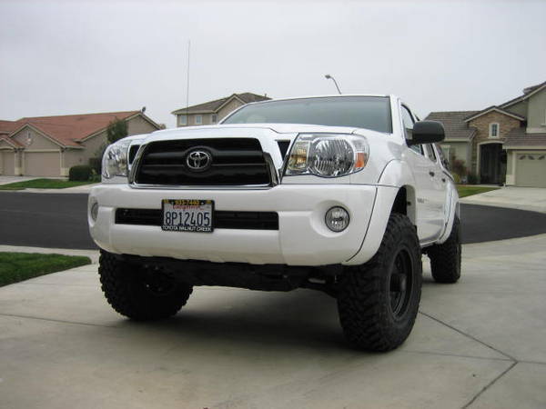

    Wow! that is a nice ride. Sorry for not responding quick. I just found out Helo was look a like wheel. Helo Series HE821 Wheel (17x8, 6 on 5.5 Bolt Pattern, Backspace 6.07" Offset 0mm. I think this might work. Toyota backspace is 5.5". not sure about the offset, but it worked for you. i never thought getting wheels adn tires would be this hard. i am learning a lot and a little over whelmed. it builts character.

    Hello everyone. I finally got wheels for my truck. I played it safe for until the warranty is over. I ended up getting Sequoia's 17" hyper Silver wheels from their limited Edition. I really loved how it came out. All I need now the tires. I am debating with BFG A/T KO, Hankook, Duelers or see what T-World recommends.
    thanks again guys and I have kept your messages for when I get the wheels I truly want. So please advice me on the tires.
    I attached a photo of my tuck, but I chaned the grill. I will post and update picture when it stops raining.

    Color Match Grille, Bed mat, Kings with JBA UCA's, Dakars and 34" BFG KM3, Snugtop Canopy, and my "Marshall Fabrication" Rock Sliders.
    Nice! great choice man!
    Many people love the BFG AT's, but I personally dont care for them. Well they do good in wet weather and on road driving. But not that great in snow and mud. They fling rocks like crazy too.
    My next set will be the Hankook MT's. they get great reviews!
