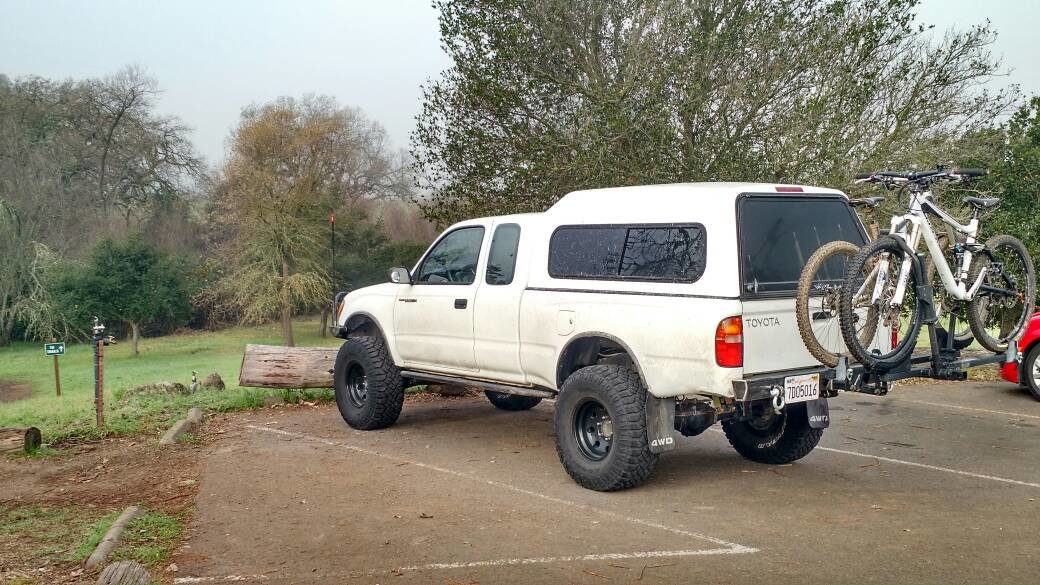

    He is foxhead here on TW and his wheel/tire set up is on point.
    305 MTRs on pro comp 16s with spacers. Not sure of the exact details

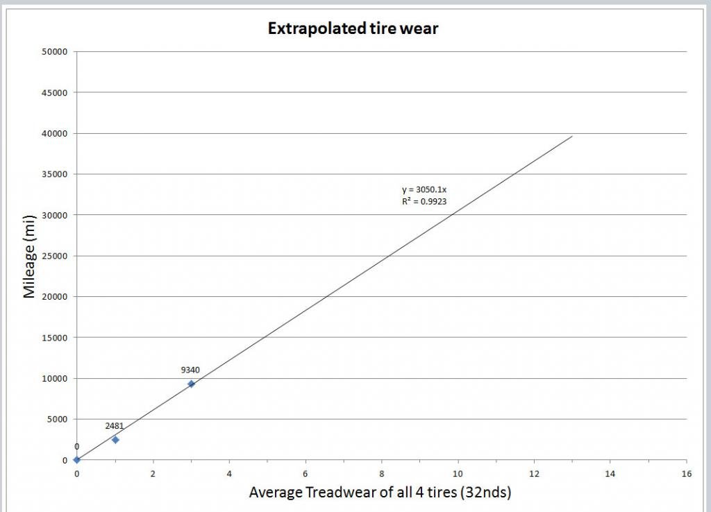

    Since you're interested in tire wear, I thought you might be interested in the small amount of data I have collected so far. I only have two data points so this extrapolation can't really be that accurate but its interesting to look at none the less.
    So according to what I have so far, these tires will last to about 40,000 miles by the time they get to 5/32" of tread remaining. Not too bad.

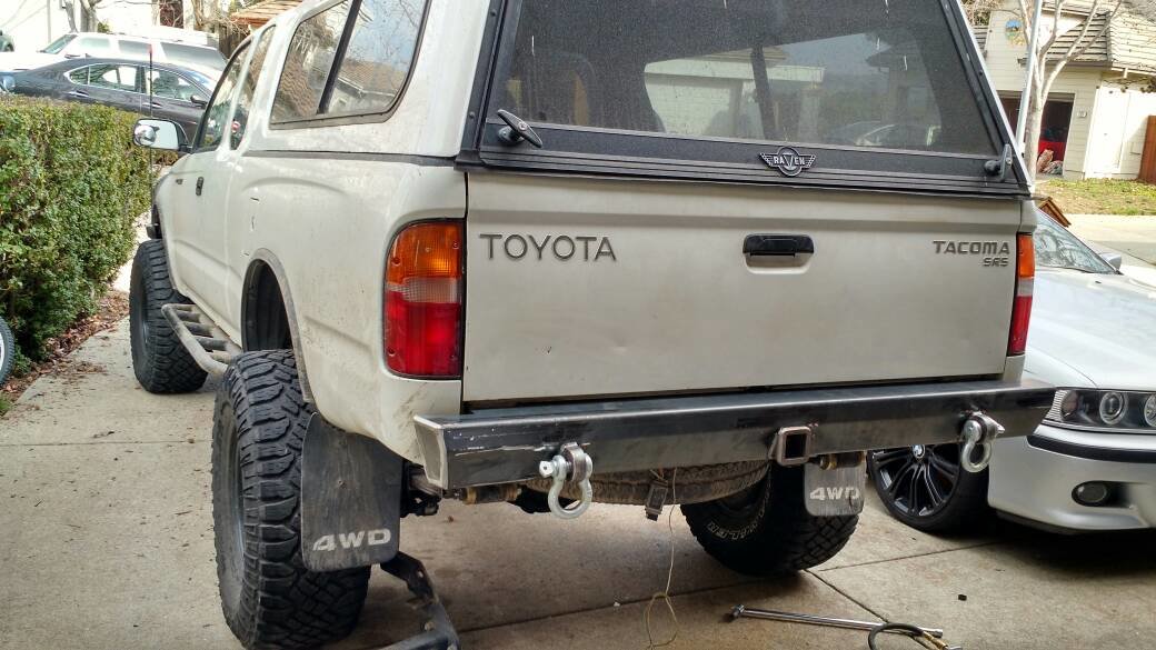

    These days, the front is sitting on some tired SAW coilovers. I haven't really kept up with this thread but I've been enjoying the truck and continuing to mod it.
    The latest would be the coilovers, longer rear shackles, and as of saturday a RAT rear bumper. Also I put the shell back on.

    Got the all pro shackles on.
