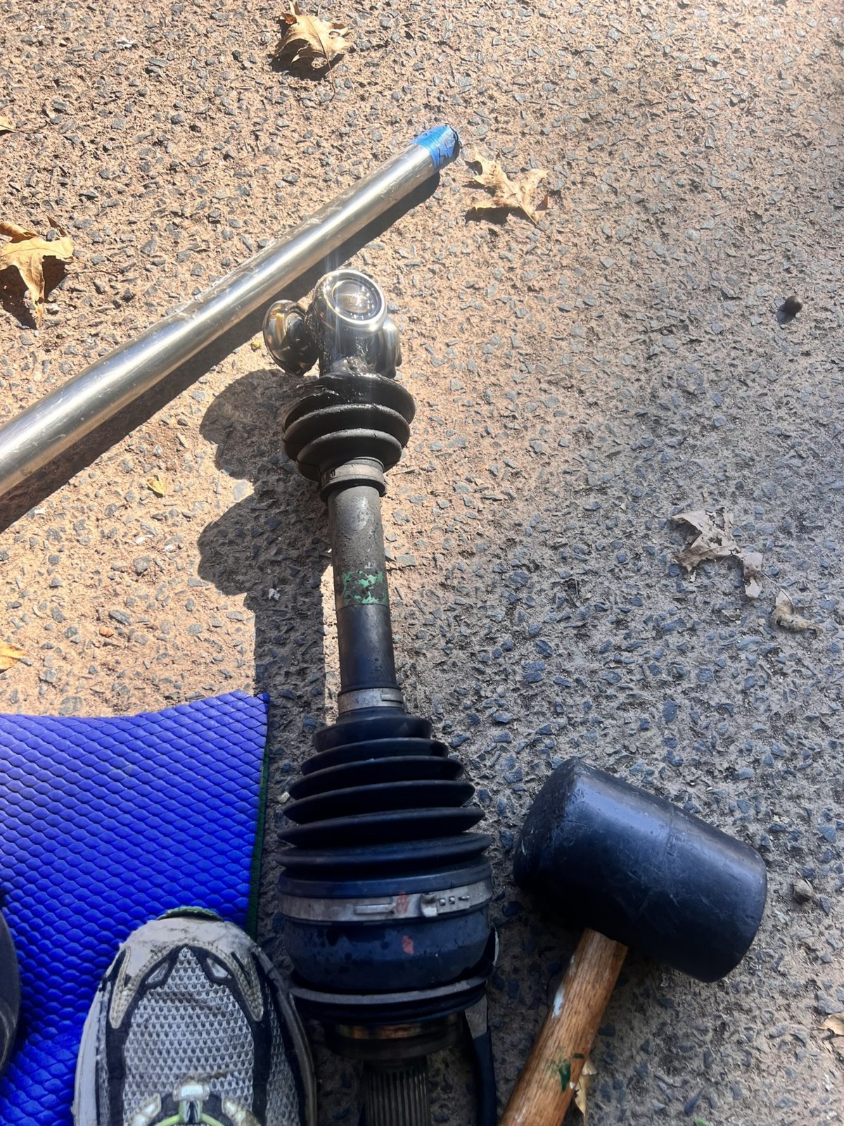

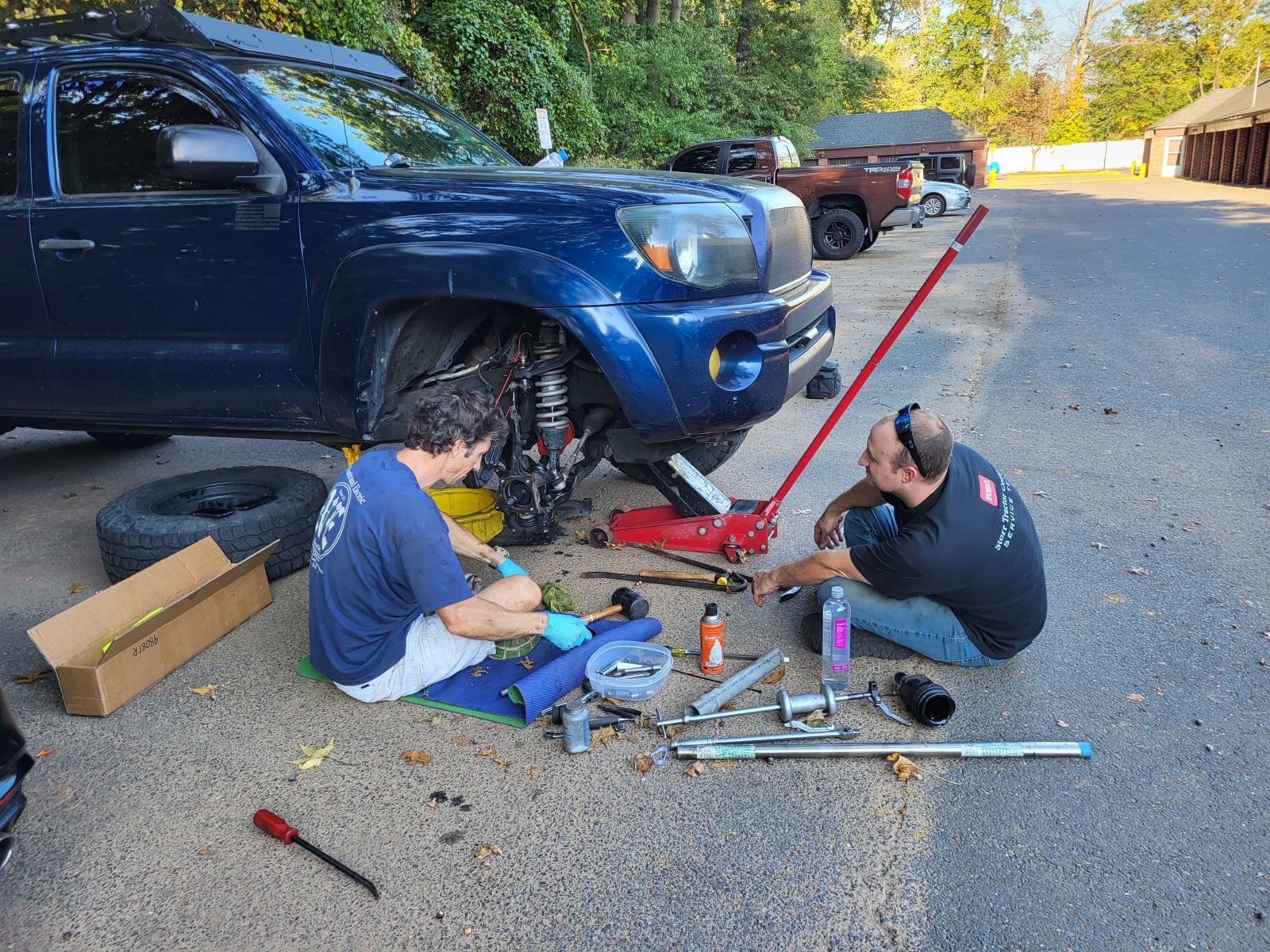

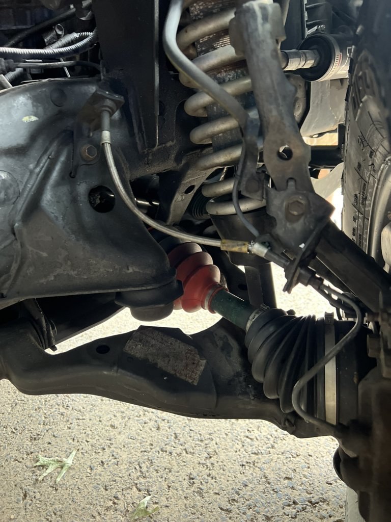

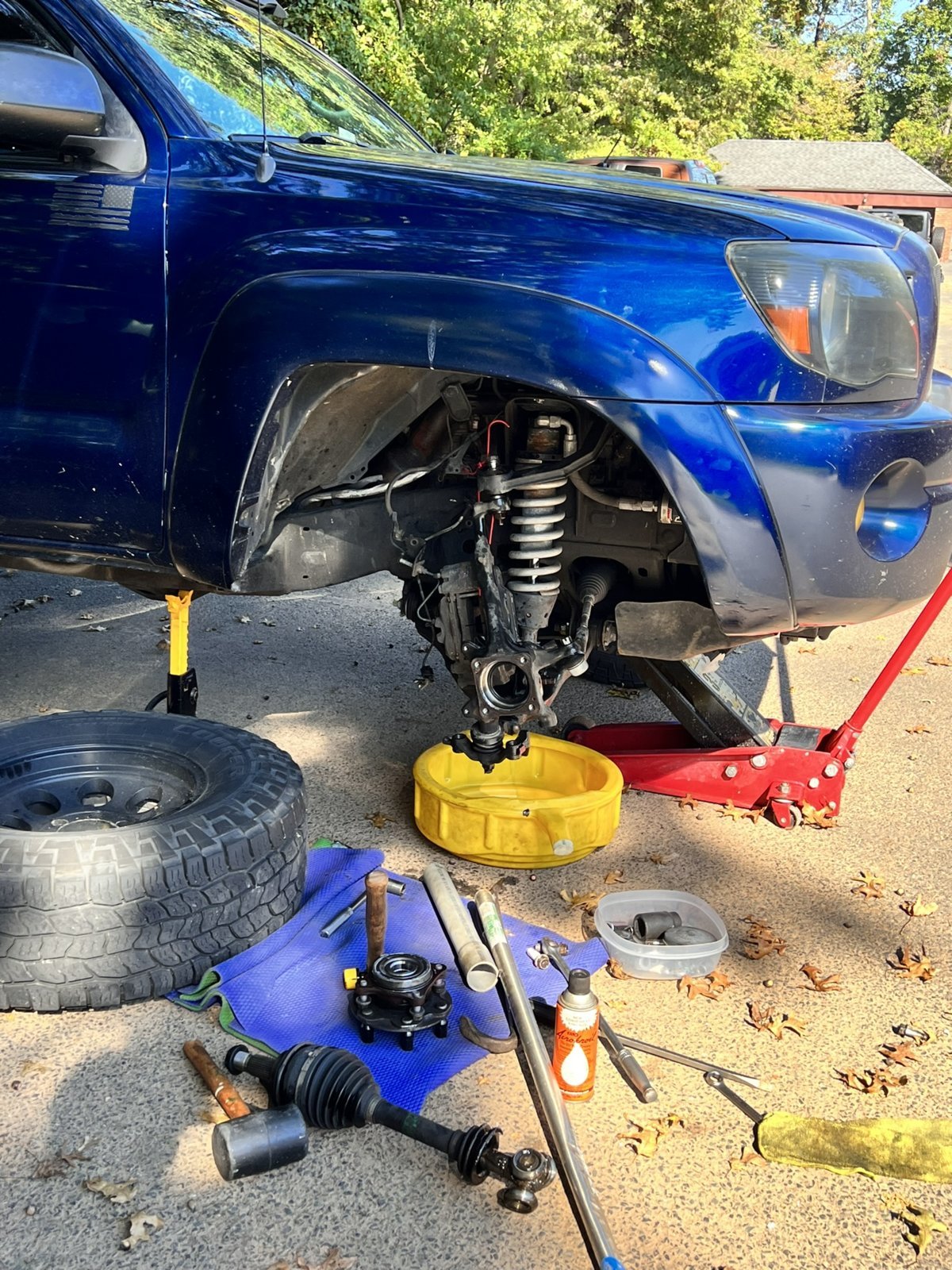

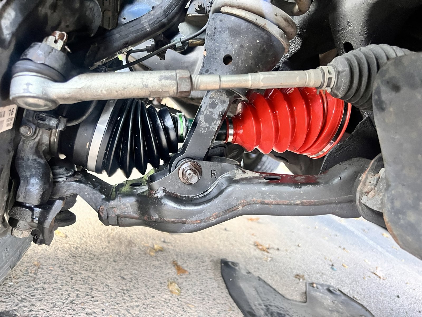

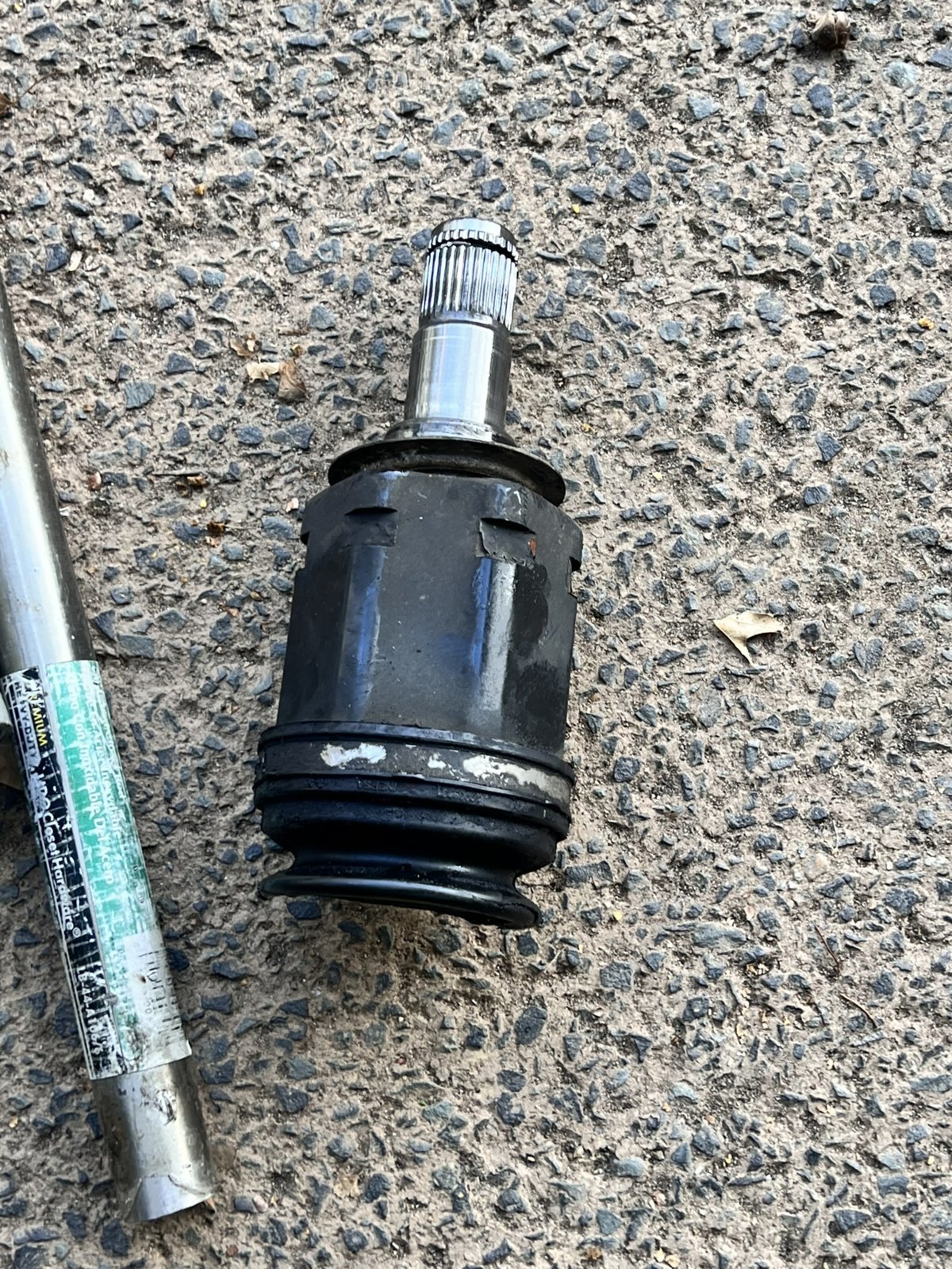

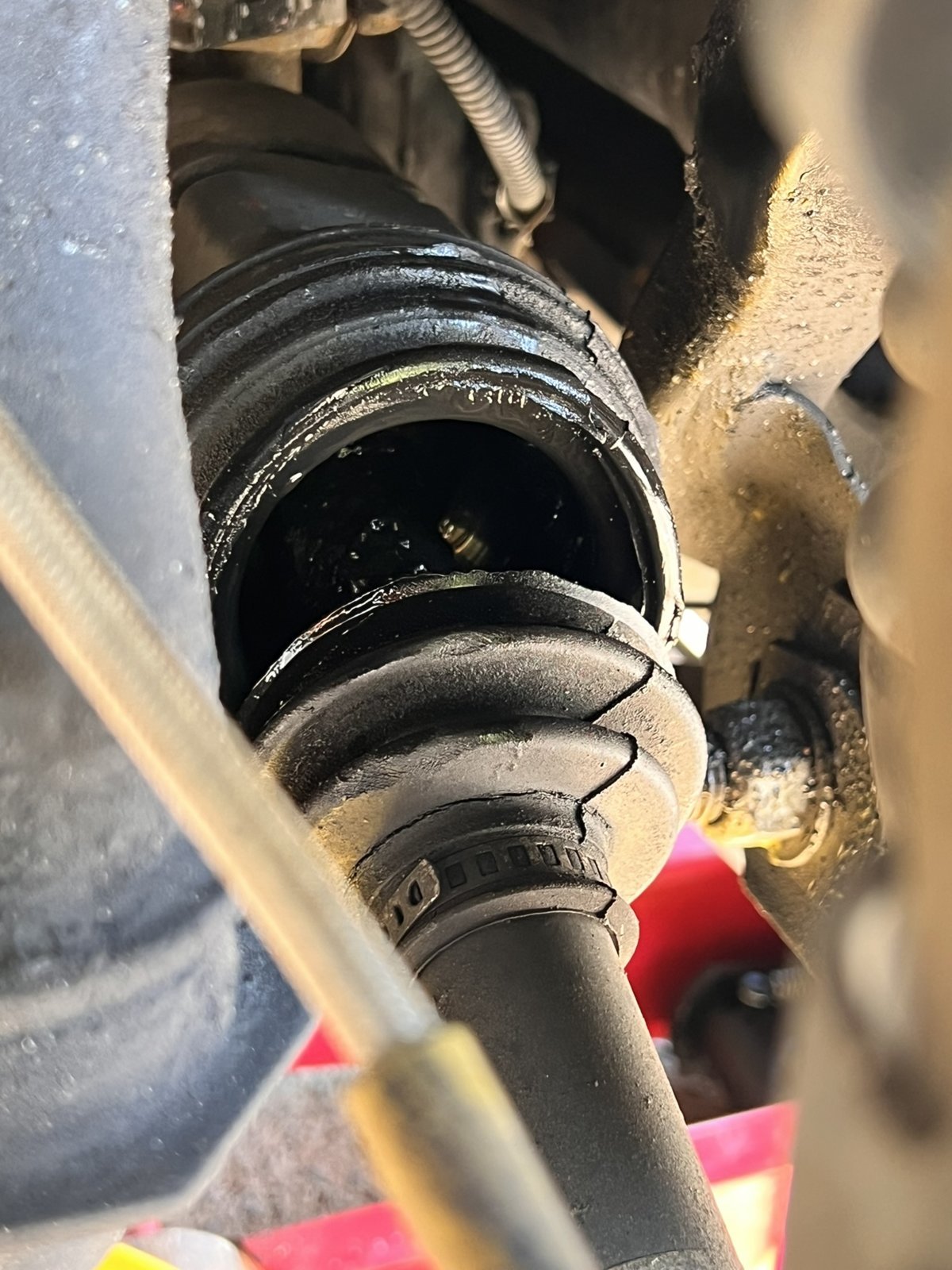

    Damn today was busy. Amongst everything else, I did get the passenger side axle changed to a CVJ high lift axle (red boot). The driver side has lasted many years, so I'm hoping for the same out of this one.
    Everything was pretty smooth. The old axle didn't want to pop out of the wheel bearing as easily as it has in the past. A couple whacks w/ the rubber mallet and it was as free as a bird.
    In total, I spent 3 hours on this. Worked solo for 99% of it. My neighbor came out in time to smack the new axle in place while I held it. 4 hands are better than 2, as they say!
    Old boot was kinda torn up......
    Which made removing (most of it) very easy!....
    The crime scene......
    The other half never slides out as smoothly but alas.......
    And we're back in business........
    Other neighbor snapped a pic of us idiots, for good measure......Resized_20231004_163130.jpg

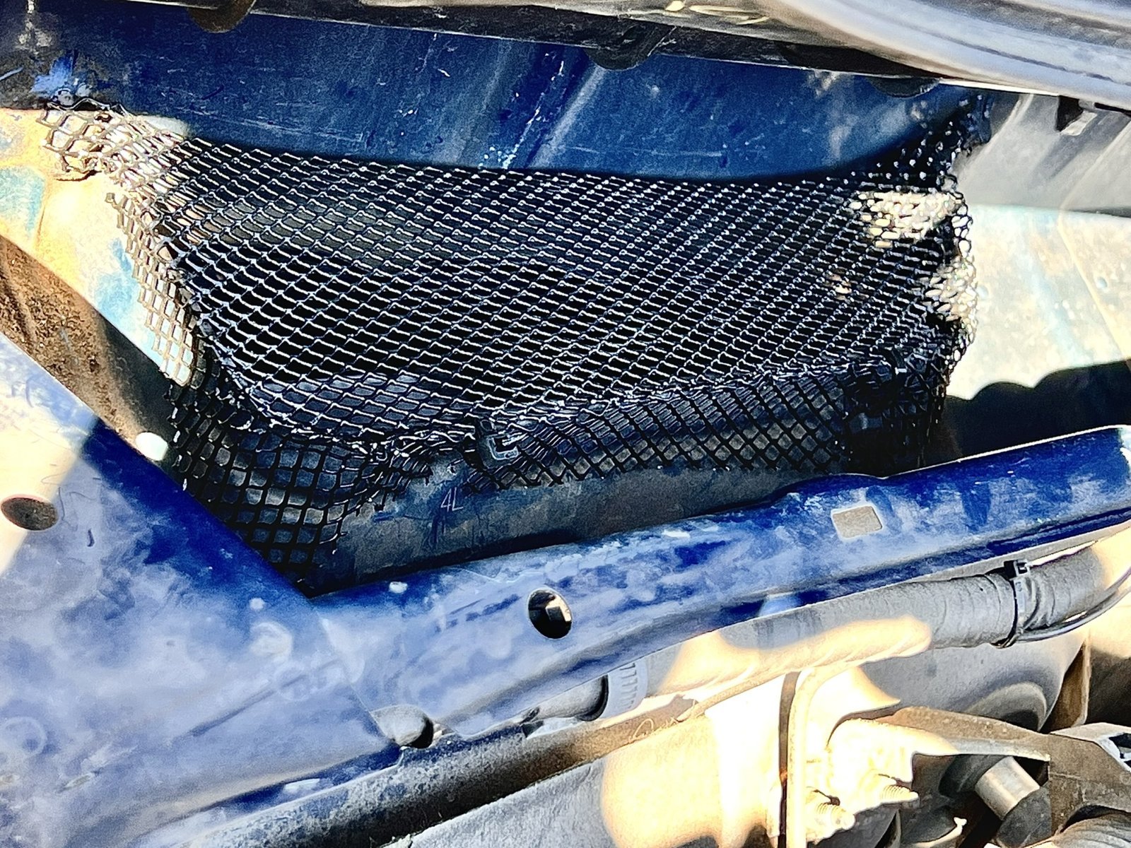

    Not sure why I took so long to do the cabin intake screen mod. Took like 15 minutes. I opted for zip ties instead of bolting it down, which seemed like overkill. Also pinched it around the lip of the opening. It's not going anywhere!
    I might pull the cowl off all together later this season and add some sound deadening in there to try and quiet down the interior even more. Not sure how much of an effect it would have on engine and wind noise entering the cabin. :pccoffee:
    Anyway..... results!

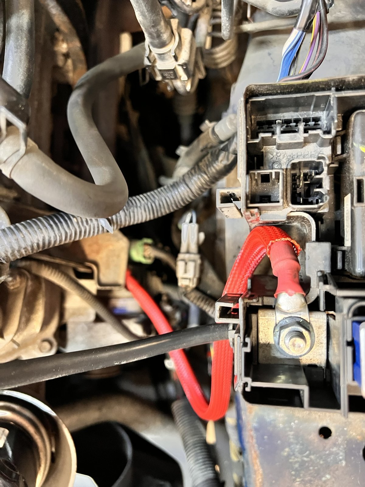

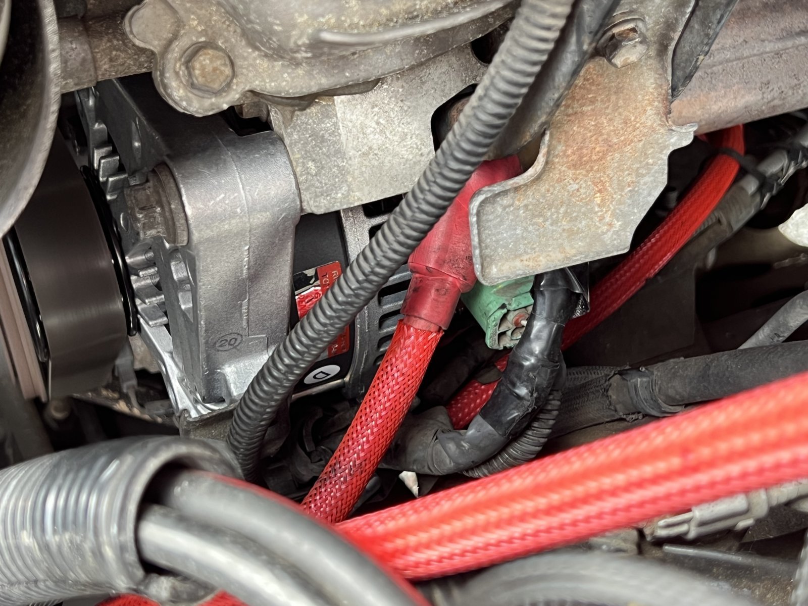

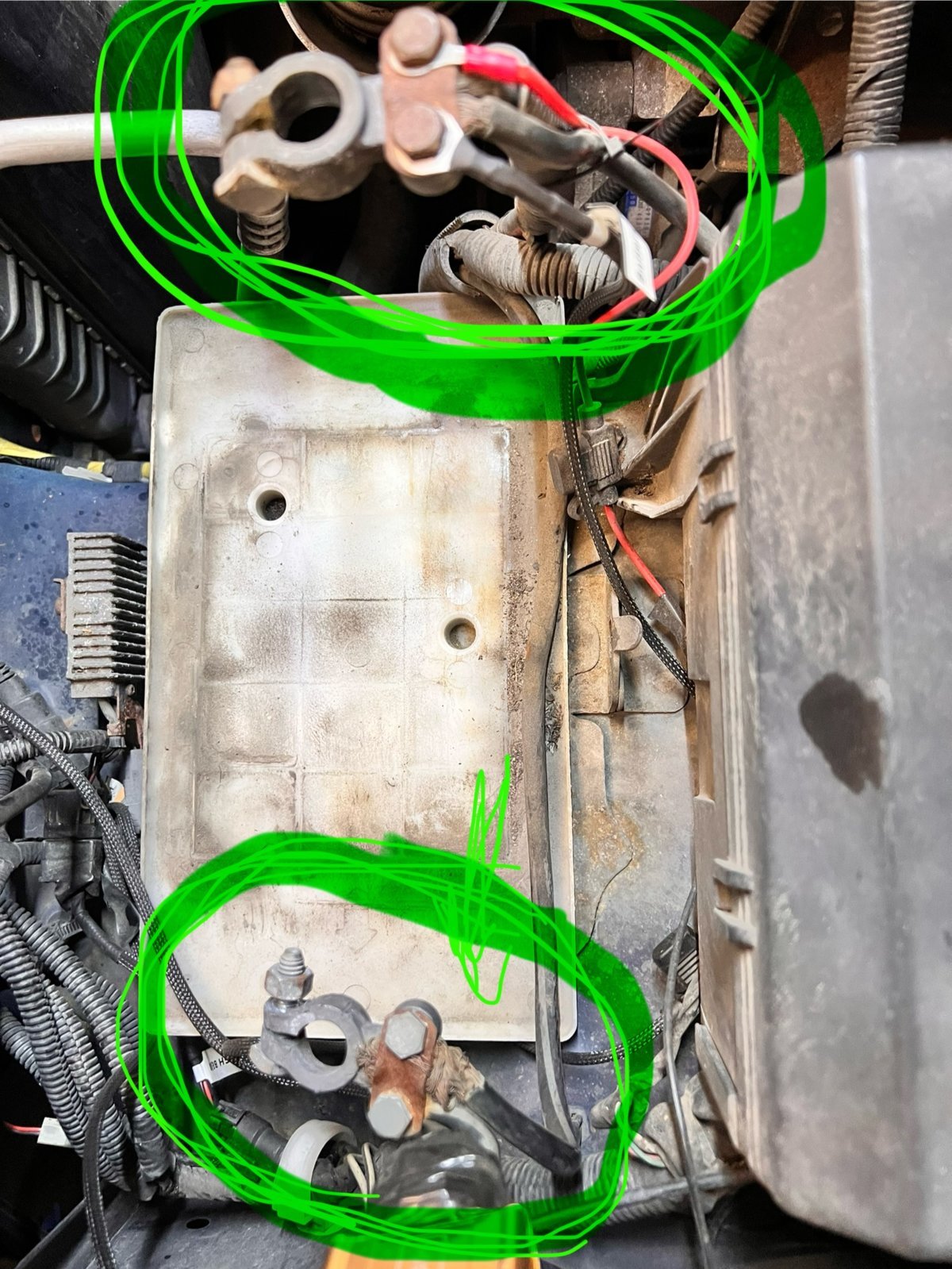

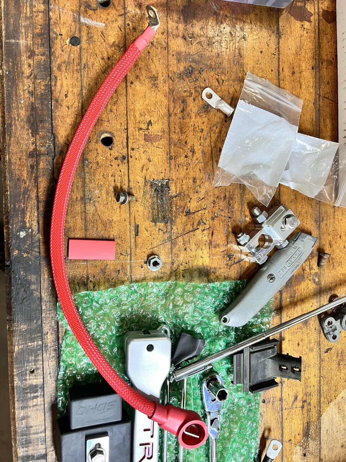

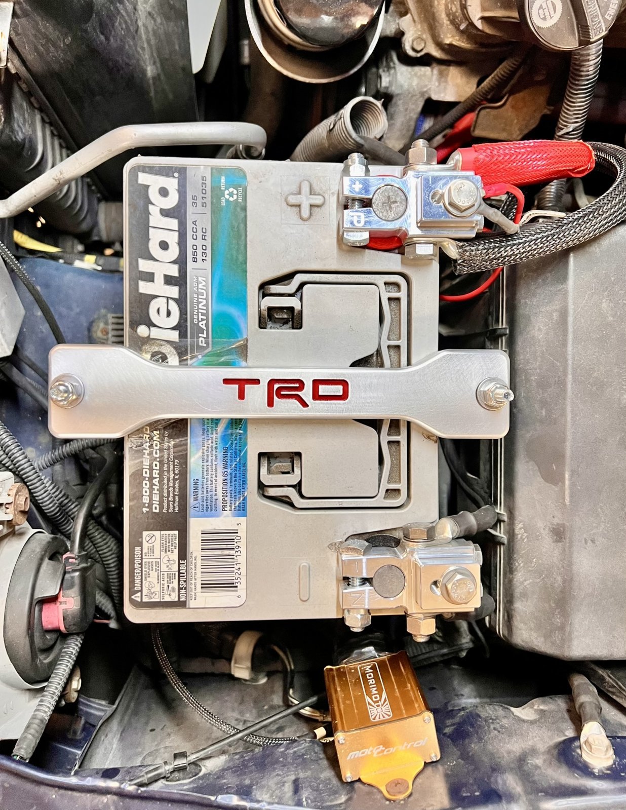

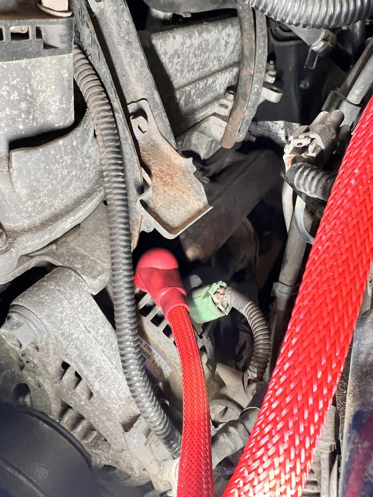

    Wires!

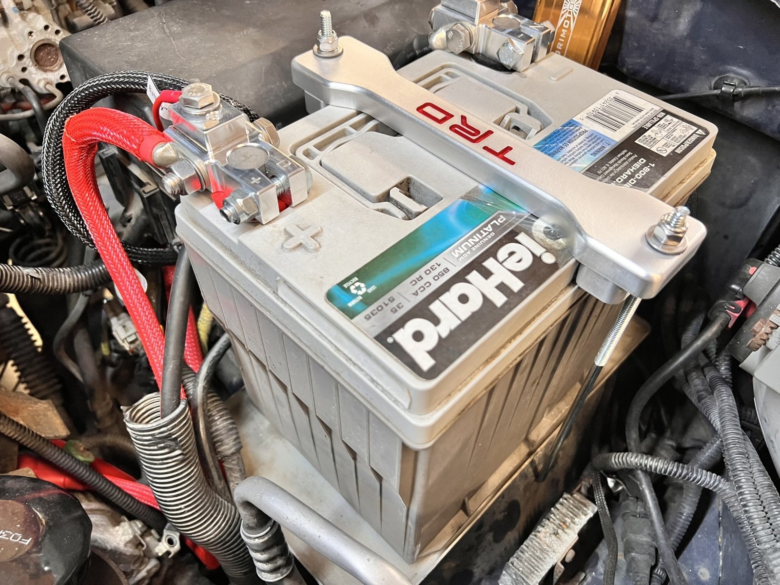

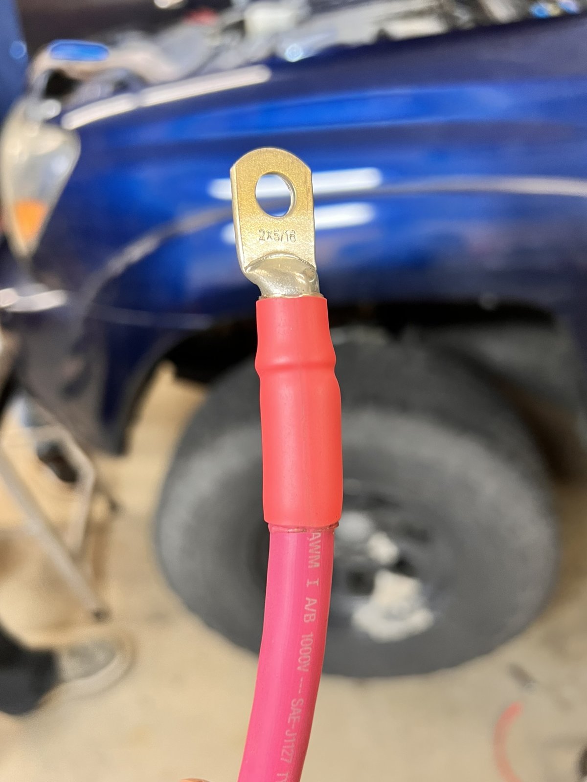

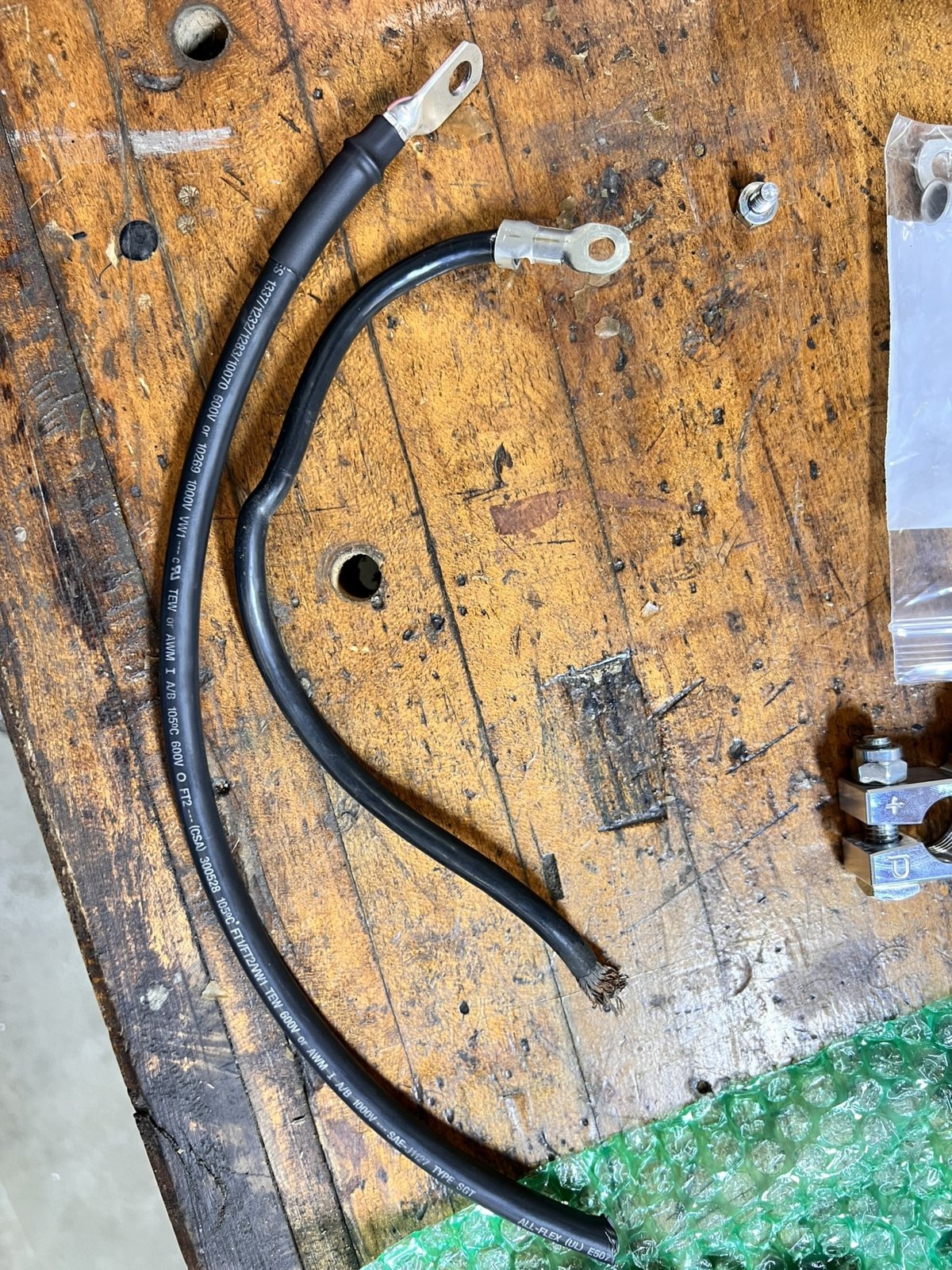

    A day spent at @6 gearT444E 's shop is a good day. We knocked out some...but not all... pretty beat up battery wires.
    After trying to chase the loom and harness for way too long, we decided to abandon the old wires for the starter/alternator and run new ones parallel to them. Although I'd like to clean that up one day, yesterday wasn't the day to do it.
    @Coupe 's battery tie down is awesome. Looks right at home. Highly recommend it.
    @sdhq terminal kit is a thing of beauty. Still love looking at them and hate hiding them beneath the terminal covers.
    Main ground still needs to be replaced. But I want to look at some pics or find a writeup showing what else is grounded in place with it. I assume the small wire is crimped to the main ground?
    Otherwise, I replaced all wires w/ the same or larger gauge. Basically all 2 or 4ga now.
    IMG_0965.jpg IMG_0973.jpg IMG_0968.jpg IMG_0976.jpg IMG_0977.jpg IMG_0979.jpg IMG_0983.jpg IMG_0982.jpg
    fatfurious2, 6 gearT444E and Coupe like this.

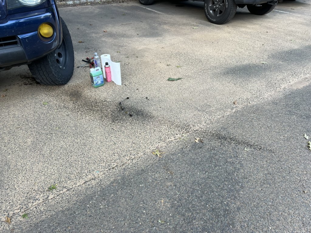

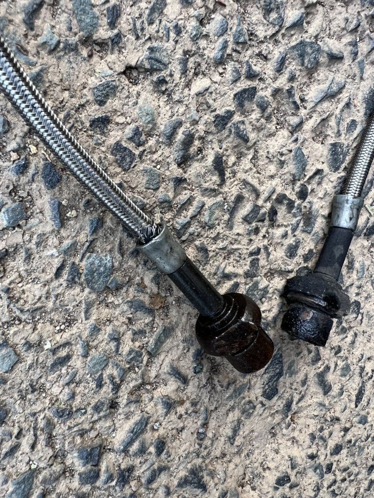

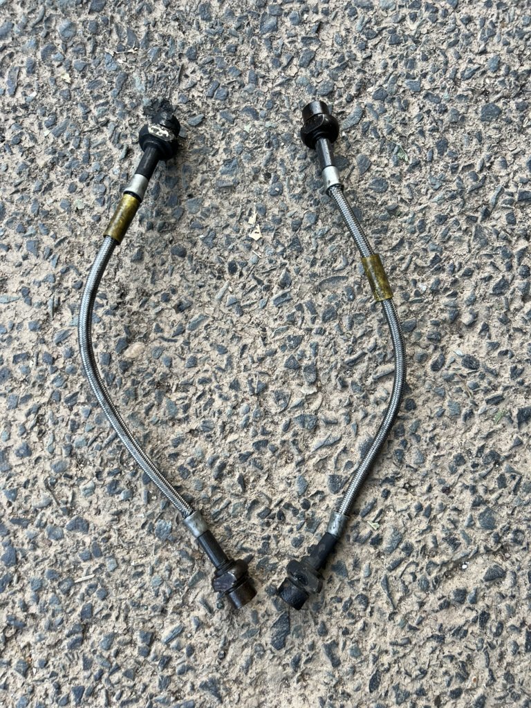

    Ok, another short but successful road trip. This time up to New Hampshire and Maine (Acadia).

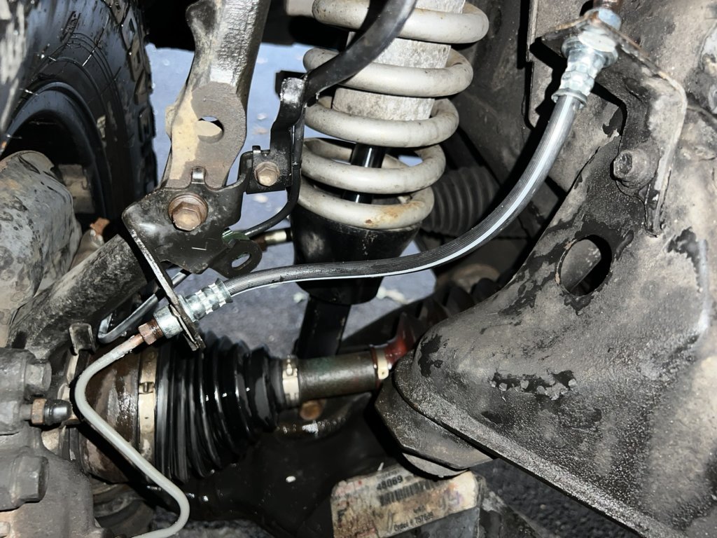

    During the drive home I noticed a strange brake pedal feel. Lunch stop gave me time to take a look and sure enough, a leaking passenger line. I felt confident I could make the remaining 200 mile drive without a roadside repair. A lot of space between me and the next car, some downshifting and a few prayers got me home in one piece.
    Both lines were broken at the caliper end.
    To get me rolling again, I dug out the OEM brake lines. Installed the passenger side and while my buddy was pumping the brakes to bleed the line.....the driver side blew! It was like a geyser lol. Look at that spray pattern!!
    Attempted to install the other oem line but turns out the threads were stripped. No idea how that ever happened or why I would've saved the line knowing they were stripped. But whatever. An Autozone run for another new line and now I'm back in business.

    Fwiw, those Goodridge lines were probably 13 or so years old.

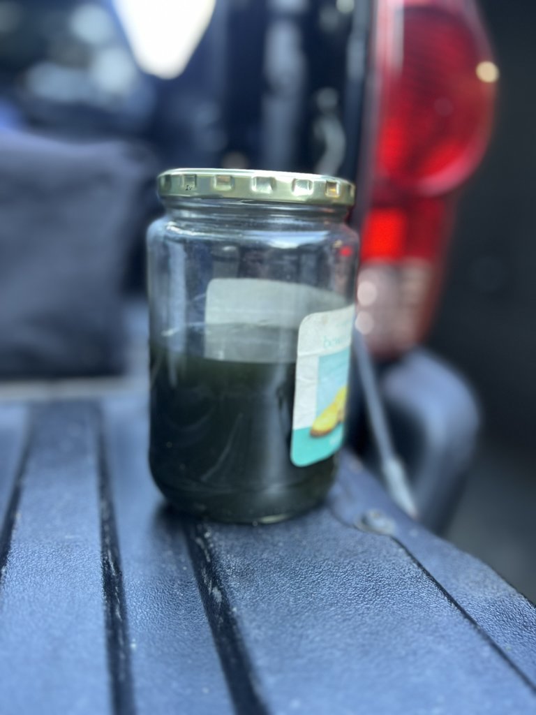

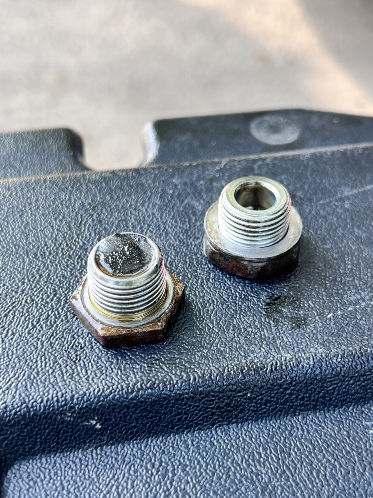

    Think my clutch fluid was a little beyond overdue? 217,630 miles
