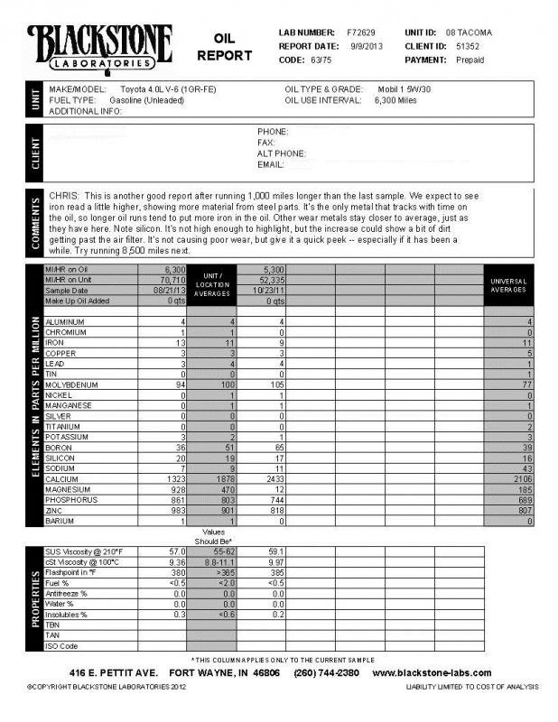

    Oil change @ 70,700. Collected oil sample to send out to Blackstone. This will be the 2nd report I'm having done. First one was clean at 52k. Been using 5w30 full syn Mobil1. I'll post up results once I get them.
    Also installed a new cabin filter and greased all fittings (as with every oil change).

    Results from the analysis...
    Next one won't be until 100k and I'm going to do oil changes at 7,500 now.
    Air Filter changed @ 74,150

    interesting

    Nice. I was up to 7,500 as well but I haven't done a sample the last few oil changes so I haven't been going much past 6,000
