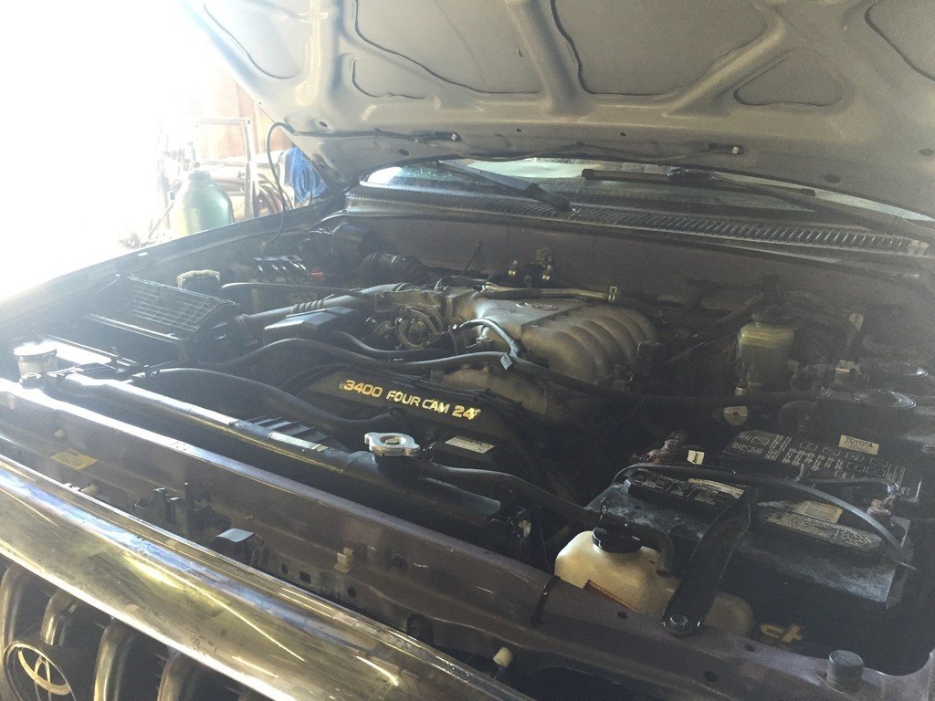

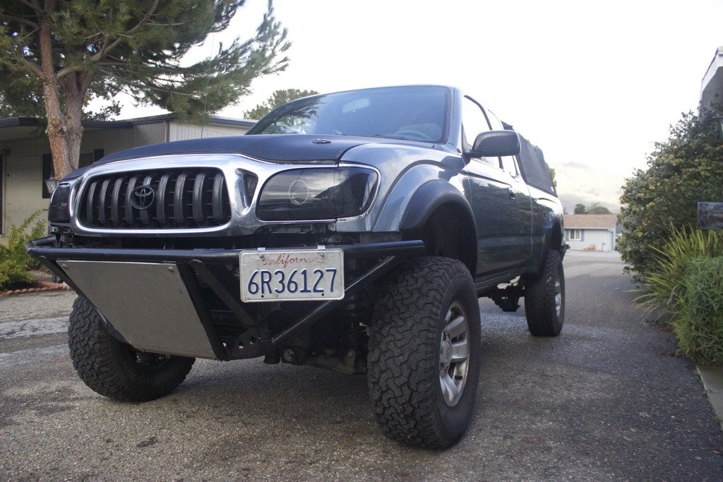

    Was too dark when I installed the headlights tonight to get other pictures.
    Will post more tomorrow :D

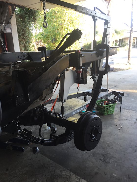

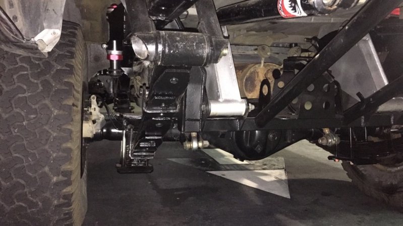

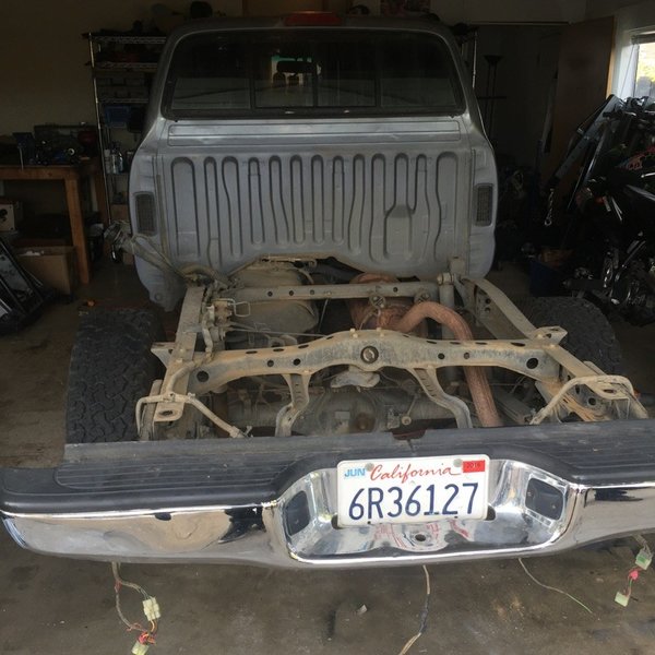

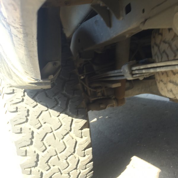

    Canti is done minus shocks and limit straps but that'll come.
    Big thanks to @anthony250f for the work space and help!
    Stock suspension with some weight in the bed..
    Definitely due for an upgrade.

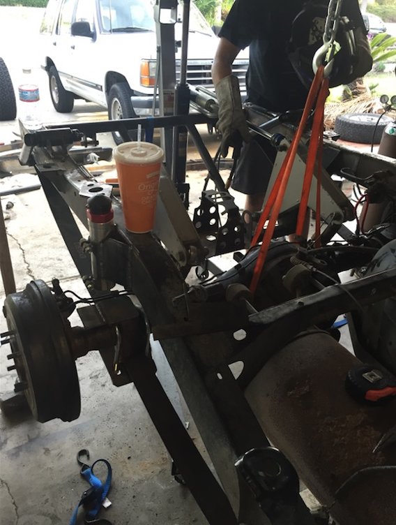

    Day 1.
    Tearing into a completely unmolested truck is always great.
    Previous owner kept this thing completely stock, frame was a little dirt but no rust! :D

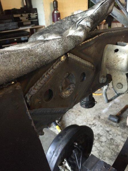

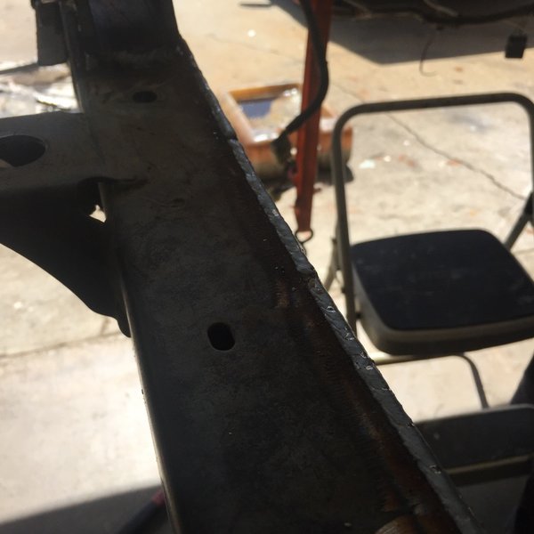

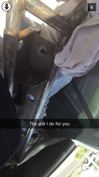

    Started with Frame Plates.
    Jordan and Anthony laying some nice welds down.
    Screen%20Shot%202015-10-22%20at%208.44.2_422ee0801194f0ca2cb6096e29fdb3ec76e10c1d.jpg

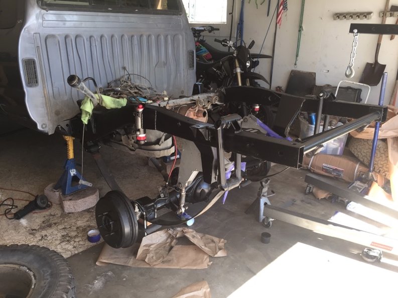

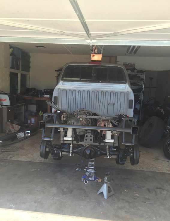

    The rest of the build became one of those lets get it done builds so no real step by step pics.
    Just random ones here and there.
    Screen%20Shot%202015-10-22%20at%208.48.1_bca747b2a495f9565443f8dee45aa82ba33335d9.jpg
    Screen%20Shot%202015-10-22%20at%208.43.5_61113d129d6b9df9f327738abdd79b43bf8c0851.jpg
    Screen%20Shot%202015-10-22%20at%208.43.4_4ed07afa3041bc94387cf1c935817593d3805a89.jpg
    Screen%20Shot%202015-10-22%20at%208.43.3_0aac5992462955c9f1d55475ff8930fa592847e2.jpg
    Screen%20Shot%202015-10-22%20at%208.48.3_32d75621efef1c6a41614be7214a66ea112b7cc9.jpg

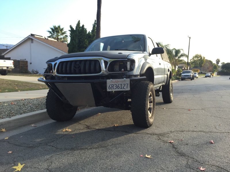

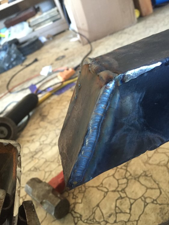

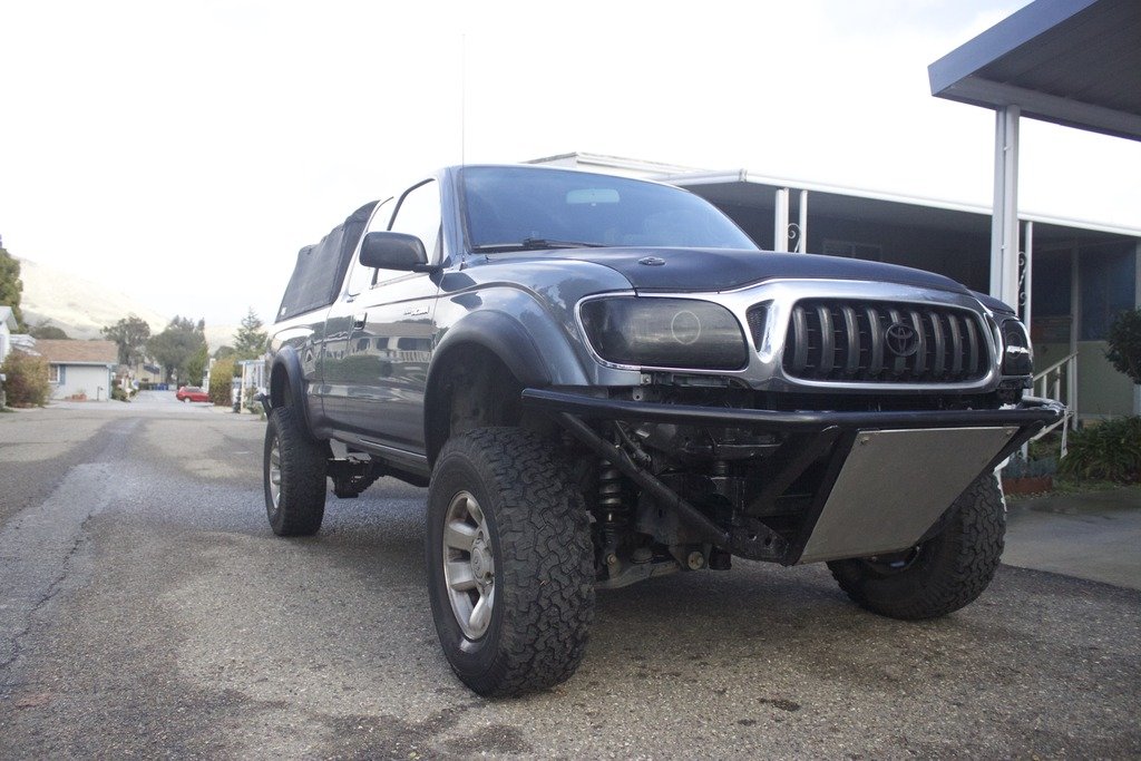

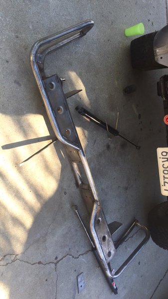

    Redid the front bumper and started to learn to weld!
    Not the prettiest but i'm still learning.
    Screen%20Shot%202015-10-22%20at%208.48.5_d3a54947de910dc616d41ee4e7ec94ed63253bb0.jpg

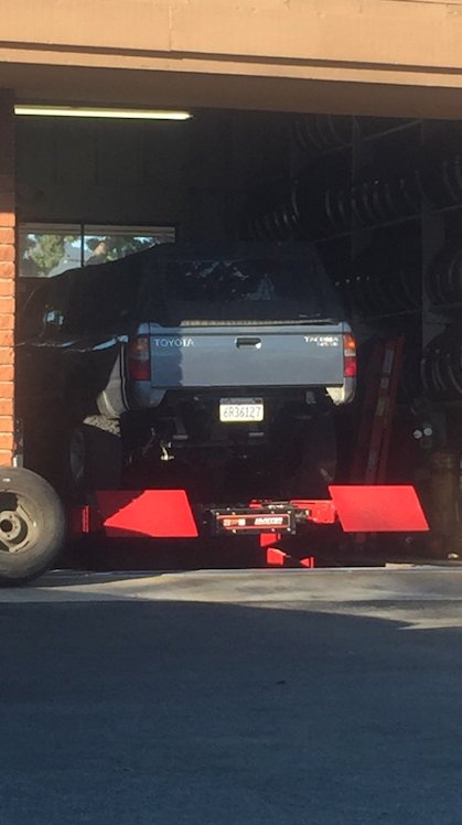

    Fresh alignment
    Screen%20Shot%202015-10-22%20at%208.49.0_9e150b6a84b8ea16aef06df9c625676478fe9872.jpg
    AND SHES "DONE" :broccoli::broccoli:

    That doesn't look like LT front....WTF!

    Haha it'll come, sooner or later. Canti is looking good though

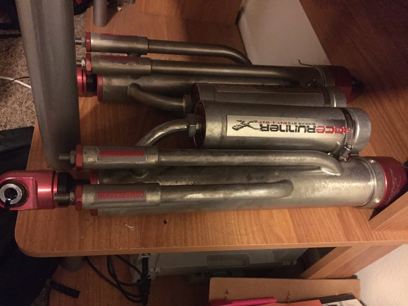

    Finally got some shocks that'll cycle properly, Feeling pretty sick and woke up to a text offering a trade for my fox's.
    Not a bad way to turn the day around!

    Got the new to me bypasses mounted.
    Filled the bumps and bypasses with nitrogen.
    Got this installed at Anthony's place
    Was dark when we finished so no installed pics, shackles hit the stock mounts for the bumper so had to do some cutting and welding.

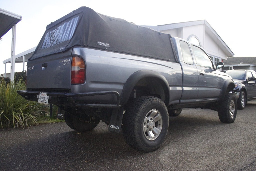

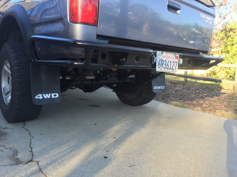

    Rear bumper installed, and painted!
    Also had time to mess around with the bypass tubes, install mud flaps, and do the grey wire mod.

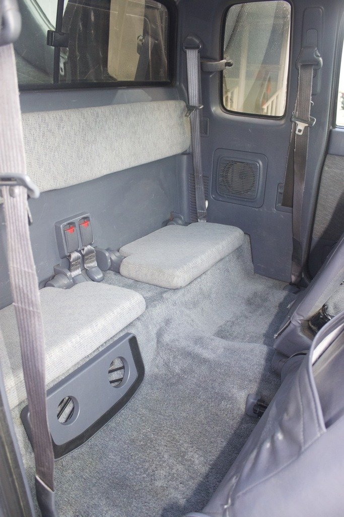

    Photodump of some pictures after i cleaned it up a bit.
    In need of rims and tires lol
    IMG_8228_zpsvolzge7p_b25693482aafc2ce96b77f357a6980087c385b44.jpg IMG_8230_zpspi4h1zjc_bdf4bf0bffc7b436fb7efd52cf44911b662e2729.jpg
    For being 18 years old the interior cleans up pretty nice.

    Full Bed Space, Pulls about 15-16" of travel.
    Doesn't give as good of a shock ratio as a traditional Spring Under Axle set up but I was going more for complete bed space so this set up is a perfect middle ground for me.
    I bought the canti off of a friend of mine. He paid LSK to build it for him. Not sure how much it ran him, guessing 3k at least.
    On top of that you need shocks and leafs, plus random hardware. Adds up quick.
    Took me and @anthony250f a few weeks to install it properly, but we were only working on it a few days a week.
    Unless you know quite a bit about fabrication you'd probably be better off paying someone to do this for you haha
    Unless you're really pushing your truck you'd probably be fine with an OME set up and some off the shelf shocks.
    I personally was planning on going that route but managed to piece this together for a little bit more than what an OME set up wouldve cost.
