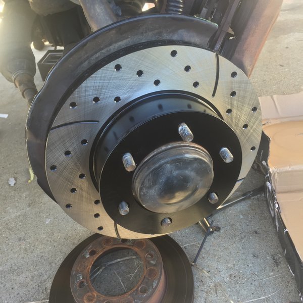

    Replaced the brake pads and rotors, and went and did some wheeling!

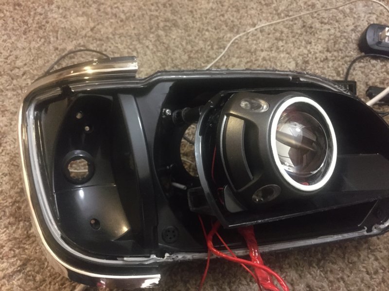

    Hey man, do you have anymore pics of your retro? Im looking to do the same one but with D2S, how much did you have to trim the panamera shrouds to get them to fit? Thanks!

    I have a ton, if you're looking for anything particular let me know. Heads up these one piece head lights suck to get apart and are next to impossible to get an FXR into. If you're doing a D2S you should be fine since thats just drop in and tighten type of thing.

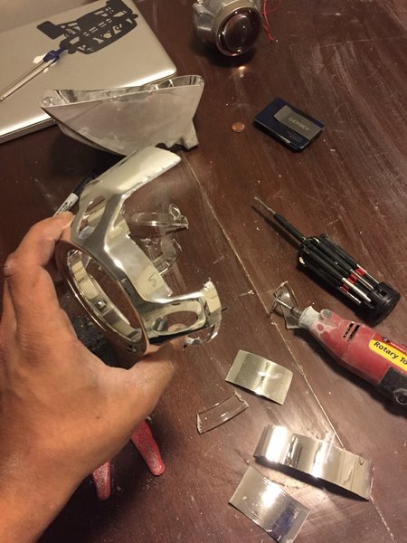

    Here's a picture of the Panemera Shrouds being trimmed. Basically cut it in half, this is with the FXR 3.0 so not sure how it compares to the D2S shroud size.
    This was just a progress pic, I ended up trimming what you see on the table all the way around

    Awesome thanks! Any tips on getting these apart? I tried the oven but they don't want to budge at all!

    I just kept them in the oven for a while and took them out every so often to try and pry them apart. The only really side effect was the chrome of the turn signal area bubbled slightly.
    The problem is the way they're sealed. It's not butyl like own headlights. It's a hard plastic that doesn't melt or give at all. One the second headlight I got frustrated so I just carefully cut along where the glue is with a dremel. Sealed them up with butyl and some clear silicone and no leaks yet

    Dang, well the same thing happened to me with the chrome corner light haha. Thanks for the tip, hopefully this project isn't to aggravating.

    Is this headlight the one you cut?

    I don't remember, can't really. Cut maybe a quarter of an inch of the plastic housing away. I think if you cut a small square to get a screw driver in there then heated it up you could pry them apart pretty easily. It's really just getting them started that sucks.
    I think I might've even started prying them and cutting the plastic glue with a knife

    Sorry unless you meant shroud, then yes this is cut shroud. This was a test fit and I Went back and polished the cuts up after this.
