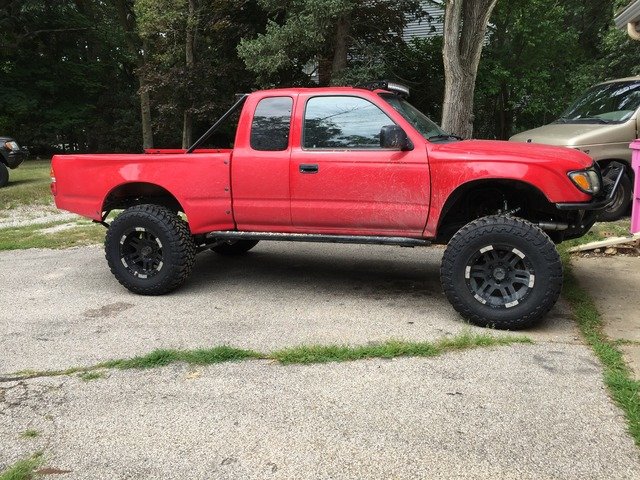

    most current pic at the moment:

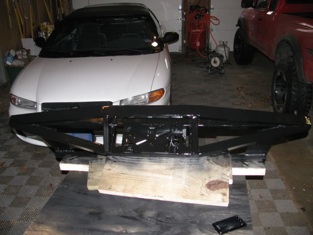

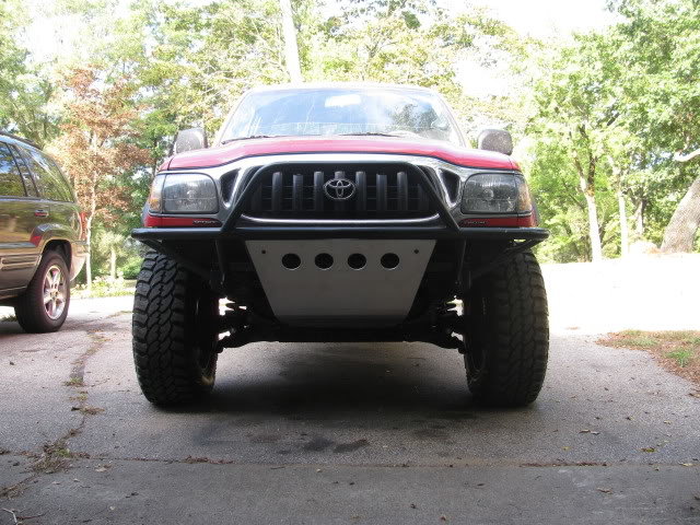

    Allpro front bumper modified http://www.tacomaworld.com/forum/1st...-modified.html
    Allpro Skids
    4X Innovations Sliders

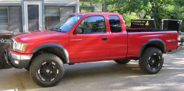

    Now how I got to the above.

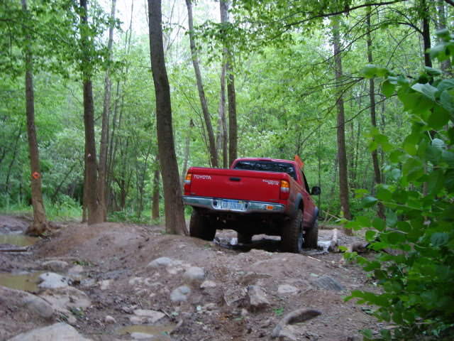

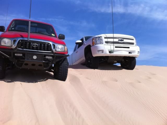

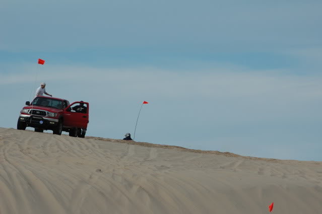

    I was looking for a truck that could go out with our quads and be a Support / film vehichle. Went to the dealship and couldn't find a TRD 4x4 with a 5speed new, but came up with this one factory preowned 2 years old with 20,000 miles on it.

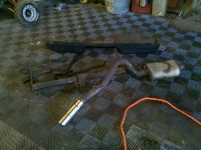

    I then picked up a Westin safari lightbar, some PIAA's, a gibson exhaust, and K&N gen 2. Also slapped on a set of cheap rims had sitting around and put 31x10.50x15 BFG Mud terrians

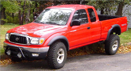

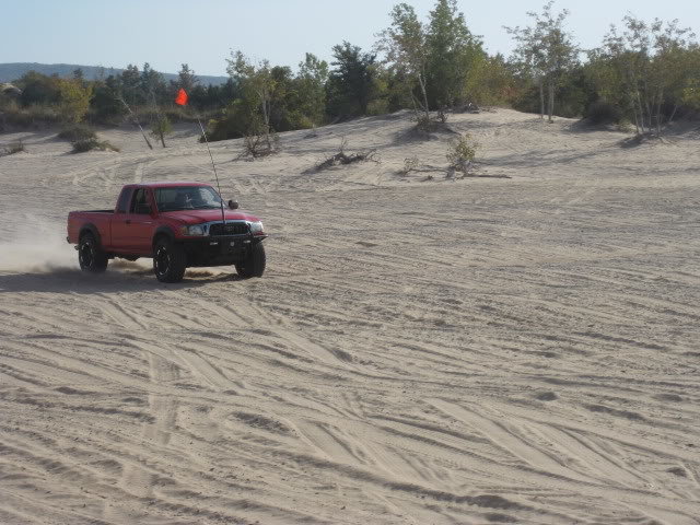

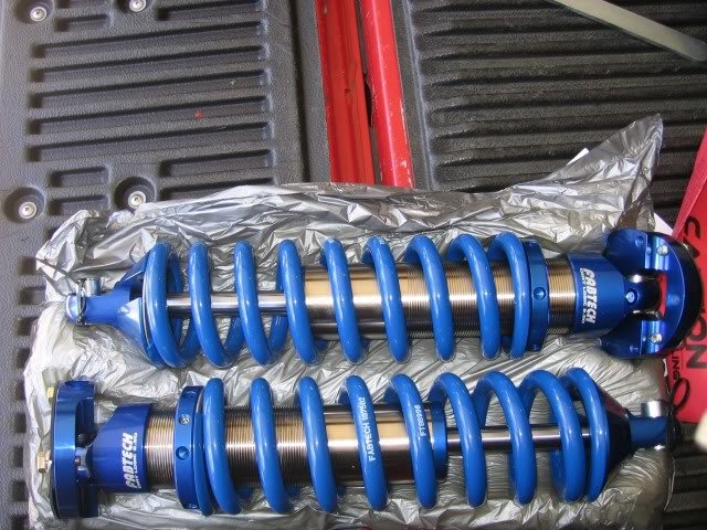

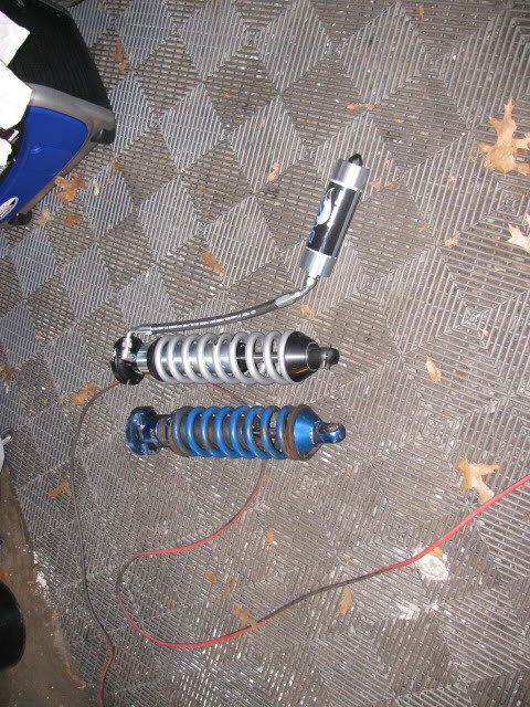

    Then I added the TRD Gen 2 Supercharger, flowmaster super 40, Fabtech 2.5 coilovers, and Bilstein HD in the back. Also switched to Motometal rims.
    This was all an attempt to pull the quad trailer to the dunes so I didn't always have to take 2 trucks. You can see the trailer in the background.

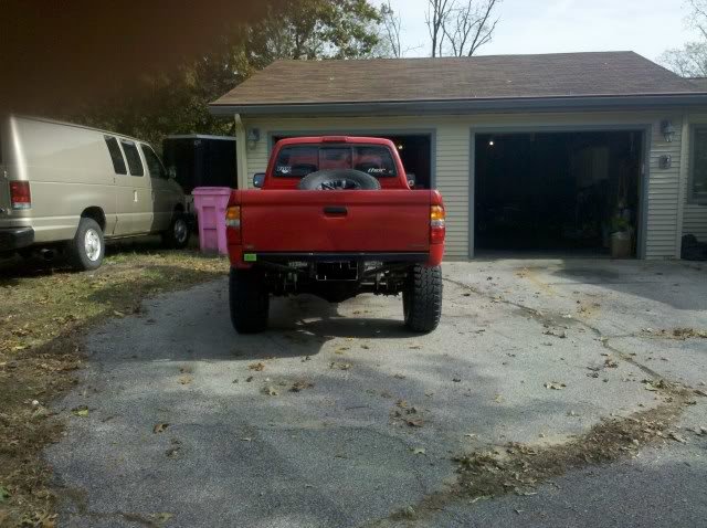

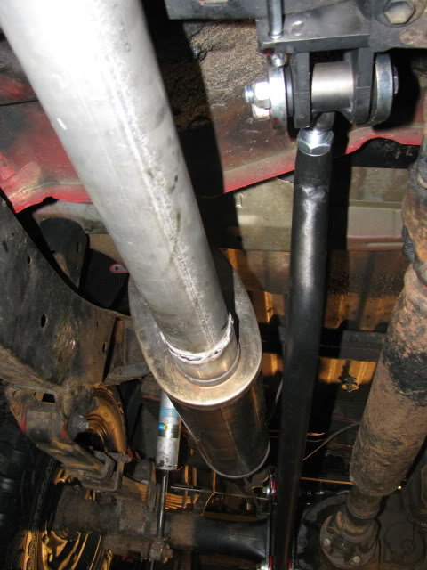

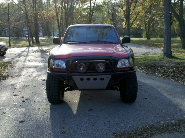

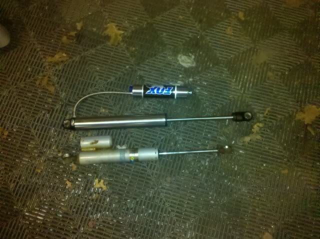

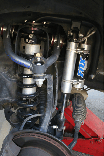

    I then put the Icon 3 pk AAL and 8.5 travel 5150's and allpro greasable shackles.

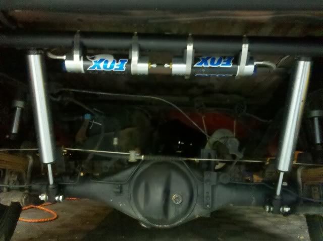

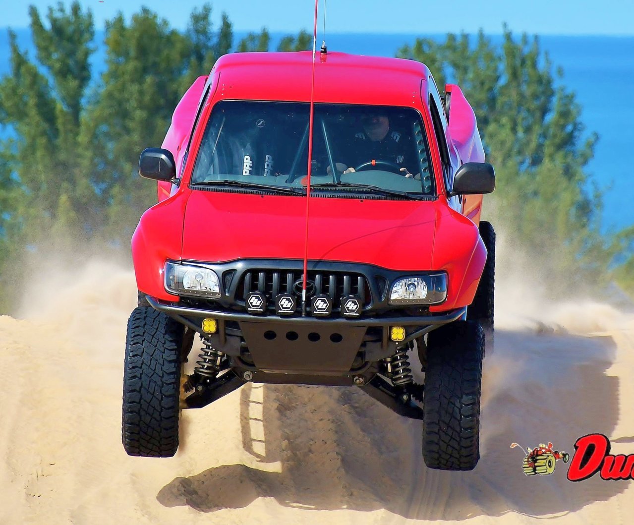

    So the next stage of the journey is building a truck that can perform like a prerunner but still fit down tight trails.
    This winters plan:
    rear sua probably. Maybe just over the frame shackles on my current springs (kinda want to try to see what its like).
    16" bypasses with bedcage and hoop behind cab to tie into a cab cage later.
    Front secondary shockhoop.
    Let hear about what you think of the truck so far, any more pics you want to see, and were you think the build should go.
    thanks,
    chris

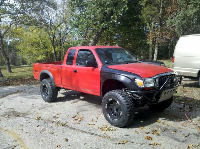

    I told Tim at glassworks anything but white. Kind of diggin it, but planning on repainting the whole truck after I get rears and probably a hood.

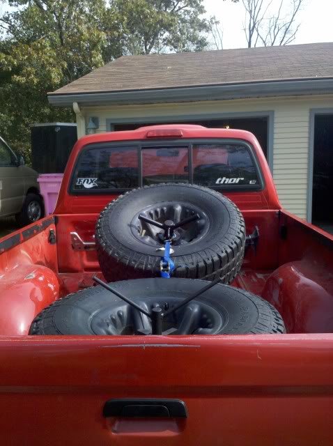

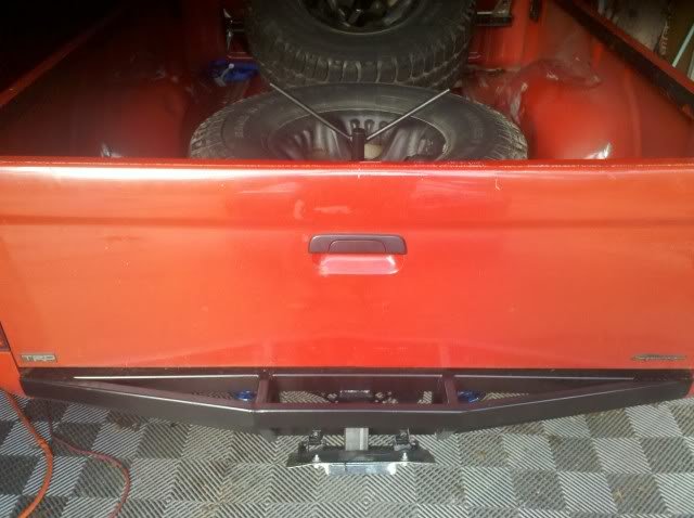

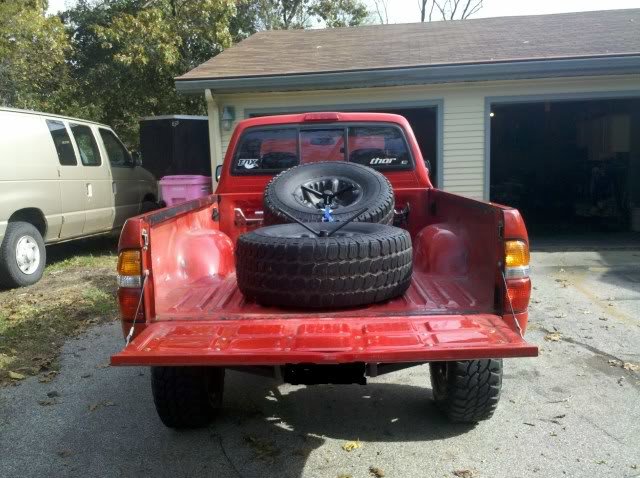

    some more pics
    and some of my bed setup:

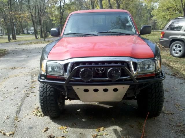

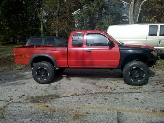

    painted the grill surround today.

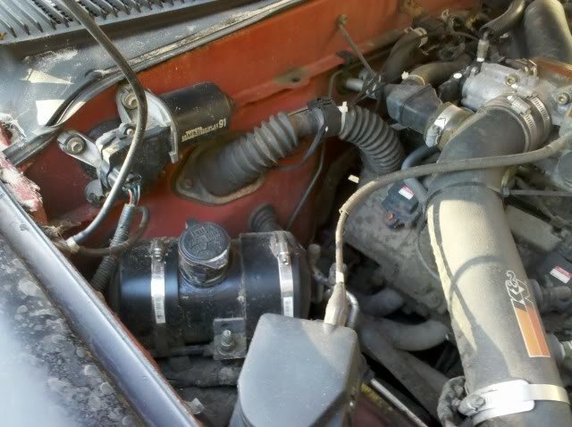

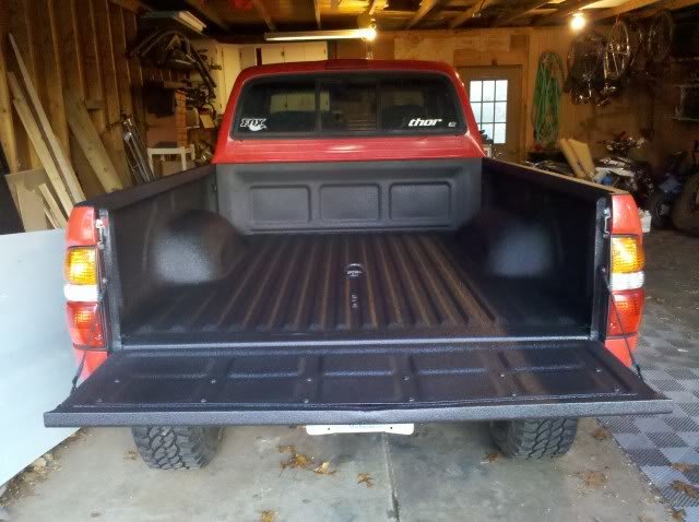

    Because of my coilover ressies I had to remove the washer bottle so here is my solution. PVC and some endcaps, worked well so far.
    Also decided to do a Raptor spray in bedliner
  16. Nov 5, 2011 at 6:08 PM
    #16
    atvlifestyle
    atvlifestyle [OP] Well-Known Member
    Nov 3, 2010
    #45647
    1,726
    Michigan
    01 trd tacoma
    supercharged with MCM front kit

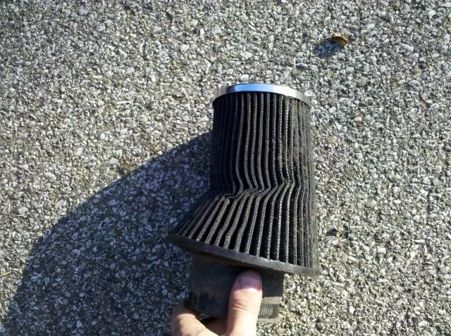

    My airfilter after hitting a mud hole and outwear got covered in mud and the supercharger pulling hard for air.
    And what it looks like under the hood after a fresh filter/outerware and alittle cleaning.
