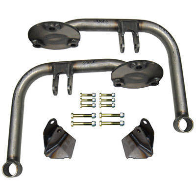

    only way to know for sure is to ask TC
    but i highly doubt a 2.0 bypass will fit in the stock length arm hoop. tubes stick off pretty far from the shock body

    I will get ahold of TC to find out. I emailed a few weeks back and never heard back so I have to get a chance to give them a call.
    Plan two would be to run a smoothbody with a compression adjustable ressie like what I have in the rear now. Just kinda seems like a waste, almost cost as much with no where as much adjustment.

    odd its working for me. its total chaos's secondary shock hoop for the stock LCA [​IMG]

    a bypass shock will bolt up to the hoop no problem. it's when the hoop is installed you run into space issues clearing the bypass tubes and the UCA. i'm pretty sure only a smooth body shock will work

    how do you plan to do the lower mounts for the 2nd shock on the stock lowers?

    I ended up ordering the TC kit which comes with a lower mount. I recieved the kit yesterday and hopefully will get it installed in the next couple weeks.

    For those wondering about the secondary shock.
    I will start out by saying that the guys at downsouth are the best. Marco did some research and it sounds like we need a shock that will compress to 15.10 and I cant remember the extended length. Anyhow fox currently is building a prototype shock that TC is going to be testing soon that will be application specific. Sounds like there is a king shock that will work avaliable now.
    So I ordered 16" travel triple bypass foxes for the rear.:D
    I am going to wait it out for a little bit on the secondary to see what shakes out with fox, because it is being built to match up with my front coilover.

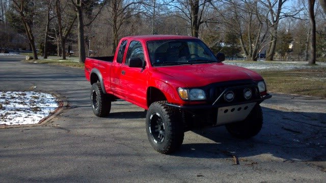

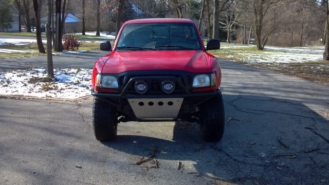

    Finally got a chance to put my fenders back on after painting them.
