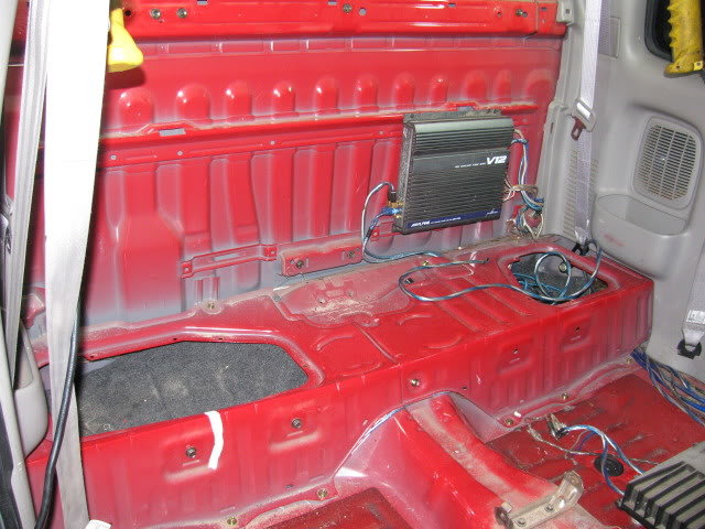

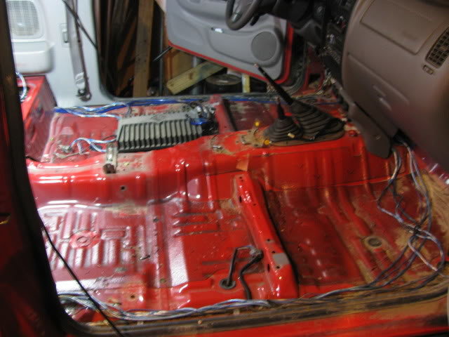

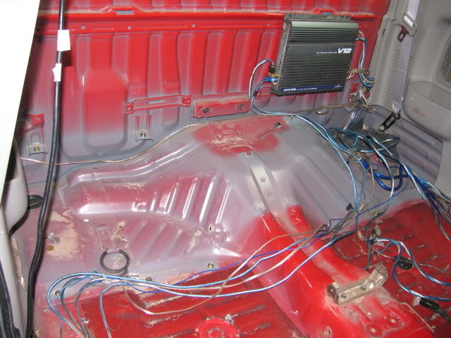

    I plan on finishing up the fan tonight or tomorrow. In the meantime started getting the truck ready for the next mods.
    That will require some major stereo rewire/cleanup. Over the years we have slapped equipment in and out and this is the resulting mess.
    Plan on leaving most of the interior out and just spraying it with Lizard skin and Raptor Liner. Time to start removing all the tabs and crap that aren't needed anymore.

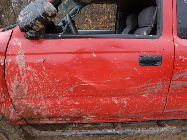

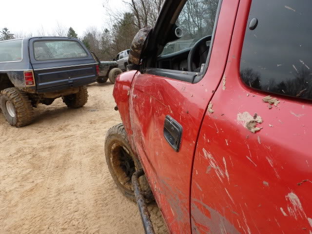

    Went wheeling today and got owned by some schrubs. Pushed me into a tree. Whoooops.
    Just added alittle character. Electric fans worked well, ill put something together on that tomorrow.

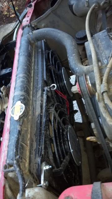

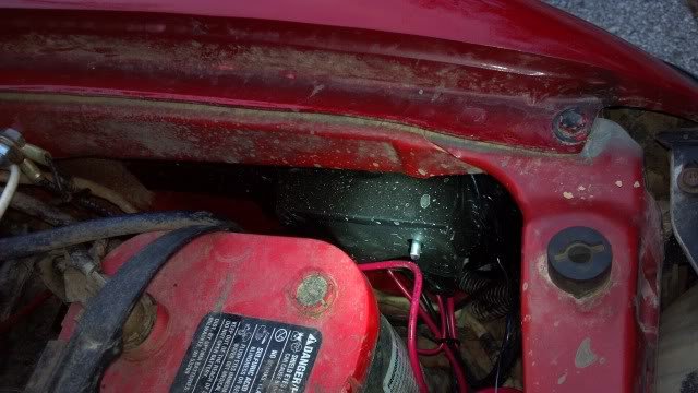

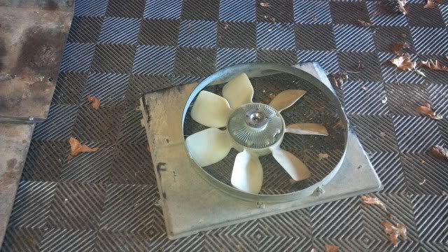

    Ok alittle info on the fan install.

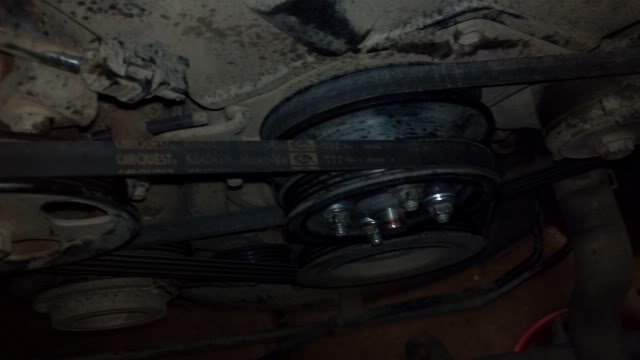

    First you have to remove this:
    You have to remove the 4 nuts that hold the fan and power steering pump pulley on. I recomend pulling the studs and replacing with a bolt. I didn't have any so I just used washers because the threads aren't down far enough on the stud.
    Then you have to wire and mount the control box. I put it behind the battery because the thermocouple only reaces so far.
    Then you mount the fan with the supplied tabs to the stock fan shroud mounts. I also used an ibot to run the wires thru and keep them out of harms way.
    I wanted a switch to be able to shut the fan off when needed. I wired the thermostat to ignition and thru a switch. I pulled the lighter and put the switch there.
    Its a pretty simple install so if you want more indepth info just ask.
    There are a few things I want to change:
    -I am going to wire an always on switch to give the flexability of thermostat/ off/ always on.
    -The mounts are cheap aluminum bracket and I want to replace with something more substancial.
    -The control box isn't water tight and needs to be mounted in the engine compartment. The circuit board is exposed where you conect to it.

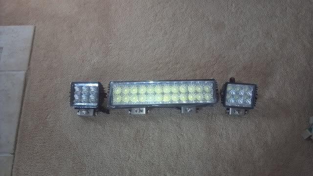

  20. Dec 22, 2012 at 7:30 AM
    #200
    atvlifestyle
    atvlifestyle [OP] Well-Known Member
    Nov 3, 2010
    #45647
    1,734
    Michigan
    01 trd tacoma
    supercharged with MCM front kit
    This time I will try to keep up on pics. Probably wont see any real progress till after Christmas.
    Since I don't have my truck at the house had to put together a few projects when I can't get to the shop.
    Working on mount setup to put this setup in place of my 21S on the bumper.
    Also going to start working on a mount system for the 21S. It will go where the tubes will come out of the cab so the light will normally be a backup light but can be rotated and be a front facing over the cab.
