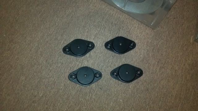

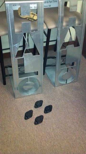

    Solid body mounts are finished and ready to go on the truck. If people are interested they will make these to sell.
    SilverGhost likes this.

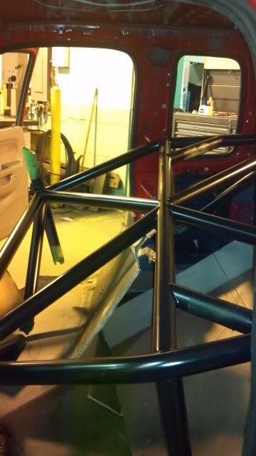

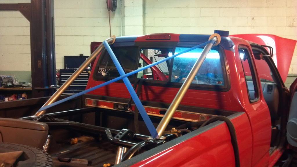

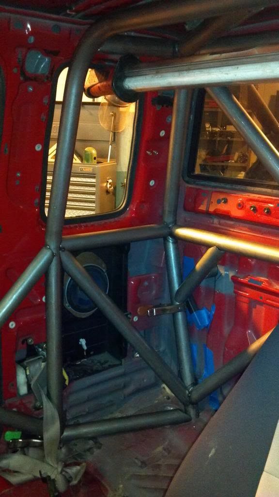

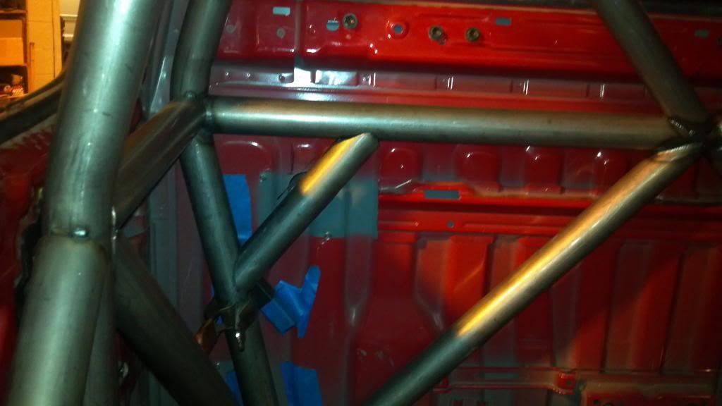

    Some cage progress:
    Have to drop the tank to get some of the welds so may also do a cell while we are at it.

    nice dude! only caging the rear of the cab right now? i see the dash is still in place...

    That was originally the idea. There will also be a door bar and more bars around the walls. We will just see how much time is left when this portion is done and we may just keep going.

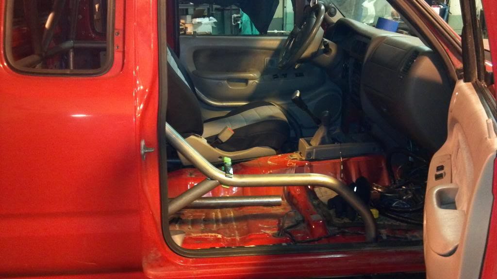

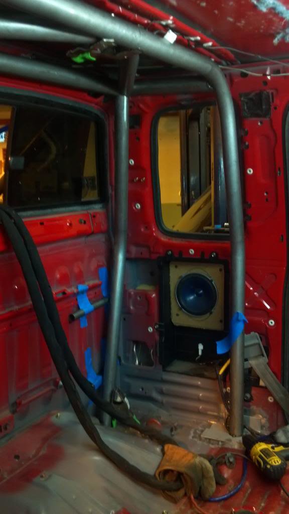

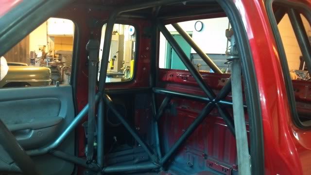

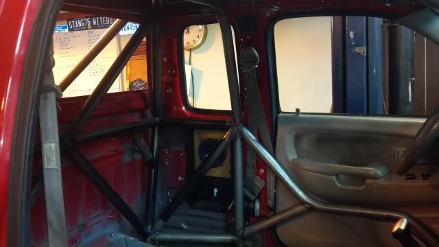

    Some more pics
    Thinking I will just stick with the stock seats for now, at least till we build my wife up a dune truck. Dont really feel like putting racing seats on sliders, or maybe I just just trade the wife for one that isn't 5'3" :rolleyes:.

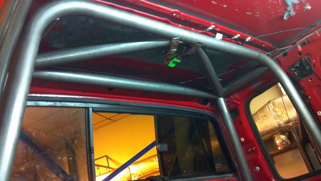

  18. Feb 16, 2013 at 7:30 PM
    #218
    atvlifestyle
    atvlifestyle [OP] Well-Known Member
    Nov 3, 2010
    #45647
    1,734
    Michigan
    01 trd tacoma
    supercharged with MCM front kit

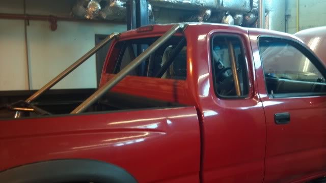

    Cage progress. Stage 1 mostly welded up.

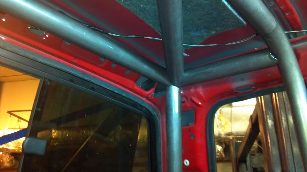

    How did your fabricator 360 weld everything with the c pillar tubes coming strait down on the frame?
  20. Feb 17, 2013 at 3:33 AM
    #220
    atvlifestyle
    Nov 3, 2010
    #45647
    1,734
    Michigan
    01 trd tacoma
    All the tubes go through a plate then through the floor. The cage was tilted forward and lowered to be able to get all the way around the tubes. Then its was raised and the plates welded into into place. He had a problem tilting it enough with the top tubes going out of the cab and had to cut them off and get creative.
