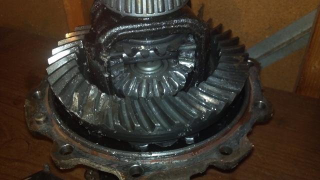

    Another front diff down the tubes. Looks like I broke the spider gears and the chunks of crap got in the R&P and jacked it up also.

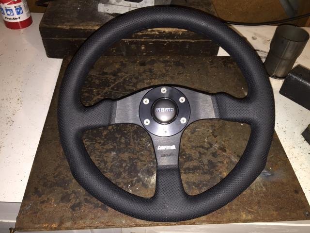

    Front suspension is pulled off just waiting on parts so I can put the long travel on.
    On another note I picked up a steering wheel and quick connect.

    i came in here to see your issues with your front diffs, as i have the same issues blowing diffs in the dunes. i have blown 4 now and im tired of it.
    always starts from the spider gears....
    will a true trac make a difference in the spider gears?
    i just got my first front diff that has a locker in it and it has an ARB, so 4 spiders instead of 2.... hoping it will do better?

    Thanks man.
    Ya I believe the trutrac will also eliminate the problem with the spider gears for two reasons. Higher quality parts. The second is what I was saying with the carrier flexing and causing poor mesh with the spider gears causing chips in the teeth. A stock carrier is a cast piece that is made with big windows where most lockers/ limited slips are mostly solid ( see below). The big windows on the stock carrier make it susceptible to flexing and twisting under force and the spider gears will separate putting more force on the end of the teeth where it is weaker. This is why it chips. Those chips then end up in the ring and pinion and end your day.
