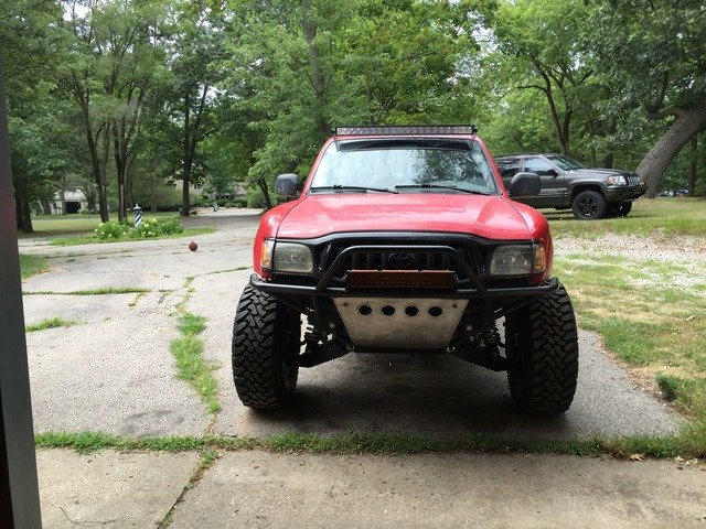

    Lack of progress update. Tires are still on backorder. May end up with toyos if they can actually get them in.

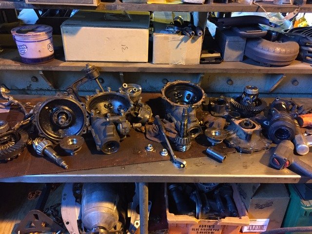

    I decided for the time being to just swap gears into one of my good 4:10 diffs. Month later still have it all layed out on the bench. I guess i havent had 4wheel drive in a year and i havent had a problem without.
    2CBCED35-4717-4A89-9DB6-202C64DD9FA3_zps_116d2f964596e32b907755b200ef3d2f274dab9b.jpg

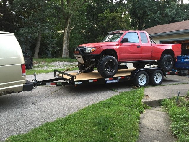

    At least the new trailer finally came in. New trailers pull so nice.
    893EFE24-B958-4EB3-959F-56169082A9AE_zps_2665afac4a6231b613e2acd6803d5edfb209b31b.jpg

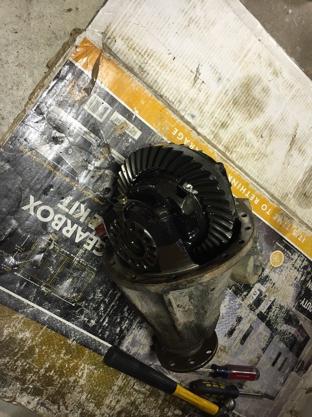

    Friday sheared a tooth off the rear ring gear. Luckily it lodged itself between the carrier and gear and didn't do any other damage. Pulled the third and removed the chunk and ran the rest of the weekend that way.
    E77E8D5E-220B-4C5B-BAB4-29661AD02805_zps_138df10005b13639f1205eb63755ad5d2961f278.jpg

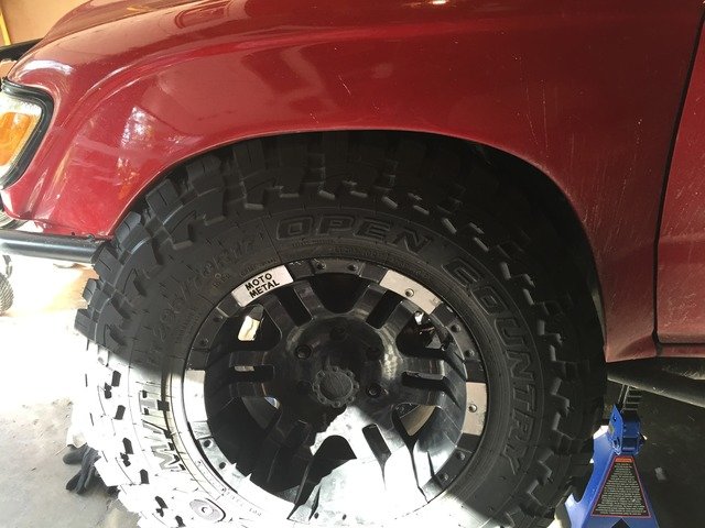

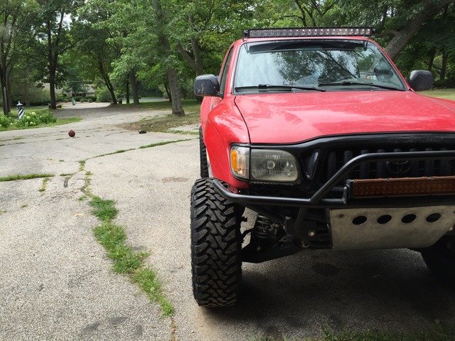

    Also found out the new tires almost clear, almost. Need to do some trimming, at least there isn't that much needed.
    E983575D-386F-49CF-AD92-25E3CEF43B6B_zps_f7885ffb644d6626bdd2504fd8cade7c68f7c34d.jpg

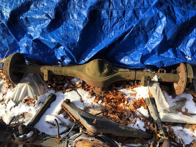

    An econoline 9". Not sure if I am going to use it or just go full fabed housing when the time comes, but figured it would be a good thing to have around.:
    B9161C46-7D9B-4498-8CB3-F26349F06DCB_zps_53c2a732e0c2da31c27896b13534d814d4e040b0.jpg

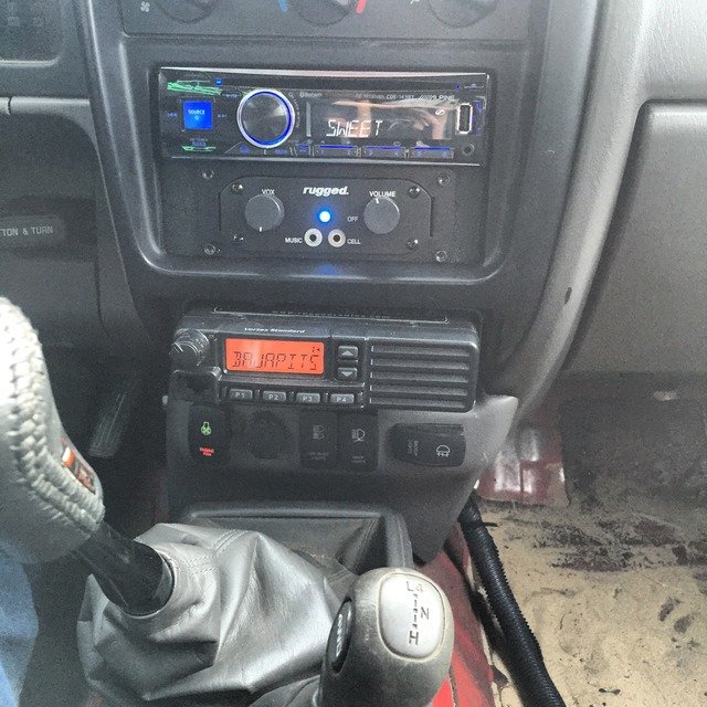

    Installed the Rugged Radio stuff yesterday. For some reason the intercom is not transmitting out on the radio but I can receive radio transmissions on the intercom. The radio calls out fine from the handheld mic.
    3D2413D2-966C-467D-B347-695337E03111_zps_77644ff030f570cbca68a42b654f5beff4cd8766.jpg

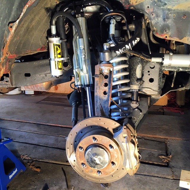

    Shinny parts. ADS 8" travel triple bypasses.

    Will you be able to use those with the stock LCA shock hoop?

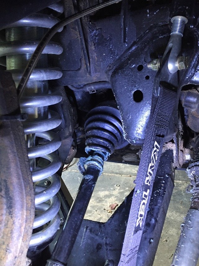

    Yes, with were my truck bumped and strapped it would have worked. The travel was not setup to match the coilover exact so I ended up cutting the mounting tabs and welding new ones on. The hoop was alittle high so I used a set of longer tabs to place the coilover and the bypass at the same place in there travel.

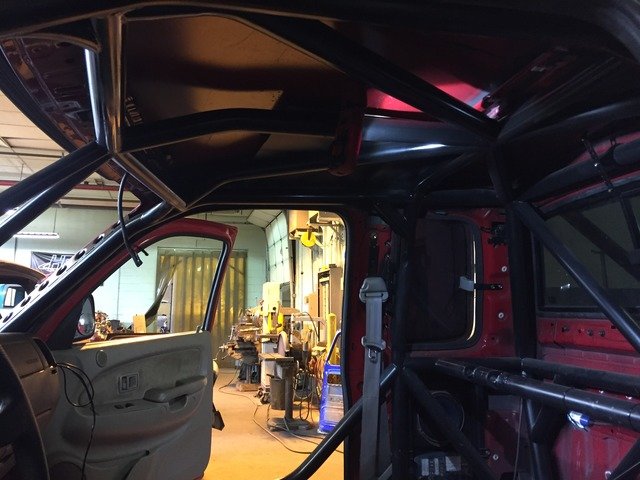

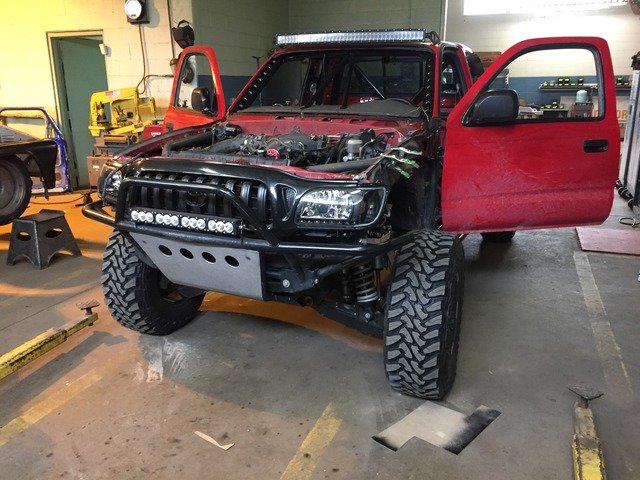

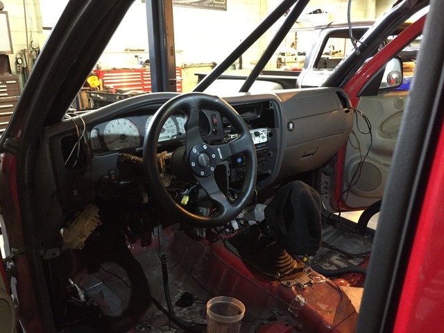

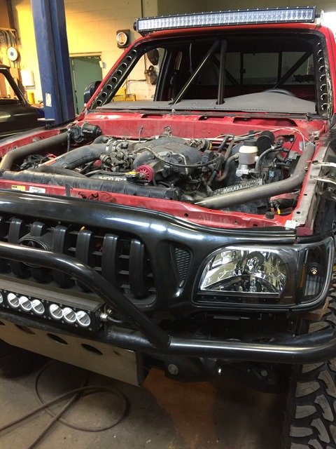

    So after a few transmisions and rear end decided its time to build a traction bar. Took the truck to Halo and we got alot more cage work done, but didn't get to a trac bar.
    Let me know what people think.
