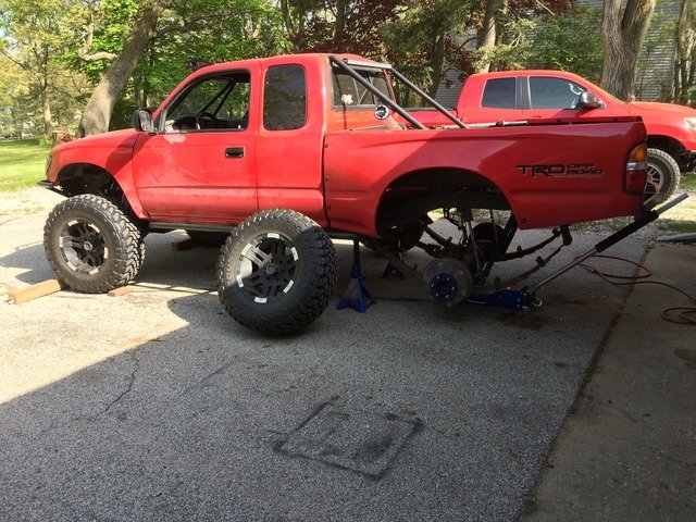

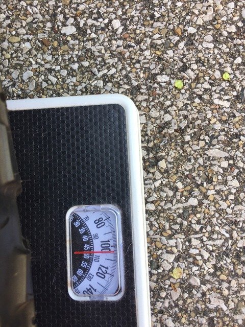

    So I was prepping the truck to hit the dunes this weekend. I decided to weigh a wheel and tire. I attribute breaking so much to how heavy the wheels and tires are and the traction they get.

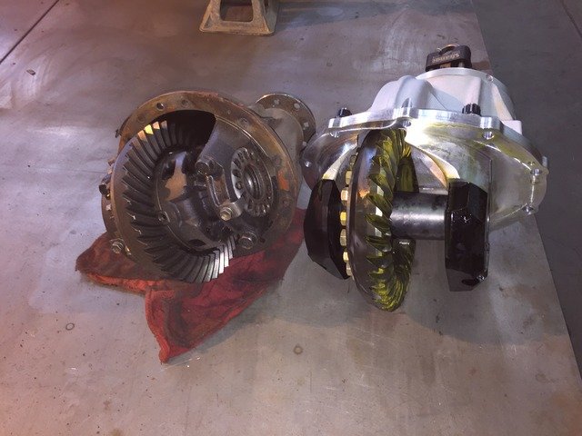

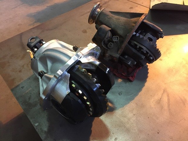

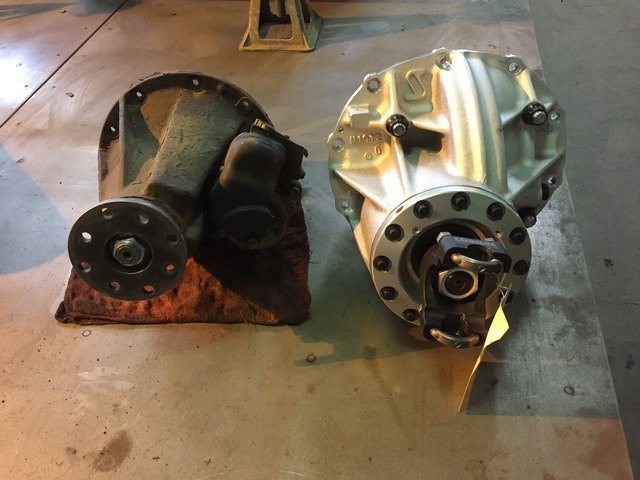

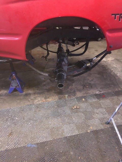

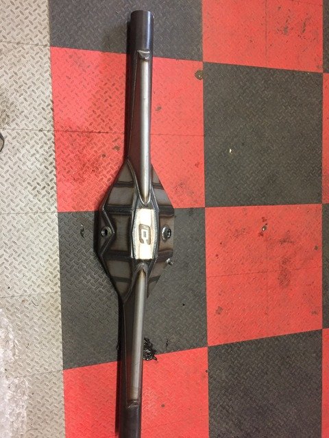

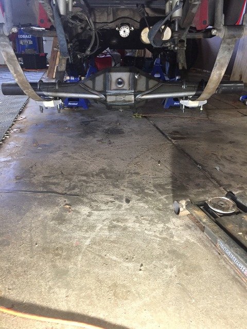

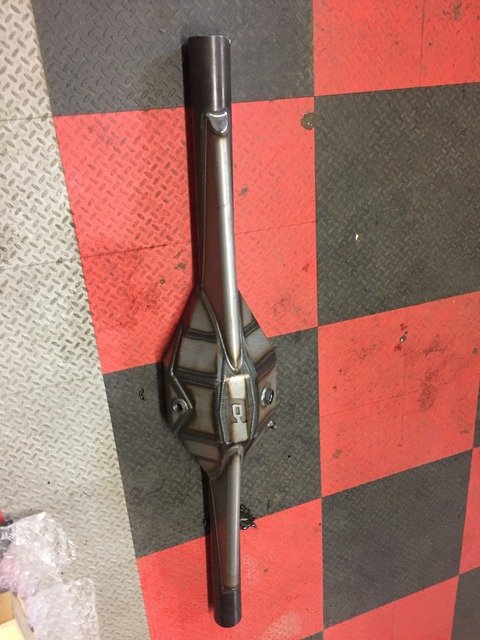

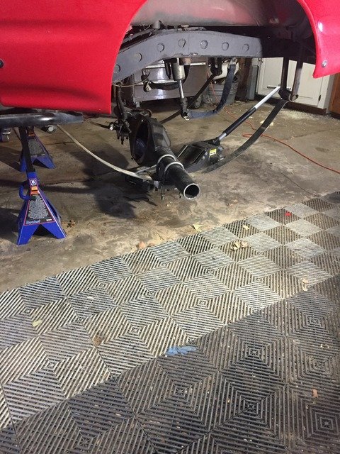

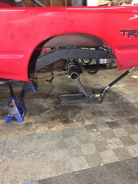

    So after alot of broken rear end parts and a bent housing this should fix the problem.
    A52469A1-D299-4D70-8872-B5D22CB55984_zps_692e2e6b98044134ad5624d2b511e7a211eed108.jpg
    33FC1F58-AAE0-4AC6-BDD1-566967B38458_zps_26b37452bf4b8c0f432eacf064bac74954830a35.jpg
    DA48E41D-A38F-4089-BFCD-4E07A7FAE384_zps_af951562ca55a2d28f501344eeeb0a299815483b.jpg

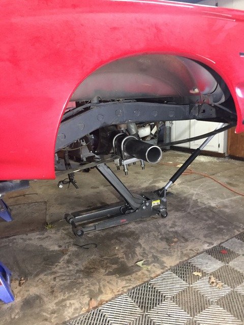

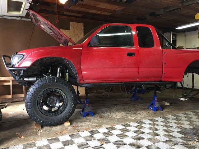

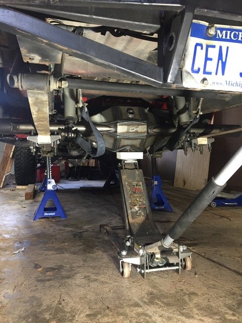

    making some progress. Working on shock mounts and bumps.

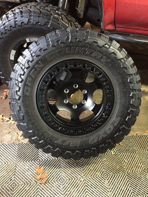

    Had to get new rims to fit the floater hubs.
    KMC RG Race beadlocks
    D220FA2A-94F6-45CB-97E1-4B91A229FEDF_zps_84f8e8ea08617f709c1135b1cb4ebd3544a6ffc9.jpg
    87D62C27-6B3B-4B65-BCC7-20C6CBFF5FCD_zps_6671051787c91d7c56380421bd572f8369aab3a4.jpg

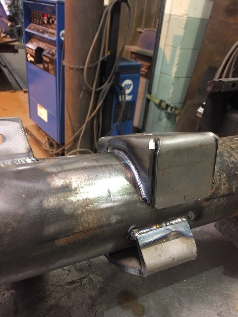

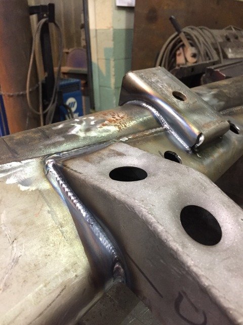

    perches, bump stop pads, and shock mounts welded up.
    A93B1CCB-296A-4123-ABBB-6CA4E7907E1F_zps_4db946072bc882a04b01d84cdaef8f5a32c99fd1.jpg
    40D87B1C-480D-4FCA-8BB8-D2C8C77E4C6D_zps_1877e58a3d4833d6e08cd57bff336170552f5a02.jpg

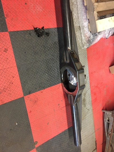

    Strange ultracase with a 9.5" gear

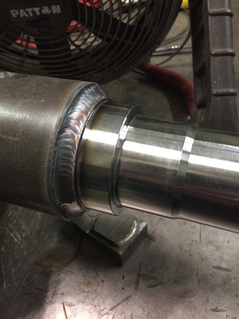

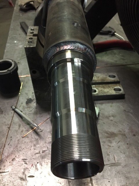

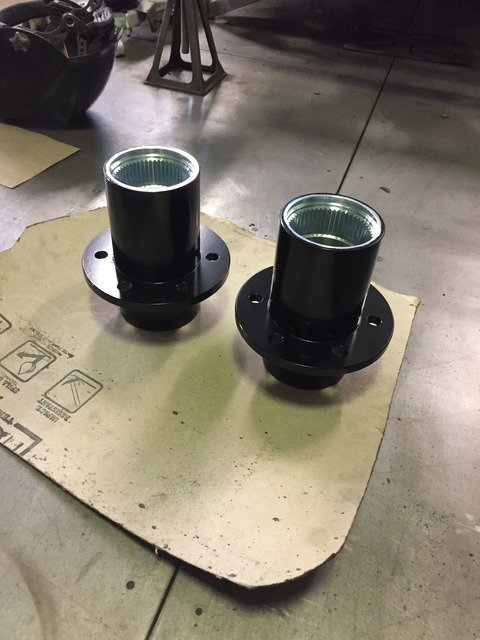

    Solid axle industries floater kit snouts welded up and hubs powder coated.
    4DC73610-1E0E-49E5-A995-14995BF6F9F1_zps_b2f9f8f88267a0bbd36b3174a47f261fbb4d7b29.jpg
    774CD73D-6B0F-4109-900B-C4558AC72027_zps_d821adff586a4a74f68af110b3ff5d8a49f98699.jpg
    1FF091FF-6DA6-4352-802F-854DE606C513_zps_20e428d92b10675430d971d46218e0aee7669b57.jpg
