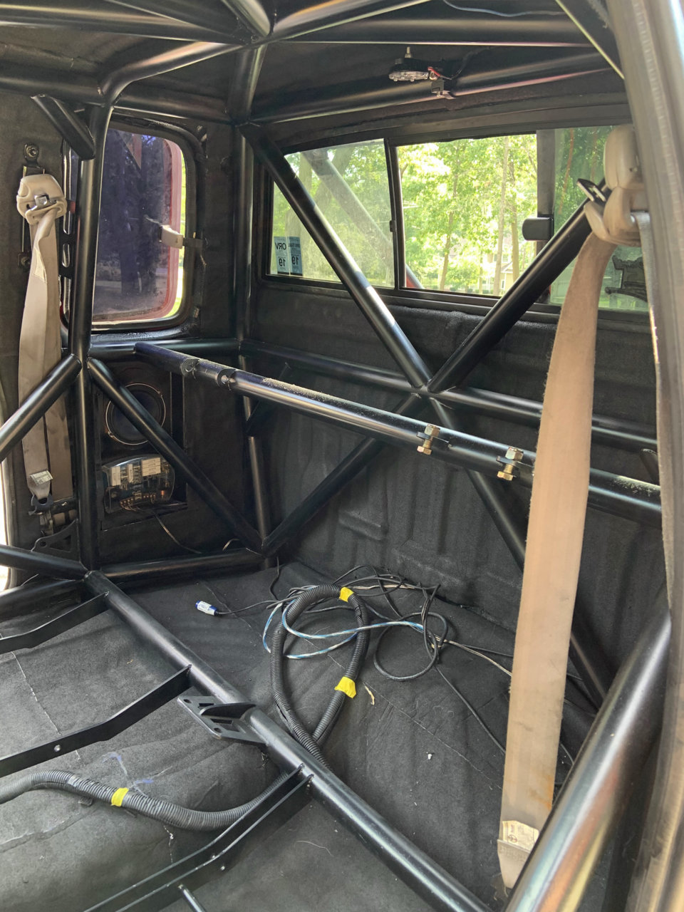

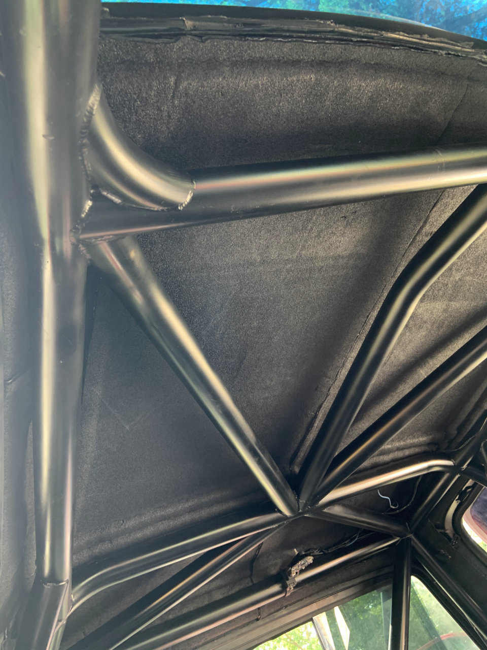

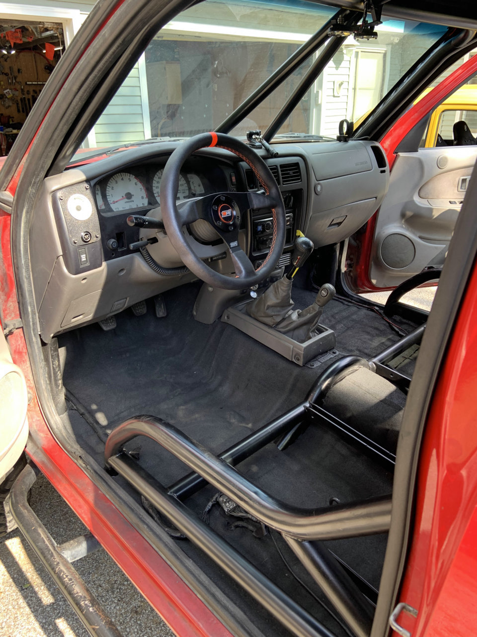

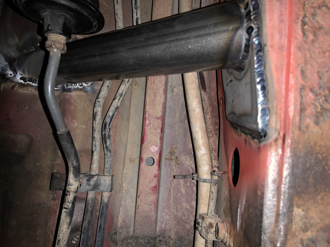

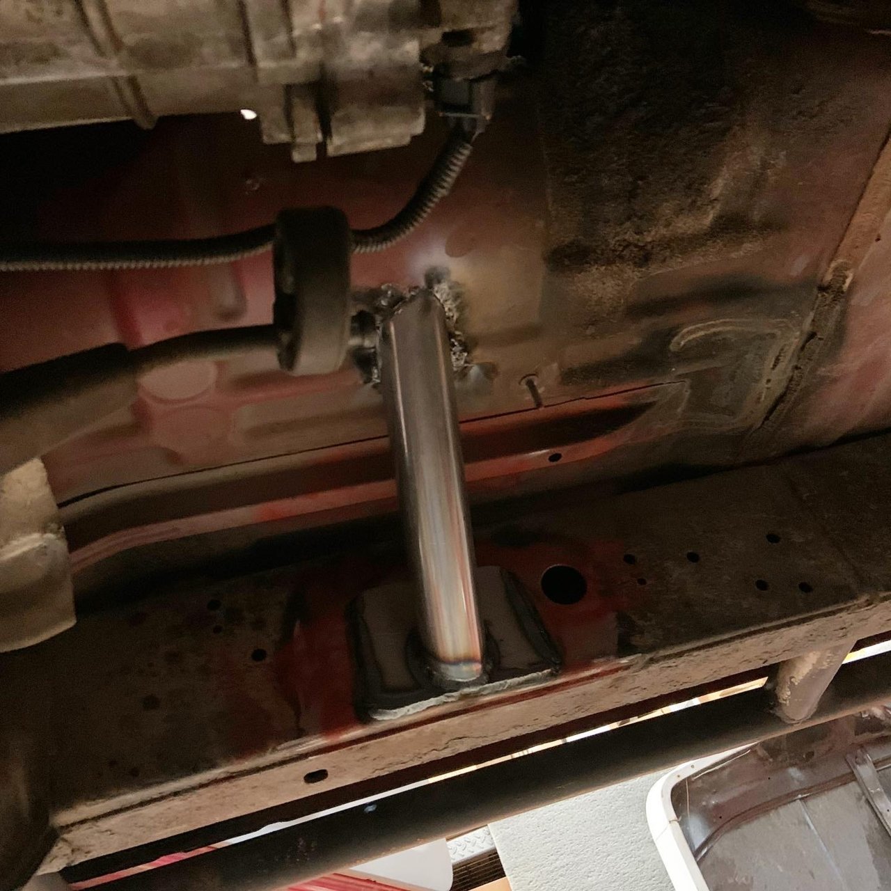

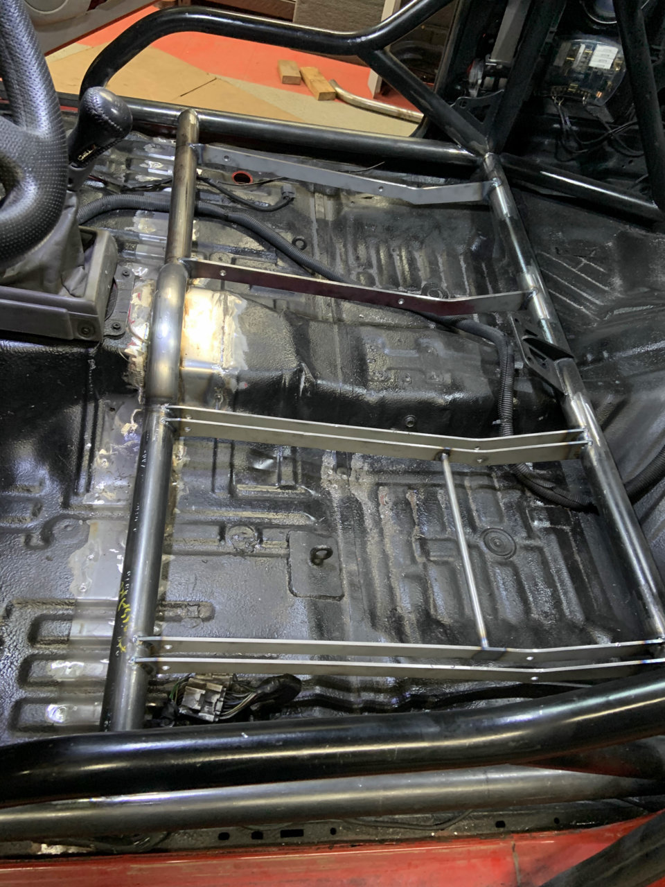

    Last season we added some tubes for better seat mounts and add a kinda crossmember at the same time.
    Also finally Lizard skinned the interior and covered it with Eastwood X-Matt Dense Matt.

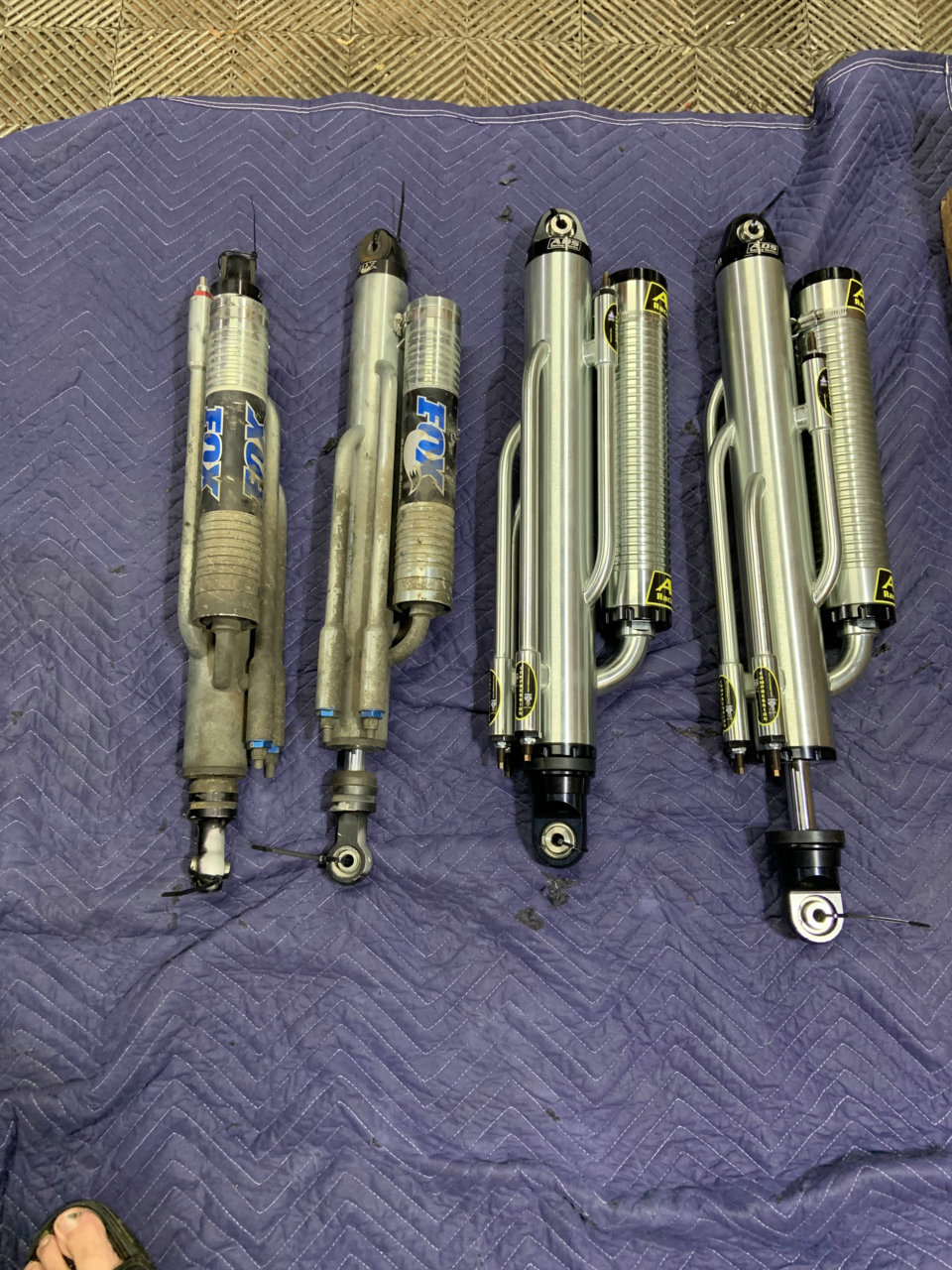

    Switched the rear Fox 2.5 3 tube bypasses out for ADS 3.0 5 tubes.
    Slashaar, malburg114 and Trigo like this.

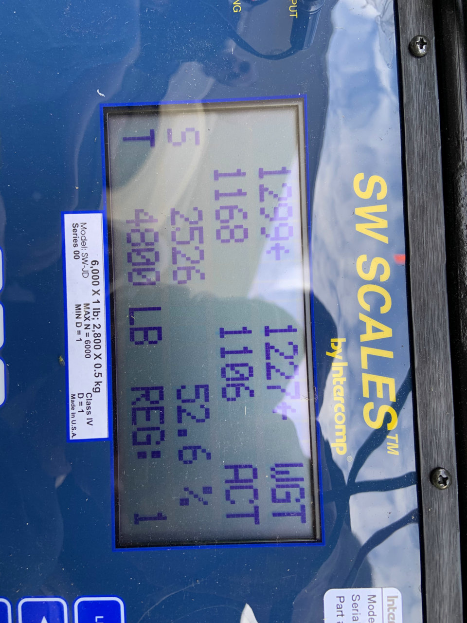

    Put the truck on the race scales.

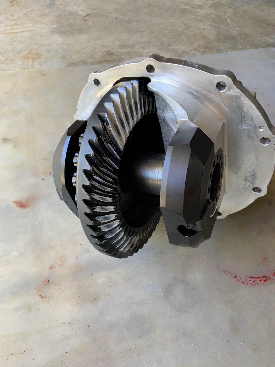

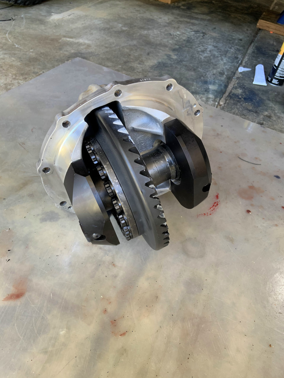

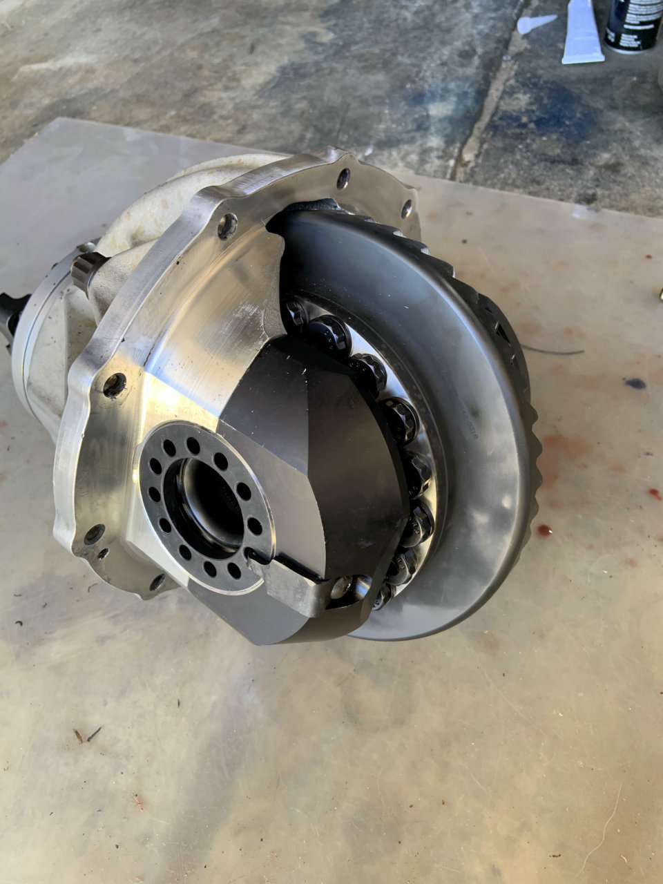

    Switched to a 10" lightened 5.33 Motive race gear.

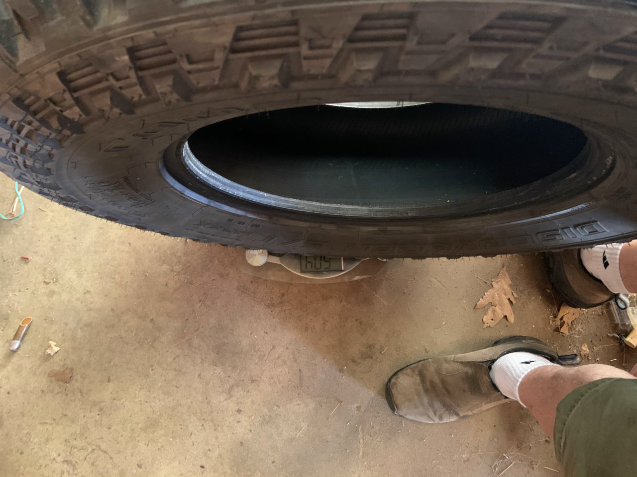

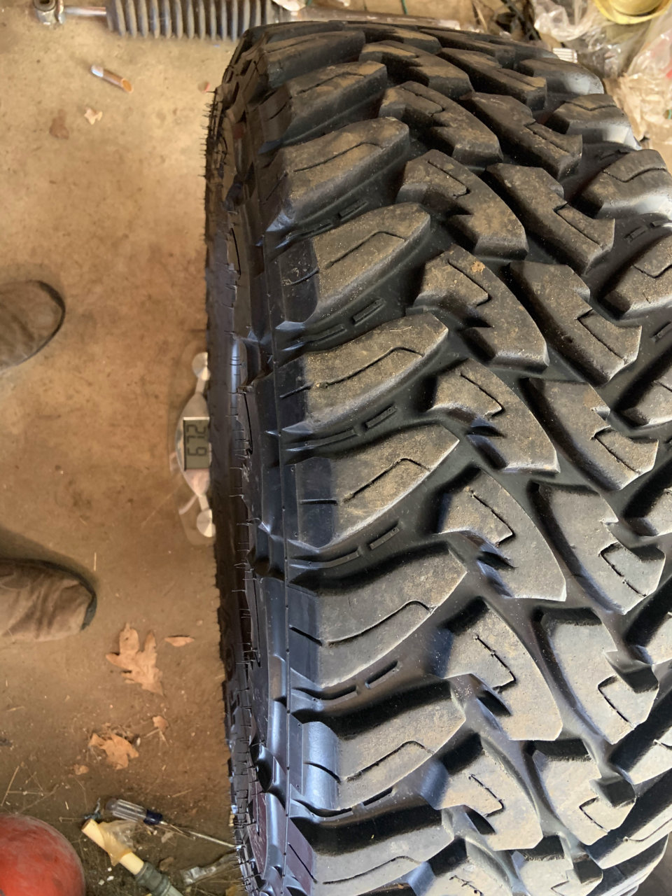

    For years I have been working on trying to get transmissions to survive more than a season. I also decided to try another set of lighter less aggressive tires I had to see if it would help. Shaved almost 7 lb per tire both same size 295/70-17
    Toyo MT 67.2 lb
    Copper ST Maxx 60.4 lb

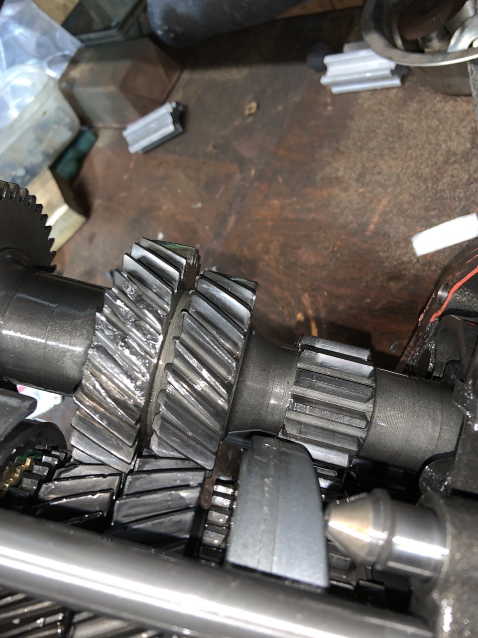

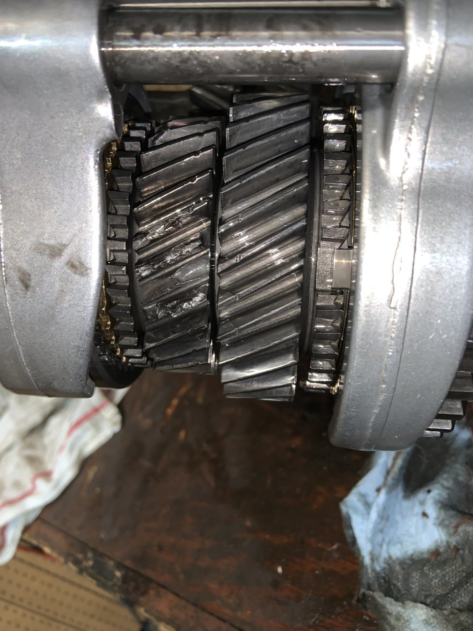

    Are you running an R series transmission?

    Yes R150F and 3rd gear always ended up like this. Pulled this one apart before it was total junk
