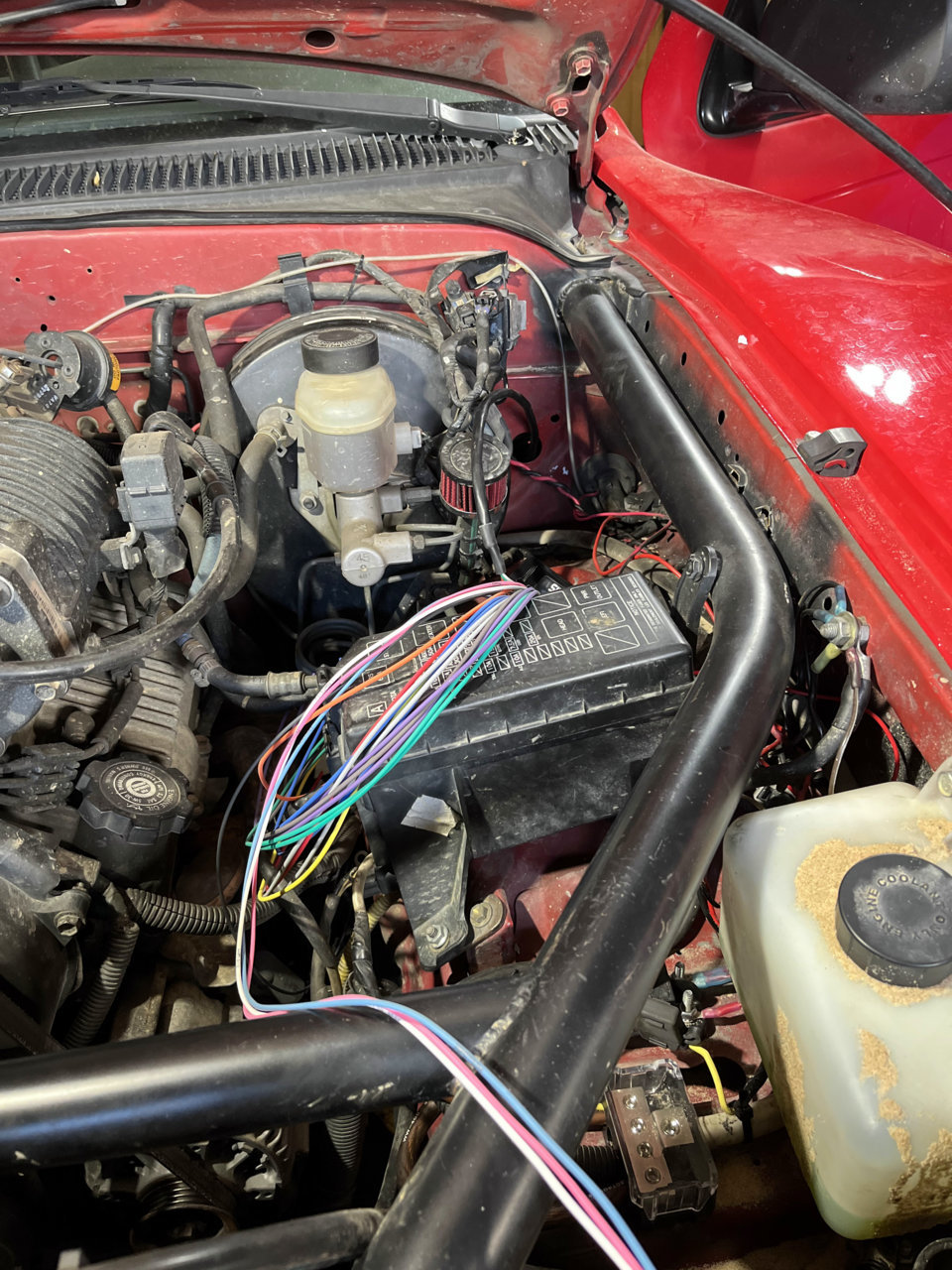

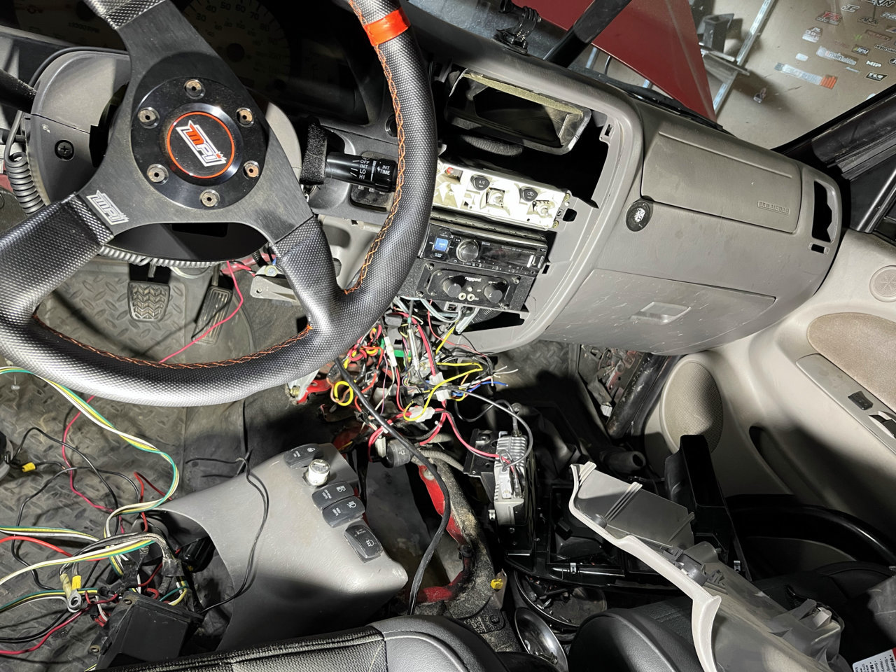

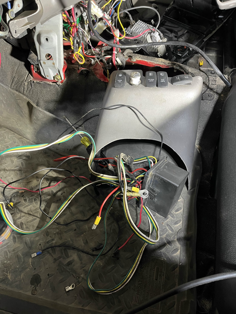

    So I was making progress on the auto swap but things seemed to snowball. Somehow adding a switch for the trans cooler fan has turned into rewiring half the truck. I am actually going to install the switchpros I have had sitting on the shelf for a few years. But now I am doing some wiring and installing heaters in the garage because its cold in Michigan. Should be back on truck wiring this week and get that done and get can back to installing trans temp gauge and switchpros panel.

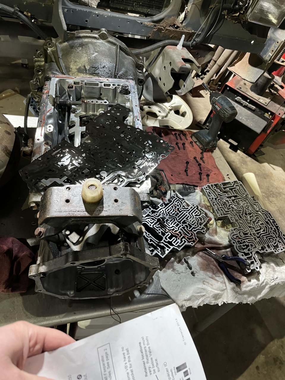

    Putting a Transgo shift kit in. Setting it up for the most aggressive setup. We will see how this 180,000 mile trans holds up.

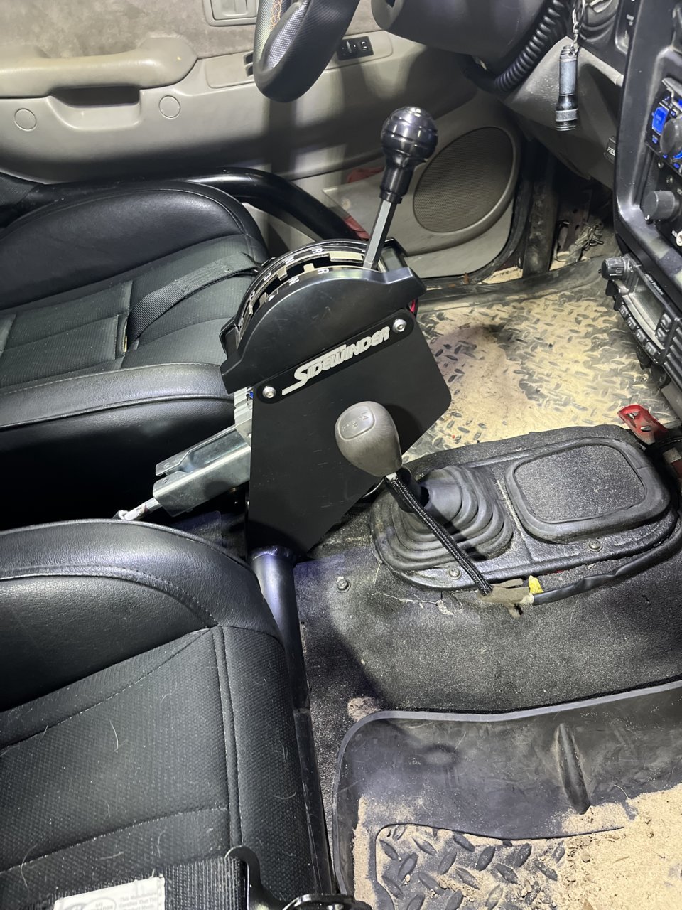

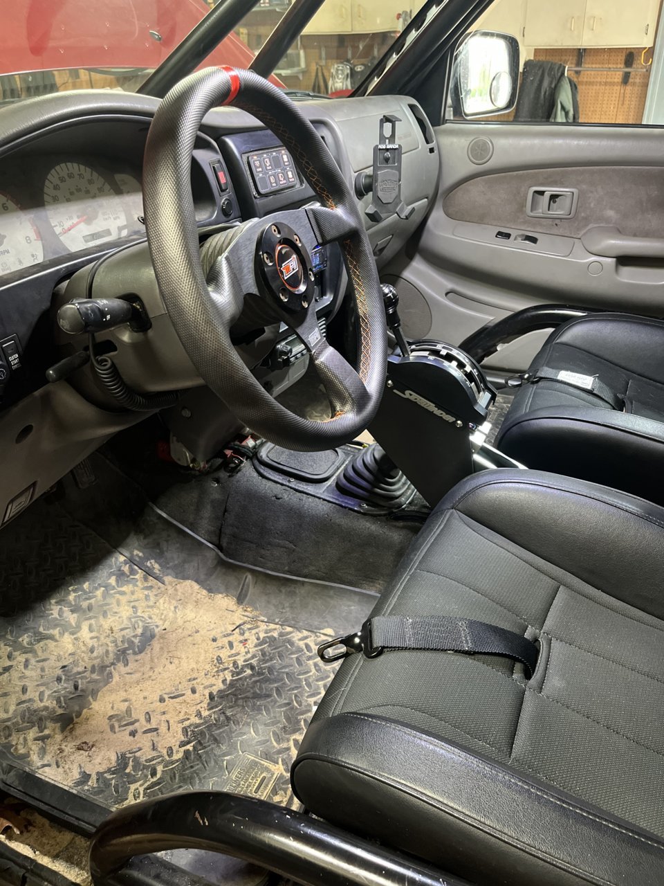

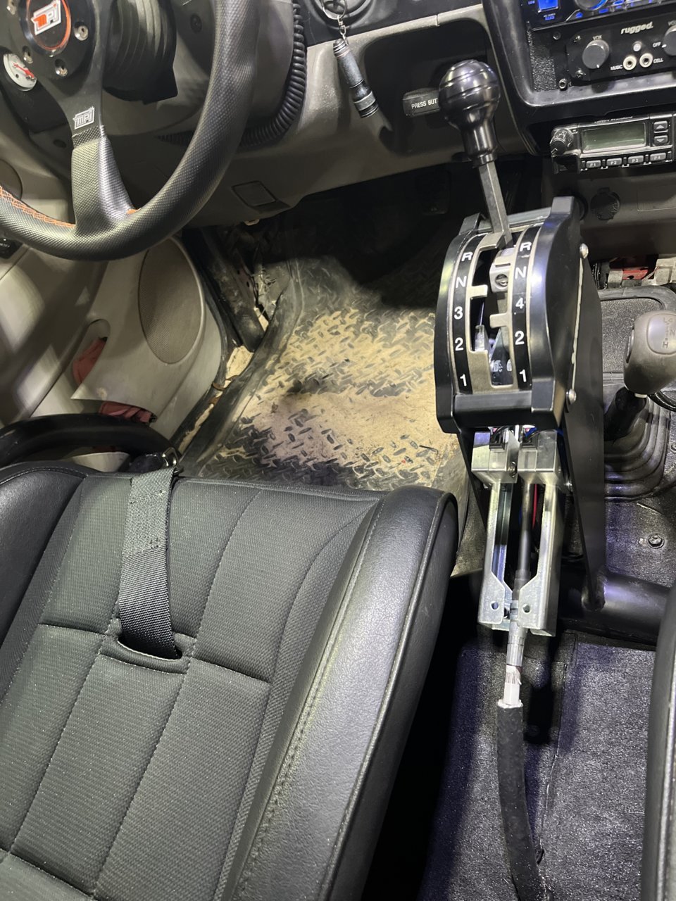

    Some pics of how i mounted my shifter. I used mounting plates from wide open designs. Worked out great with my seat bar. 15246ECC-ADD7-4524-8D0E-371DBF7CE192.jpg 3ACE4C2F-D520-4C67-A56C-C1418A013812.jpg C3BDACBA-30D5-4C0B-93FB-C54F5BDE2A42.jpg

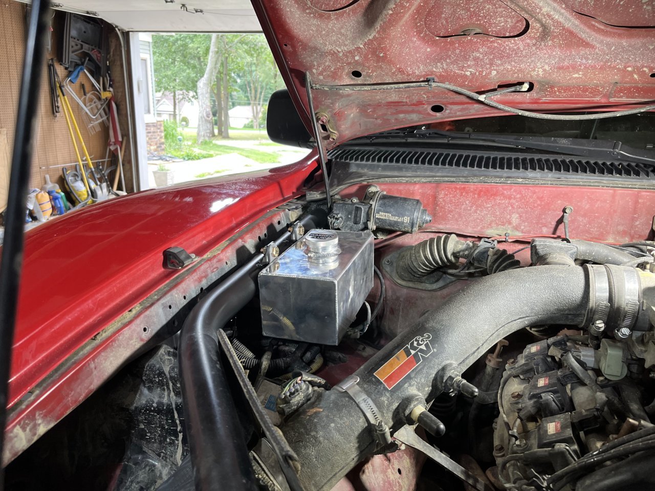

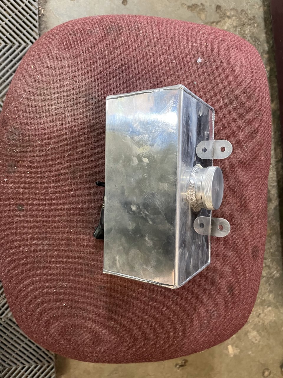

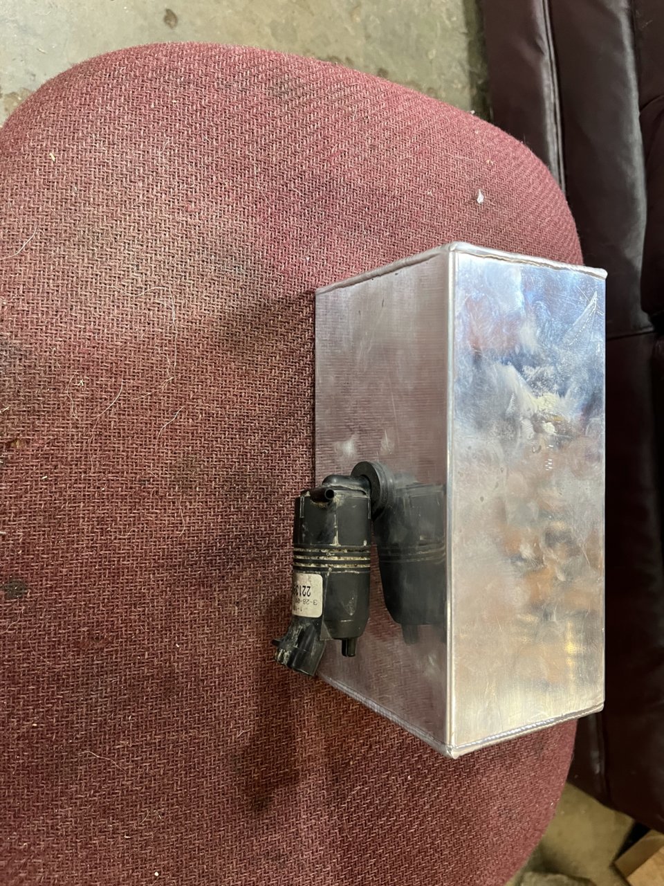

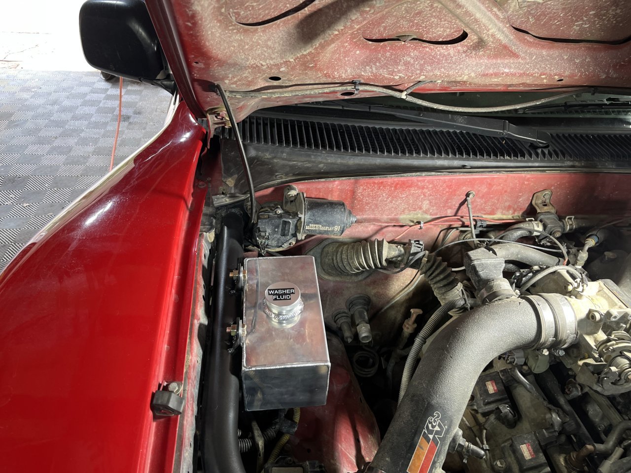

    So I got sick of not having a windshield washer tank so I came up with this. Its a cheap Amazon tank I just drilled for a larger hole to accept the stock pump. A few tabs on the cage and I have squirters again.
    https://www.instagram.com/p/Cguve-bpxpi/?hl=en
