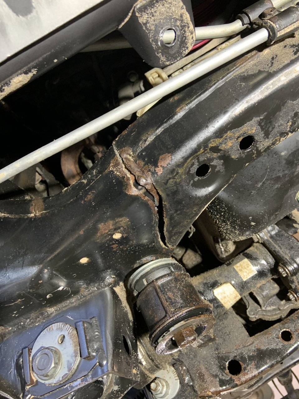

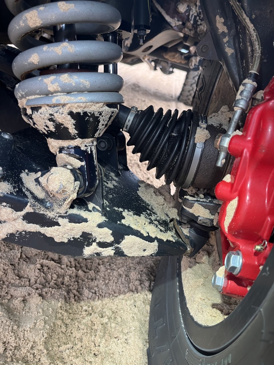

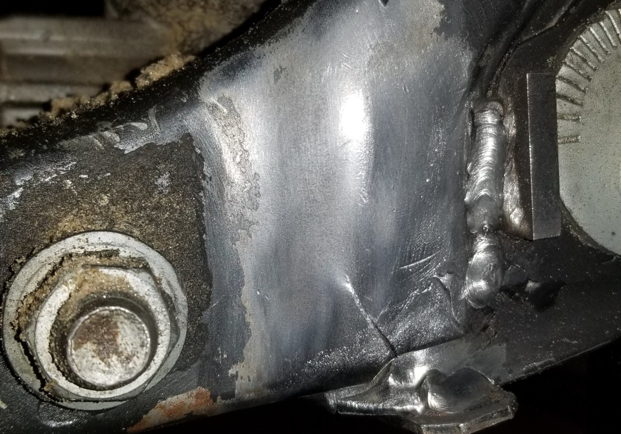

    It was a good weekend at the dunes and for the first time in a decade I can say I made it the whole season on a transmission.
    Unfortunately there was a fair amount of carnage.
    The first day I broke the lower control arm. Unfortunately from the looks of it alittle prep would have prevented this. You can see rust on part of the crack. It was actually holding strong so I drove it out and pounded it back welded it in. These arms have survived breaking and rebuilding and plating in the Coil buckets and Frame, even when I sheared off the coilover bolt on the bottom tab going thru a whoop section at speed. Not to mention hitting rocks at offroad parks and stumps at the dunes. I still hold these are the stongest LCA's on the market and I believe I have proved that over and over again.

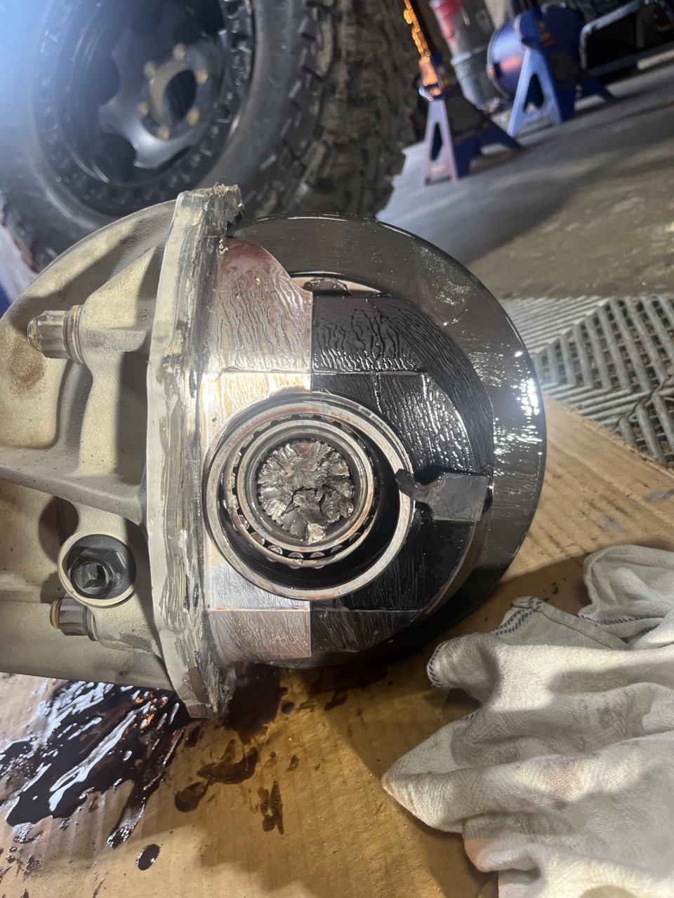

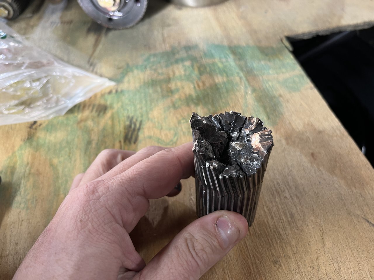

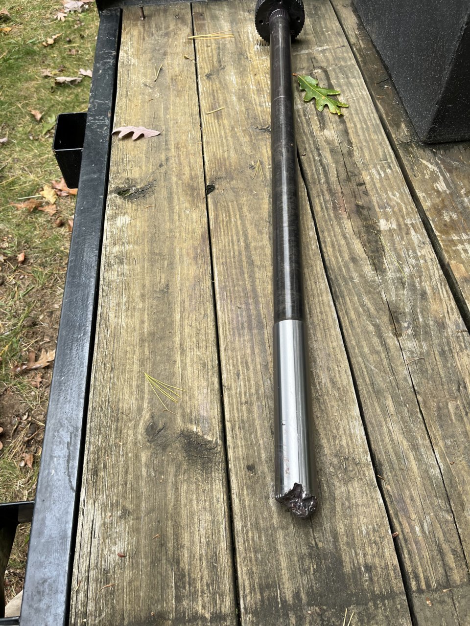

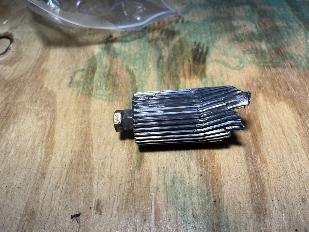

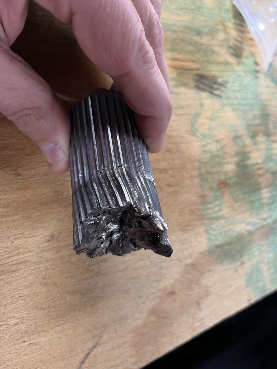

    Took my rear end apart and cant believe how the shaft broke. It is twisted and stress cracks in multiple places. I would have thought I do not make enough power to do that to a 35 spline.

    What kind of rear axle do you have?

    Is it a power thing or shockloading?

    My shafts are Currie chromoly. I am going to get 300M shafts made.

    you are right it most likely is shock load. I am just surprised there was not a weaker link somewhere down the line. Oh well guess its time for 300M axles and see where the next weakest link is. At least its not a Transmission that breaks anymore I guess.

    Considering how hard you huck that thing it's damn impressive how well it actually stays together at all :rofl:

    Was going to suggest chromoly but you already have them.

    Edit: just skimmed through where you put in that rear axle... im suprised you broke it, definitely load and unload stress from over time.
    Another edit: how did the diff hold up.

    The diff would have been fine but the axle destroyed the preload adjuster and the race came out of the bearing. So not to well.C30CCB48-CFC9-47F8-A158-474D8C406783.jpg962C7A3F-04D8-4389-B4F7-1D997179CA26.jpg
