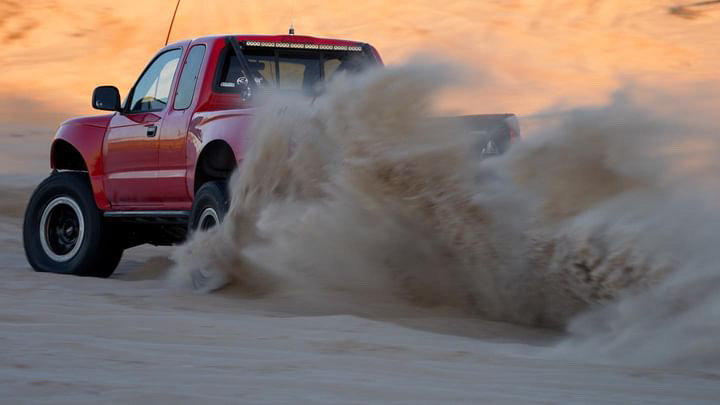

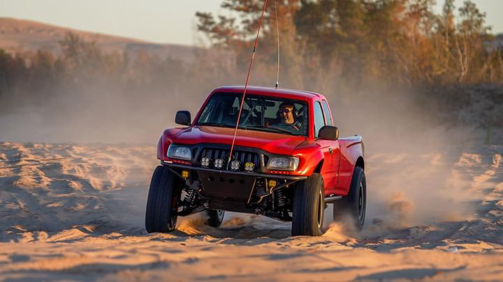

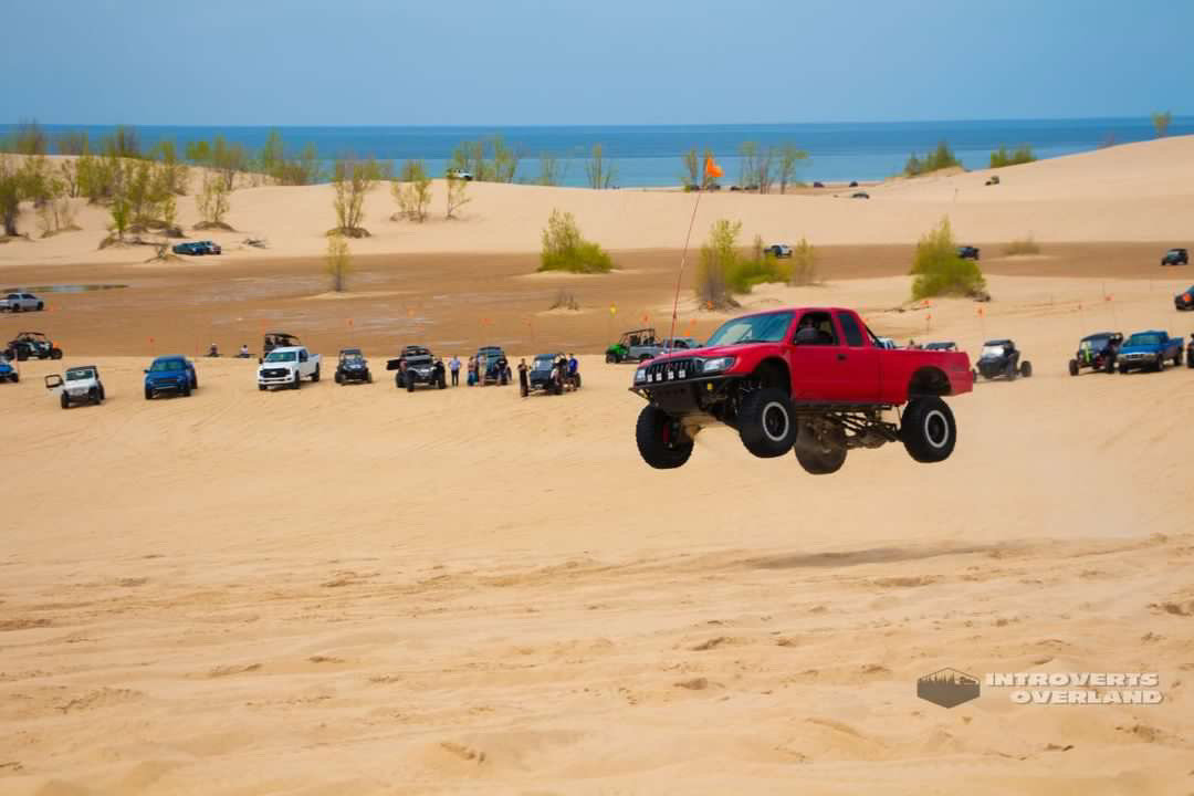

    Well the truck went to prerunner invasion with a list of things broken and came home with a list twice as long. I did get alot of sand miles in and alot of good air.

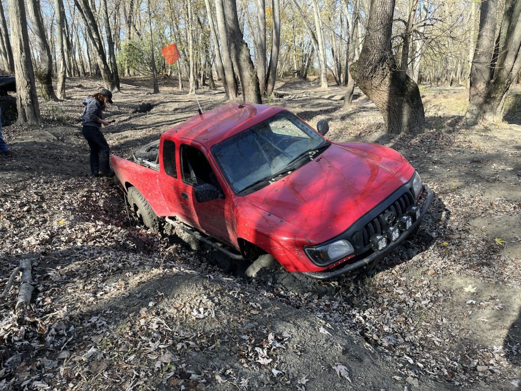

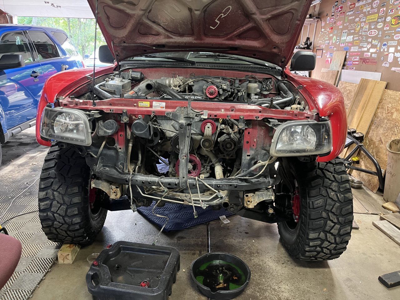

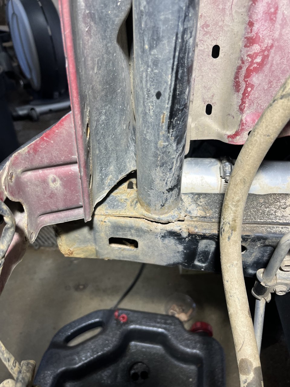

    Started tearing into the truck. And this list is:
    -radiator and fans
    -fix broken header collector and redo some exhaust
    -weld cracks/ plate and add a cross tube on frame where engine cage lands
    -fix coilover retab control arm
    -add more engine cage and coil bucket/ bump stop bracing. Doubt i will have time to move bumps to upper but possibly.
    -new seal on the rack that decided to start leaking.
    Figured i would put this here so maybe i will actually fix it and remeber what needs to be done

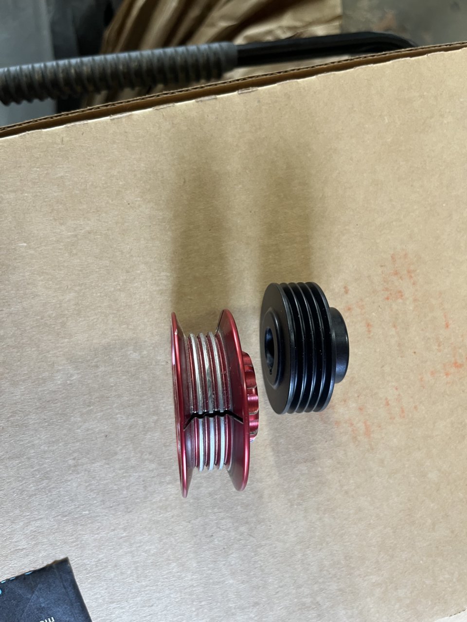

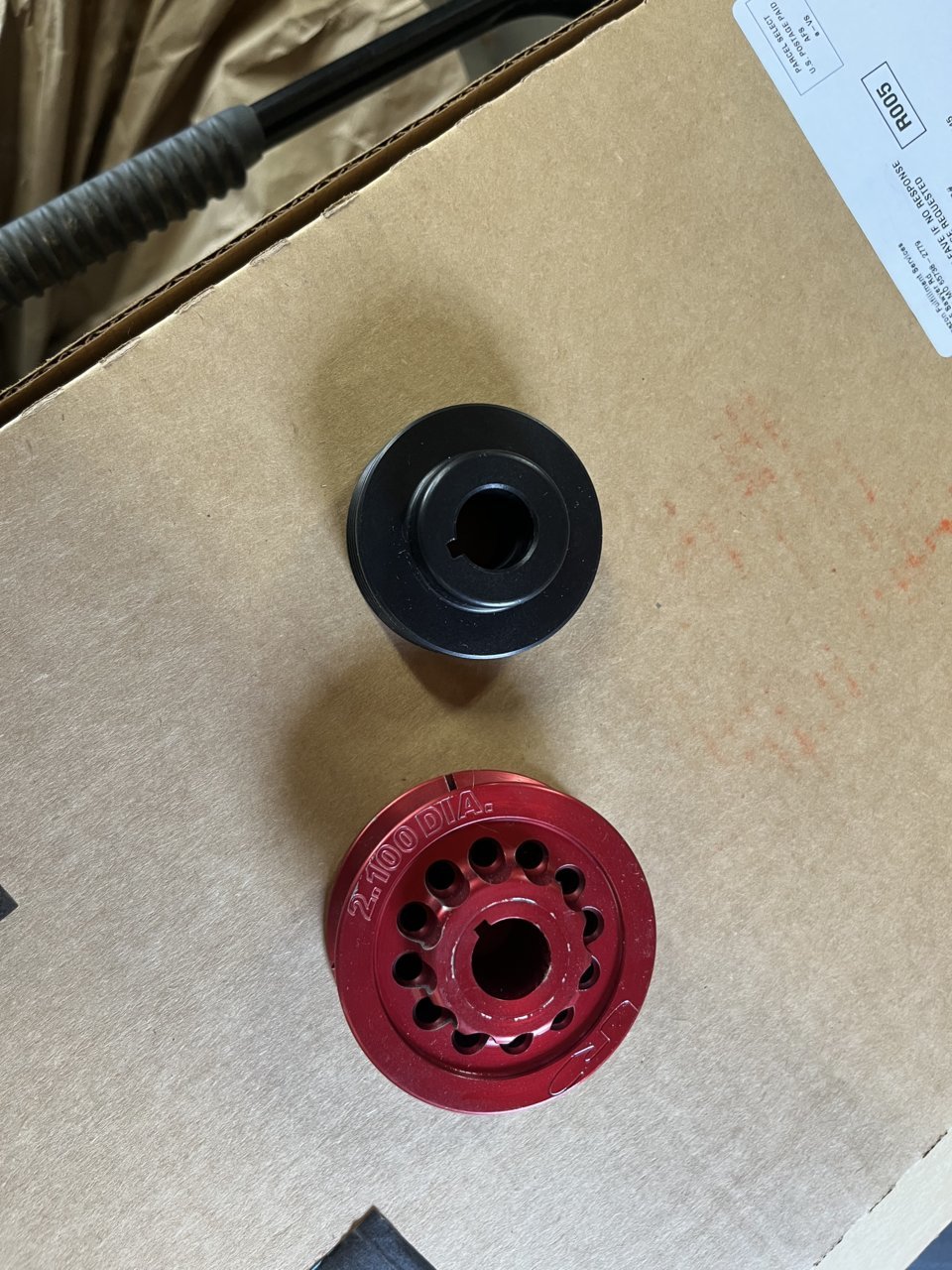

    New pulleyboys 2.1 supercharger pulley. We will see if it last longer than the URD 2.1.

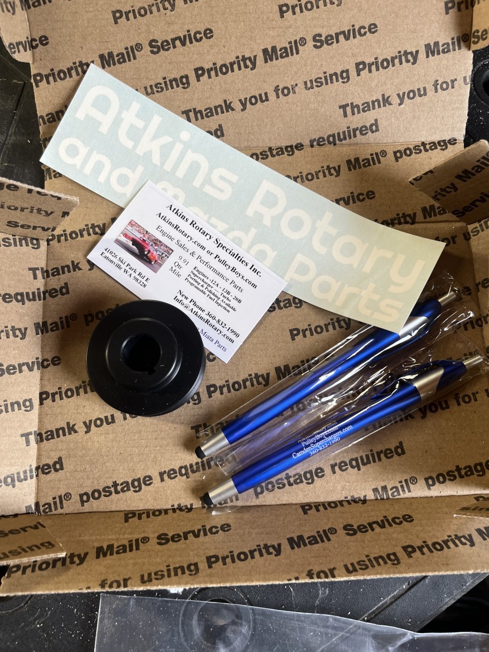

    So I thought the Pulleysboys pulley was going to be steel but after receiving it I realize its aluminum. After looking on there site it says it is : Made from hard anodized 6061 T6 billet aluminum.
    Anyone else think they were steel? Maybe that was a long time ago when I think they only made a 2.0, or at least that is all people talked about.
    It does feel harder than the URD one but time will tell I guess.

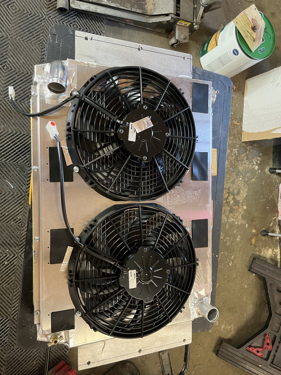

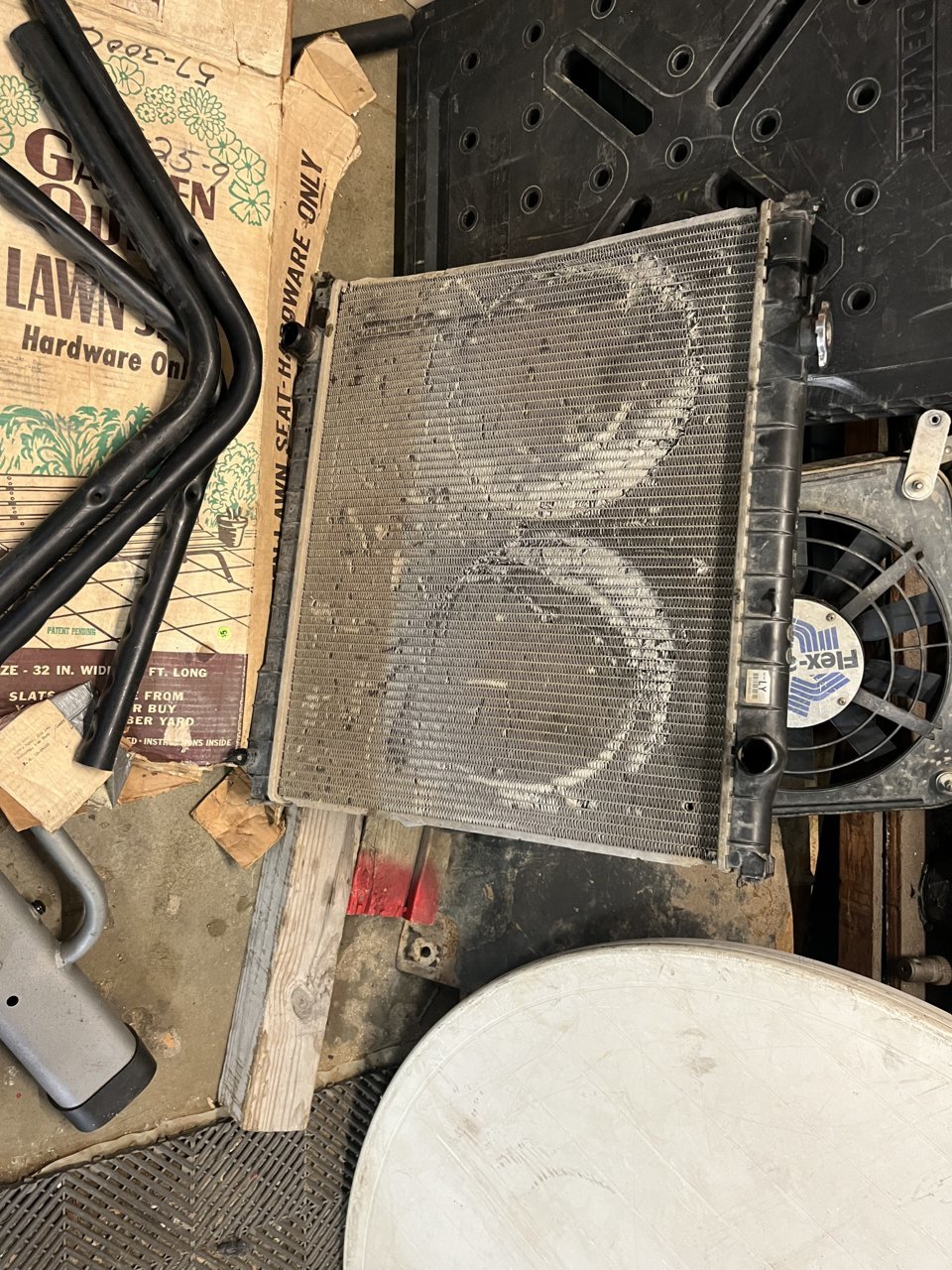

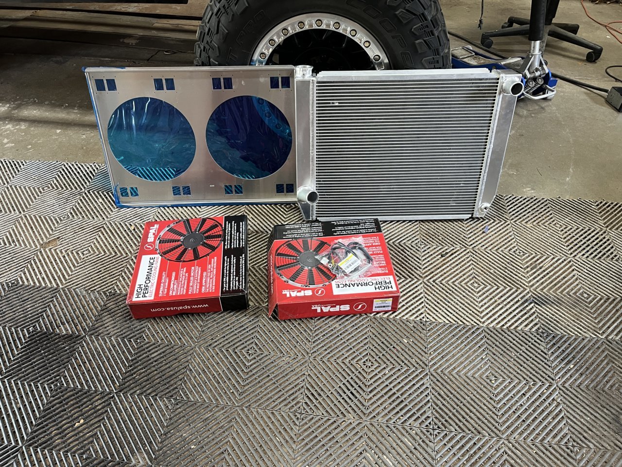

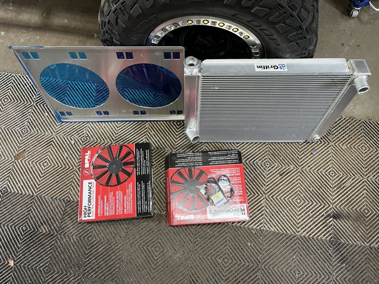

    New cooling setup:
    Griffin 56222-x radiator
    dual Spal 30101522 fans
    Allstar 30064 fan shroud
    Now just have to make mounts and make it all to work together.

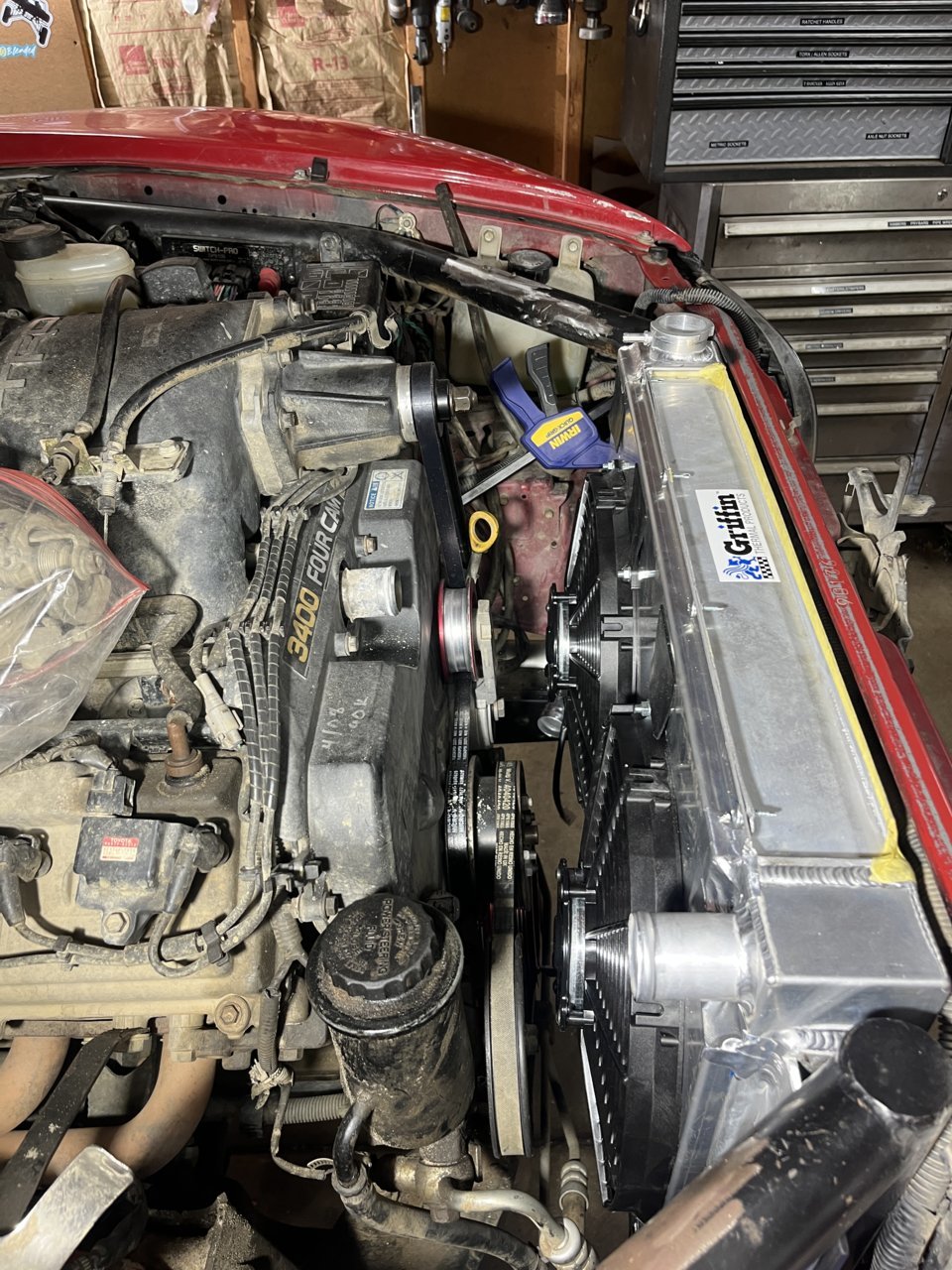

    Radiator is in, fits like a glove.

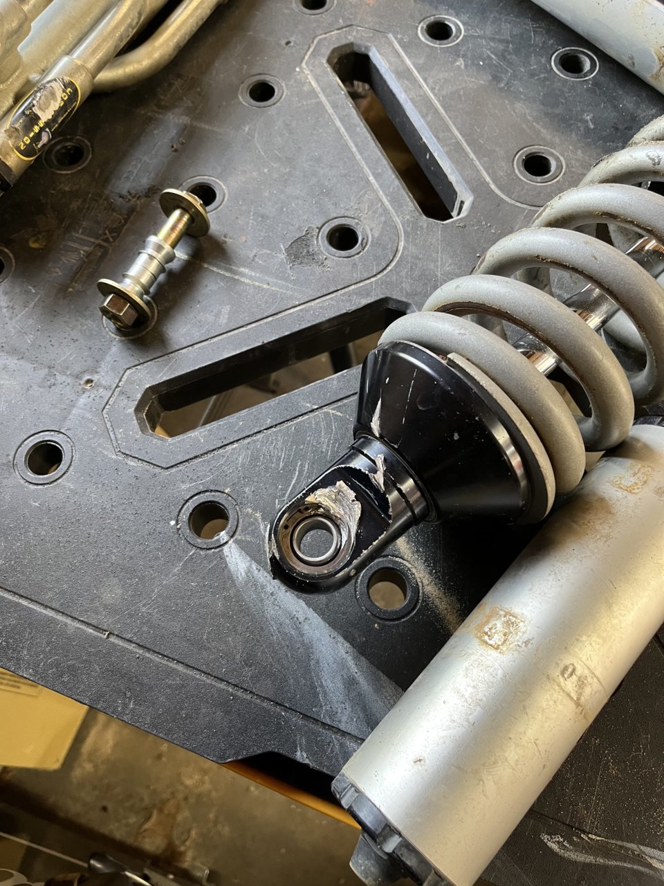

    The list of broken parts were:
    Axle shaft
    Broke the end of the spindle snout
    The shocks mounts are tearing off the truss.
    If you want to see we repair it in this video.

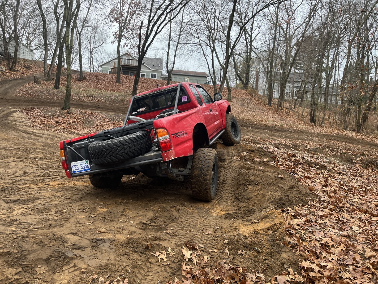

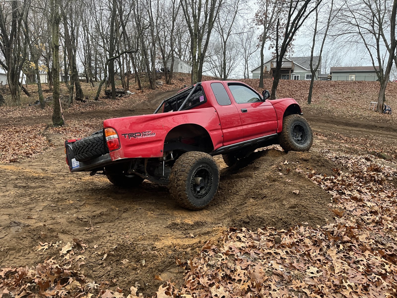

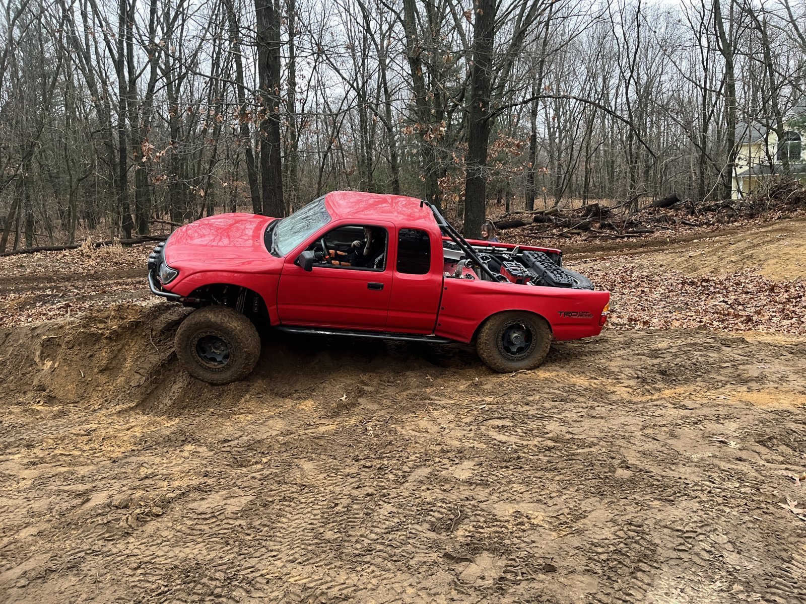

    Screwing around at my house last weekend

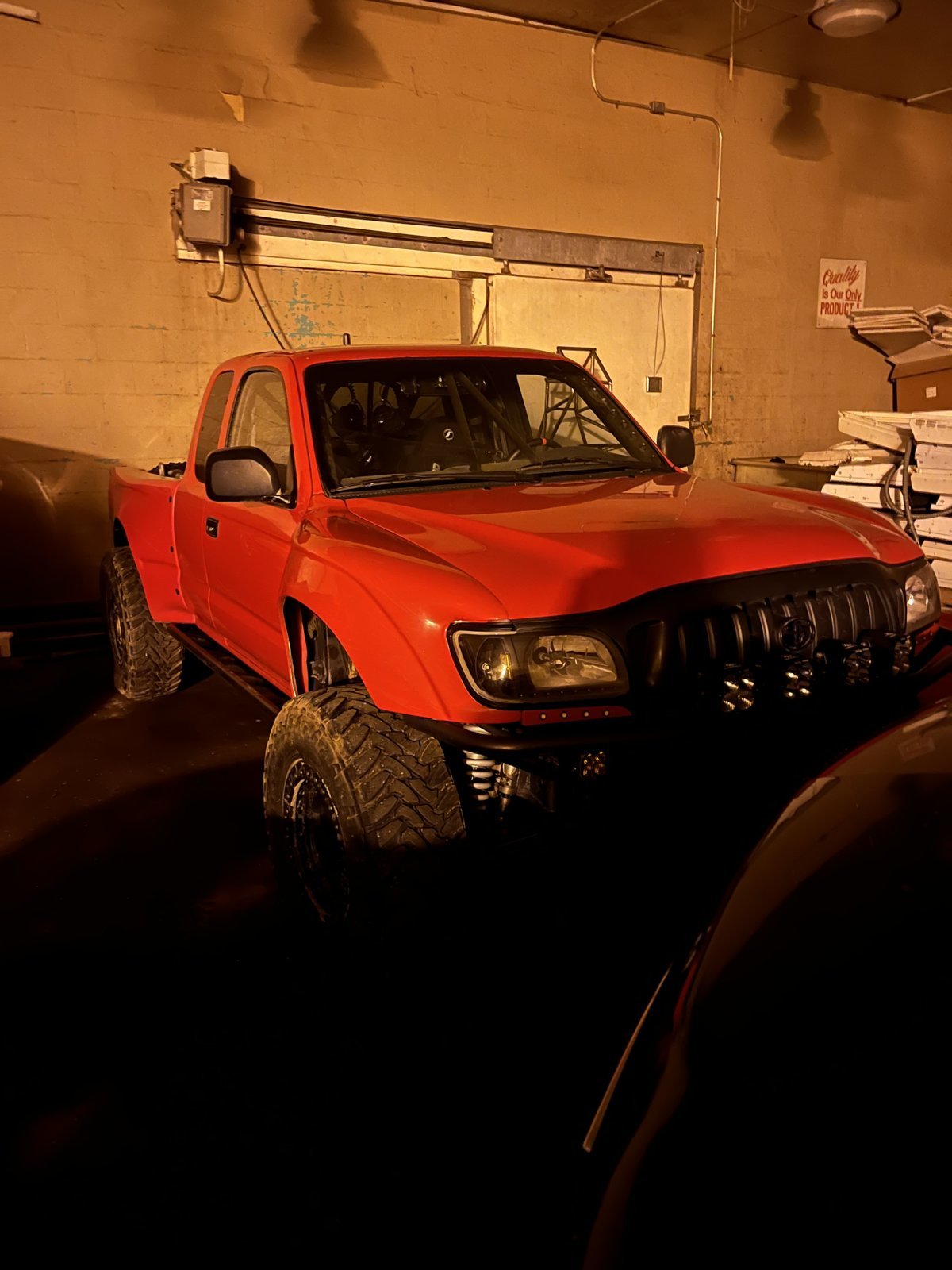

    I guess next week i should probably pull it out of the back of the warehouse i abandoned it in before winter.
