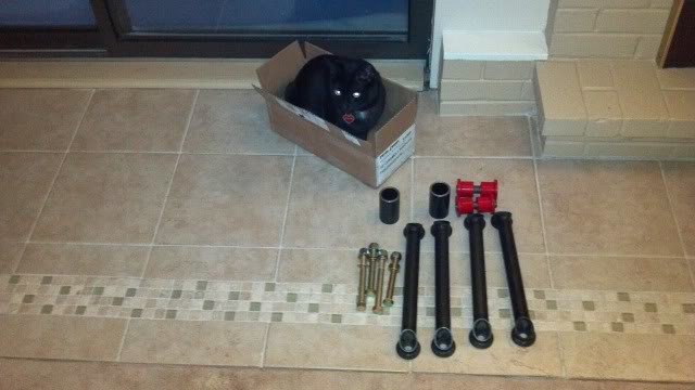

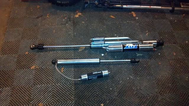

    Look what the cat dragged in today.
    About time to get this thing put together.

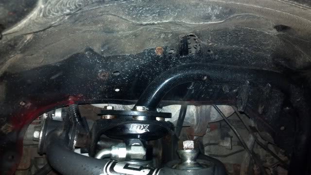

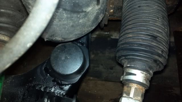

    Today I decided to work on my front bump height. I was allowing alittle to much uptravel as you can see from the holes in the inner fenderwells. Trying to remove the bumps and I found that the nuts inside the arm had broken loose. so I made gusset pads for the bumps that will also raise to appropriate height.

    I also tried to put my 10" travel 2.0 from the rear in the secondary hoop and the compressed length is to long by about .25" to .5".

    Anyhow going from the 2.0 to the 2.5 bypasses should be a big difference in its self. Just the amount more fluid the shocks will hold is huge.

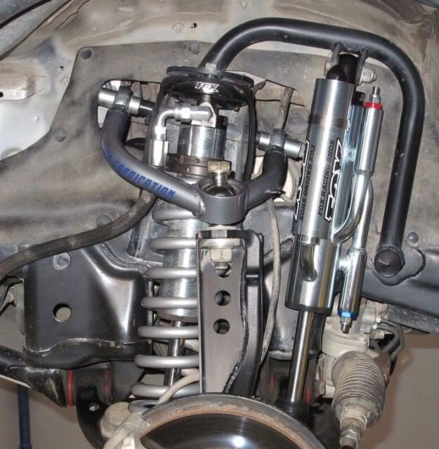

    Found this pic on TC's facebook page. Anyhow for the time being Downsouth is going to convert my 2.0 to 8.5" travel so I can use them as a secondary. At least I will have compression adjustment and the front can be done for the time being and I can concentrate on the rear.

    Figure I had no use for the old shocks and this option is still cheaper than each new would cost. Since I am still planning on switching them out at some point it made sense.
    Cost from Downsouth below:
    New shock bodies: $35/Each
    New shafts: $25/Each
    New Oil: $10 (we can reuse yours if it's not nasty)
    Labor to swap all internals & top caps: $45 Each
    Total: $220.00

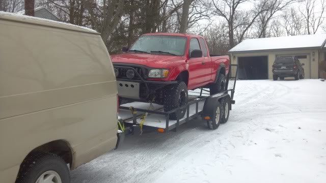

    Ok so alittle update:
    Ive been working on the truck as I got time and havent gotten very far. So after a few nights of waiting for the garage to warm up and getting alittle work done Lenger got back to me and can work it in. So I loaded it up and dropped it off for the next phase of the build. Gave him ideas of what Im thinking and he is going to get everything started.
    say good bye for a few weeks.

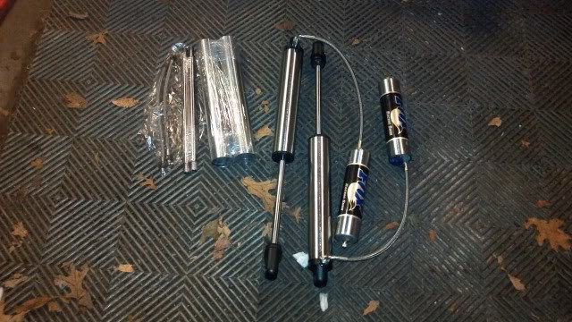

    Got my smoothbodies back from Downsouth. Shortened to 8.5 travel bodies and shafts, 90 degree hoses, and revalved to be run as a secondary. Now if I only had my truck to see how they work out.
