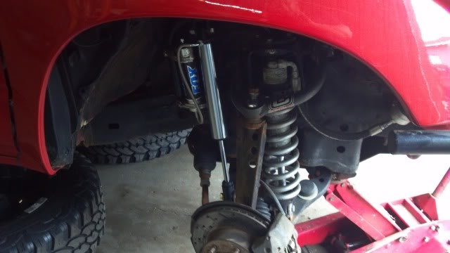

    You know I'm not entirely sure. Havent had a chance to make it up and see how its going. They are going to notch the frame so the airbumps can strike on the Ubolt plate, start the bedcage to mount the bypasses. Not sure what we are doing with the shackles yet I told him to decide. Might make a set of 10" but going to try the 12" first. Then we will test it before we proceed, so we dont wast to much time/ money in that direction if it wont work like I want.

    Went to Lenger yesterday and put the secondary shocks on. Had to run my spidertrax spacers to clear. two trips out in the snow and the fox CO's are super oxidized, oh well we own this stuff to use it.

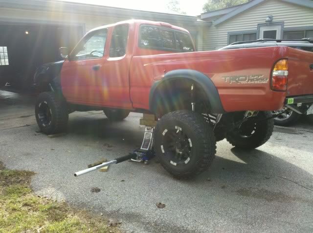

    here is a pic of the bumps outside the frame and the shackle angle with a stock length 3.5" shackle. The tires rubbed the bump can alittle so that was my first motivation for a change.
    Now the frame will be notched and it will be bumped of the center of the ubolt plate, or at least that is the plan.
