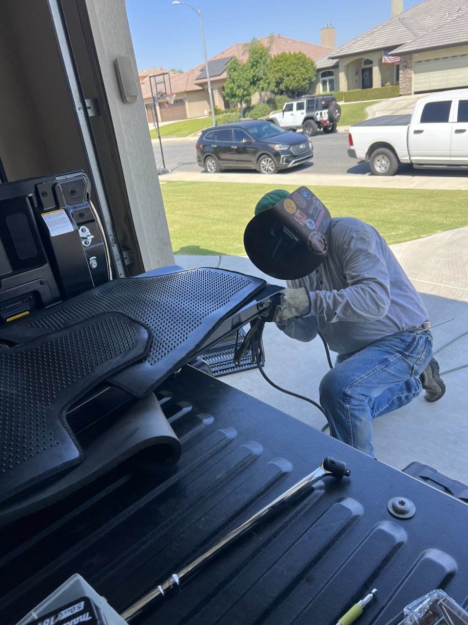

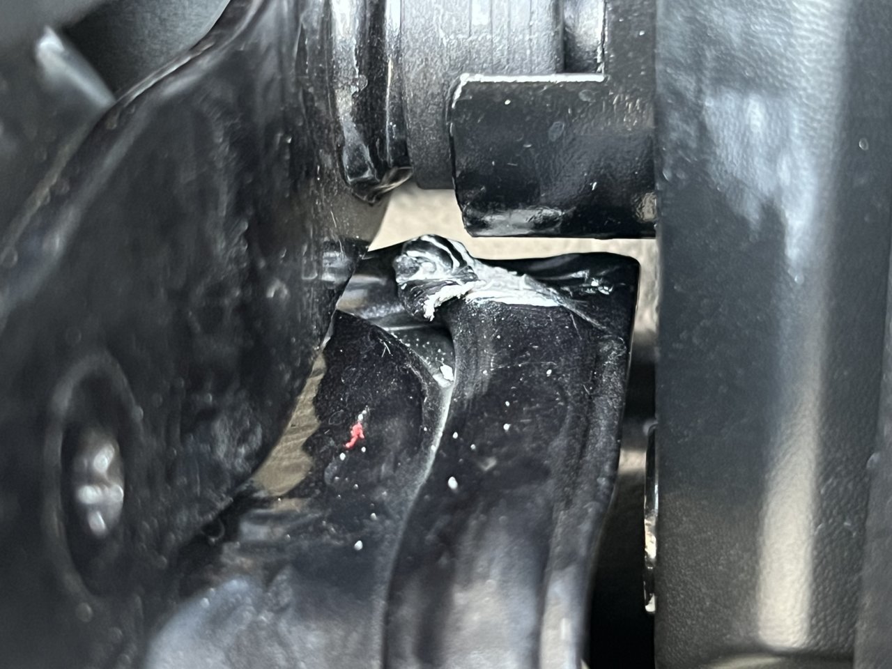

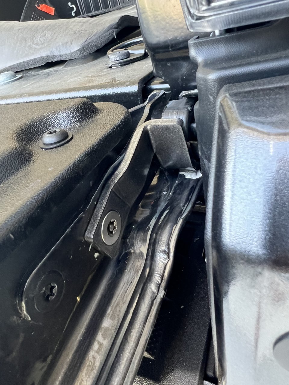

    @christian06 yep, that’s what I ended up doing. Still couldn’t get it out and stripped the screw. Next step was drilling and an extractor, and that still didn’t work. I ended up calling my neighbor who is a welder, and had him weld a nut on top so I could get it out. That finally did the trick. I also ran into the issue of a heavy bead of weather striping of some kind that I had to take down. I’m glad I got it on. Now I can rest easier when my car is parked. IMG_2022.jpg IMG_2022.jpg IMG_2021.jpg IMG_2023.jpg
