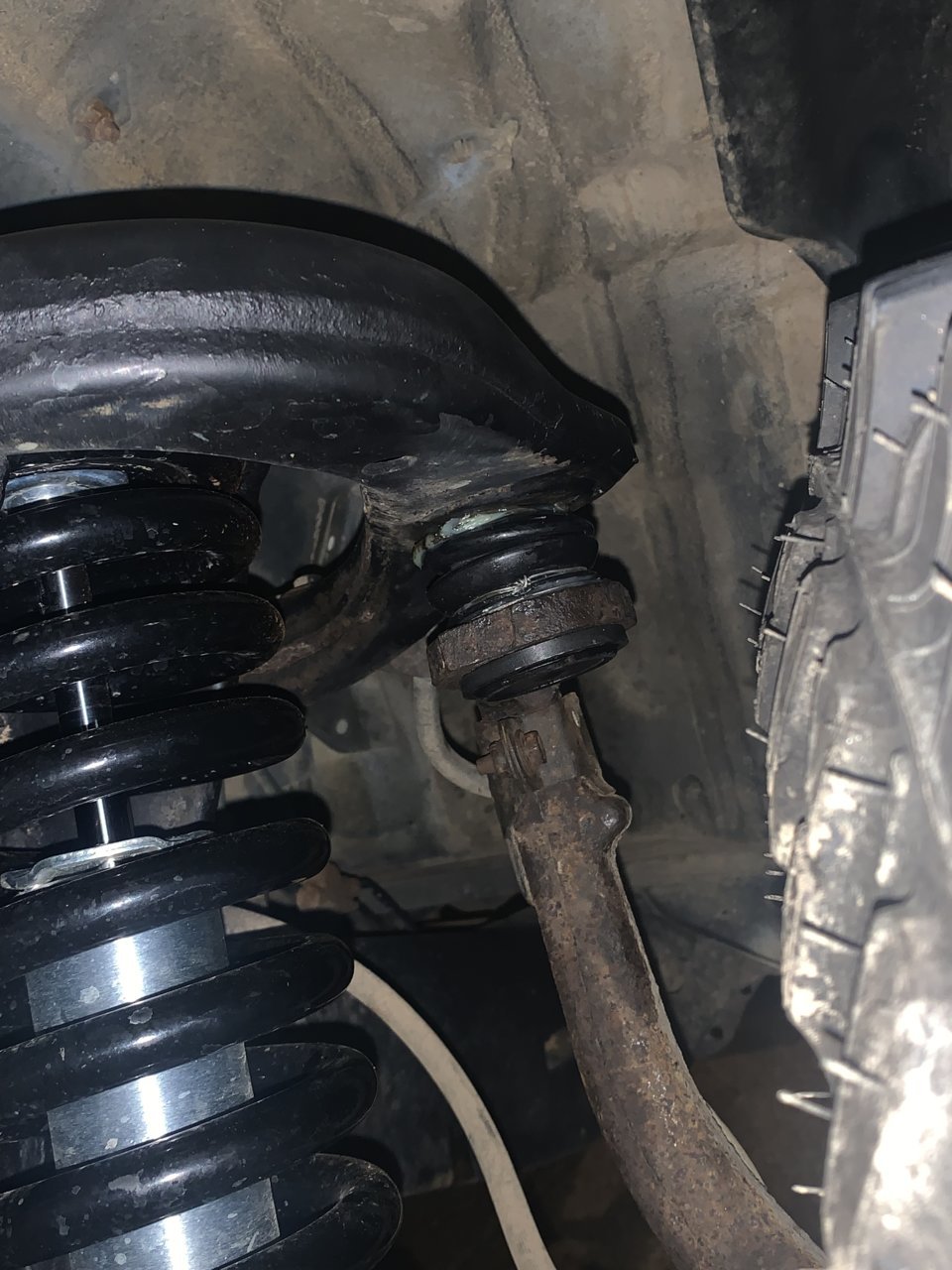

    - Toyota upper ball joints N

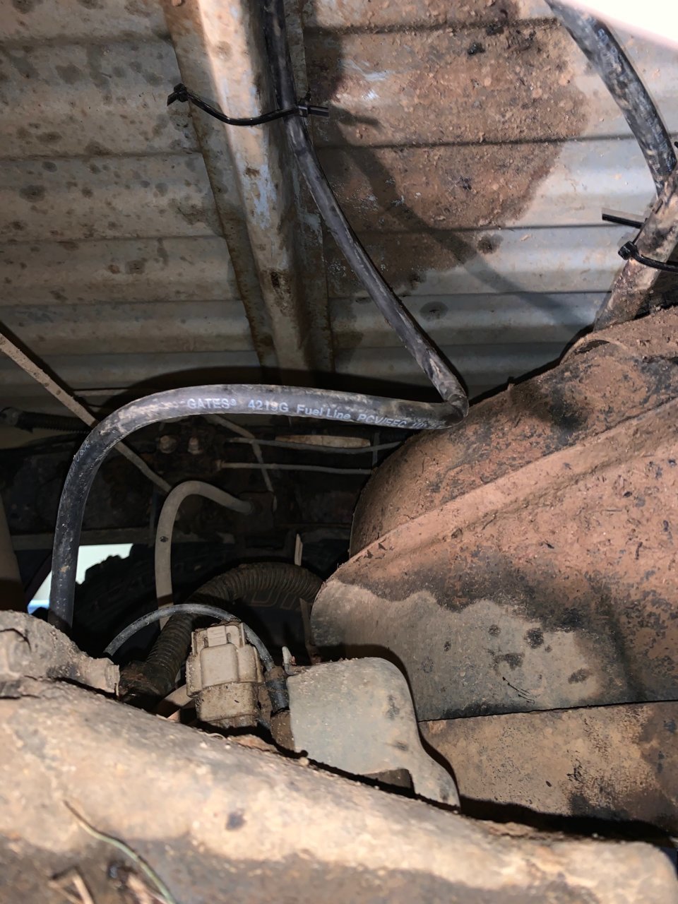

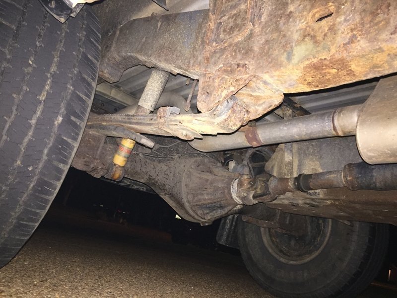

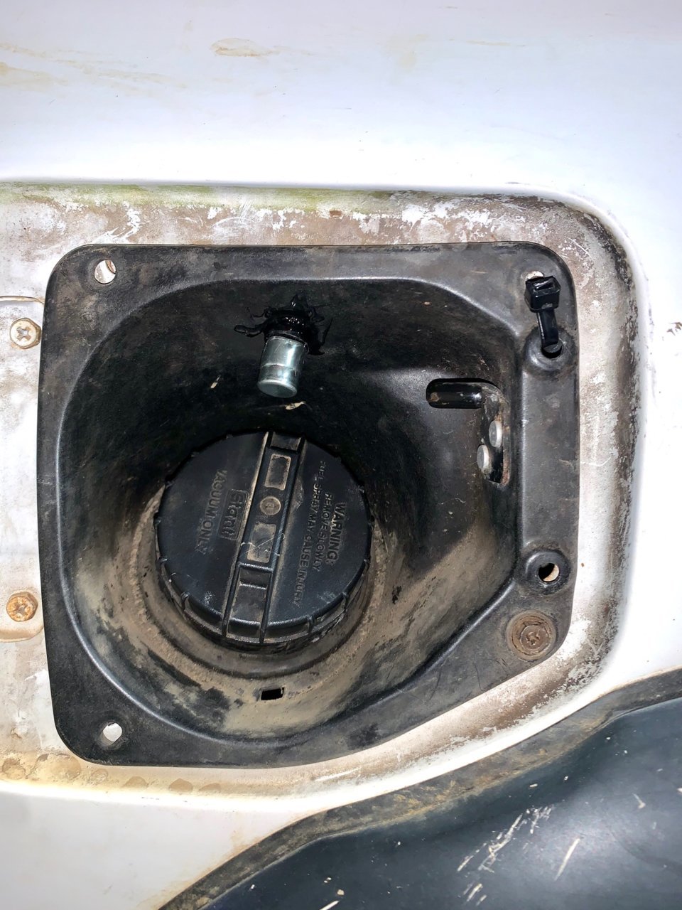

    - YotaShop rear diff breather extension (^lesson learned) O, P, Q

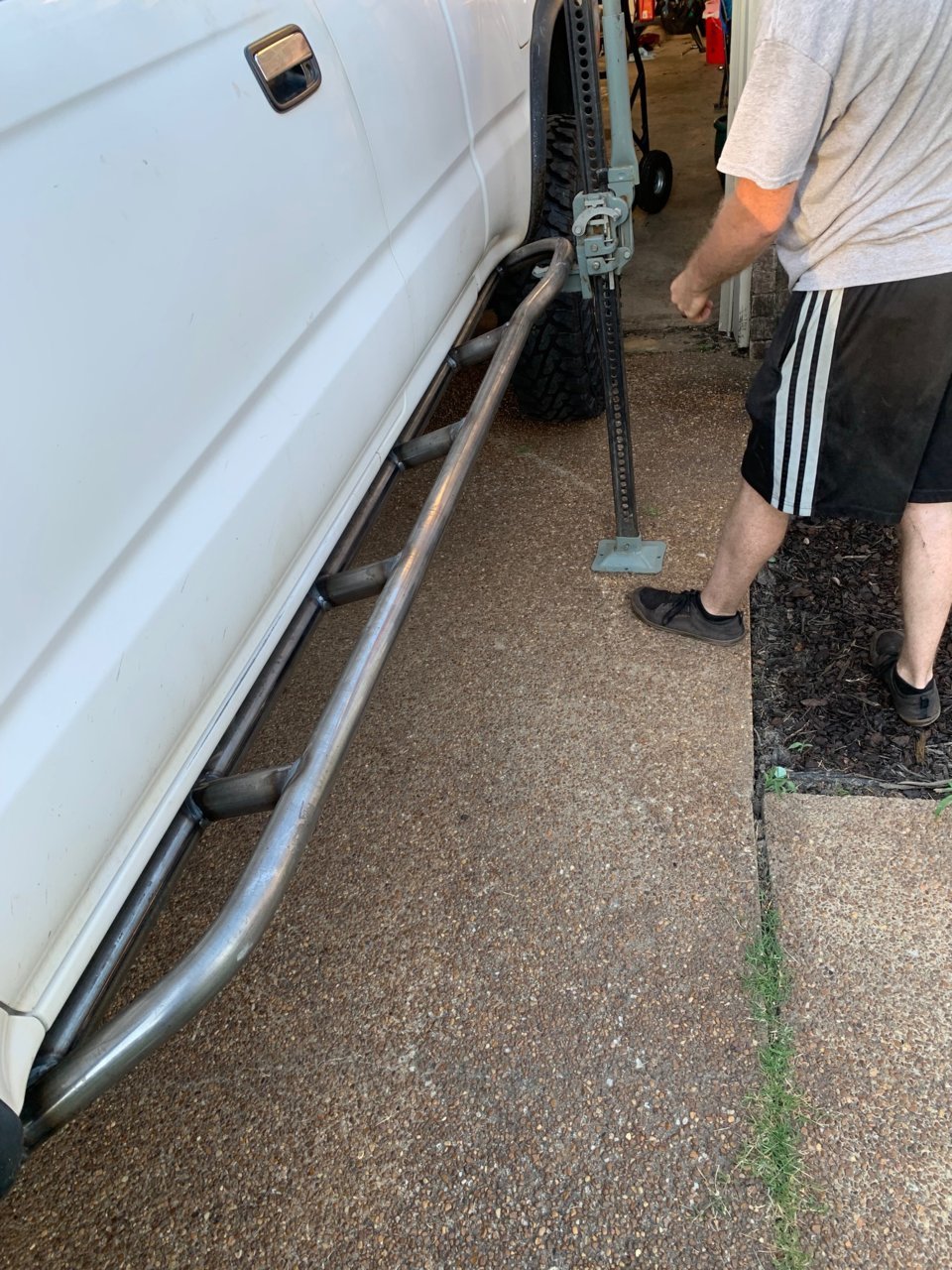

    - 4xInnovations rock sliders D

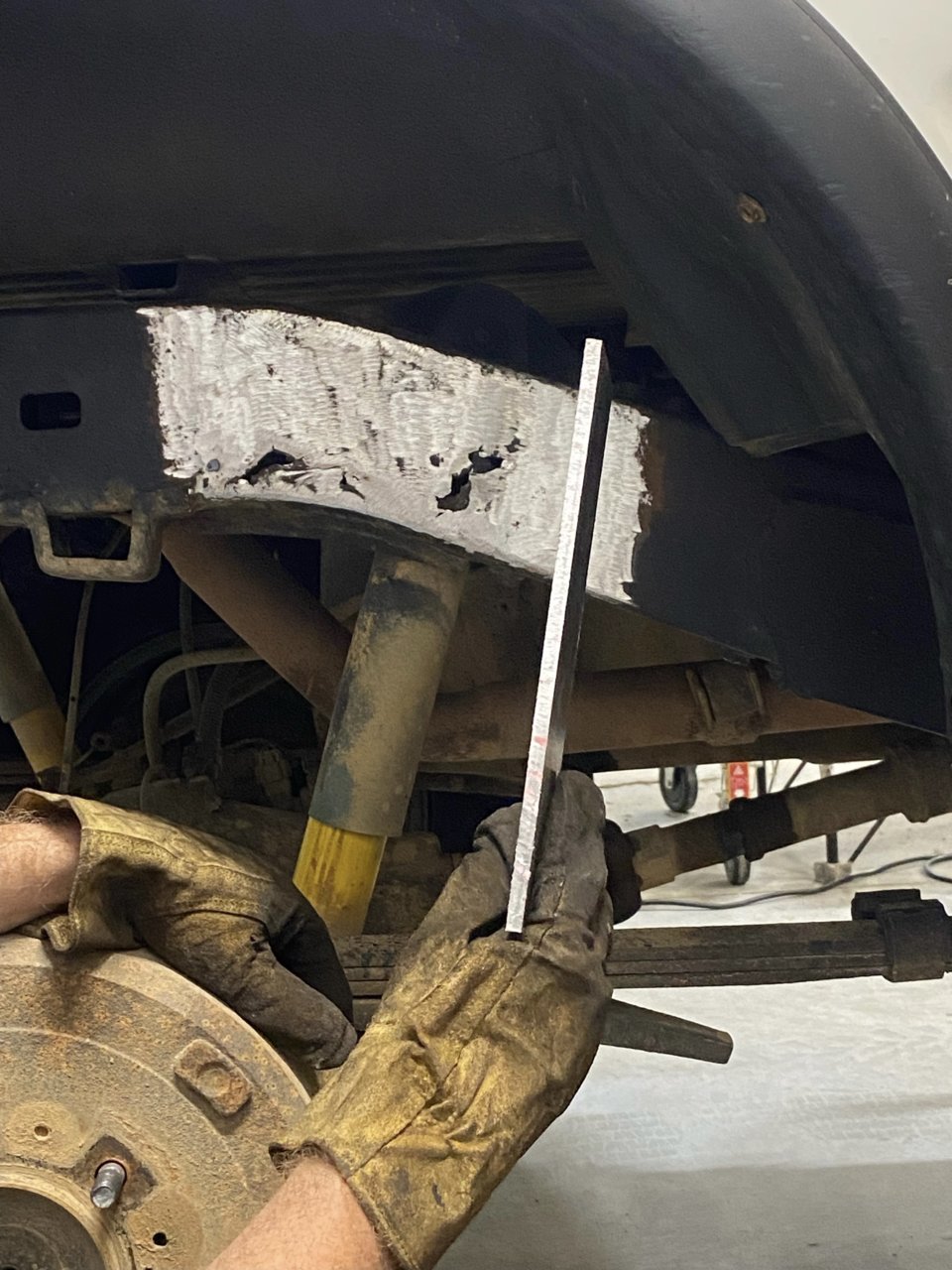

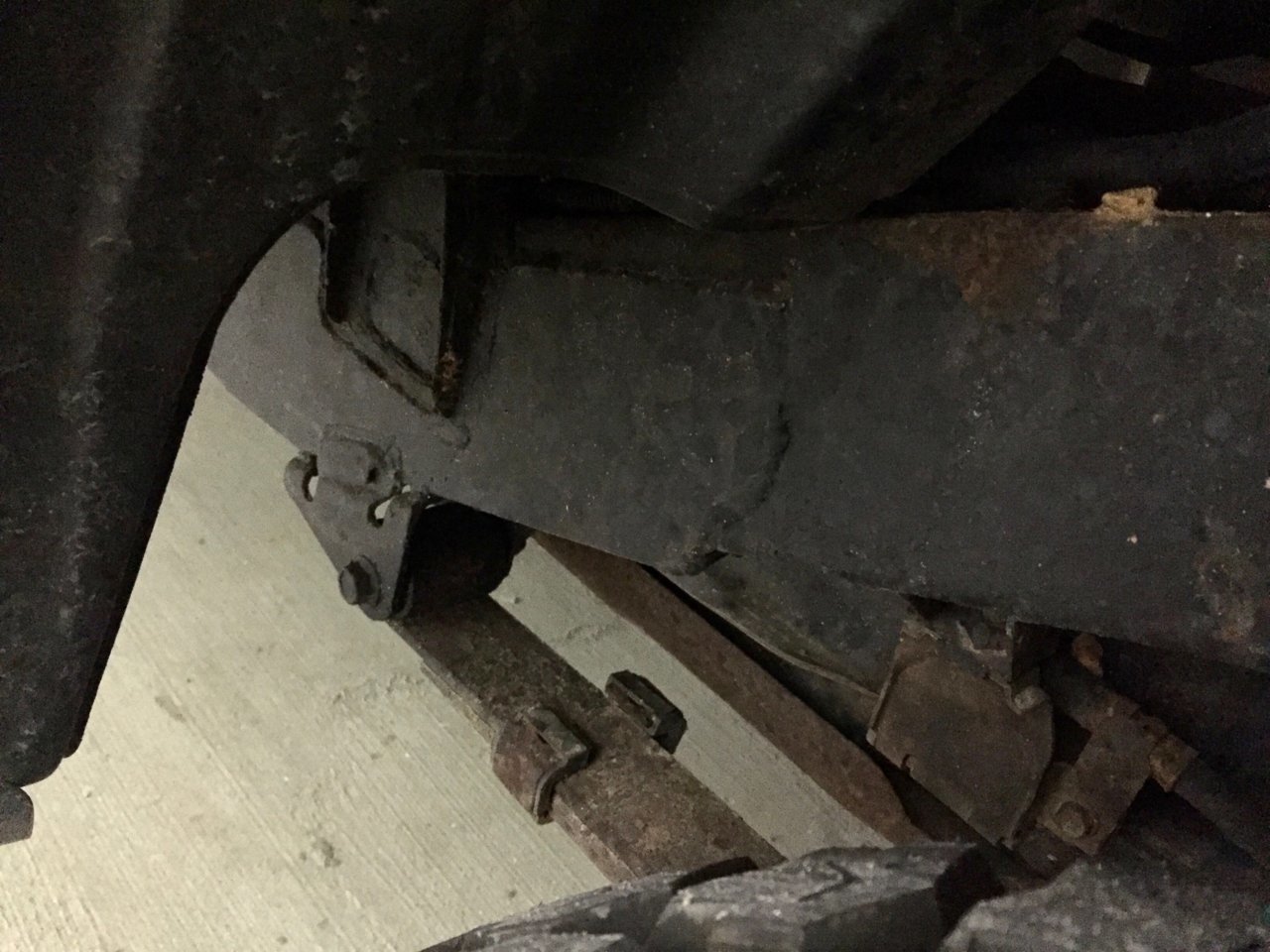

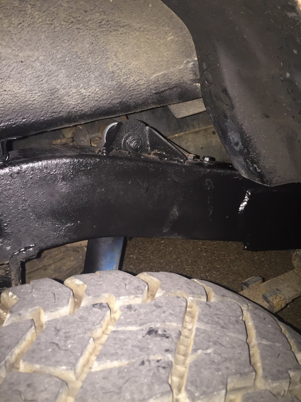

    - SafeTCap frame repair caps for leaf spring mount-section of frame A, B, C
    - SafeTCap rear pass. shock mount L, M

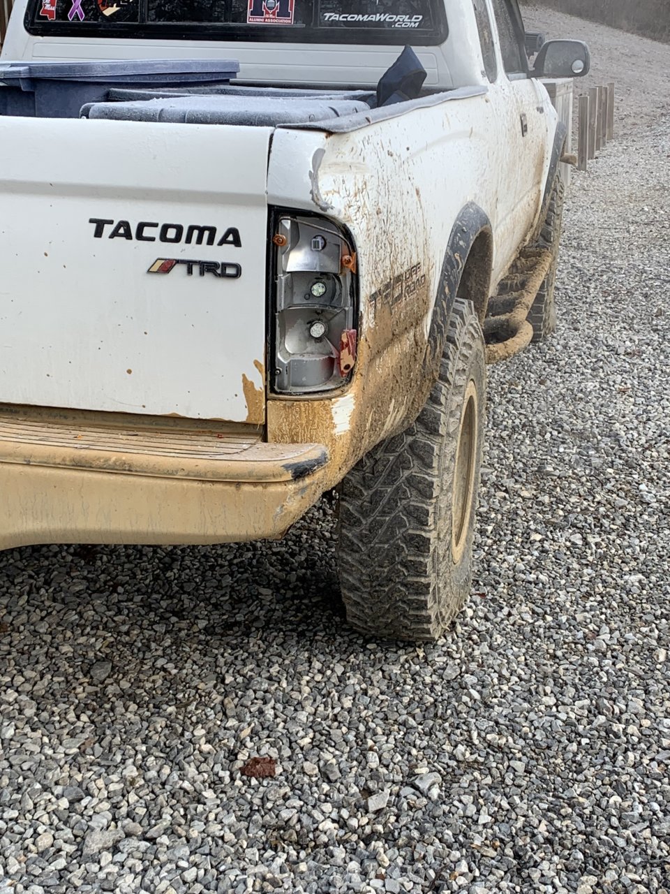

    - Right side tail light replaced after trail damage F

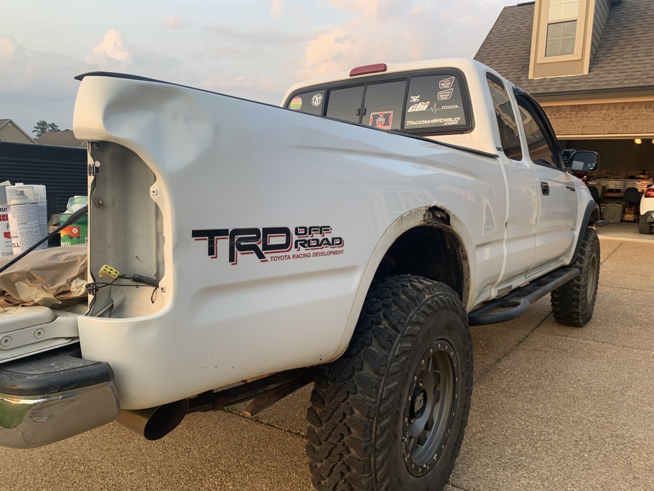

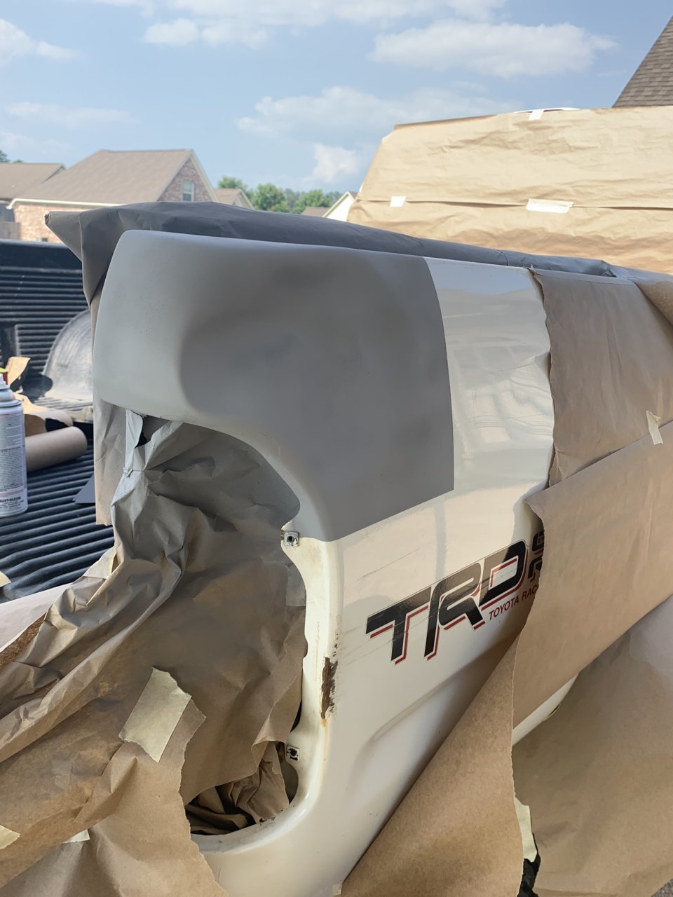

    - Right rear bed dent painted G, H

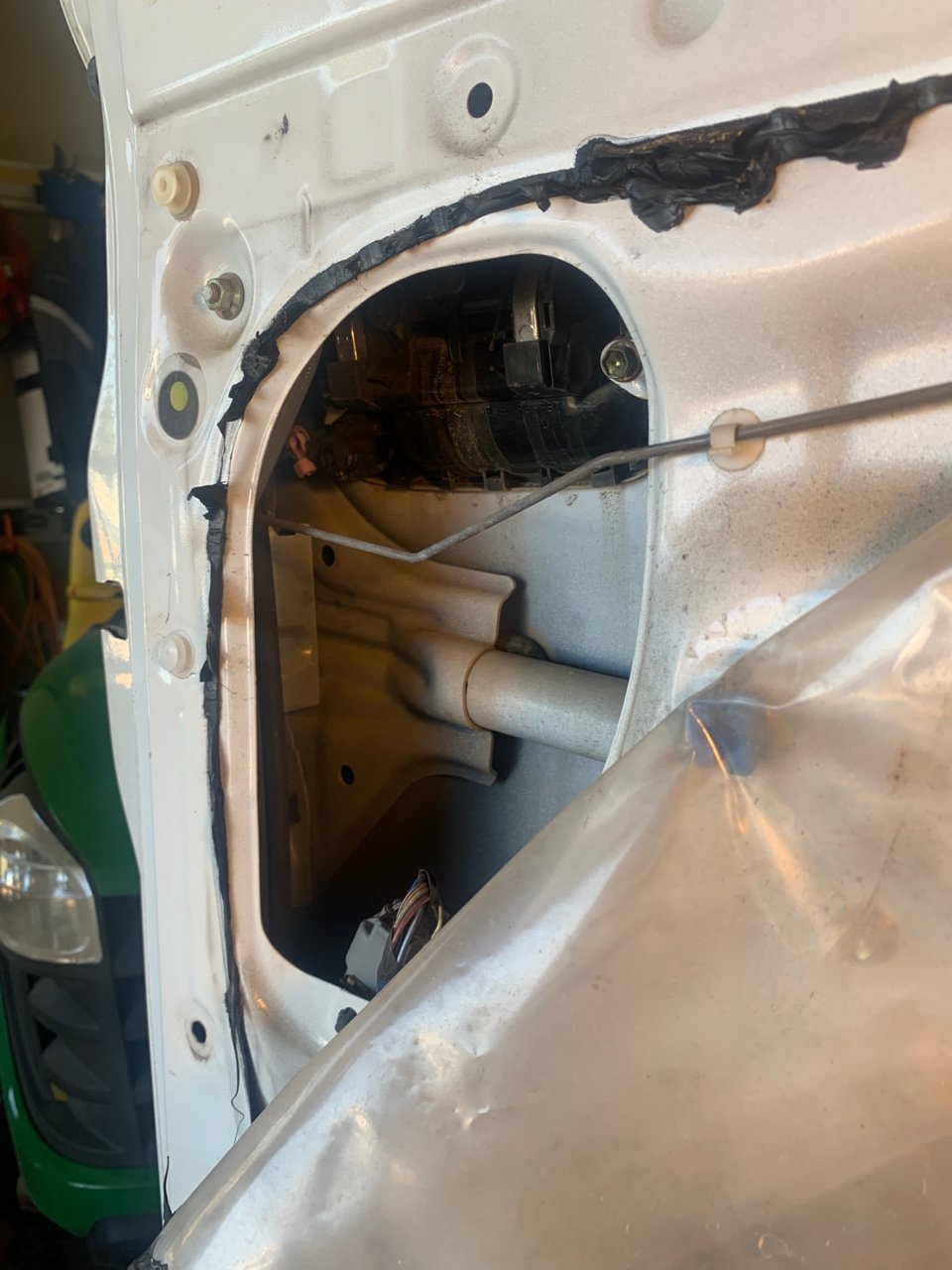

    - Door lock cylinder - driver side Z, AA, AB, AC

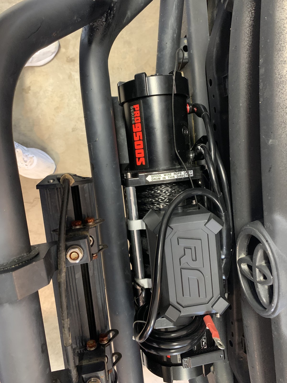

    - Rough Country 9500S winch with synthetic line AD, AE, AF, AG

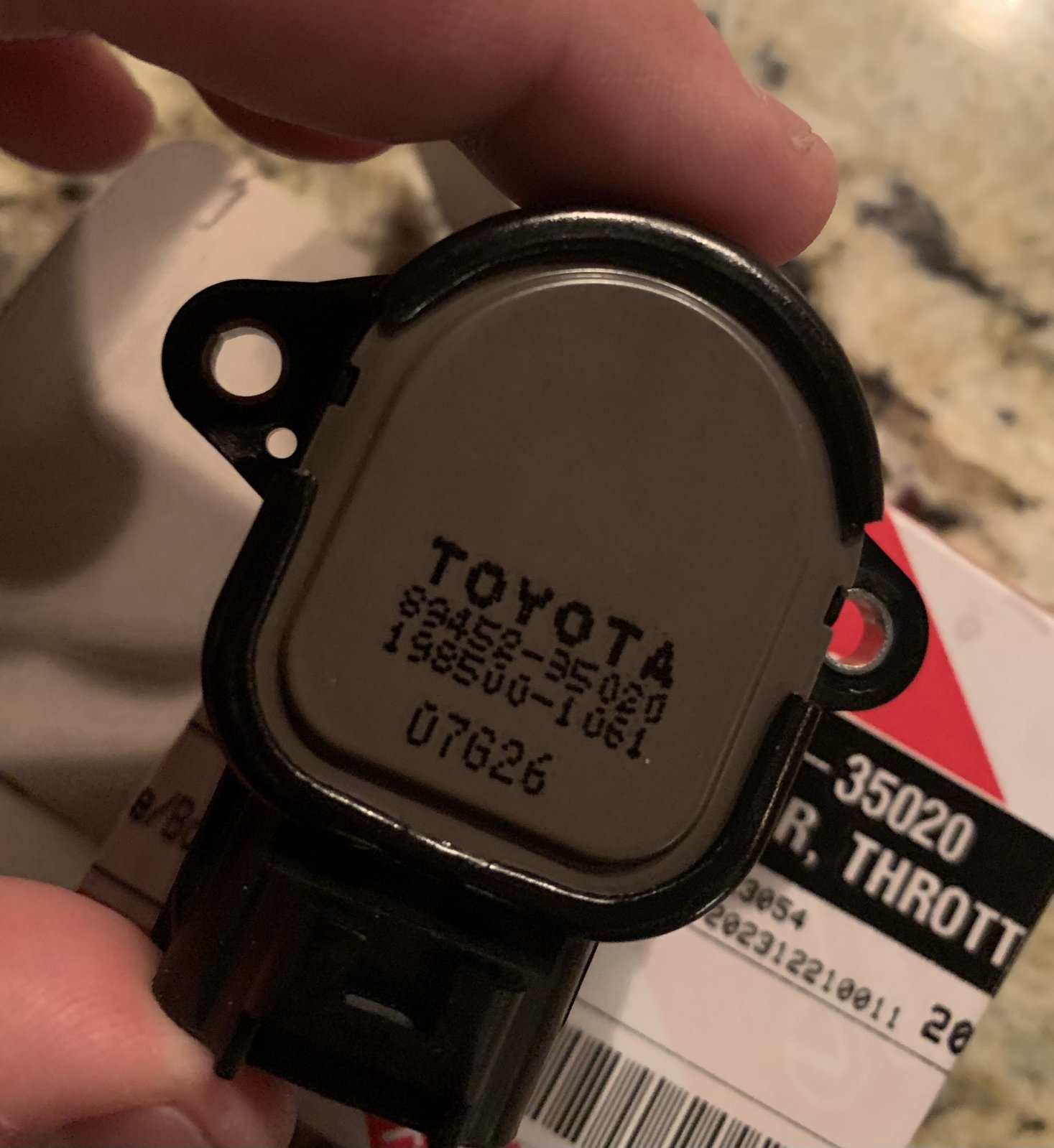

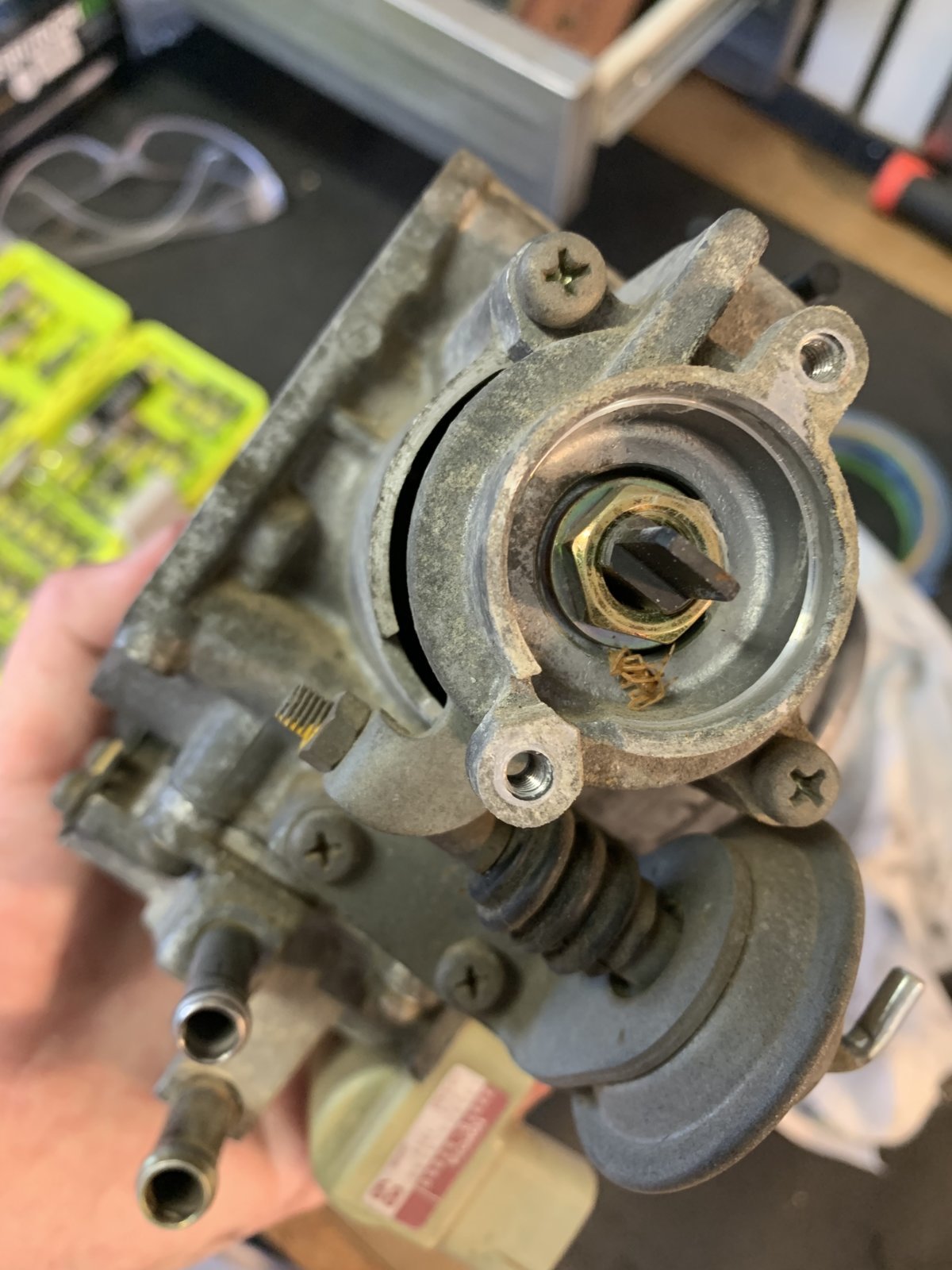

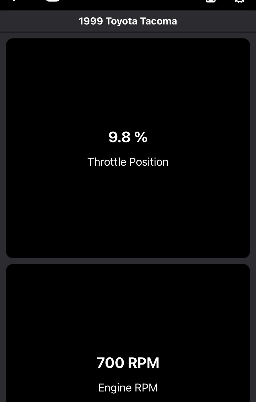

    - Throttle Position Sensor replacement AH, AI, AJ

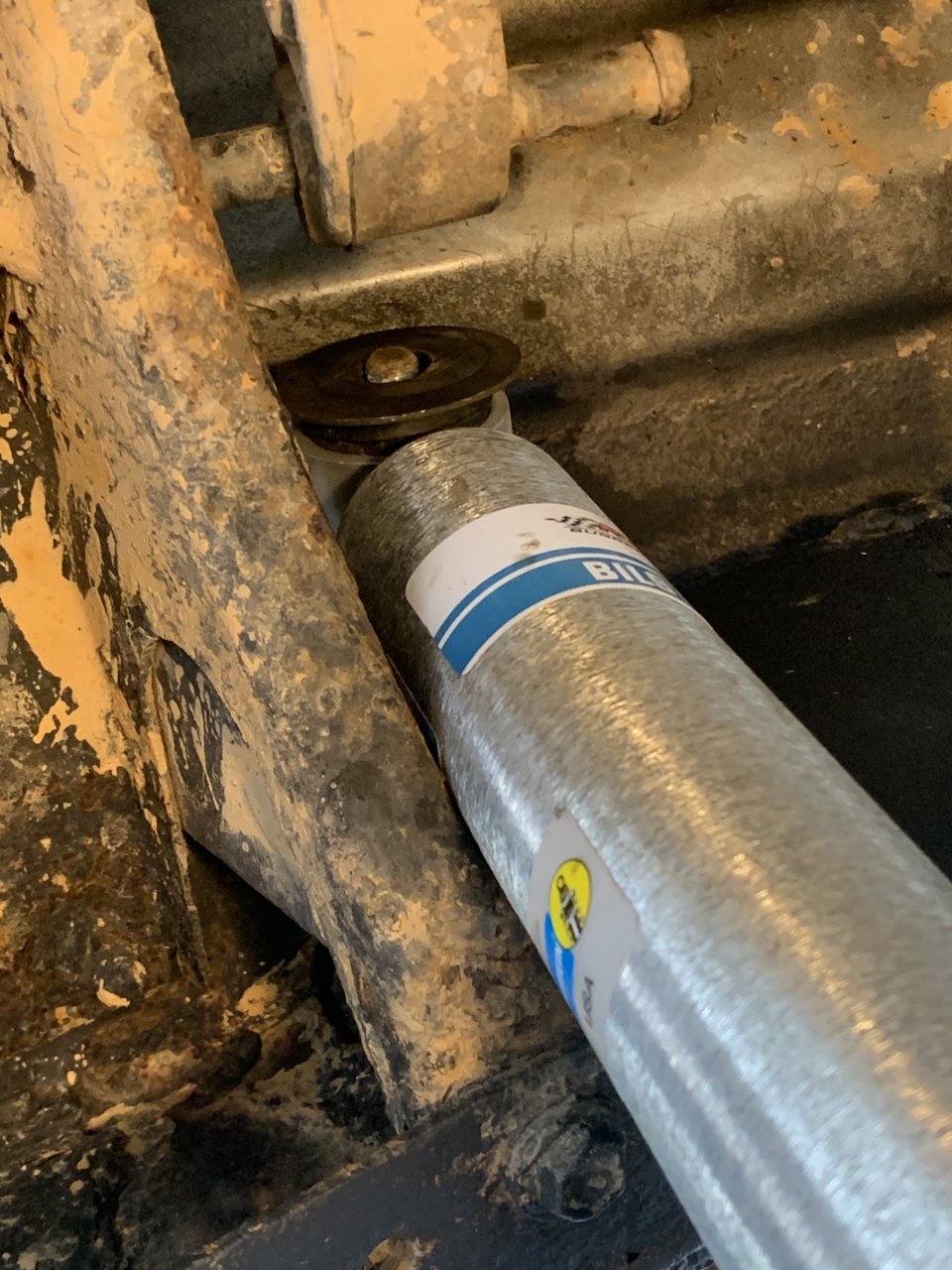

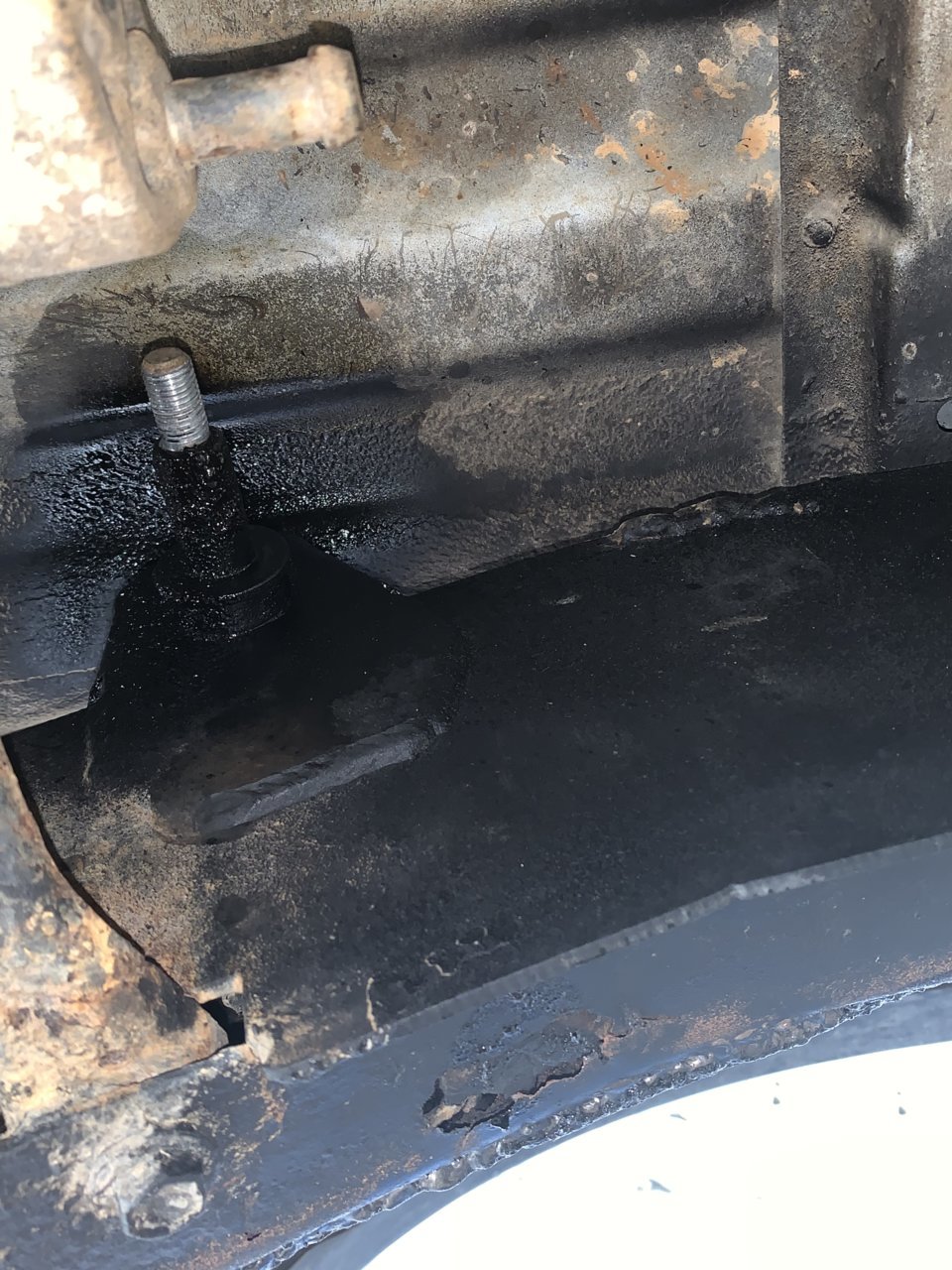

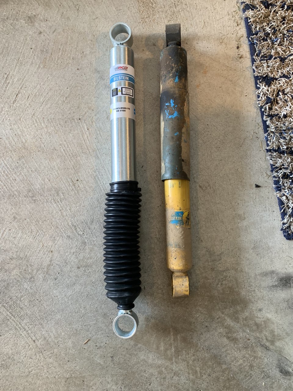

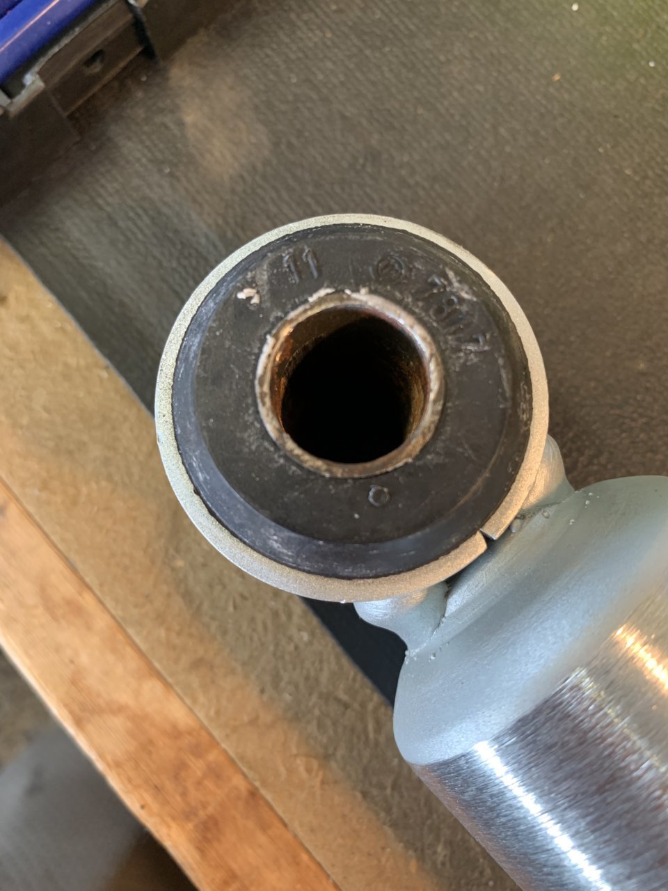

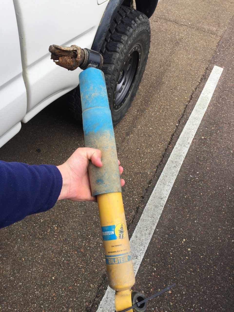

    Last month, I replaced the front coils and shocks with a pre-assembled Bilstein 5100/OME 881 setup from Wheeler's. The other day I saw rear 5100s on sale with free shipping, so I jumped on it. I know that 5100s are an extended length shock, but it's kind of wild to see the 5100 and factory replacement 4600s next to each other (R)
    A little backstory: In 2018, on my first ever wheeling trip, the passenger rear shock mount snapped (L). Flexing too much and bottoming the shock out is all I can guess. The old shock mount was so rotted it was only a matter of time anyway. In its place is a SafeTCap shock bracket welded on by a local collision repair shop here in Oxford.
    Replacing the shocks went without a hitch until it came to installing the passenger side on that new mount. It seems that rather than a replacement factory bracket with threads to accept a bolt, SafeTCap decided to use a long threaded stud all the way through. This made things difficult because I had to compress the new bushings just to even get a nut started. I learned that it would be best to just let the shock hang straight down without any pressure on it to try and do this. They also had a sleeve for the bushings to go over before installing. The replacement bracket itself was starting to look a little corroded so I cleaned it and hit it with some undercoating (S, T, U). At the end of the day it worked fine, and the ride is great. Took it down a bumpy gravel road and much of the bed chattering is gone. I wouldn't say it's night/day but I can definitely feel some difference.
    For a 24 year old truck that really had no business being on the road 7-8 years ago, it rides pretty well:rofl:

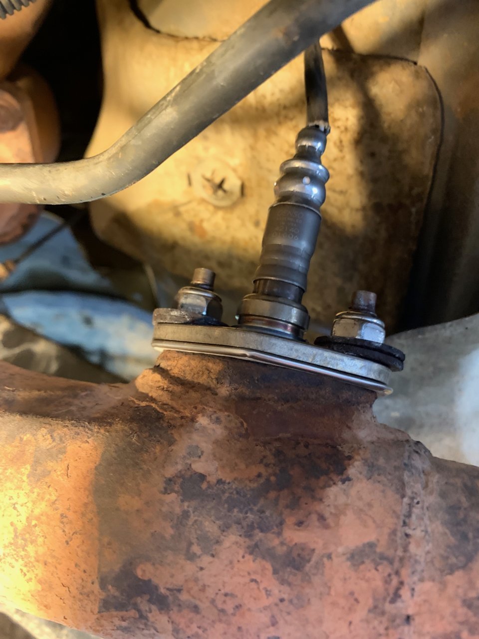

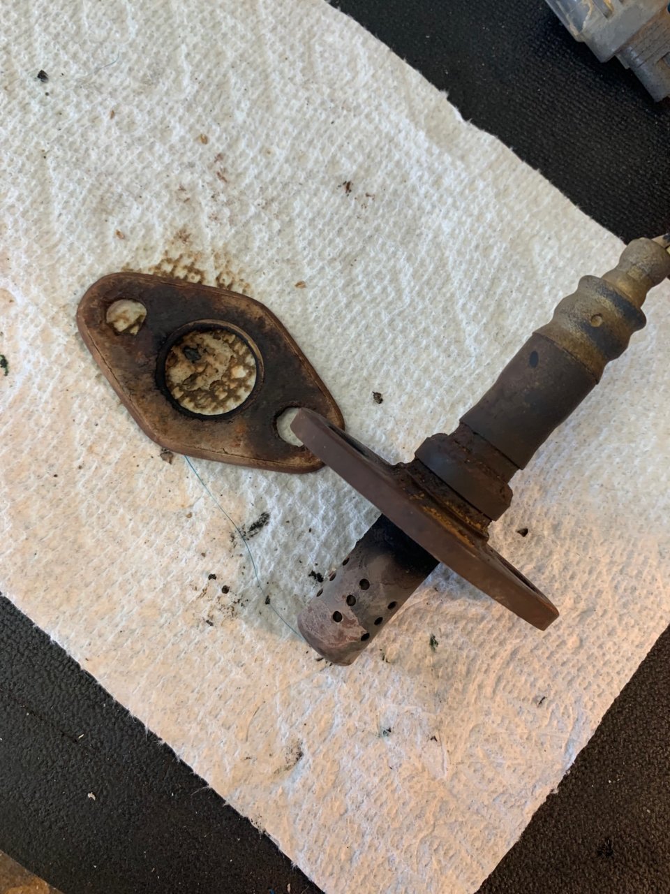

    After getting a repeating P0420 code for quite a while, I've decided to change out the upstream O2 sensor. This decision was partly influenced by the potential for better gas mileage.
    I got a Denso part number 234-4162. Hopefully anyone who google searches about this topic will see this.

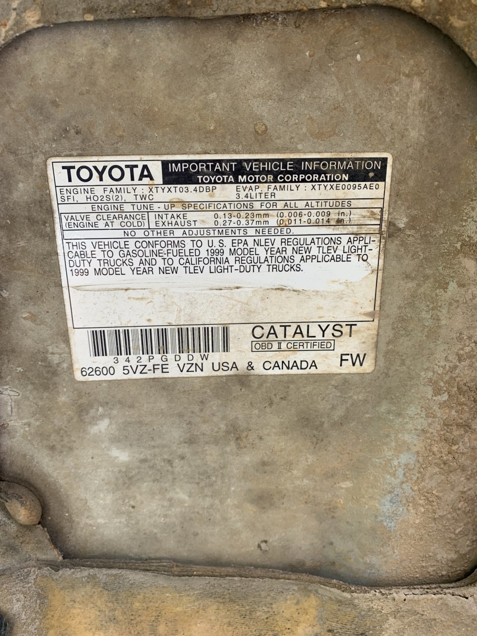

    Oxygen sensor vs. Air/Fuel Sensor:
    I've come across many posts on this forum claiming that the front oxygen sensor for the first gen tacoma's are all the same part and are called and "Air fuel ratio sensor." Or that it's either A/F sensor and then California vs. non California. It seems that 95-00 are actually just called "upstream oxygen sensor" and the 01-04 upstream is called "Air/Fuel Sensor."
    California vs. non-California:
    As seen in picture Y, my truck has a sticker that says it is California emissions certified. For the 1999 model year only, do not trust this sticker. Go to the dealer with the VIN and ask them directly whether your truck is federal or California emissions certified. For some reason, thanks to information from member @Jeff Lange Toyota used the same sticker for federal and California emissions. With that said, my truck is federal emissions, automatic, and manufactured in 3/1999, and used part 234-4162
    No codes as of now. I'll update with gas mileage calculations.

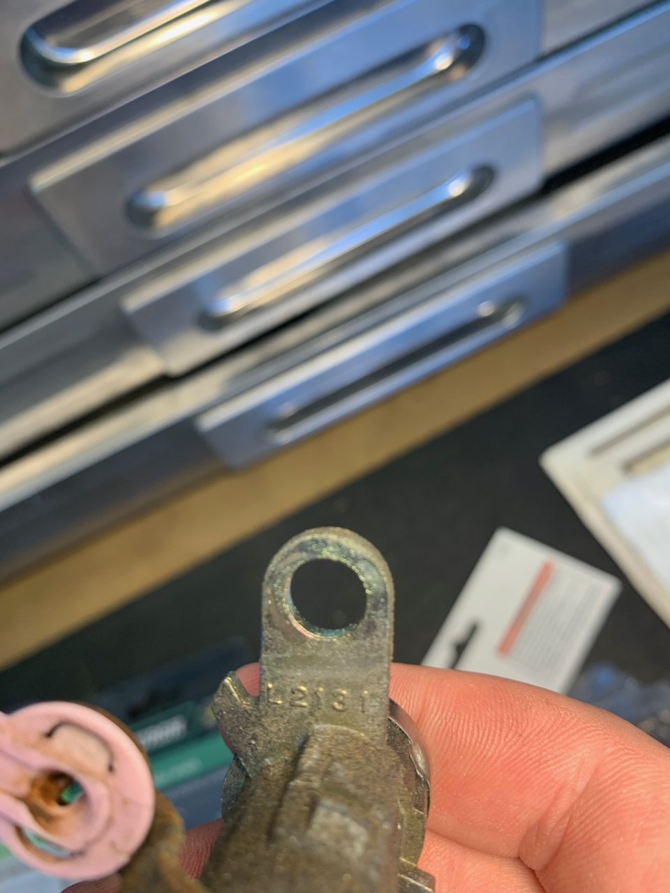

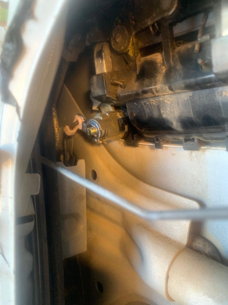

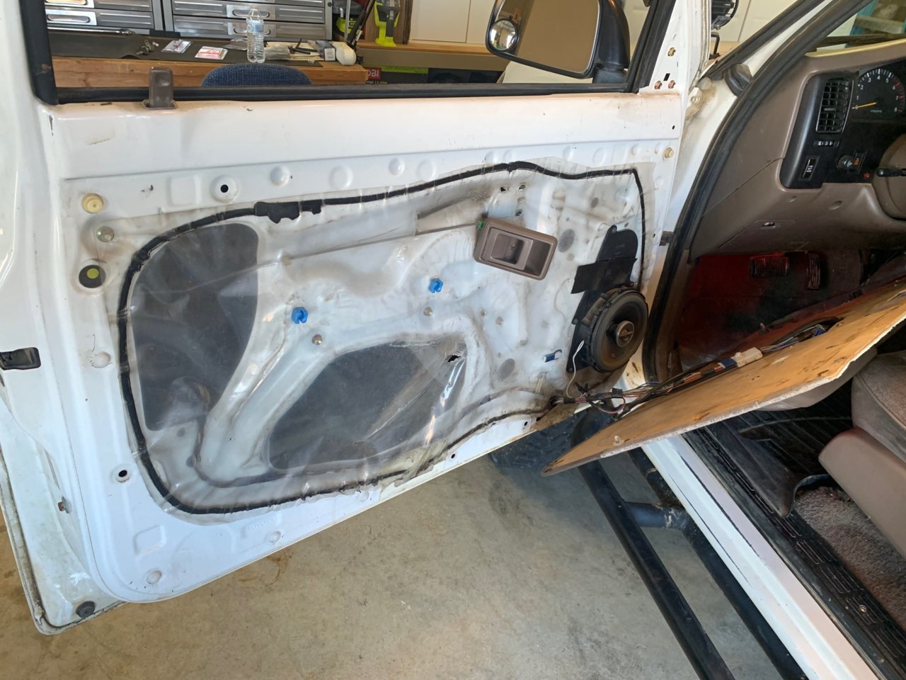

    A few weeks ago I went out to the truck and I couldn't turn the key in the driver door lock cylinder. Instead of getting a new one from Toyota I got this WVE one from Rock Auto. The part is WVE 9D1150. If anyone is trying to change out a door lock cylinder on a 1995-2000 Tacoma it is insanely easy.
    Timmy the Toolman has a great video on the replacement of these, but it seems that Toyota changed the design of how these are held into the door handle either depending on the year or depending on whether you have a key fob. I do not have remote locking doors, so the process was similar to the video but rather than a clip holding the cylinder in, you simply unscrew the door handle and twist the old lock cylinder out.
    I'm convinced this could be an OEM door lock cylinder because the old and new cylinders both have "L2131" stamped in them. If anyone wants to add to this please do.
    Separate door and ignition keys FTW i guess?

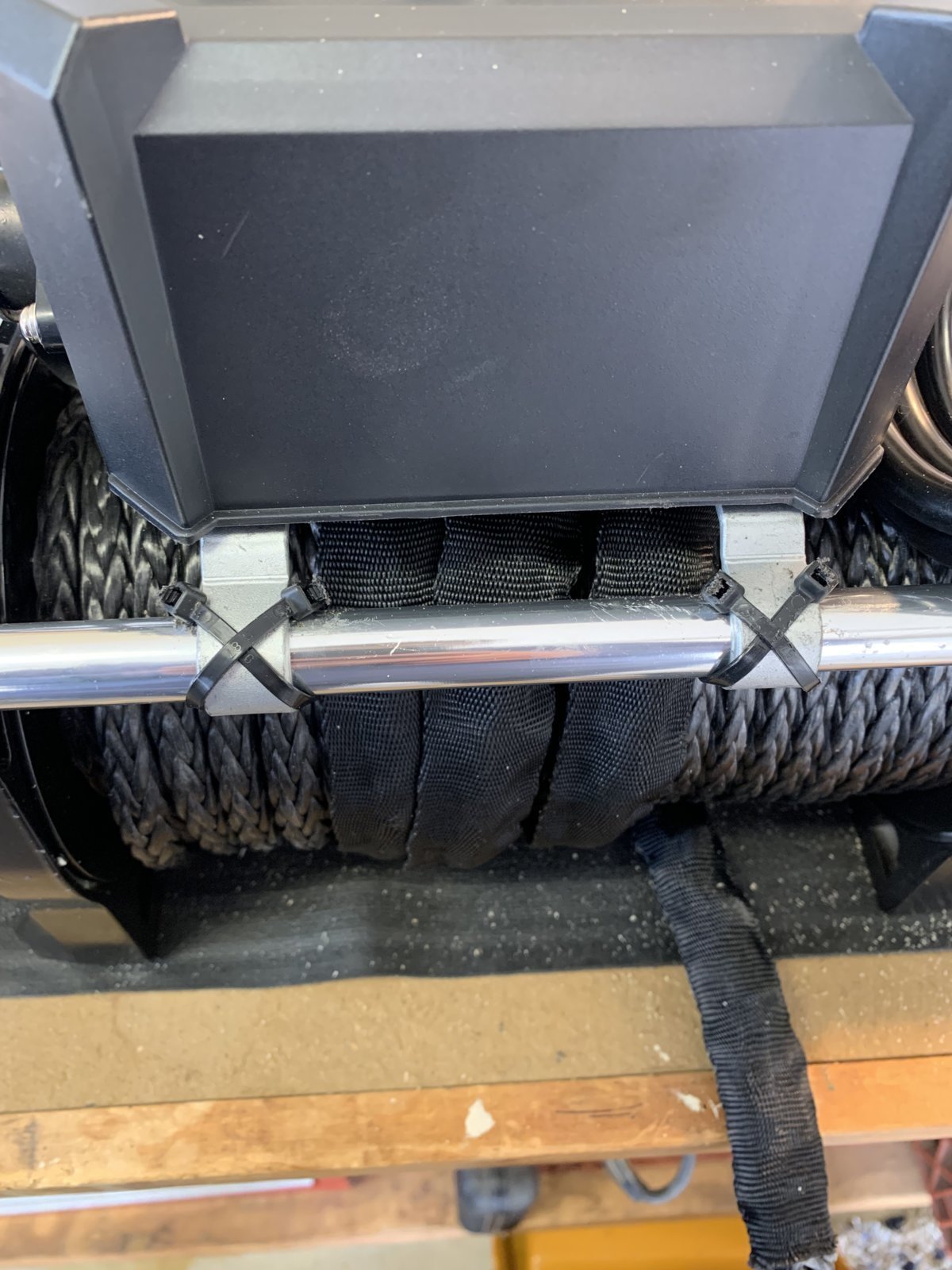

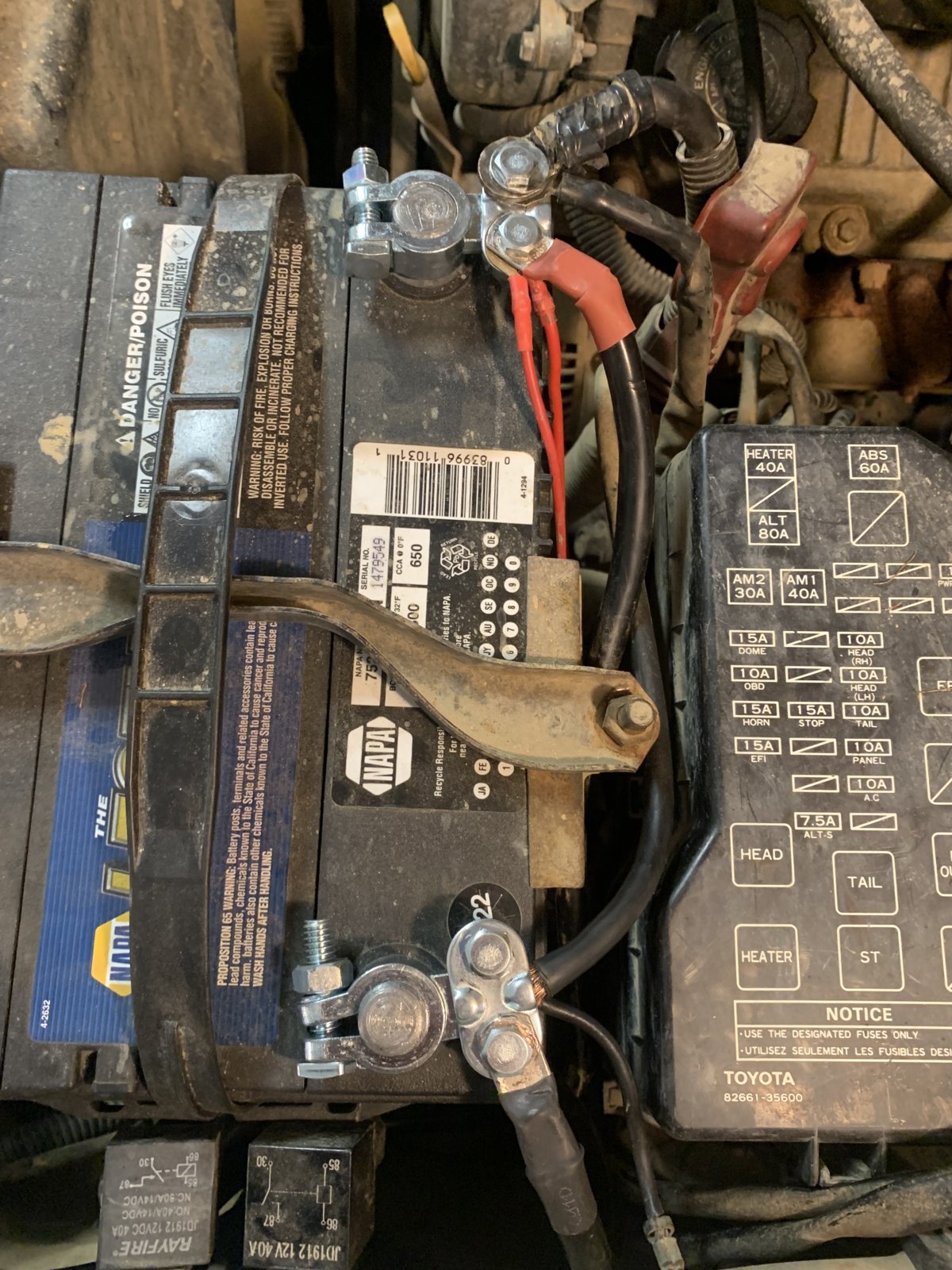

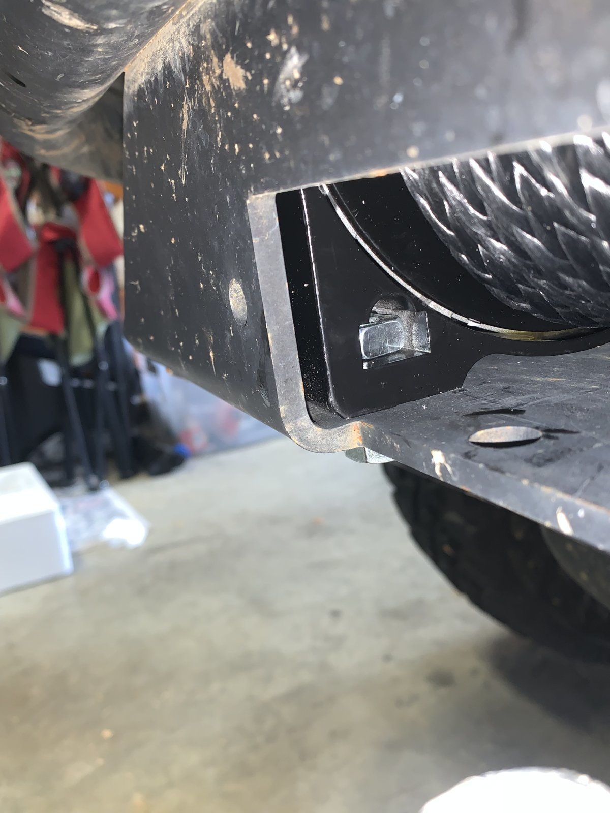

    New Rough Country 9500S winch is installed. I went out to Sardis Lake to test it out on flat ground and tension the winch line but have yet to use it. This is my first ever winch. I hope that I get to use it. I have been in situations where a winch would have been really helpful, so I'm surprised it's been this long before getting one.
    I also went ahead and added on a Badland wide mouth winch hook and rewired my battery terminals with new splitters (AF).
    The winch mounting holes on the TrailGear bumper were close enough to the front of the bumper that it caused issues with mounting (AE). I removed the front aluminum cap that holds the control box onto the rail with "Rough Country" printed on it and affixed it to the rail with zip ties (AG). Overall the winch is a tight fit. I've got a tree saver, soft shackles, d-rings (bow shackles), and a snatch block. Can't wait to use it! Going to Windrock Park in January.

    P0120 code and rough idle forced me to change the Throttle Position Sensor. Spent my money on a Toyota one rather than taking a gamble. Found a dead spider in the little area where the TPS sits.
    From what I've read, TPS reading should be around 10% at idle and 700 +/- 50 rpm. Spot on.
    And after a laundry list of small maintenance items like greasing the driveline, tightening valve cover due to a small leak, fitting a bolt-on exhaust hanger, oil change, checking diff fluids, and patching the driver seat, I'm ready for Windrock in January!

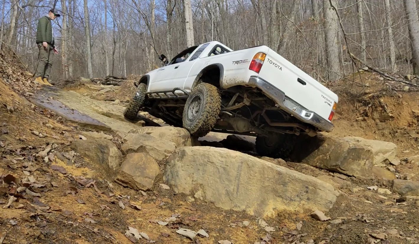

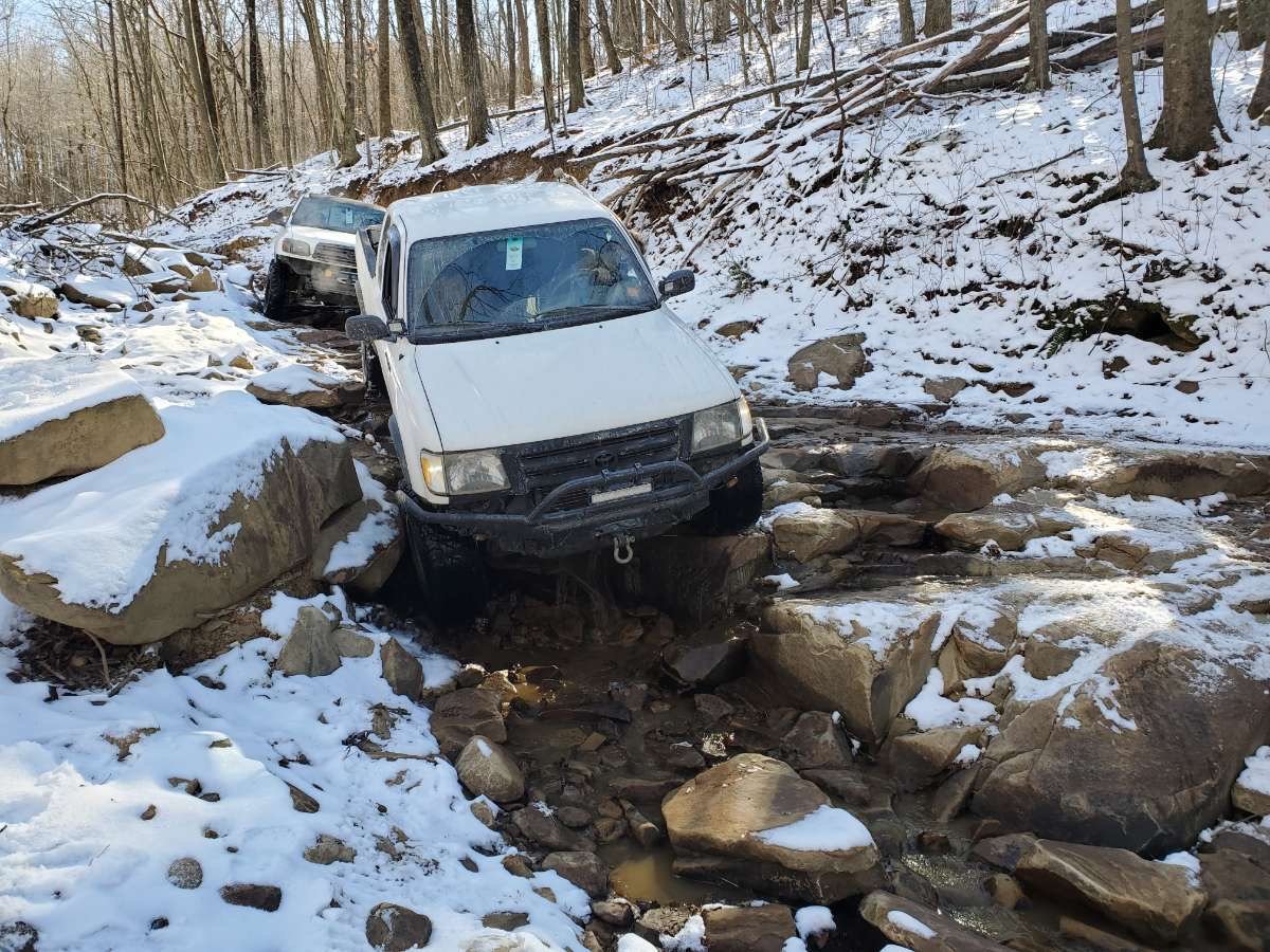

    Had some fun on the rocks at Windrock Park with @ThunderOne @TundraLivesMatter4.7 and @Justinogo, then got stuck in Memphis in the snow storm last weekend! We did trails 83 and 42 (which were less exciting than expected) on Friday, then 35 took up most of the day on Saturday. We came home early on Sunday and barely made it back to Memphis. Shout out to @TundraLivesMatter4.7 for this sick video of trail 35:https://youtu.be/TlaasELE1J4?si=NNdO3Q3C7hfVKR1s
    The picture below is of Mississippi State Highway 6 two days after snowfall. No salt, no plows.
    The truck ran well on this trip. Power steering has been very sluggish in the past when cold. New Toyota rack, but a NAPA reman pump trying to push 33s in the cold doesn't go too well. Tightened up the belt just a hair before we left and that seemed to help some.

    #19
    545
    545 Well-Known Member
    Mar 21, 2019
    #287482
    1,261
    2015 Access Cab
    Sorry if you took offense, but that weld is not safe. I said it in what I thought was a joking way, but it needs to be rewelded.
    It’s a vehicle, we all share the road with you
