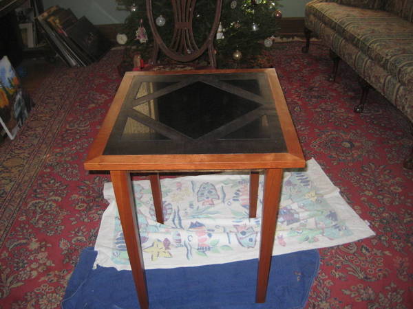

    So i built my sister and future brother in law a raised panel maple pantry door for their new house and now she has a list of things for me to make:rolleyes:. They needed an end table for their new leather couch, so i decided as a christmas present i would make them one.

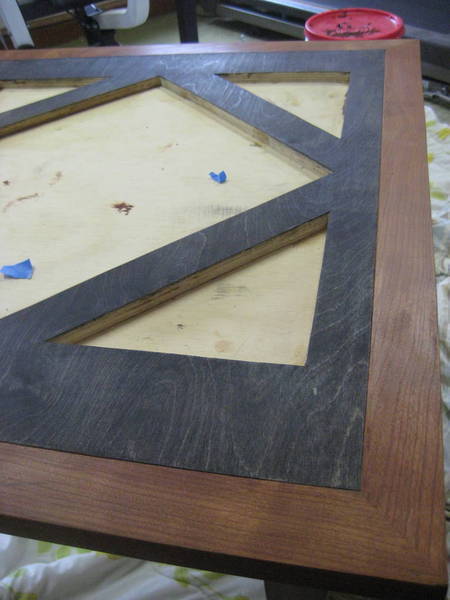

    I came up with a design and went out to pick up lumber. I found 8/4 and 4/4 rough cherry for the legs, skirt and edgebanding. I was able to get the cherry for around $70 total. I had a veneered piece of plywood in the basement for the face. This was the first time i have ever worked with rough lumber, so i spent many hours planeing and sanding the cherry down to size.
    I tapered the legs using a custom sled i made for the table saw. I cut out a design into the plywood which will be filled with granite. The granite was cut on a sliding compound miter sawl with a diamond blade. I ordered an edgebanding router bit from mlcs so i didn't have to veneer the sides of the plywood, which i am very impressed with. I then mortised the skirt into the legs and used biscuits to secure the top to the skirt/legs. I stained it last night, i still need to put the gel varnish on and glue the granite down into the holes. Ill add more pics up when i get it finished.
    I've spent alot of time and money on this project, so im hoping that they like it, what do you guys think?

    That looks awesome. I would be proud to own it, especially since it was hand made and required a lot of time, thought, and energy to accomplish. What color is the granite?

    Thanks man, soo many hours of sanding.
    The granite is like jet black but it has white flakes in it.

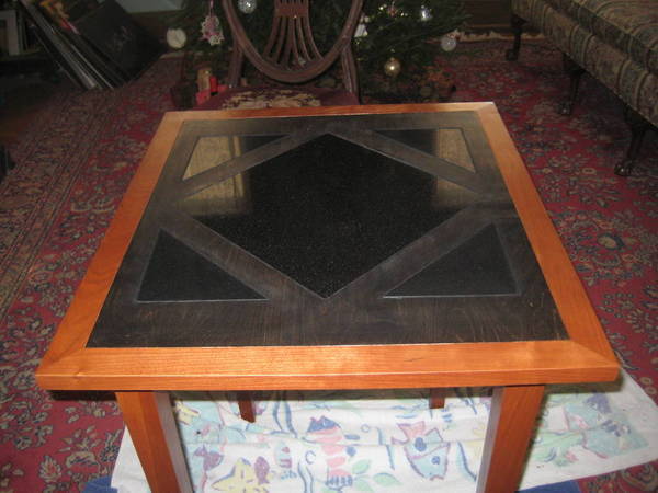

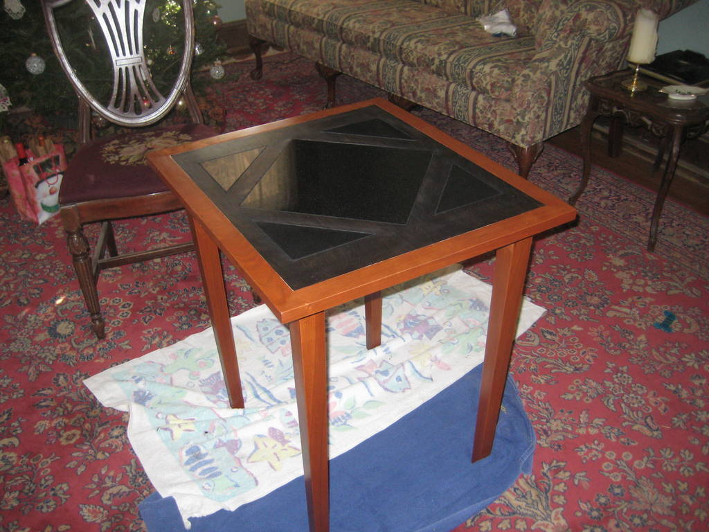

    Well i finally got the table done, gotta love being a procrastinator:D. I'm keeping my fingers crossed they will like it.
