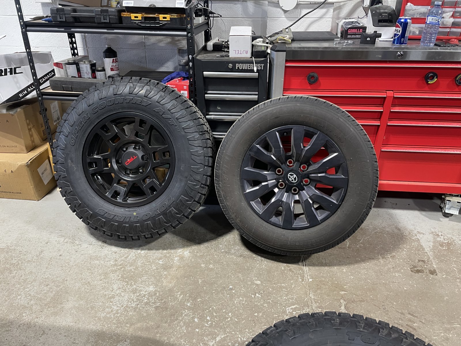

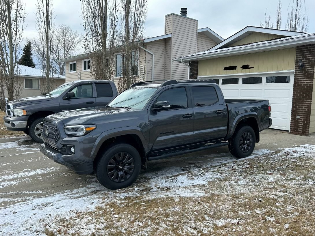

    Picked up the new wheels today. Test-fitted at the shop. Very minor contact at the front air dam and at the mud flap. I’m going to be replacing the mud flaps and removing the dam anyways so fairly minor to correct. No rubbing anywhere else (at least not when parked), so 255/80r17 was a reasonable choice I think (lighter and better for winter anyways).
    The lift parts are due in on Wednesday. I’ll likely disassemble some stuff on the truck tomorrow and leave it cued up for install till then.
    currently looking for mudflaps. Leaning toward the rally armor for looks and coverage. I want something that hangs low, isn’t just a flap of plastic (like the rokblokz are). If anyone has any thoughts on those (or again on the “coverage” of various side steps). Please chime in.

    Both photos are deceptive. Looks huge in this one and small in the one above. The truth is somewhere in between lol.

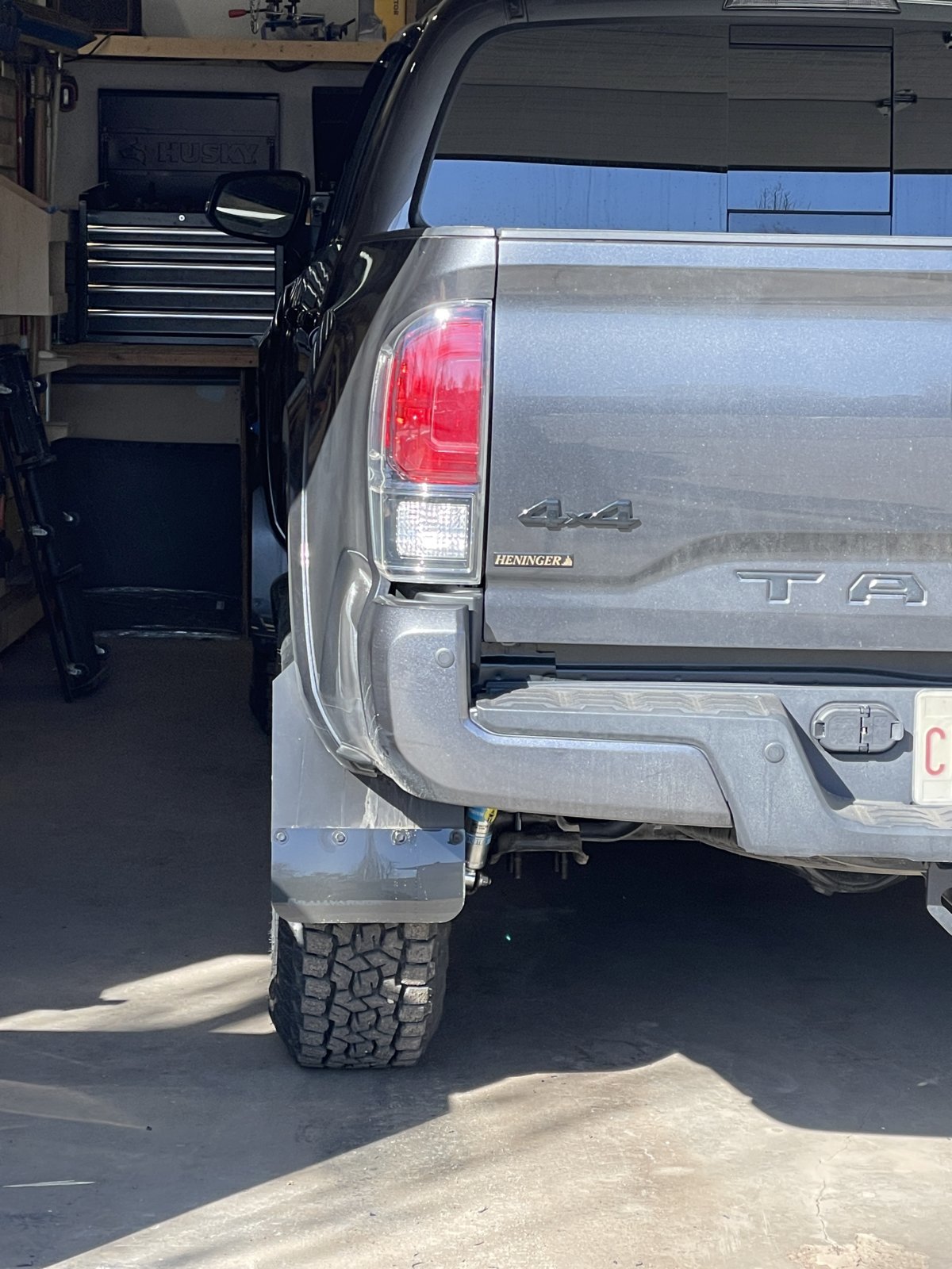

    Welp… I ordered some rally armor mudflaps. Hopefully that wasn’t a dumb choice.
    Edit/update: (turns out they are two separate flaps of plastic, and nylon hardware between the upper and lower flap). They don’t look cheap though. The fit is good. So far debris doesn’t stick to them which is great… will see if that changes as they take some abuse and become pitted or otherwise.

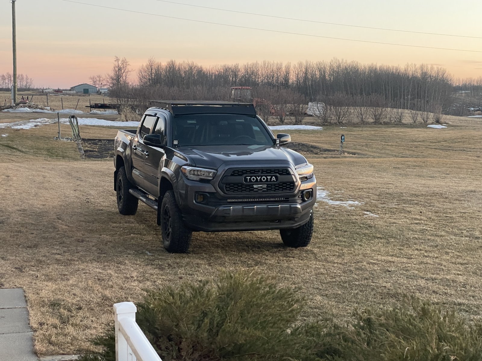

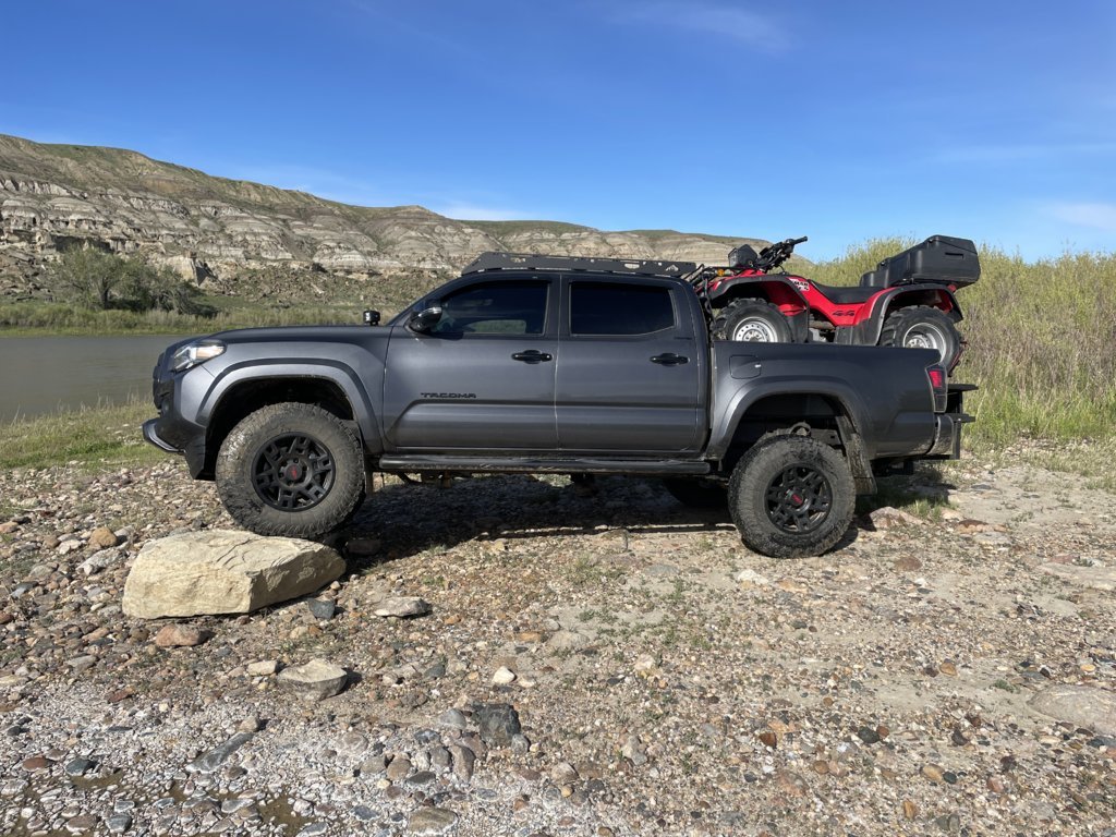

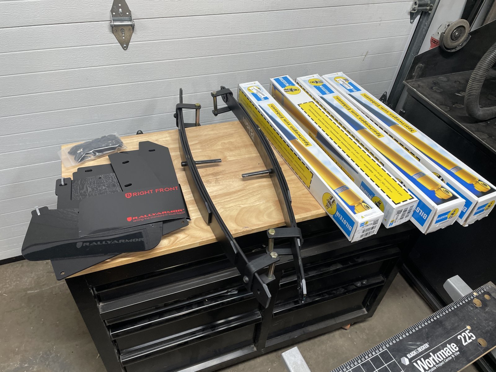

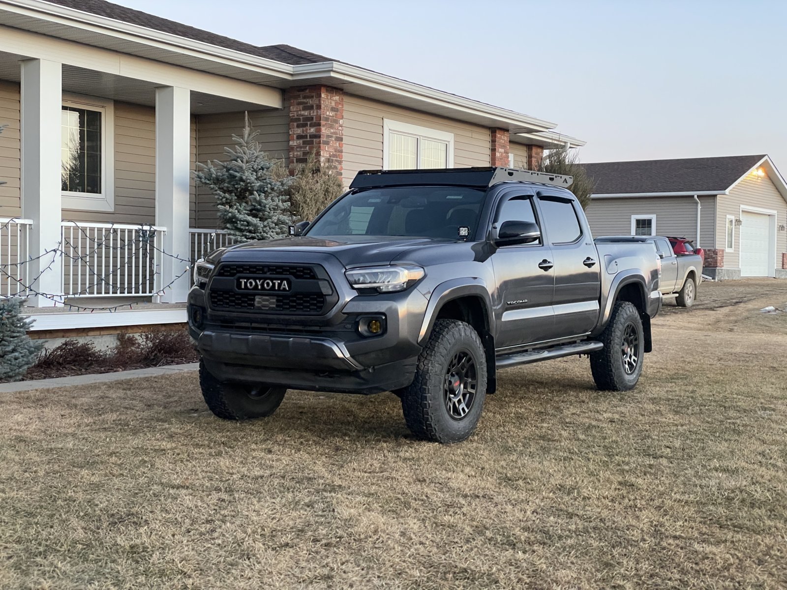

    Well, I did a few things.
    - bilstein 5100’s in (front and rear, with the 2” front lift)
    - icon AAL’s 1.5” rear
    - Toyo open-country AT3’s - 33” skinnies! - 255/85r17 on Replika TRD pro rims
    - rally armor large size mudflaps.
    - aftermarket TRD-pro style grille (no issues with pre-collision/radar system yet after grille and lift)
    - Sherpa Grand Teton roof rack
    - air horn with small on-demand compressor (momentary switch on dash). Later when I get a proper compressor for air bags, I’ll run an electronic valve off a tank instead.
    - 32” el-cheapo light bar in lower grille. Honestly not great. Wired to headlight highbeams with switch in dash, so it can only be used with the high beams on and can be used selectively.
    - Dynamic Diodes SS3 Pro SAE fogs in selective yellow (chosen from the SAE Fog light thread). Wow they are great
    - auxbeam 8 switch panel installed in cab left of steering column. Does not interfere with the factory switch panel which was mostly full.
    - Pro Comp ditch flood lights (these are not as good as I had hoped). I’ve had them for years but never installed on anything.
    - 2 6” amber light bars on roof rack, will be wired to strobe (if working on a road or construction site) or always on (seperate switch) if snowy and white light not as useful.
    - 30” rough-country black-series light bar ordered for roof rack.
    - window vent visors added (not in-channel because I have seen these scratch other people’s windows).
    - Tacoma seat front lift blocks (lifts from of seat 1-1.5”). I really like this addition. Gives a bit more vertical leg room.

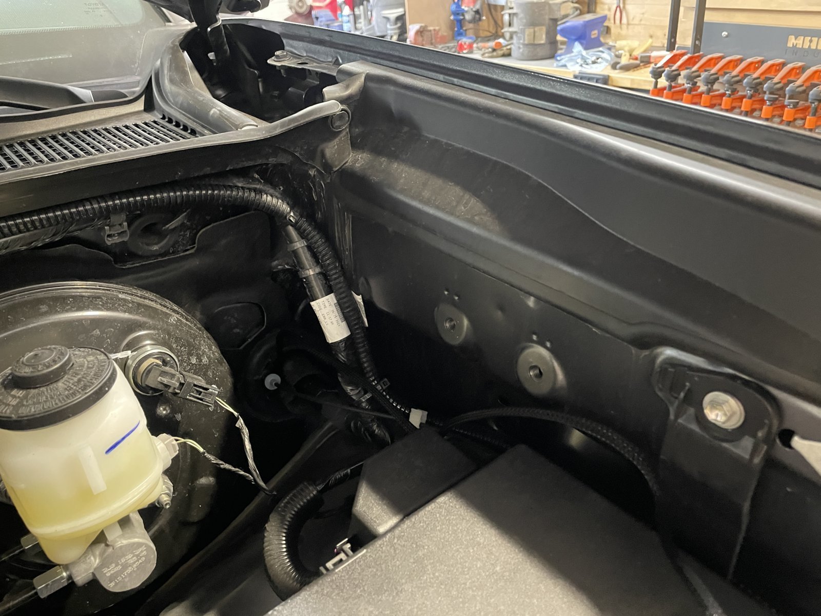

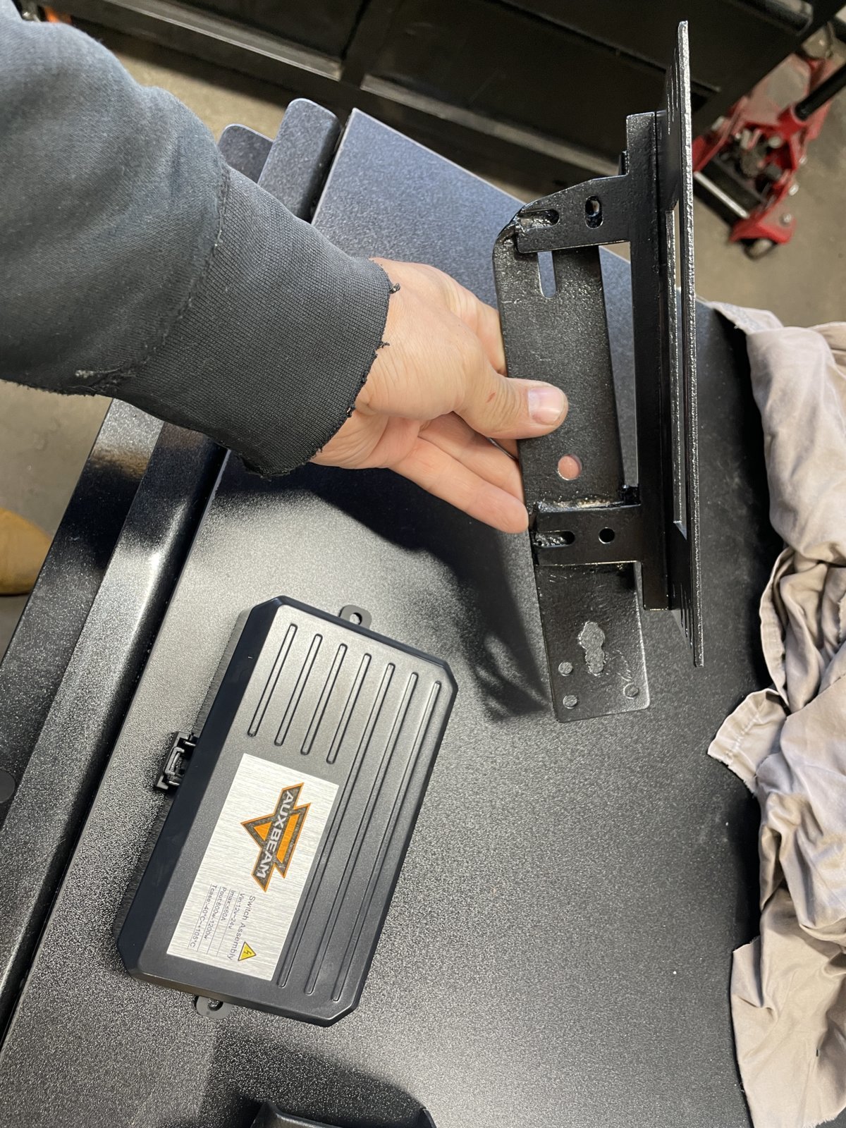

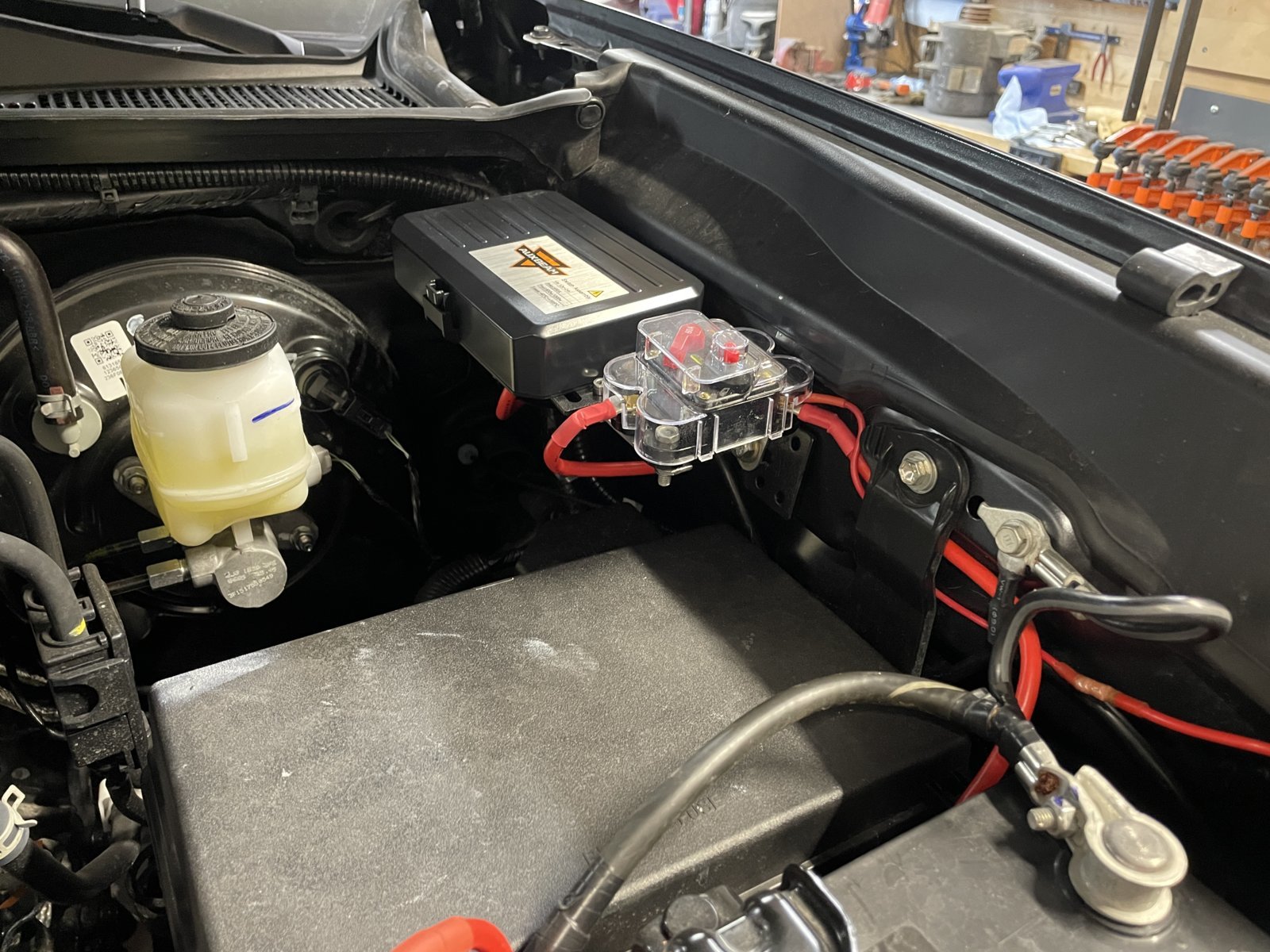

    - Re-fabricated the auxbeam mount to fit the two open bolt holes at back driver side of engine bay.

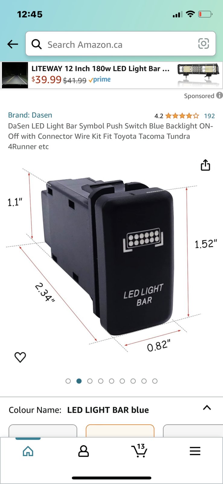

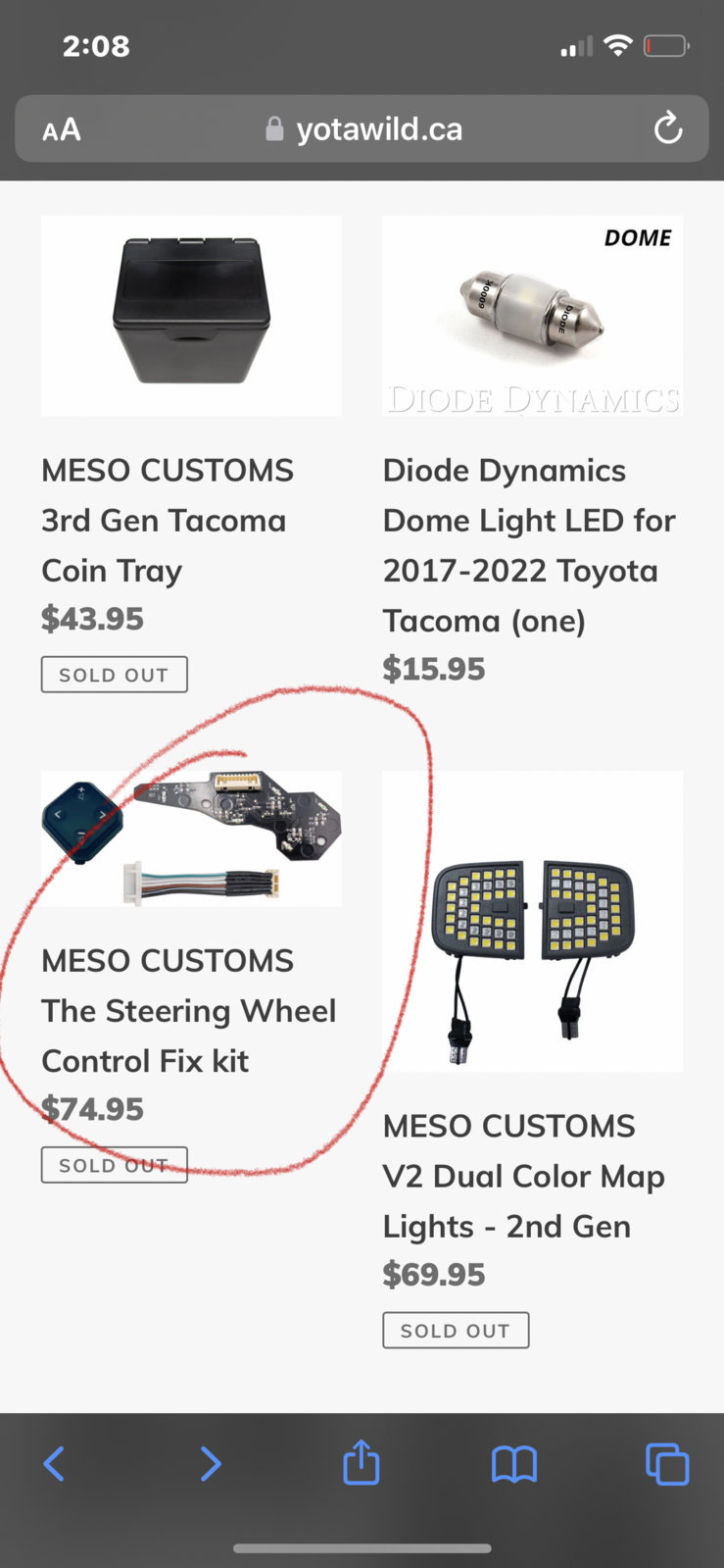

    - Amazon LED light bar switch to fit a factory tall blank. I wired this to a relay with the switch power off a fuse tap on high-beam circuit.

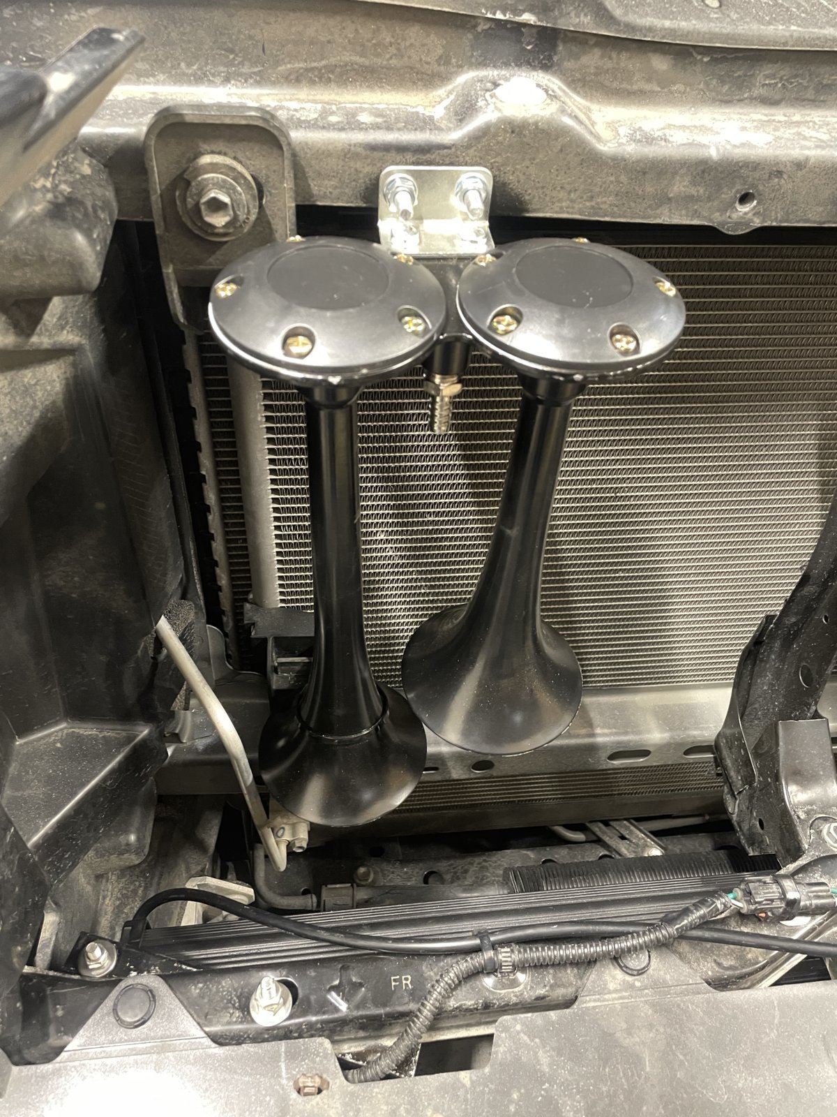

    - And the horn add-in is pictured. I ordered a Farbin momentary switch on Amazon cause I could tuck it behind steering column and surface mount it with sticky tape in case of later changes

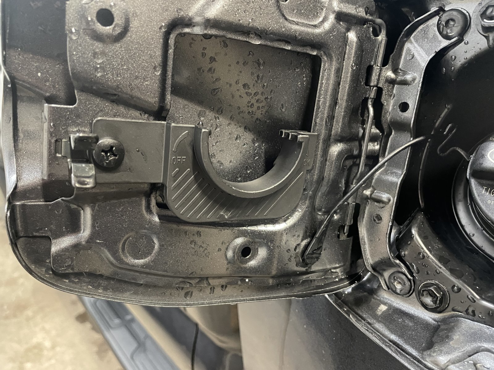

    Added an Amazon gas cap holder. Works great. Cheap.
    Also photo of lift parts/mud flaps

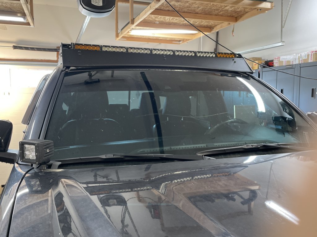

    Got my 44” ExtremeLED X6S light bar which turned out to be the only single row I could find that fits neatly BELOW the upper flat surface of the Sherpa Grand Teton (I made my own mounting brackets).
    I wired the amber lights to a flasher unit so I could either run them steady on or as amber strobes (i am occasionally on roadways for work).

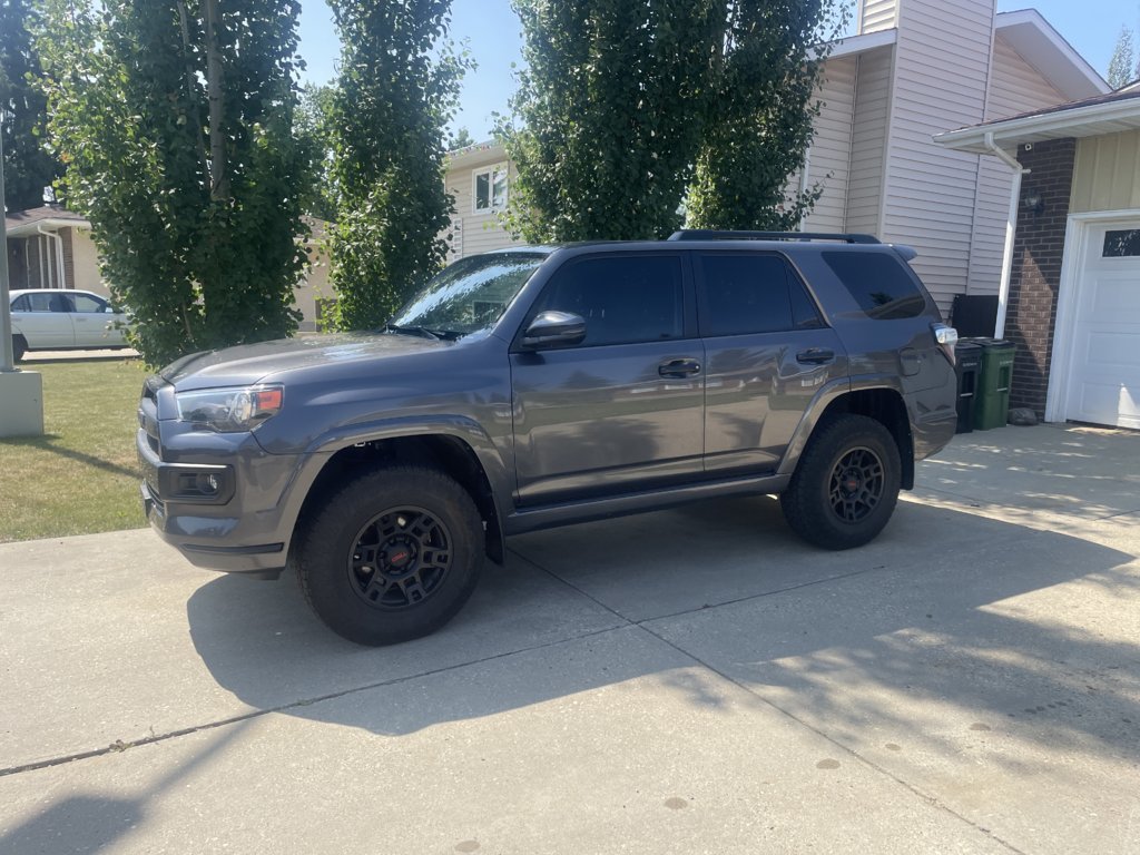

    I did a bit of work to my wife’s 4 runner limited (Mild spacer lift to keep XREAS functional for on-road handling, since that is most of her driving), chrome delete, running board delete, some fog lights from the Tacoma, sequential smoked mirror signal lights, and I took the skinny 33’s off my truck and put them on her vehicle. Turned out they fit pretty well. Only minor rubbing and I corrected that with some adjustments to the inner fender liners.
    I plan to add a prinsu or similar roof rack for her vehicle, i really like the flatter roof racks for mounting versatility.
    Got 285/70r17 Falken Wildpeak AT4W for my truck, on the same rims again, so the vehicles matched which was fun.

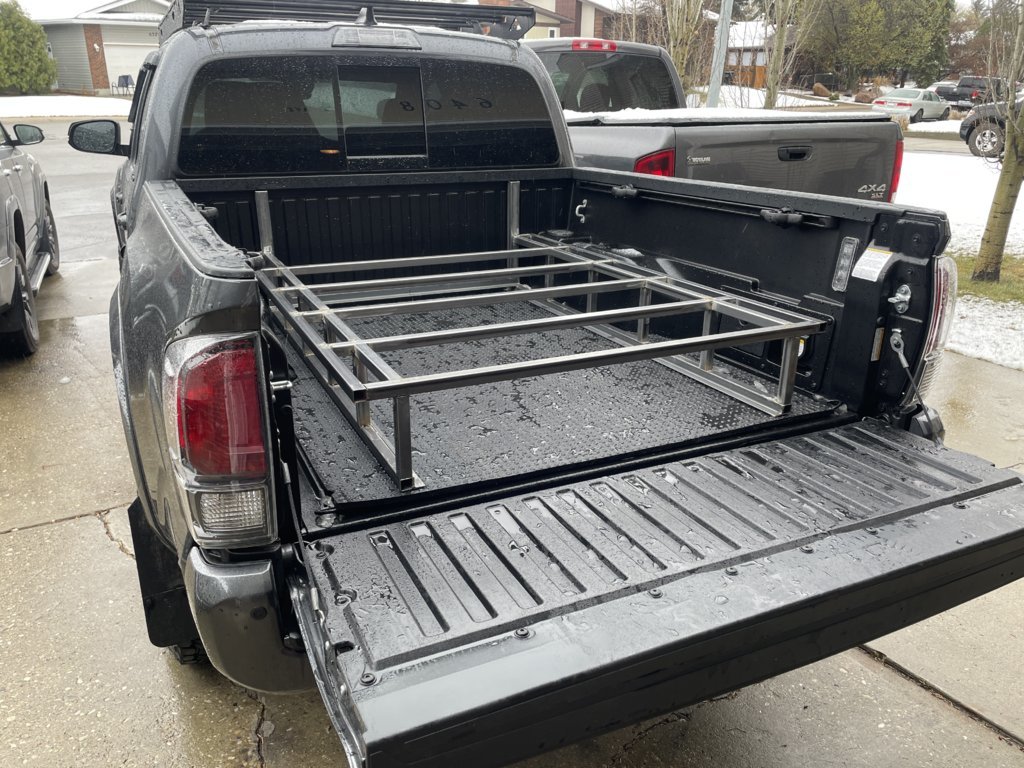

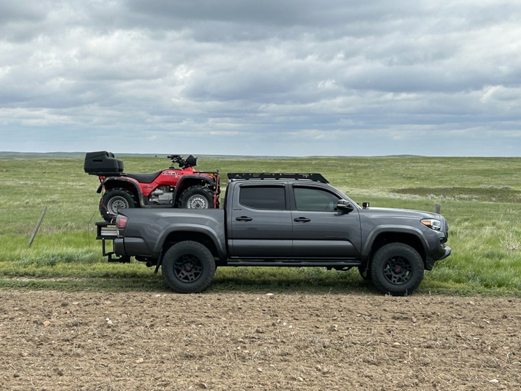

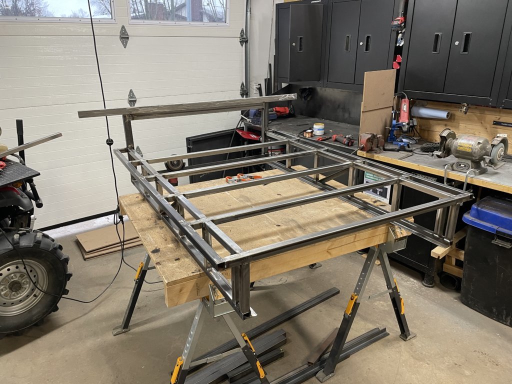

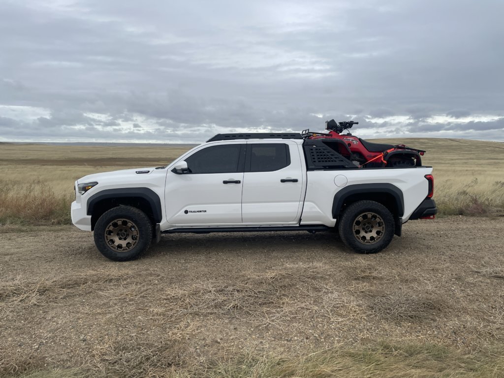

    Took the truck to work a lot and to other various places (I haul and use a quad for work).
    Made a bed rack to support my 6 foot long quad with 5 foot bed. Removable section outside the box was supported both by sliding in to the in-bed segment and by a support in the hitch receiver.
    I dont have a completed photo of it and did more work after. It’s intended to hold a drawer but I never did finish it yet cause I had other plans… see next post.

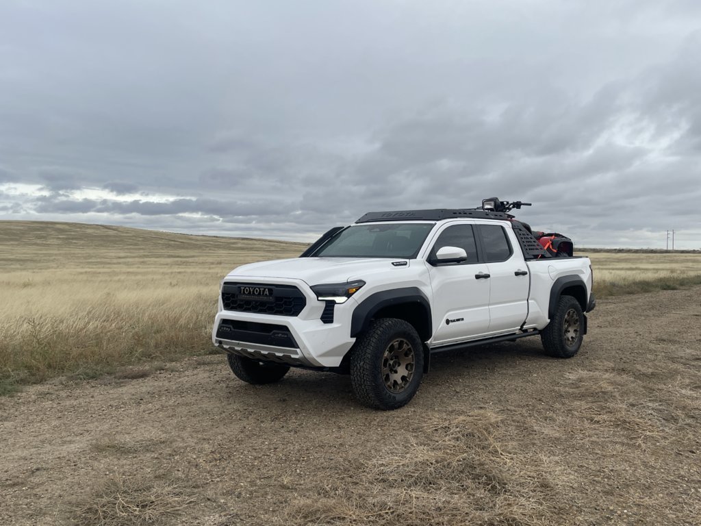

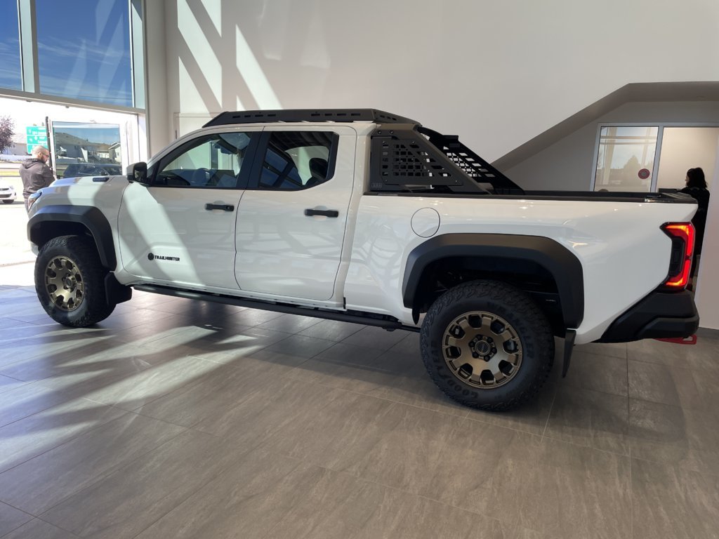

    I returned the truck to stock (mostly) last weekend and got a new toy!
    Canadian Caber likes this.
