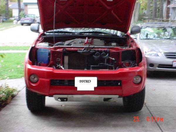

    Well, I took another plunge this weekend and did the BHLM. There are a few tips I can add to the mod, or 'gotchas'.
    1. The fourth screw is not that hard once you feel it up there. I was able to get both off and both back on fairly easy. You wont see it, but you can feel it. Use a stubby ratchet to get it off.
    2. The hardest part of the mod is pulling the clear plastic piece off after 'cooking' it. It is a mess. Do NOT grab the outside bracket for leverage. I snapped one off. I used epoxy to re-attach and it will be fine, but beware.
    3. Best advice to give is to take your time. The only real trouble you can get into is being in a hurry. Since I have the attention span of a 3rd grader, that was my biggest challenge.
    Everything off
    Side view
    Finished
    Next weekend I may do the bumper. Still thinking about the rims.
