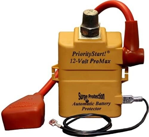

    https://www.ebay.com/itm/195473988657
    #31
