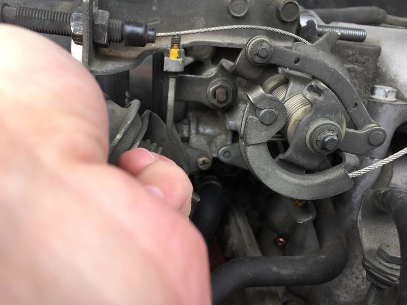

    Anybody know what this dampener thingy does? I just noticed it's keeping my butterfly ever so slightly cracked. I'd think that the TPS would catch this and adjust accordingly...maybe it is and that's why the idle is smooth but high.
    I've been hesitant to adjust it because it still has the factory seal paint on it, so it must have been right at some point.

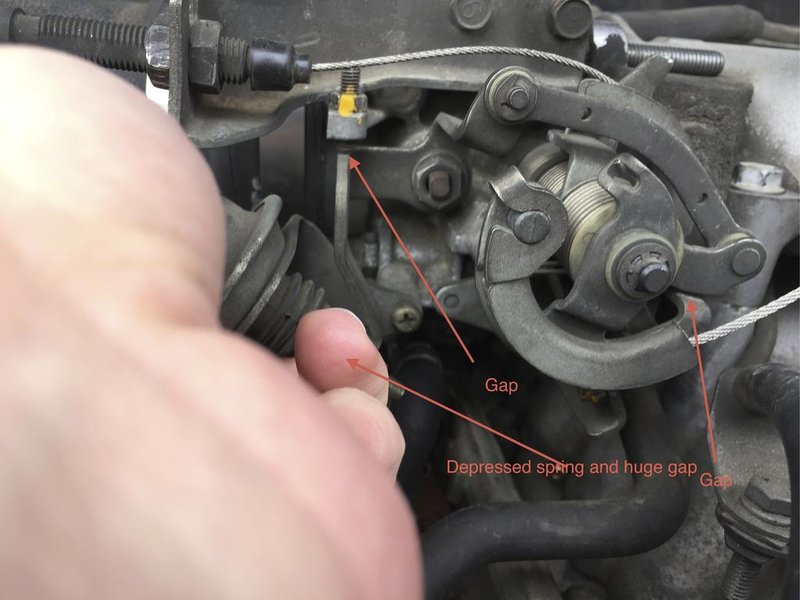

    No dice on the damper thingy. I depressed it all the way so the throttle assembly wasn't touching it and the butterfly still didn't close all the way. Same story with the stop screw at the top. There's something else that holds the throttle open.
    I illustrated this in the pics. In the first one, you can see a gap in several places as I depress only the spring. In the 2nd pic, I'm also pulling the throttle assembly until it closes all the way (about 8 lbs pressure if I had to guess).
    Is there any sort of motor on the TPS side of the throttle body? What else might hold butterfly open just 1/32"? My linkages all have enough slack in them.

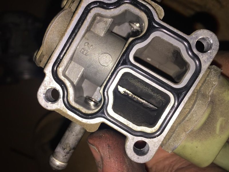

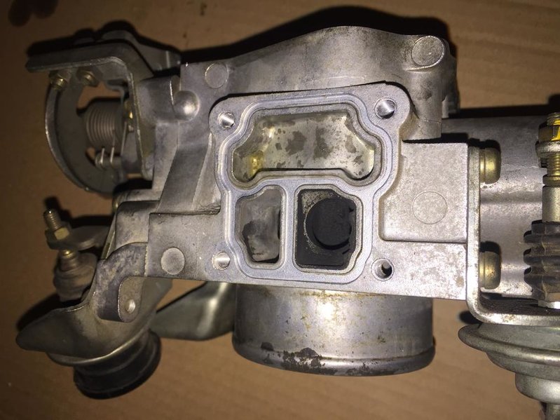

    Bonus: the last 2 pics are why you should always clean your IAC on a 200,000+ motor.
    Edit: forgot to mention, this is all relevant because I discovered today that the motor idles beautifully at 600-750 if you rotate the throttle body that extra 1/32" illustrated in the pic.
