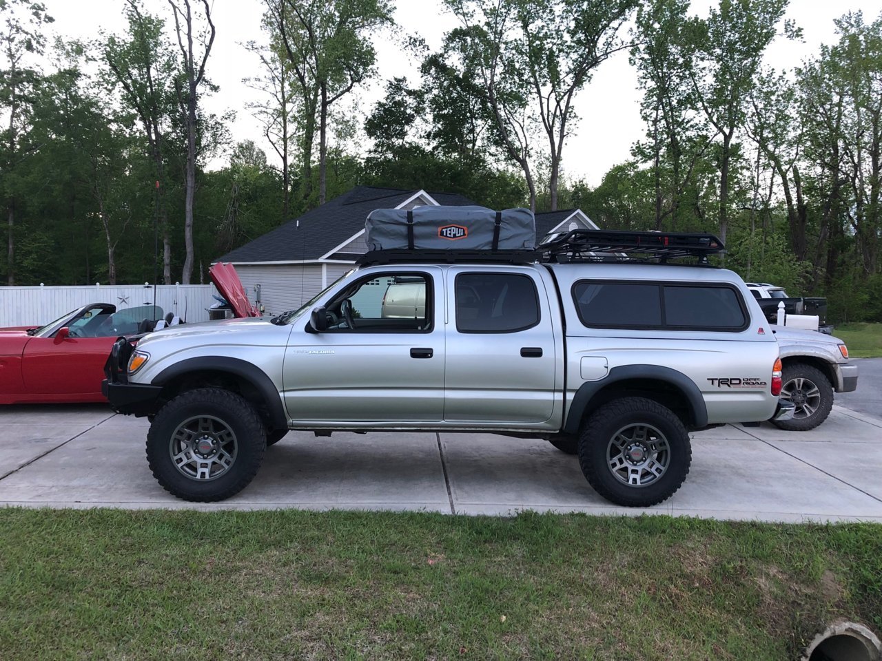

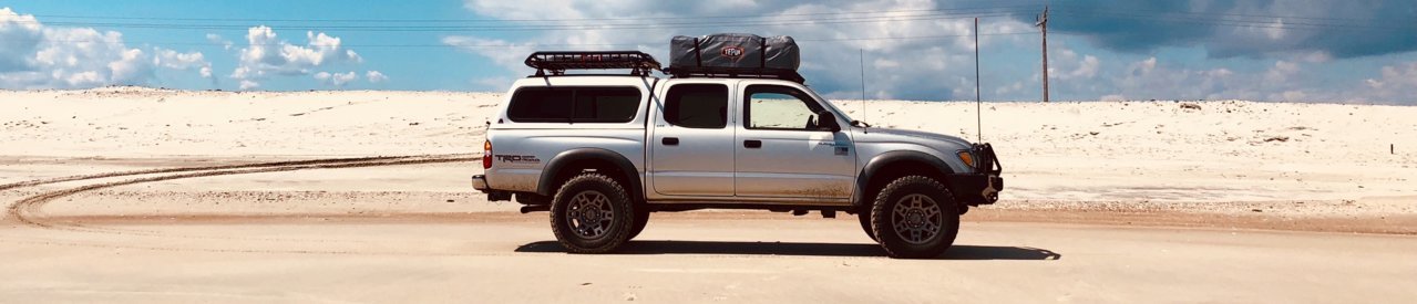

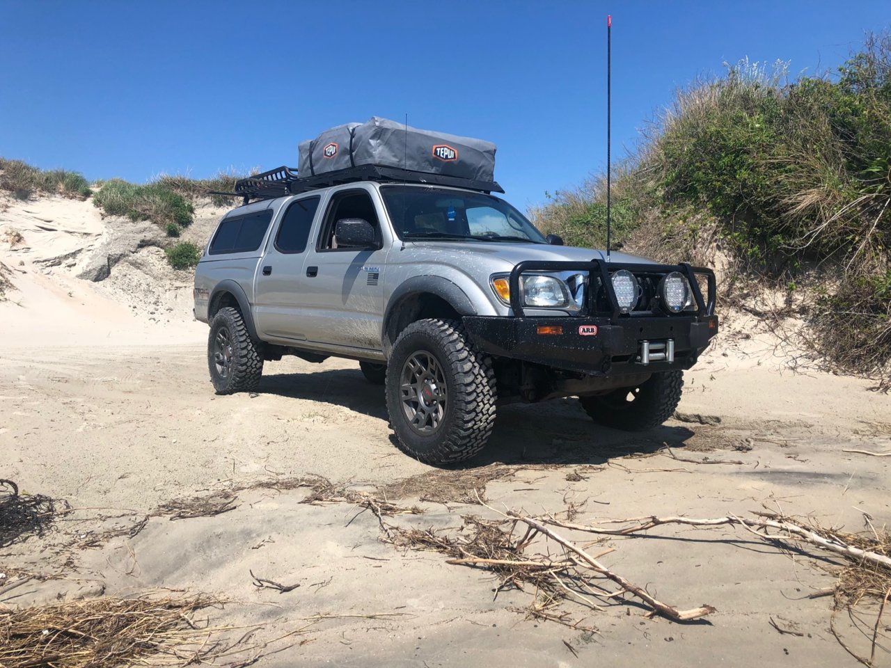

    2004 Double Cab TRD Off Road with 167,000 miles for $13,000. Craigslist found and picked up just how it looks in these pictures. I didn't even drive it before I bought it since I was out of the country. I sent the wife and said, "Get me that truck!" She crawled around under it, banging on the frame with me on FaceTime. God bless her.
    I'll post all my mods here as I do them.

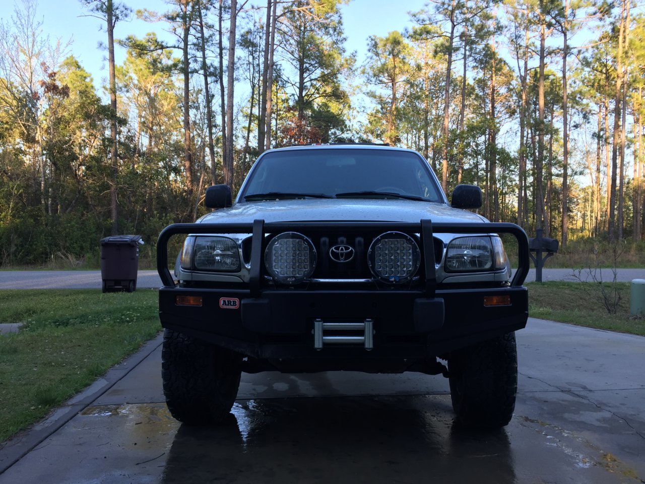

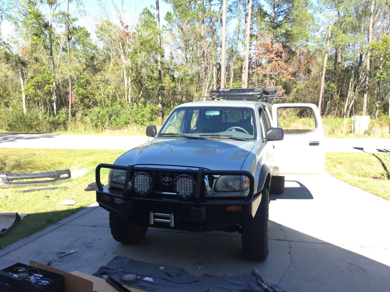

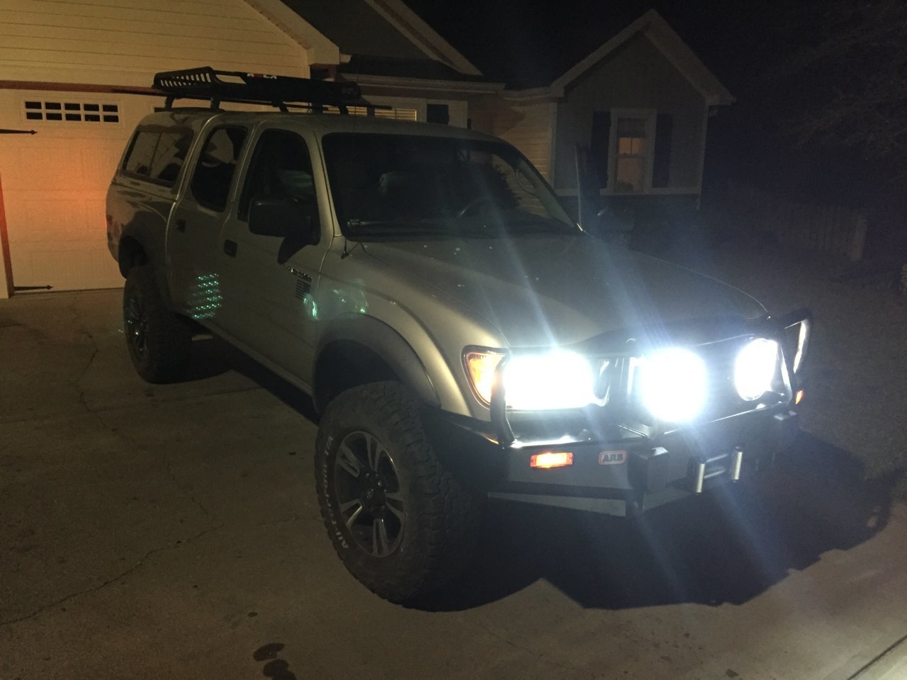

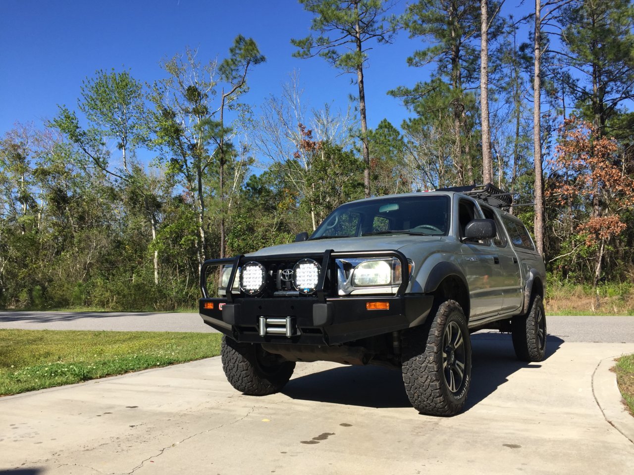

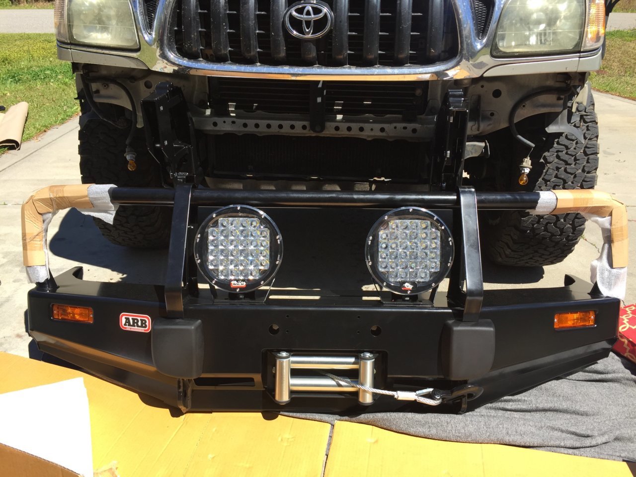

    Well, I started wrenching on Wednesday. Got the ARB bumper installed, but I had a hell of a time with the Smittybuilt winch. The bumper is made for a Warn, and that's the issue. The smittybuilt is too big.I clocked the gearbox to put the clutch lever facing down, but it still didn't fit, so that winch is out, and a Warn is in order. The instructions on the bumper were, as everyone else said, horrible. Half way through I tossed them. More of a headache than they were worth. The install was straight forward after that.
    The lights are Lumitek 96W LED Flood lights.

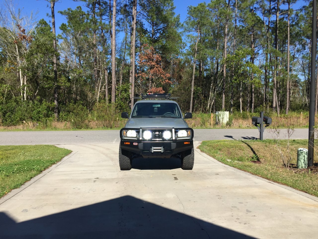

    Cleaned the Headlights up with a Mother's restoration kit. Installed an LED headlight conversion as well.IMG_2949.jpg

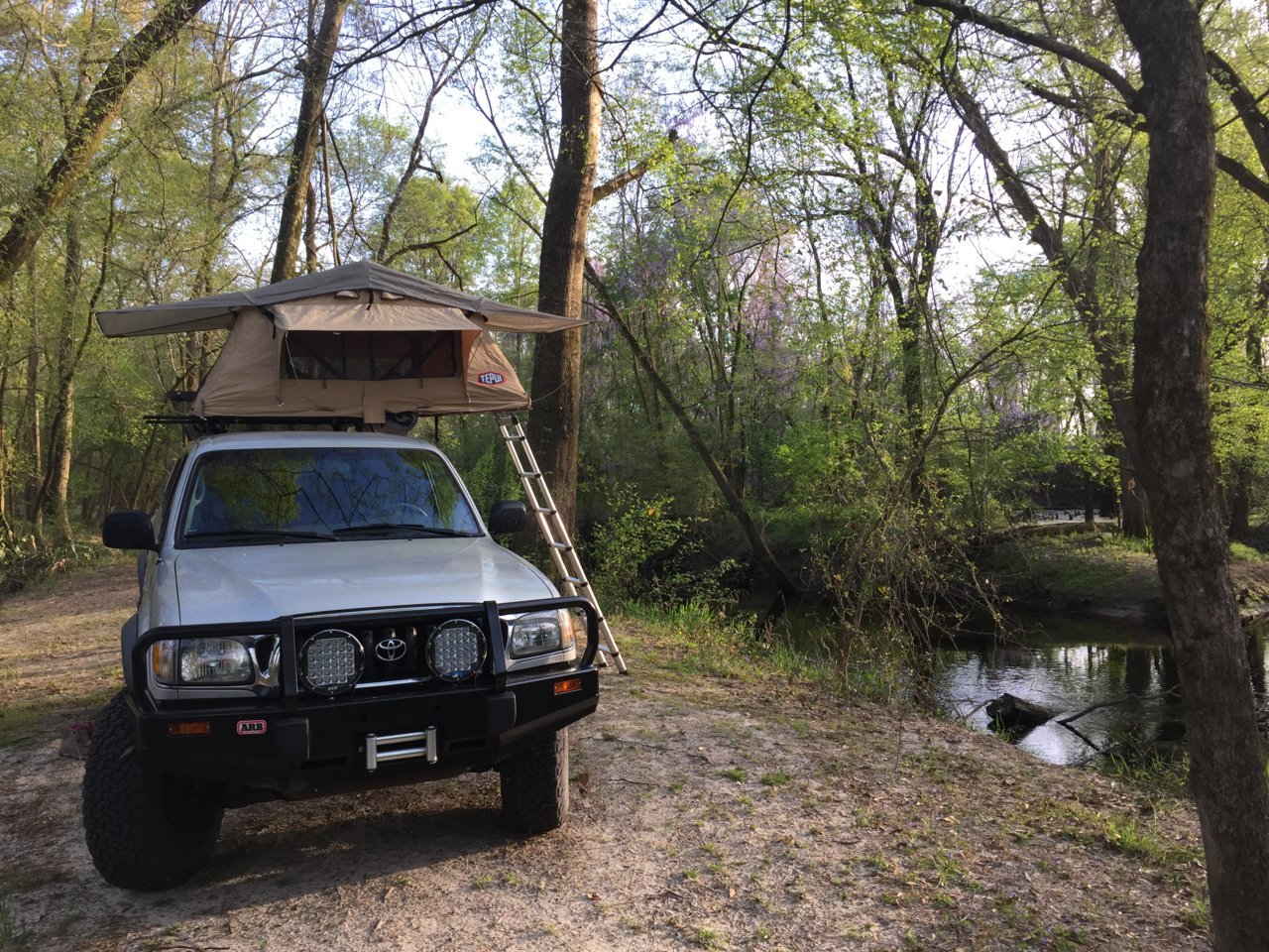

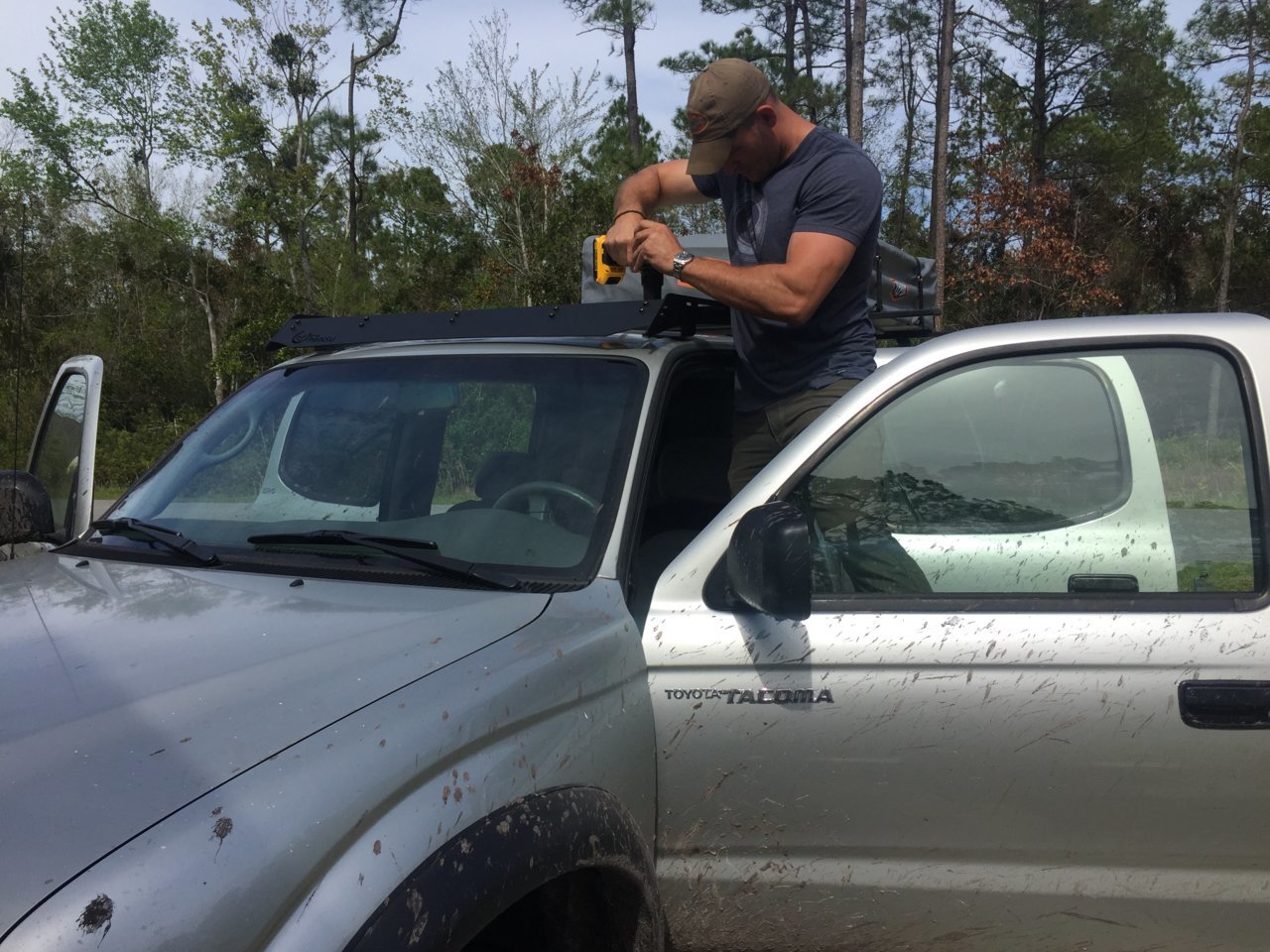

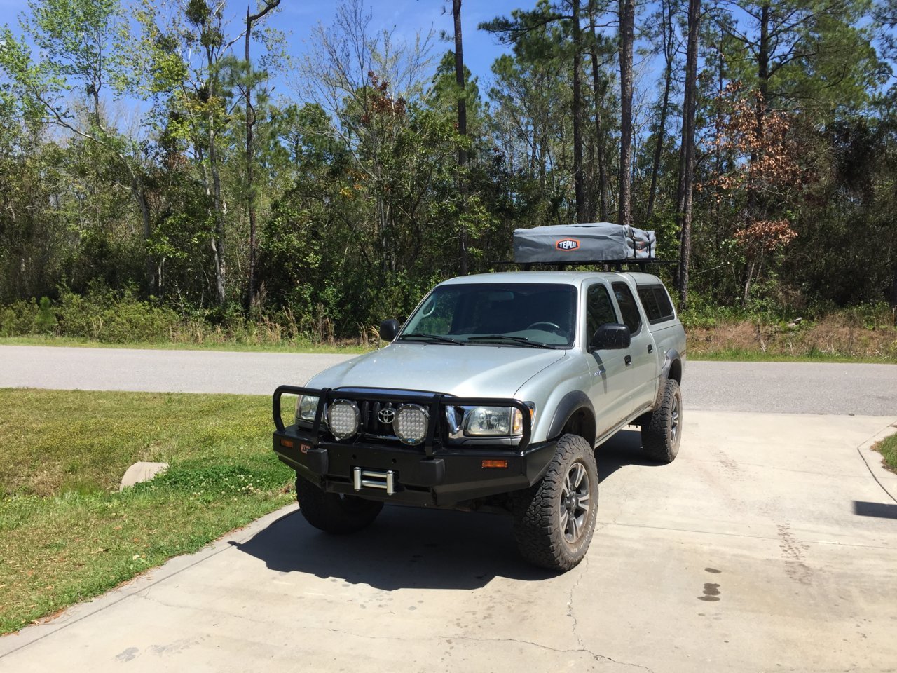

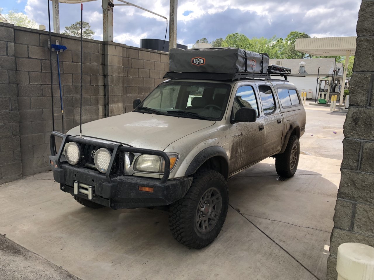

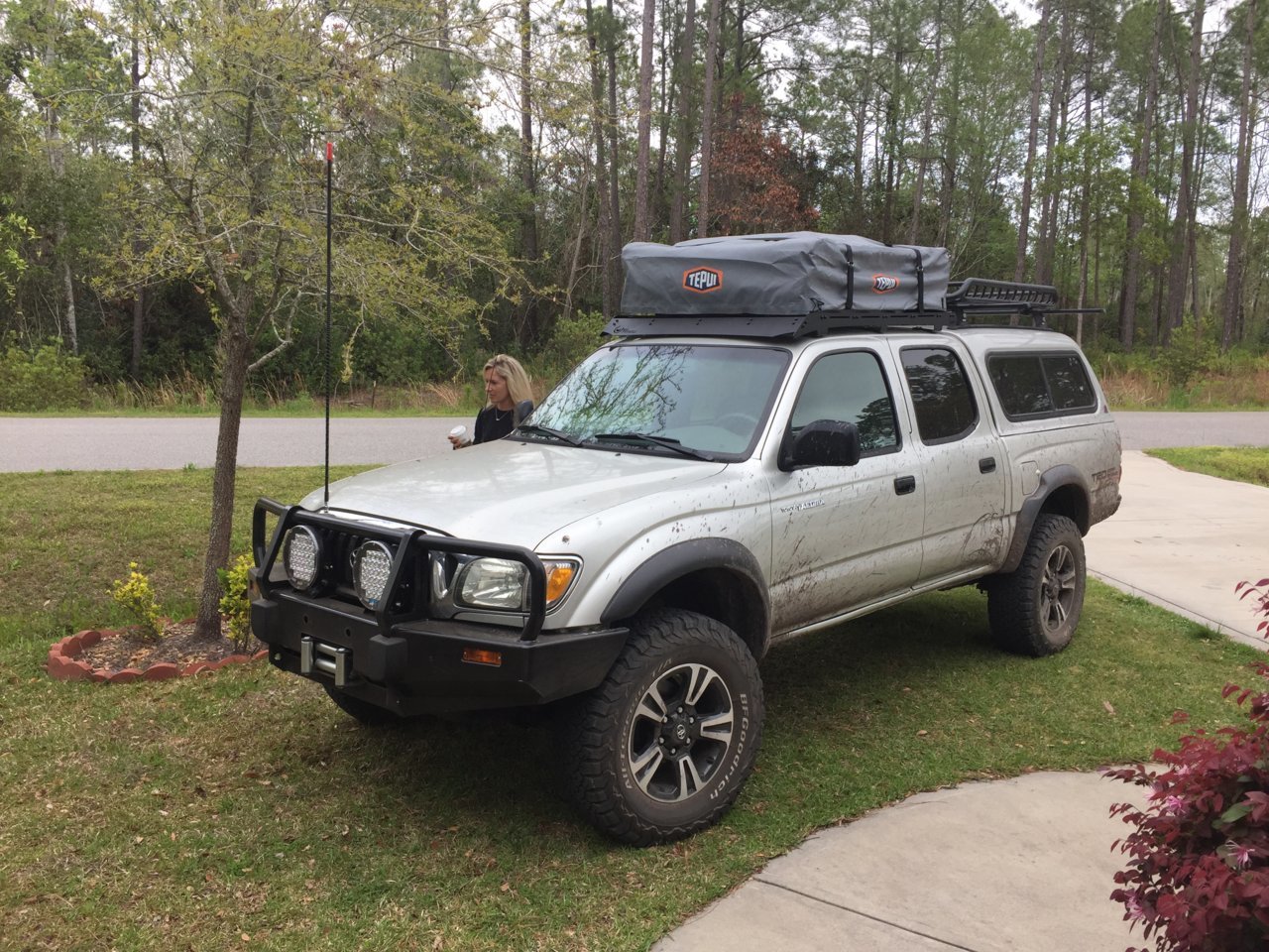

    Thursday Morning the Tepui Explorer Series Ayer 2 arrived and I immediately mounted it over the topper. I wasn't stoked on that. Not because of the topper. It seemed strong enough, but the Thule rail system didn't. IMG_2965.jpgIMG_2966.jpg Naturally, we couldn't wait to sleep in it, so we hit the road to a good little camping spot to try out the new house. It fits a two person sleeping bag perfectly, but you'd better like the person you're in there with. This 97lb tent is only 48 inches wide. IMG_2981.jpgIMG_2975.jpg IMG_2999.jpg

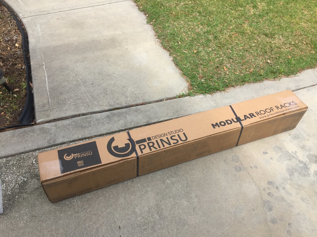

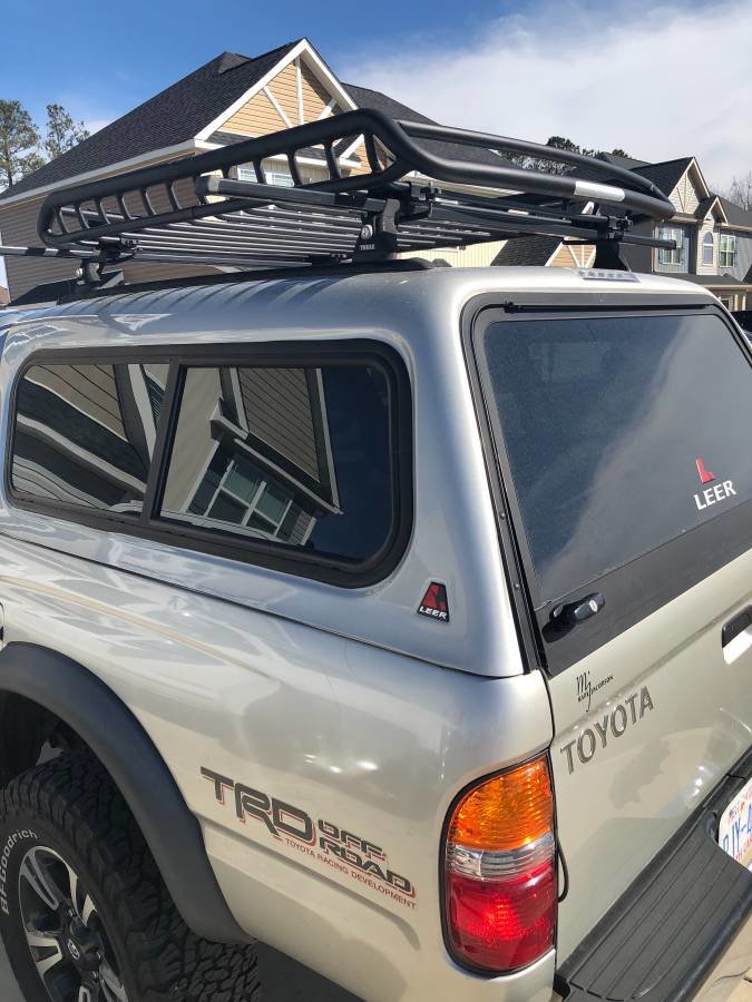

    Got home today and my Prinsu Designs 1st Gen roof rack was on the porch waiting for me. That was way faster than expected. Assembly was very easy, but the instructions are on their web site and not in the box. I ordered one with a 40inch light bar cutout, and the invoice said 40 inch cutout, but the wind deflector had no cutout. Decided to push with the instal anyway, since after giving the tent a good shake, the topper isn't the best place for it.. IMG_3046.jpgDrilling holes in your roof is not the best feeling.. Also, drilling through your headliner.. I added some silicone under the plusnuts to make extra sure it doesn't leak. Fingers crossed.IMG_3049.jpgMoved the Tepui from the topper to the cab and installed a CB antenna on the ARB bumper. The antenna is a bit taller than the tent, so if it clears, I know the tent will clear. I reinstalled the roof rack on the topper too. IMG_3057.jpg Tent over cab made a huge difference. Everything felt better- more balanced and much more solid.

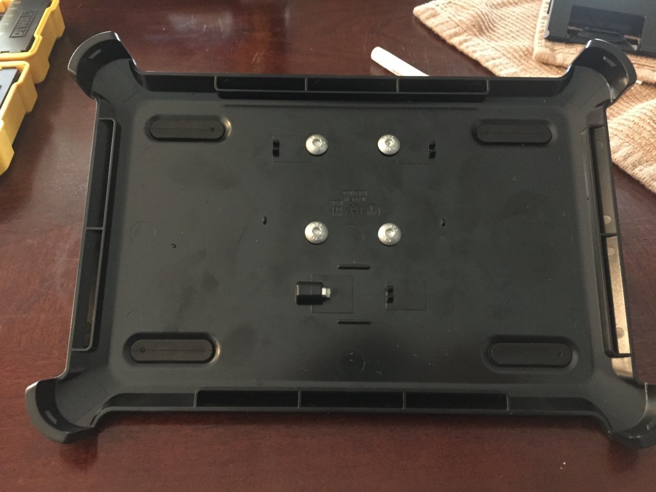

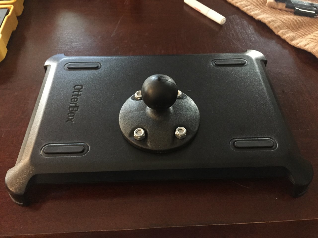

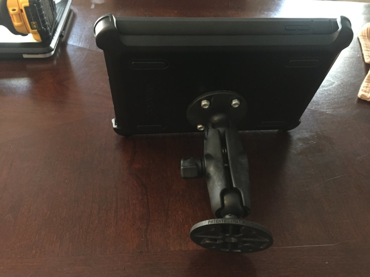

    Tonights project.. Ram Mount/Otter Box Defender hybrid. This, running Gaia or Hema will be the primary Nav tool. I like both initially, but haven't fully committed to either. Hema seems a little more intuitive. I have an iPad Mini 3 with LTE. IMG_2958.jpgIMG_2959.jpg IMG_2960.jpg

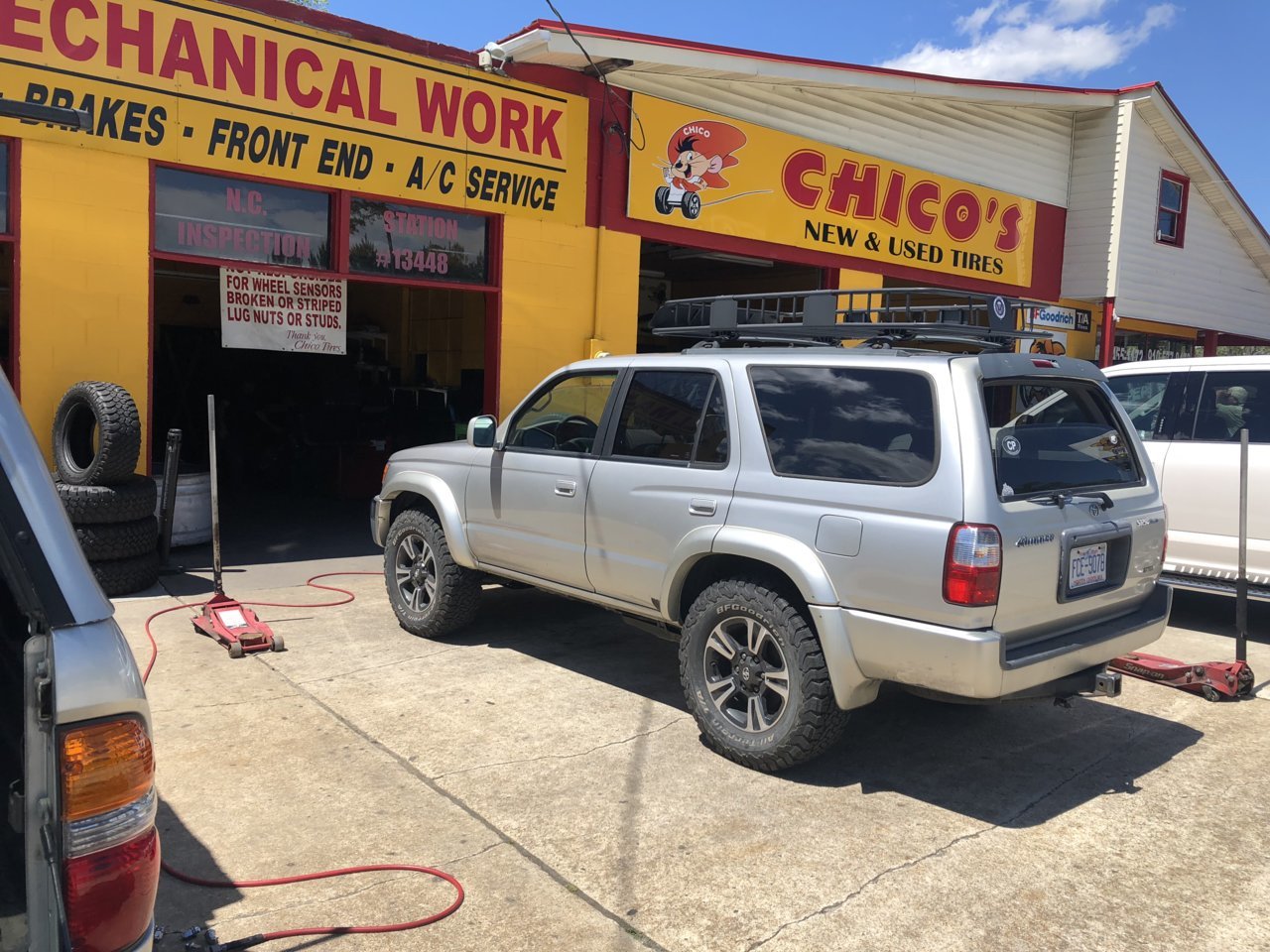

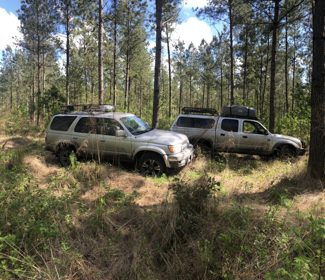

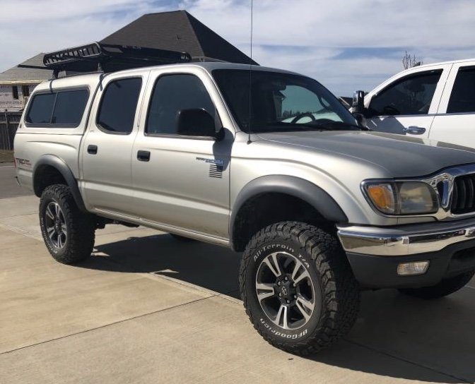

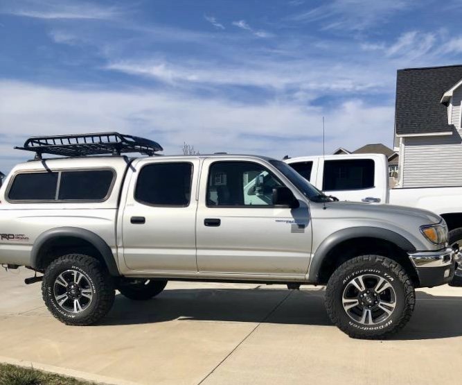

    Drove out to Raleigh to pick up a set of TRD Pro wheels from @STrooper today and put the old TRD Sport wheels and BFG AT's onto the wife's 4runner since it was in need of new shoes anyway. I put a set of BFG Mud-Terrains on and picked up a matching used one for a spare. They are a little narrower than the AT's (went from 265/75R17 to 255/75R17), and I added about an inch of width in my track with the TRD Pro wheels. As with everything, we immediately have to go test it out so we headed deep into Richlands in search of some dirt that didn't have pavement on top of it.C9A31C6D-A576-4992-AAA2-BE2C3DC93DC1.jpg 2F6590DE-0621-4A74-B1F6-AFC8810D0DC7.jpg And, a little scrub-down afterwards. But not for the 4Runner. She likes to stay dirty.BD819A60-FBF7-4232-8336-4C052A129C24.jpgDC32EACF-E3E7-4BBB-ADE0-56DE3A2F37DC.jpg

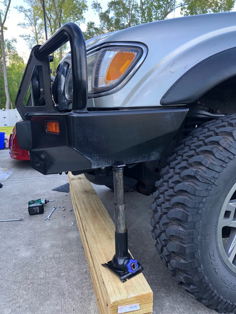

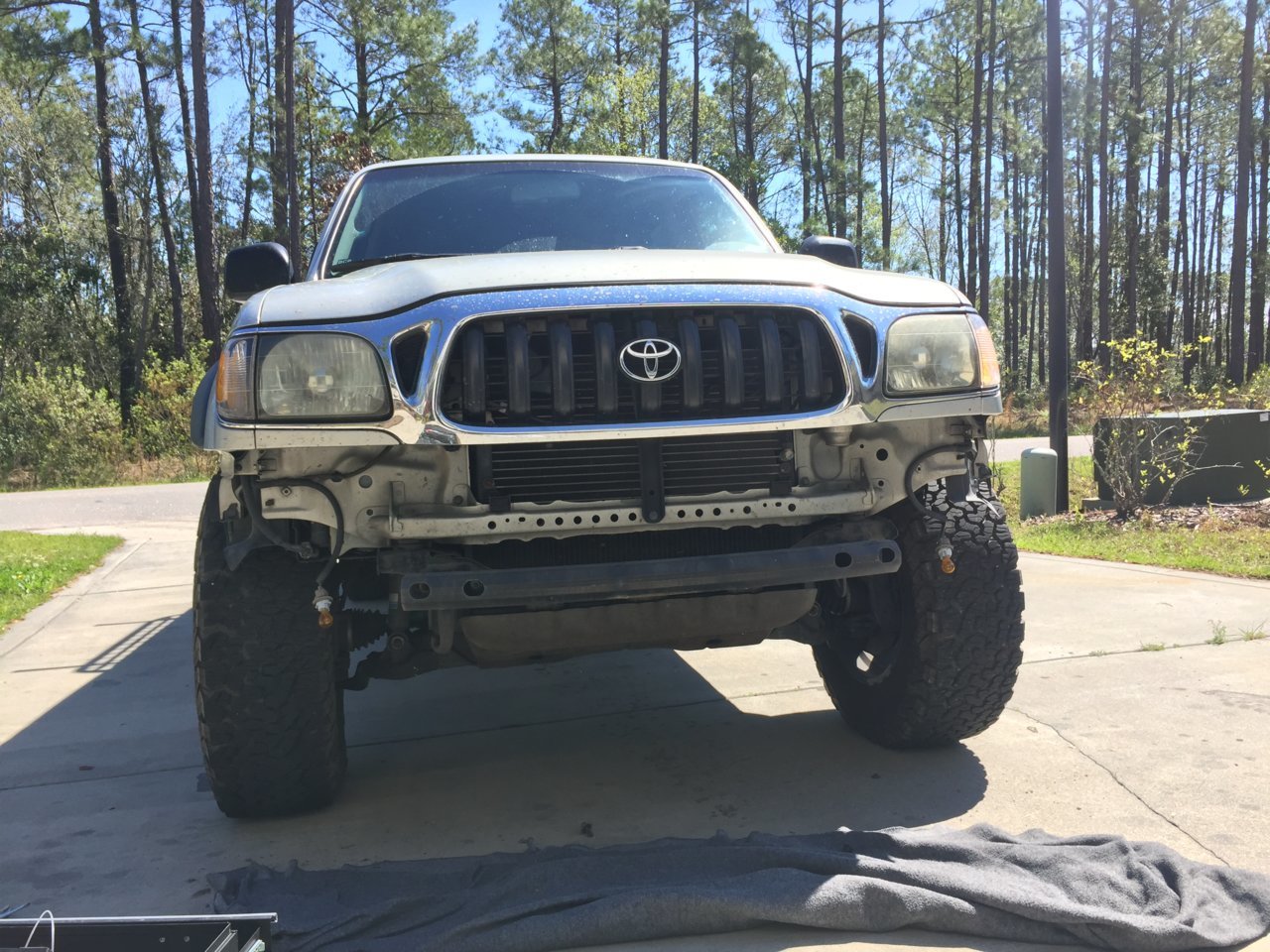

    My bumper wasn't quite sitting as flush as I wanted it to be, so I loosened all the bolts holding it on and then set jacks under it to get all my gaps looking right, then tightened everything back up. Maybe the directions from ARB said to do this, but I don't know since I threw them out. I see a lot of ARB bumpers with a large/ uneven gap, so I doubt the instructions mentioned it.. It took a few times of going through the same process, loosening, jacking, and tightening, since as I let the jacks down everything relaxed a bit and the gap widened. Heres some pictures.
    End result. You can see in my older pictures how bad the gap was before. Thanks @STrooper for the sweet TRD Pro wheels! IMG_4604.jpg
