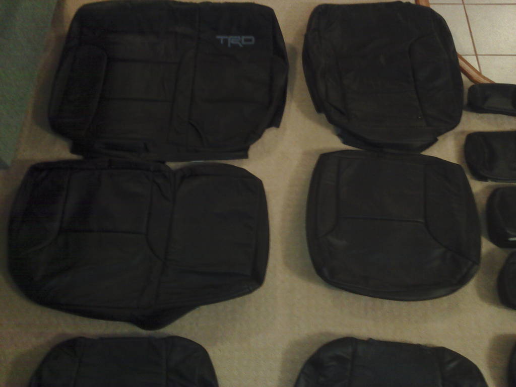

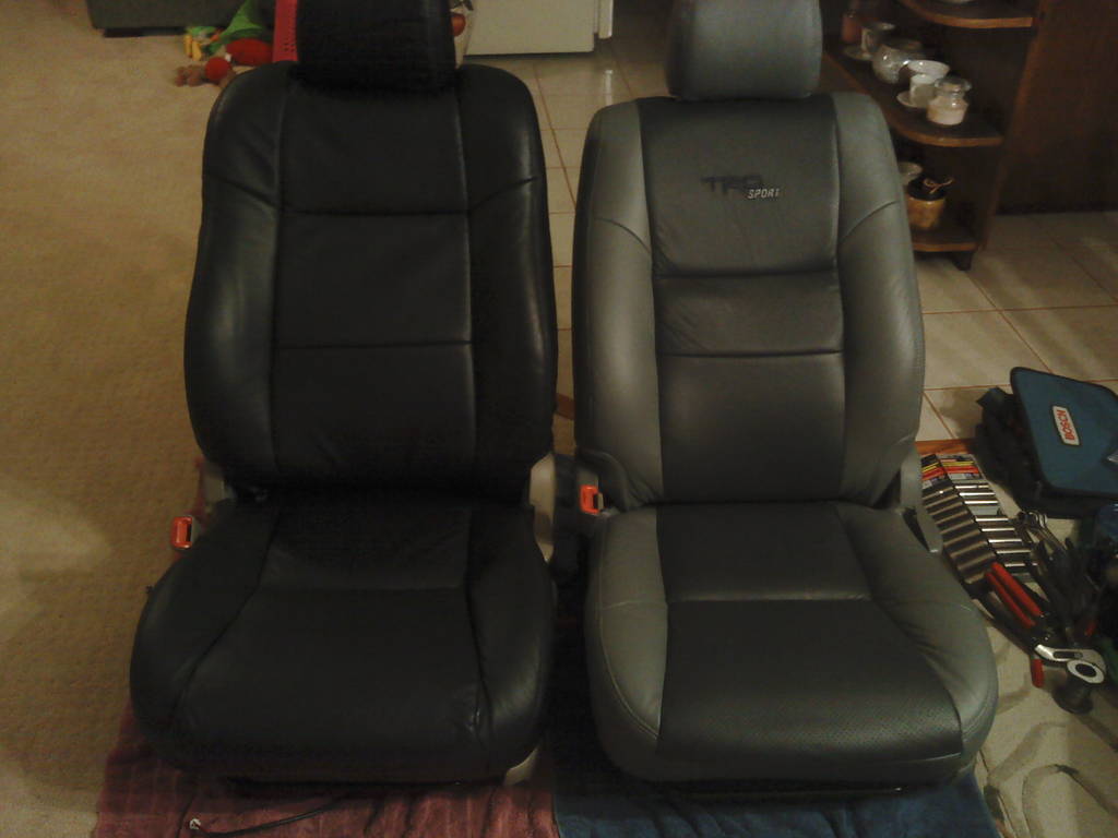

    16. Bought different leather interior, Katzkins in all black. Heaters on bottoms and tops. Took Sport buckets out of my trd sport truck and swapped old leather into it.

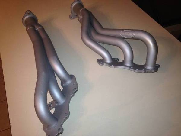

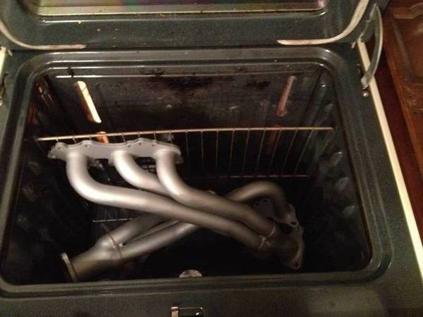

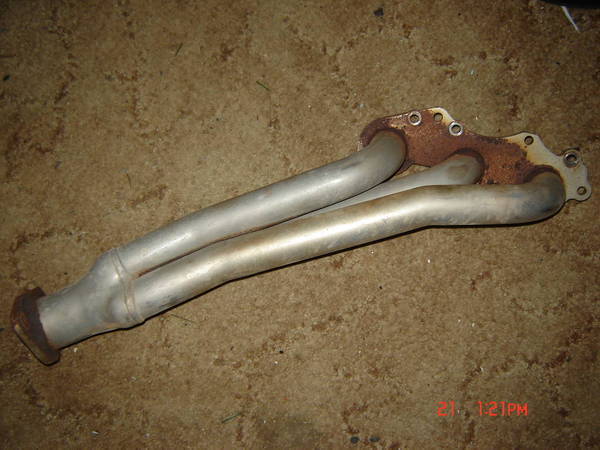

    Got some DTLT's, the ceramic was bad around the flanges as you can see.
    After a lot of sanding, Naval Jelly (works wonders on rust), Dremeling, etc....I got some high temp ceramic paint and sprayed it down (torched it between coats a bit)
    It's in the oven for the second time now!
