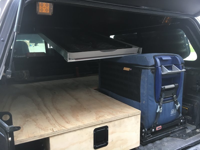

    That's awesome. Got anymore details on the materials you used and how you attached it at the hinge end?

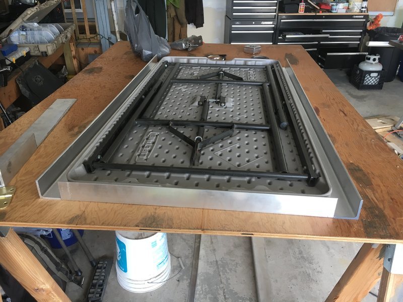

    Just an average two hinges. I drilled through my cap ceiling to mount everything. Between using rubber washers and the RTT over top I'm not concerned about water getting in. The cap I got doesn't have the channels for the load bars, but if it did I would use some aluminum plate to bridge the two areas where the factory mounted bolts come through and use the plate as a base for the mounting hardware for this mod. Three sides are 2"x2" aluminum angle and I cut a 3" wide by 3/16 plate for the fourth side. Some cheap gas struts from Amazon and a couple latches from the hardware store. The tray portion could have been so much cleaner if I had a tig machine but I'm still saving up for one. Instead I riveted everything together.

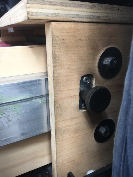

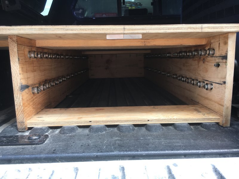

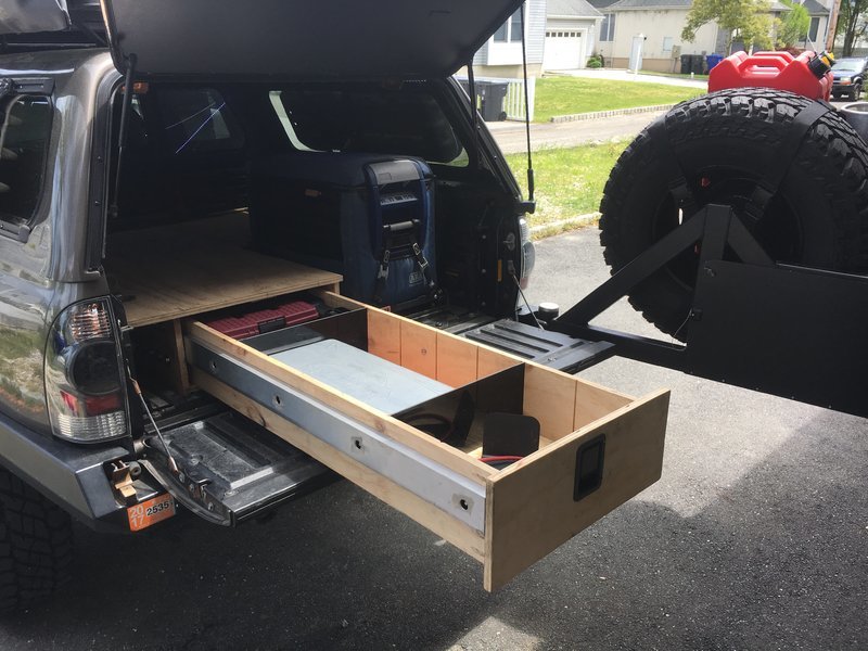

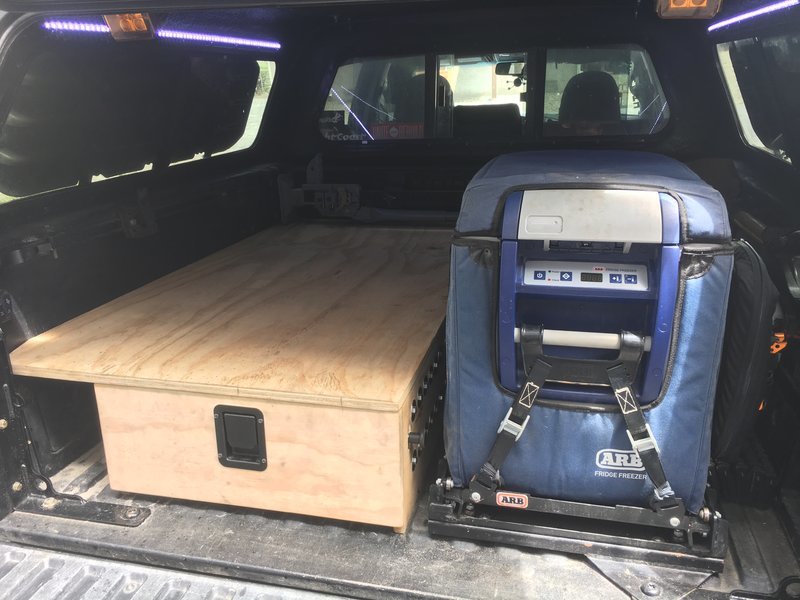

    Also built a drawer system based off of @2012Taco build. Bunch of skateboard bearings, aluminum channel, and a Kregjig to get it done.
    I added a spring pin to lock the drawer open, the latch locks it closed.

    I dig it. Especially that pin setup :thumbsup:
