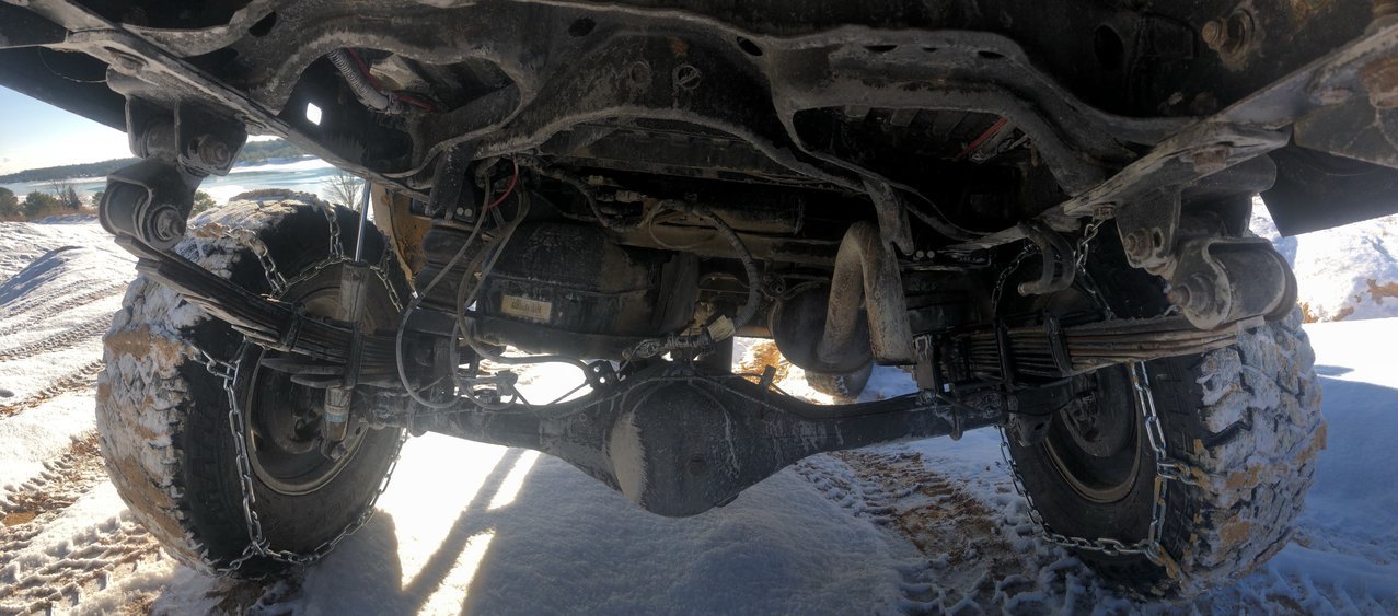

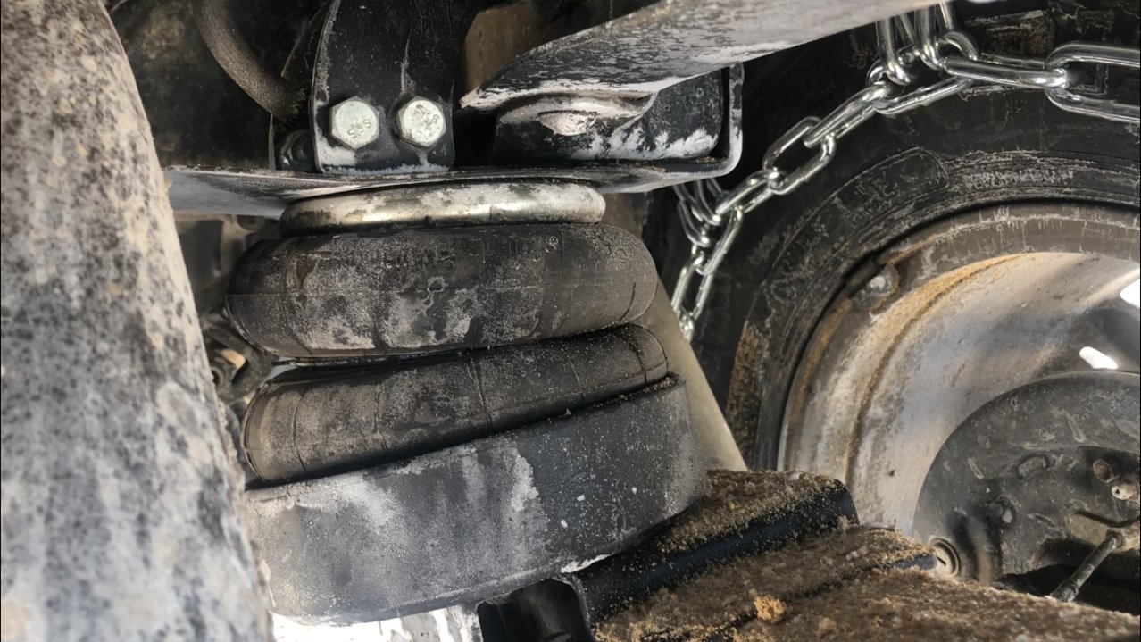

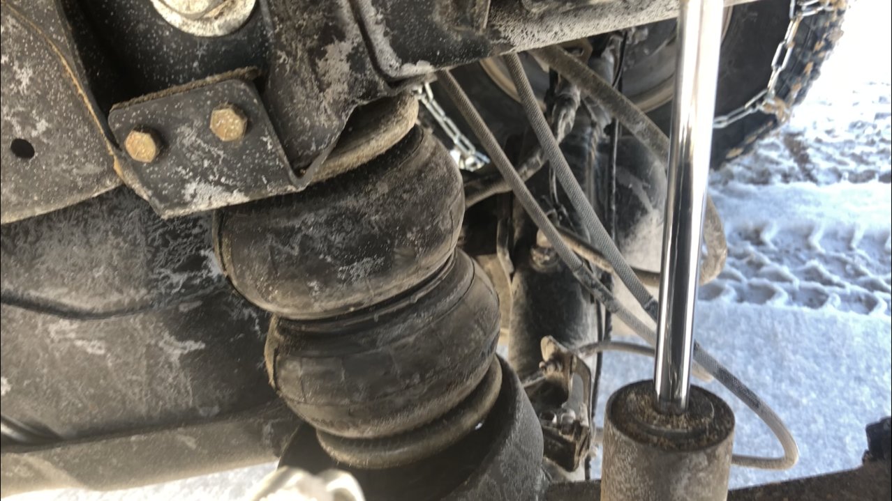

    Yea your limit for up travel is the psi of the bags. Down travel doesn’t change if you use the cradles. Basically if your in a situation that requires your max suspension travel your most likely gonna air down your tires to something lower then highway pressure. Just do the same with your bags aswell. Results may vary so this is just an example, you’d have to mess around with your setup to find the sweet spot. But for the sake of argument you run 35 in your tires on the highway and 35 in your bags, you’d set your tires to 17-18 for off-road. I’d use that as a baseline for the bags aswell and adjust as needed.

    No issues personally. As potato described you can mess around looking for the sweet spot. Unless the trip or terrain in gnarly I keep my street setting offroad. This was a very cold day over the winter and last set the bags were 20psi, not sure if the temps adjusted that just technically saying. It’s not the craziest flex and my suspension isn’t maxed out but you can see the one bag compress and the other extend..
    A0A481B0-DAFF-40B9-A09F-6225B3DAE5FC.jpg 72C2A3A4-CDB0-4D6F-A947-C91F347E08BB.jpg B9C360B3-B2E1-4B2A-8D80-9460EDD08B5C.jpg 736DBE00-6105-42B4-9C9E-93E6696D7909.jpg
    Next time offroad I’ll try to get better pics with a shot of the bag at ride height.

    D00d second pic your axle looks bent AF:eek:

    Looks like MAYBE he took a panorama picture??

    Fisheye maybe lol

    Pannohhhh

    Chux has the bow shaped axle mod. It's popular with the overlanders.
