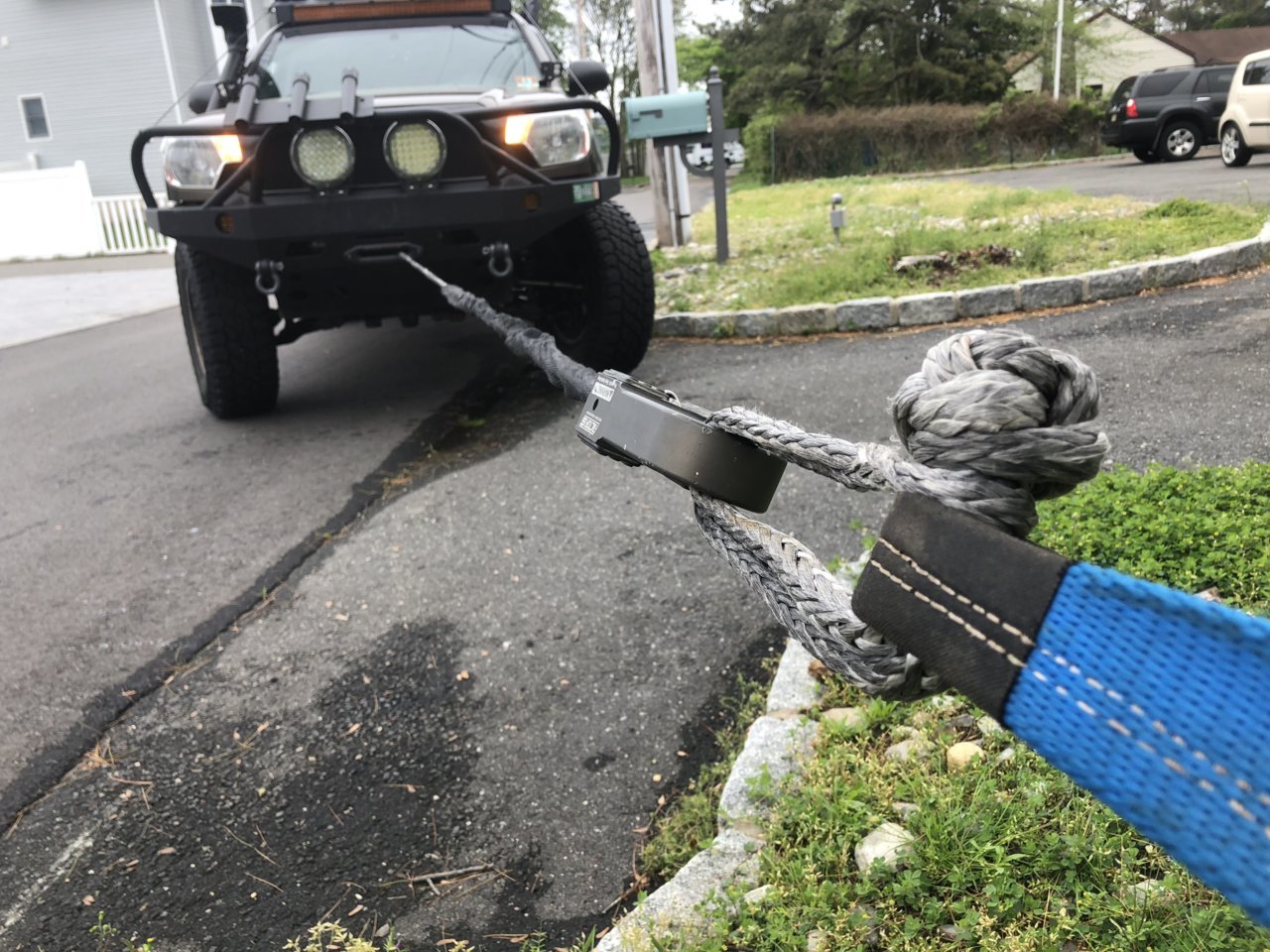

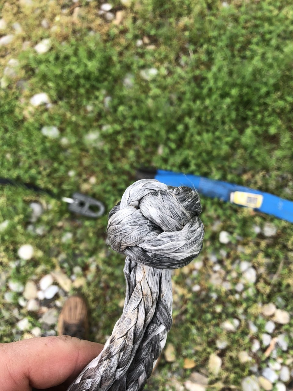

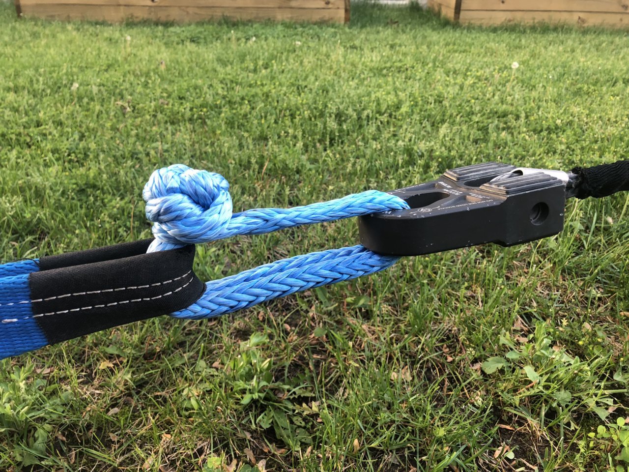

    Been getting into these soft shackles..
    Correct orientation of load on a soft shackle
    After winch tension
    1AFA6C86-ACAE-4160-94C4-6972122F137C.jpg 7D25E493-8070-45A3-8BC5-632376EF03B1.jpg CFBF35D0-6BC1-4525-BE4F-708DBAF22946.jpg

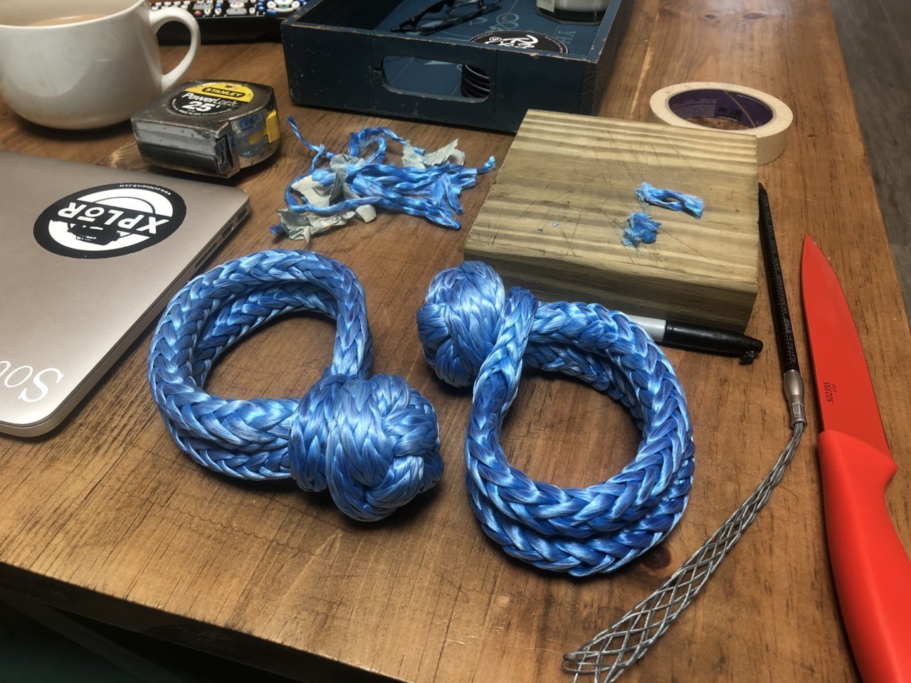

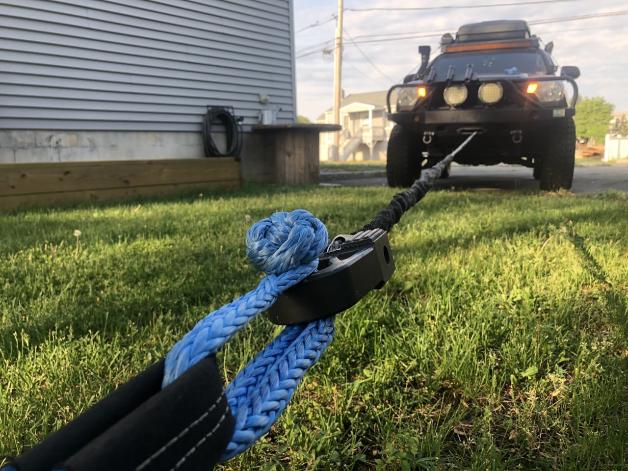

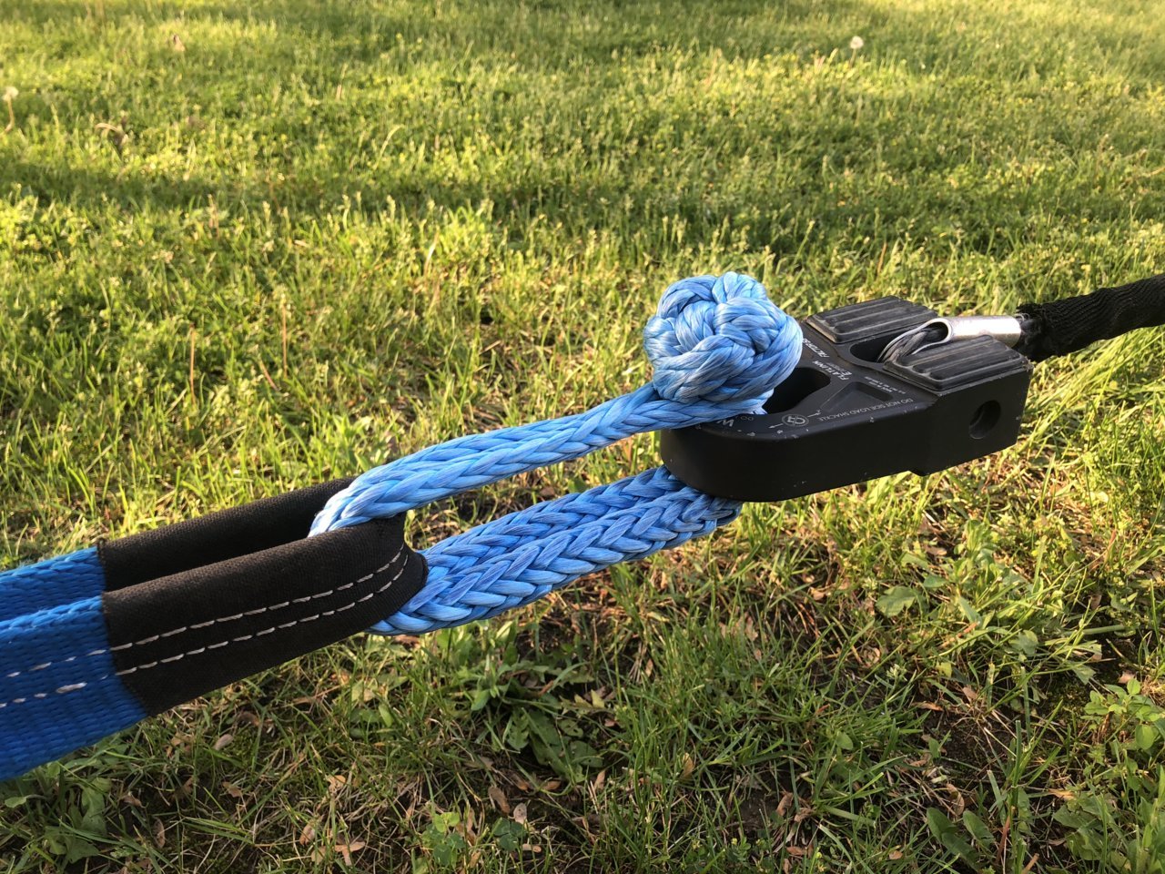

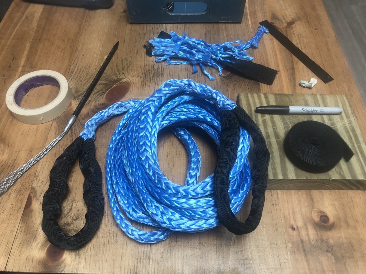

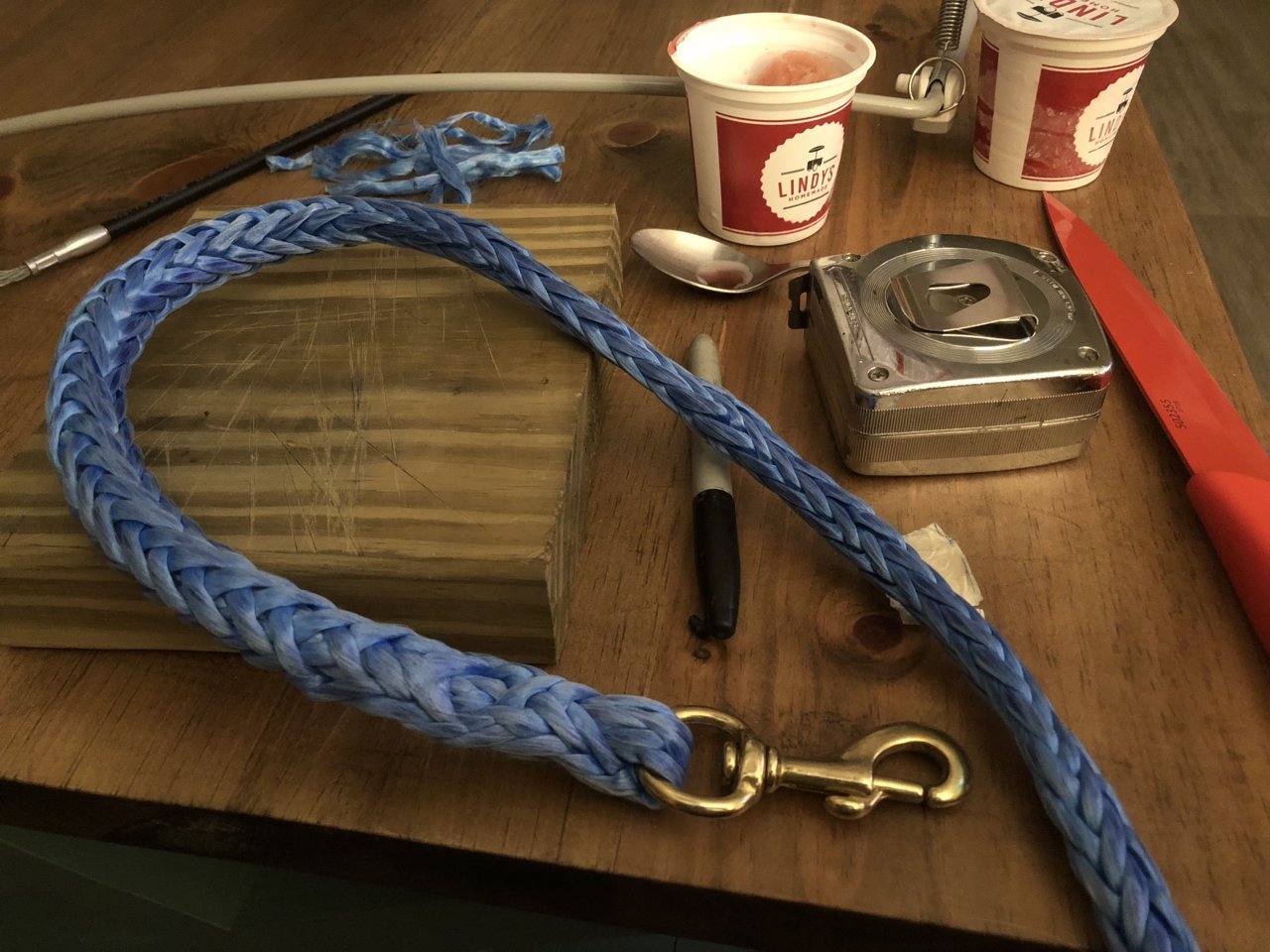

    Tied a couple more this morning. 3/8” Dyneema 6” Soft shackle
    5D57DA0A-4CE5-42C6-A087-C30905DE29EC.jpg C6FFC77B-88EB-4F24-98E6-F64032BF59C0.jpg

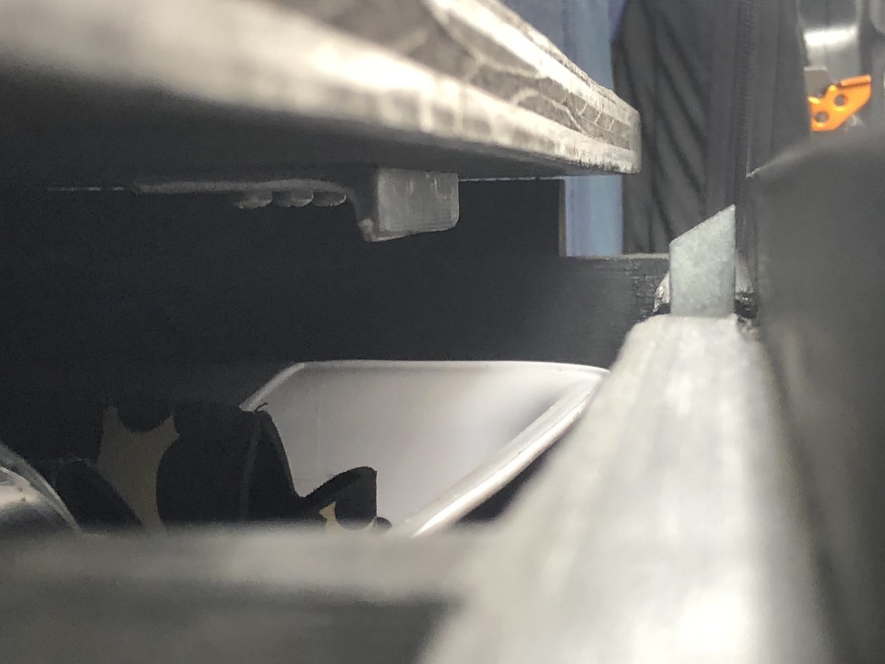

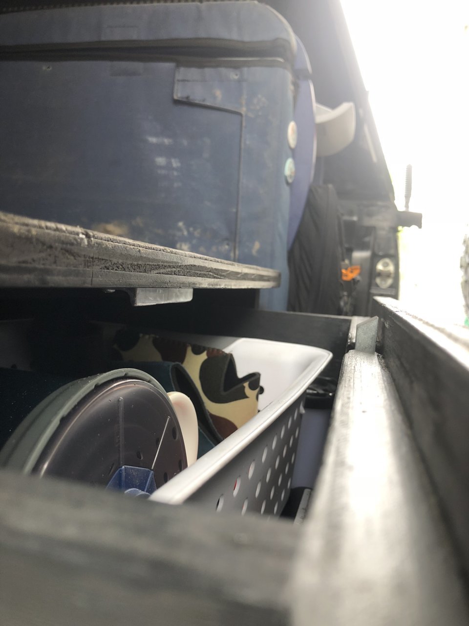

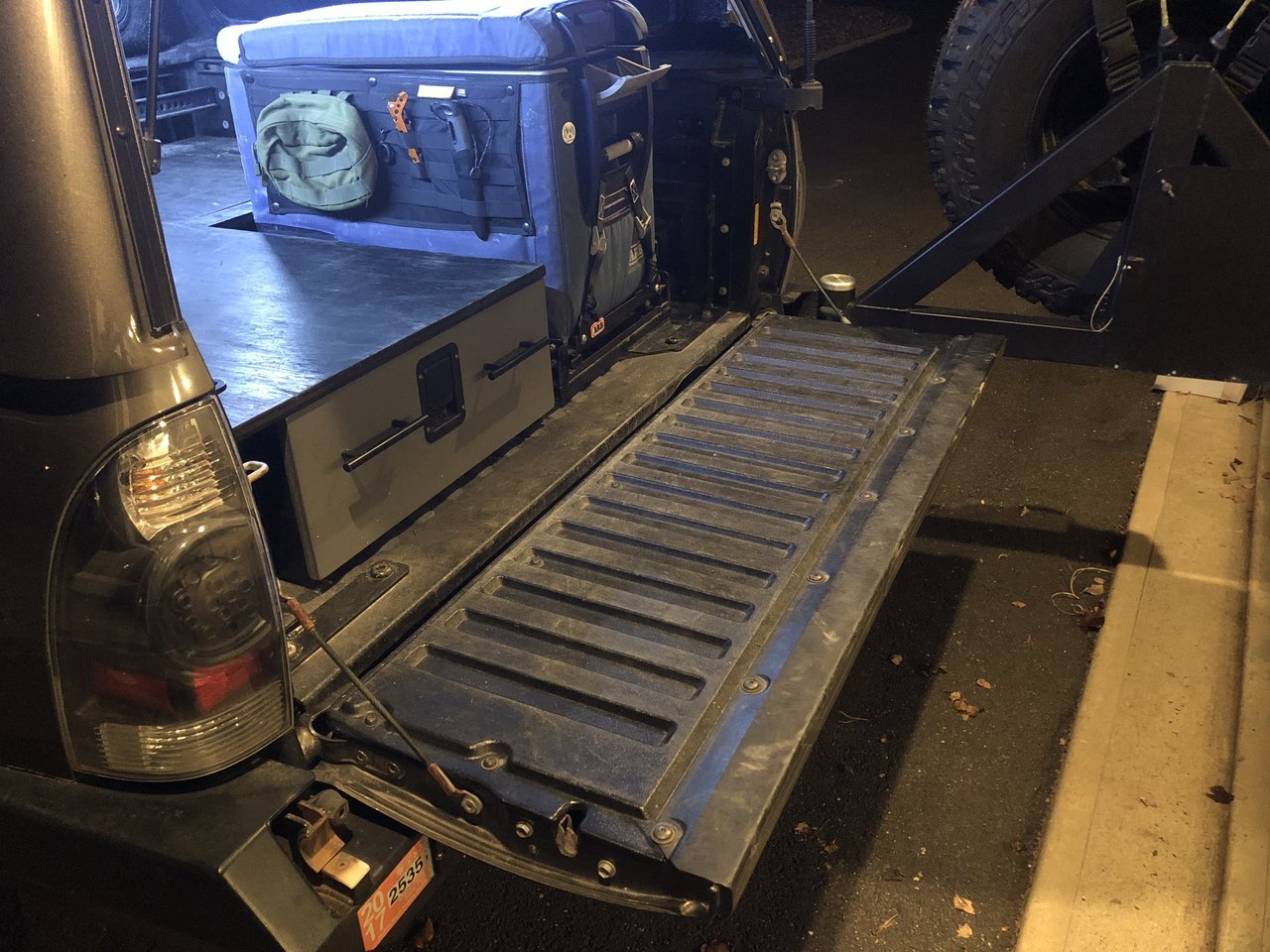

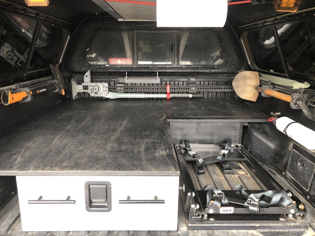

    How did you attach the paddle handles on the drawer? Was there a bracket that came with it for it to latch into? Im not too sure on how to go about doin it. Or did you notch out the wood?
  5. May 27, 2018 at 2:39 PM
    #2465
    Chux
    Chux [OP] Pura Vida
    Oct 1, 2013
    #113652
    6,234
    NJ beaches
    2013 TRD O/R Beach Buggy
    Click on my Build
    I was actually surprised their wasn’t a catch that came with the paddle latch.. I ended up taking a piece of aluminum angle (iron) and trimming the one side down. It was the first thing I could think of and had worked flawlessly since like it was ment for the latch.
    B71EC191-6919-425A-9642-16EF108EEAF5.jpg 0D8F74DC-A7A2-4B9F-ABF7-8A3D3530B4B2.jpg 0EACE1C0-8920-4ABC-B652-7EE268144509.jpg 63CAB32F-88DC-4FD8-965D-EBDDBEBF587E.jpg

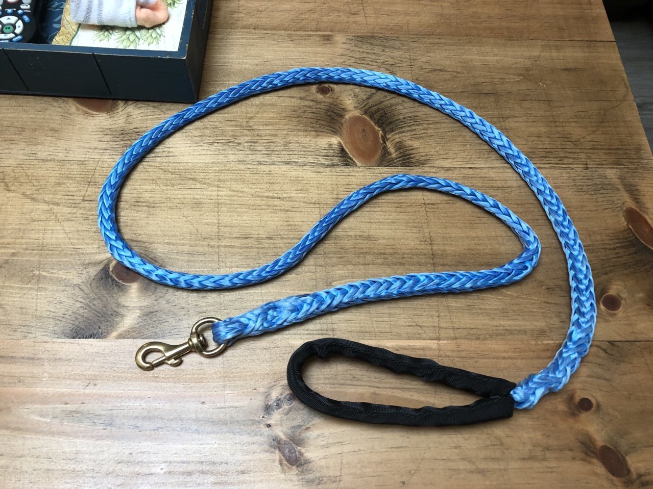

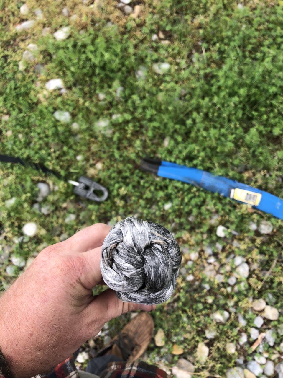

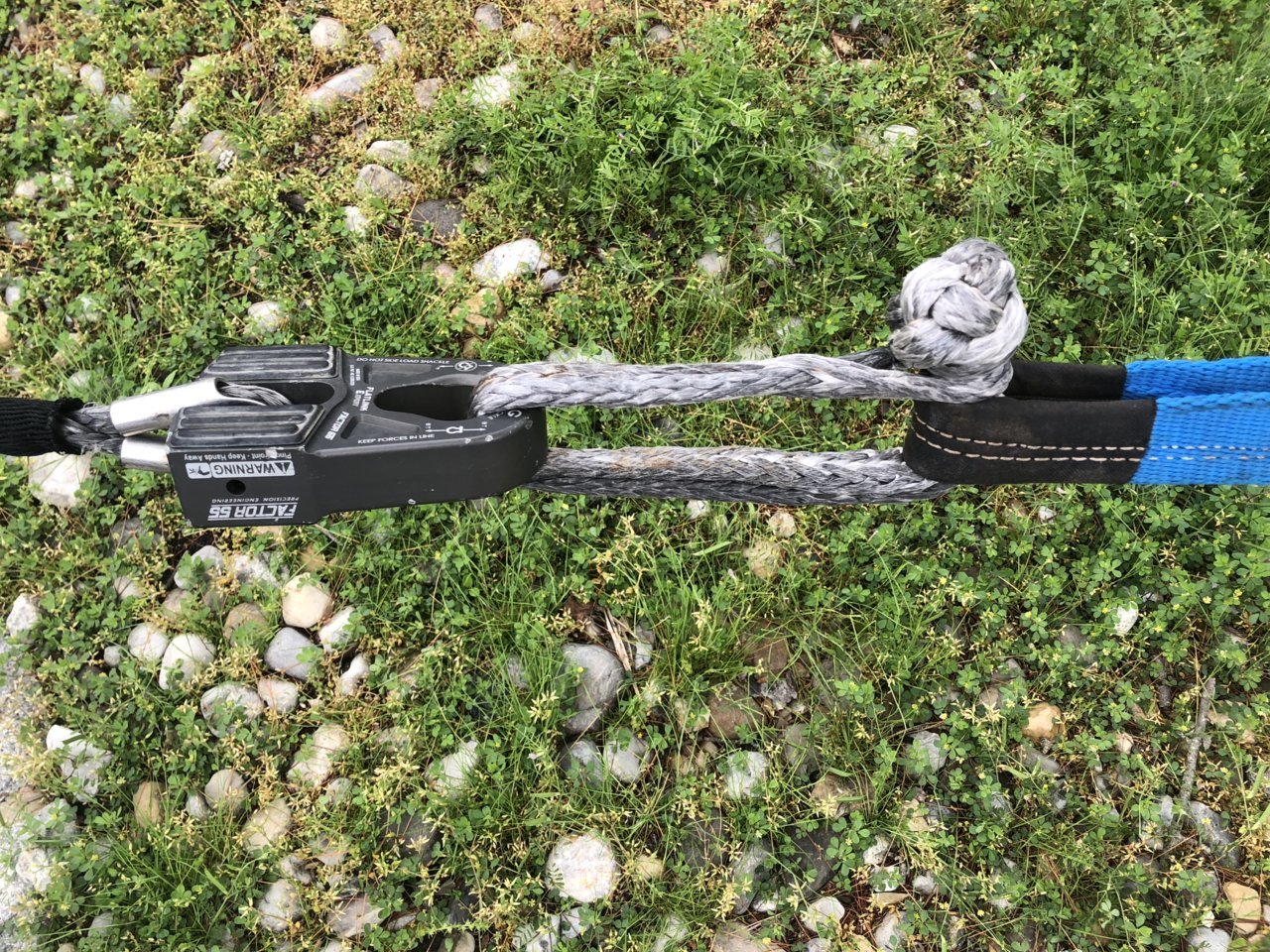

    Tension tested new soft shackles. They are looking good!
    598CFAE6-DB39-4DFA-B989-D022C6923E9B.jpg DE693F6D-EDA3-4700-805B-A2FBBDCAED86.jpg 68BDD2F5-96F2-40CD-B6A9-ECA25DE03F33.jpg

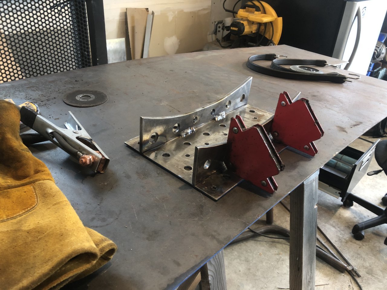

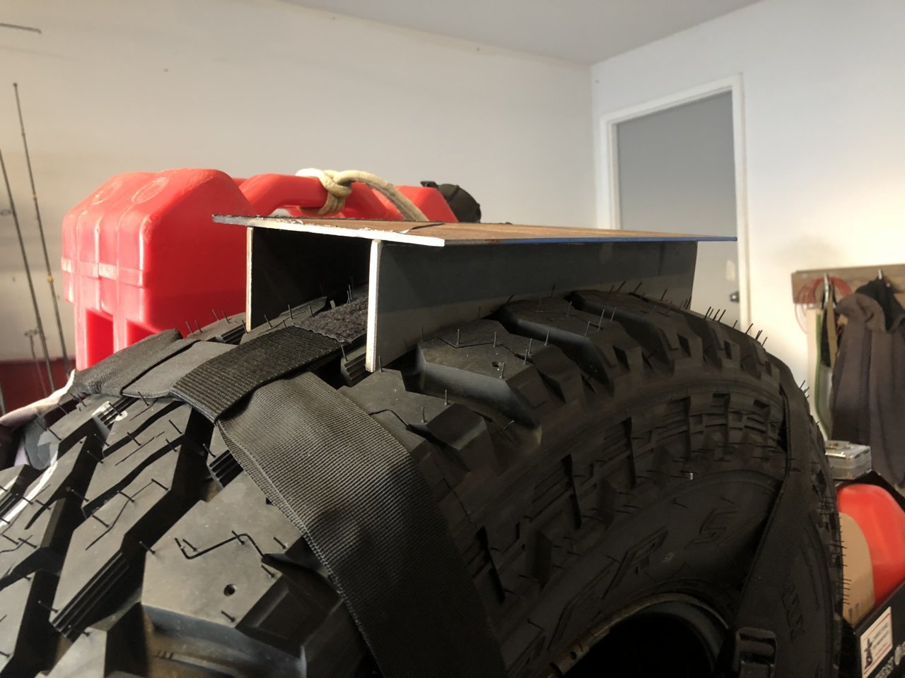

  10. May 27, 2018 at 4:04 PM
    #2470
    Chux
    Chux [OP] Pura Vida
    Oct 1, 2013
    #113652
    6,234
    NJ beaches
    Click on my Build

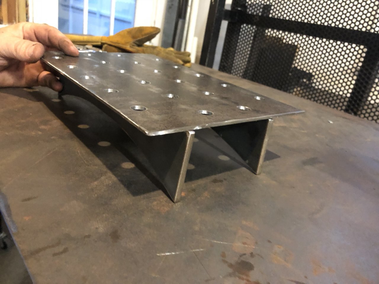

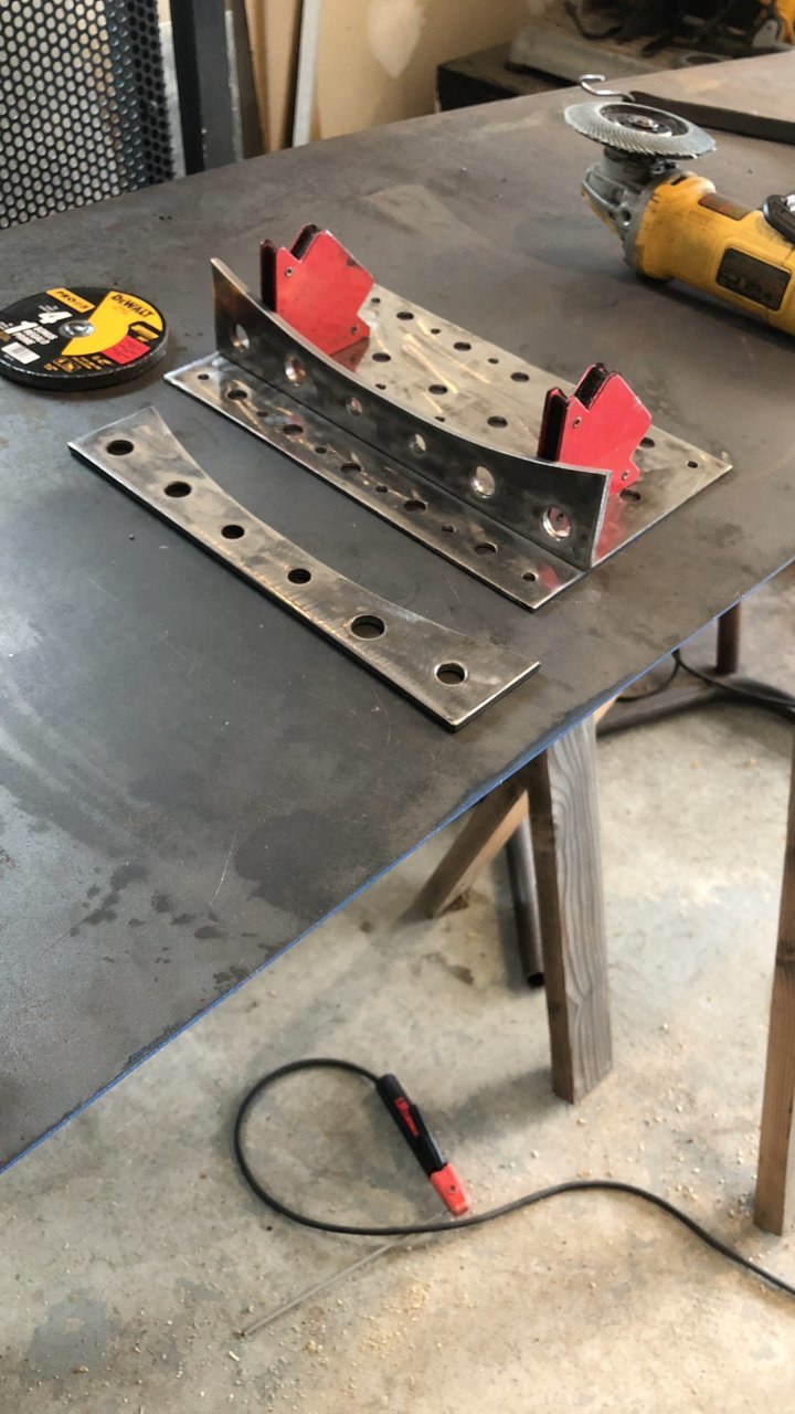

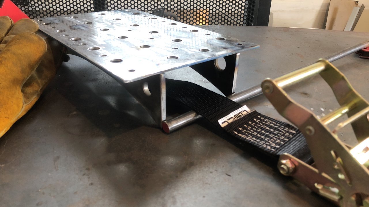

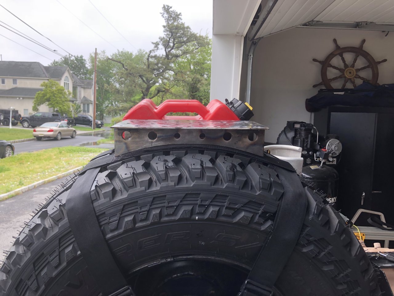

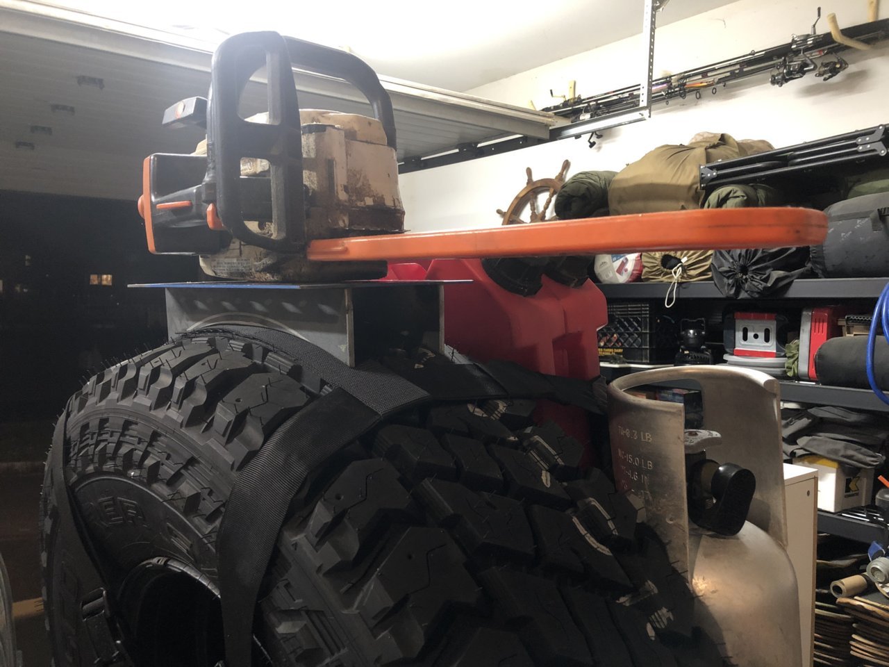

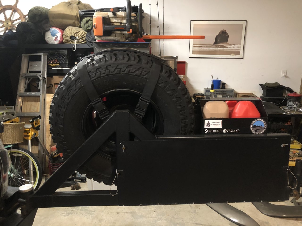

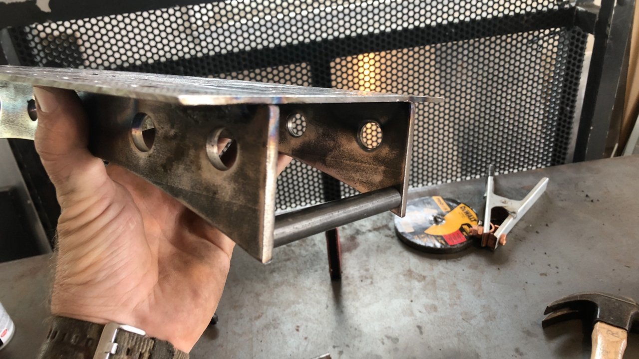

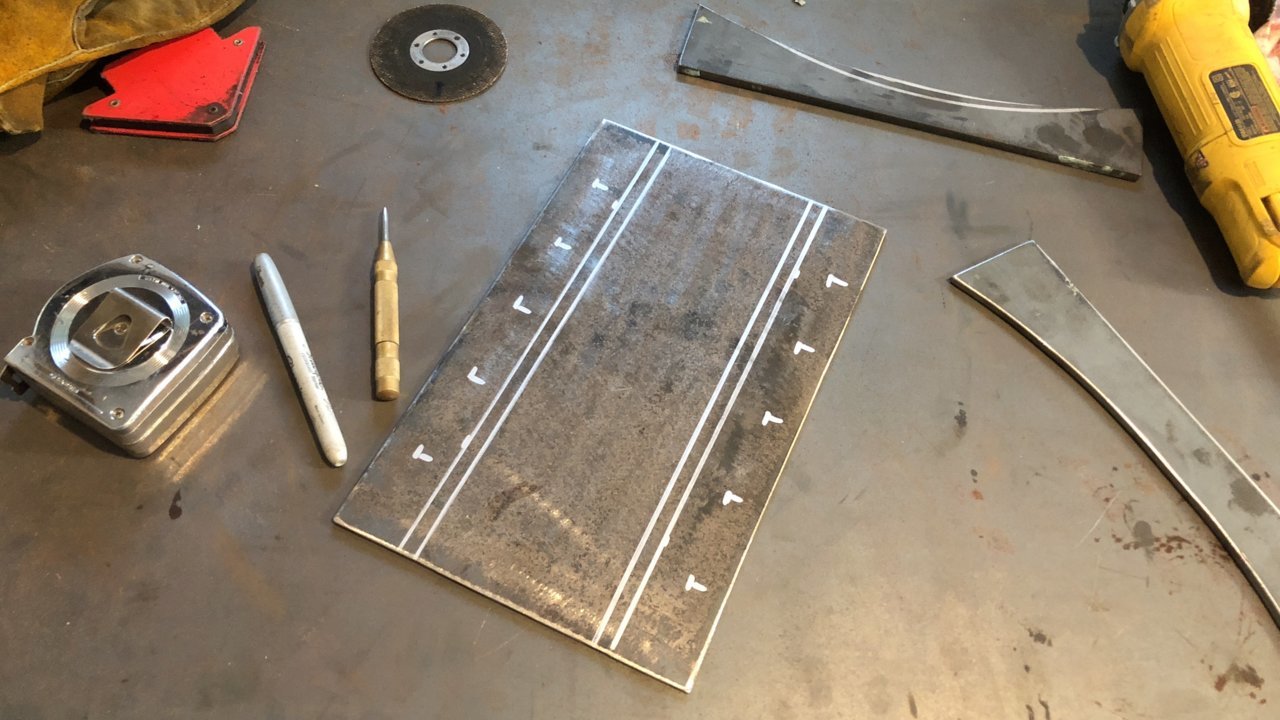

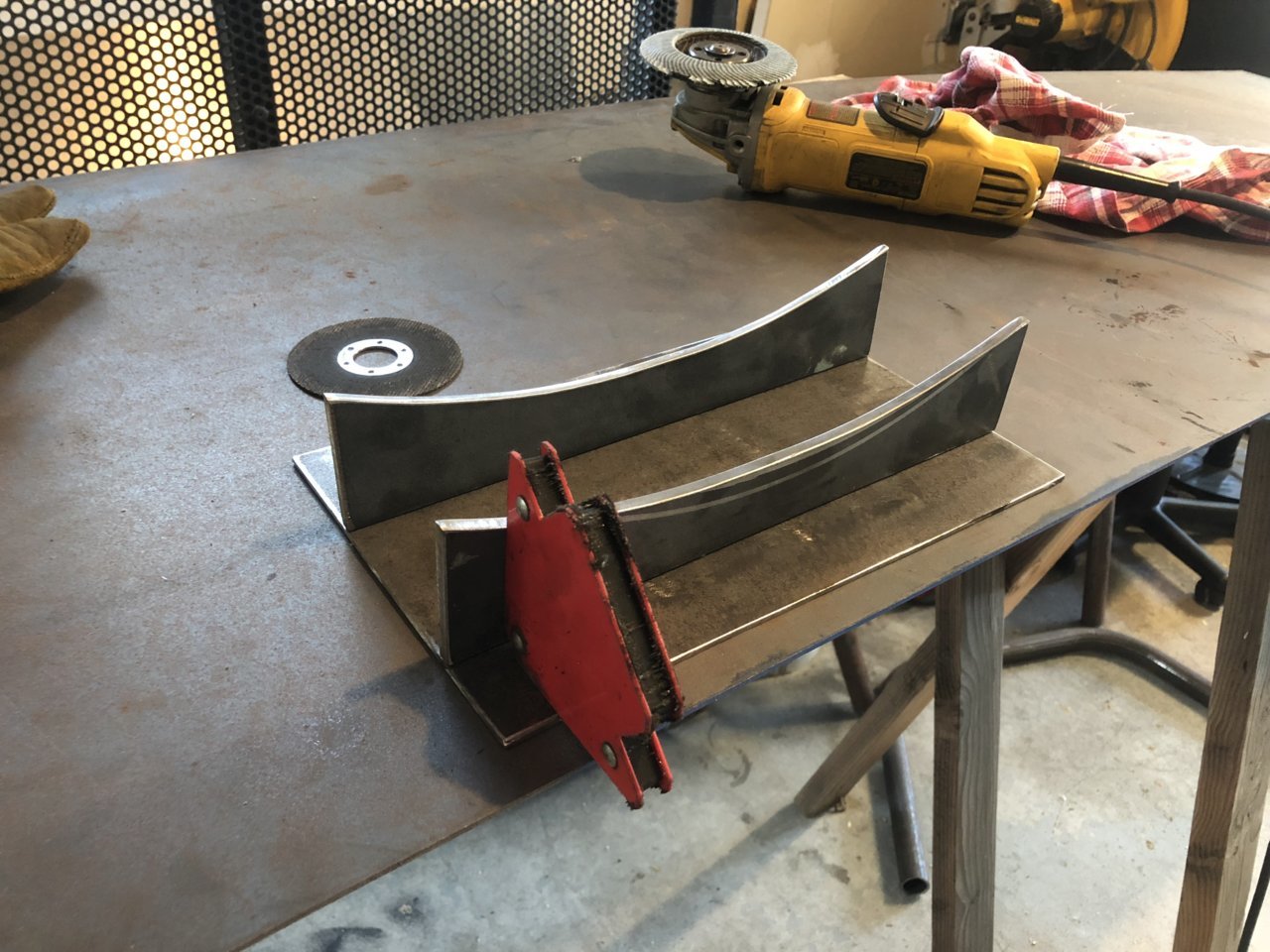

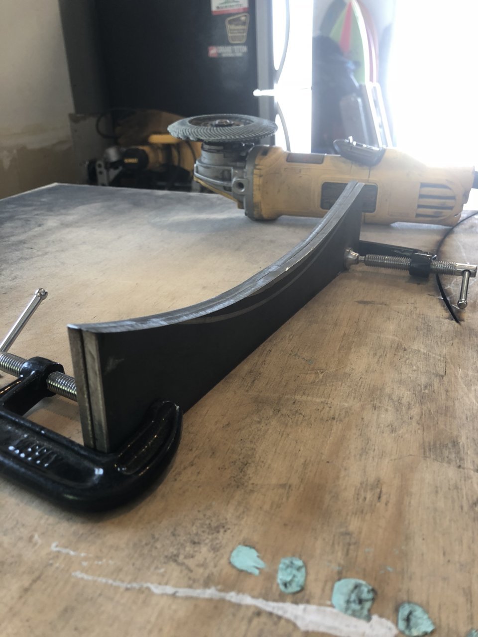

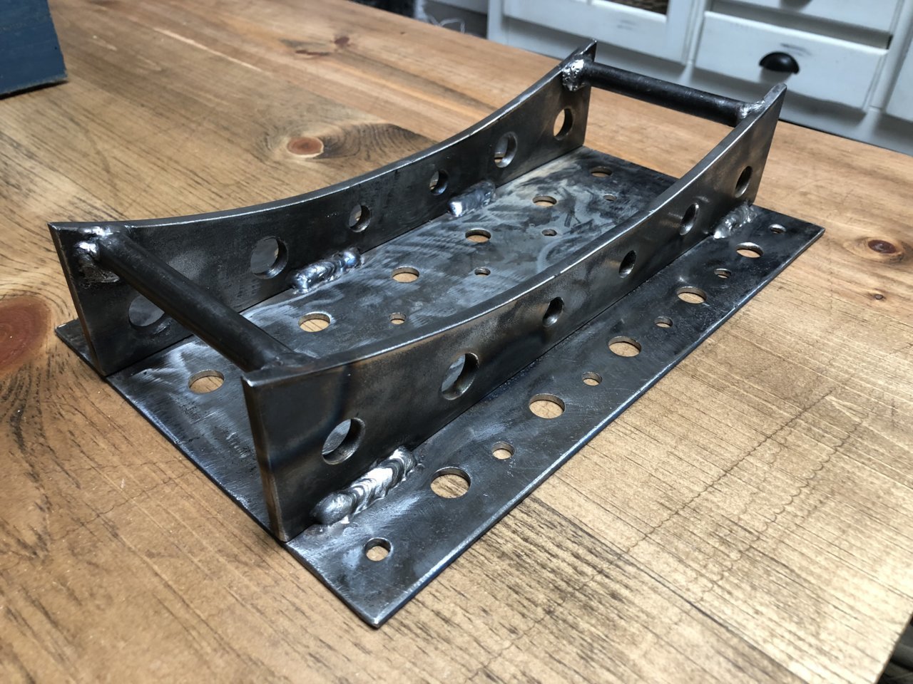

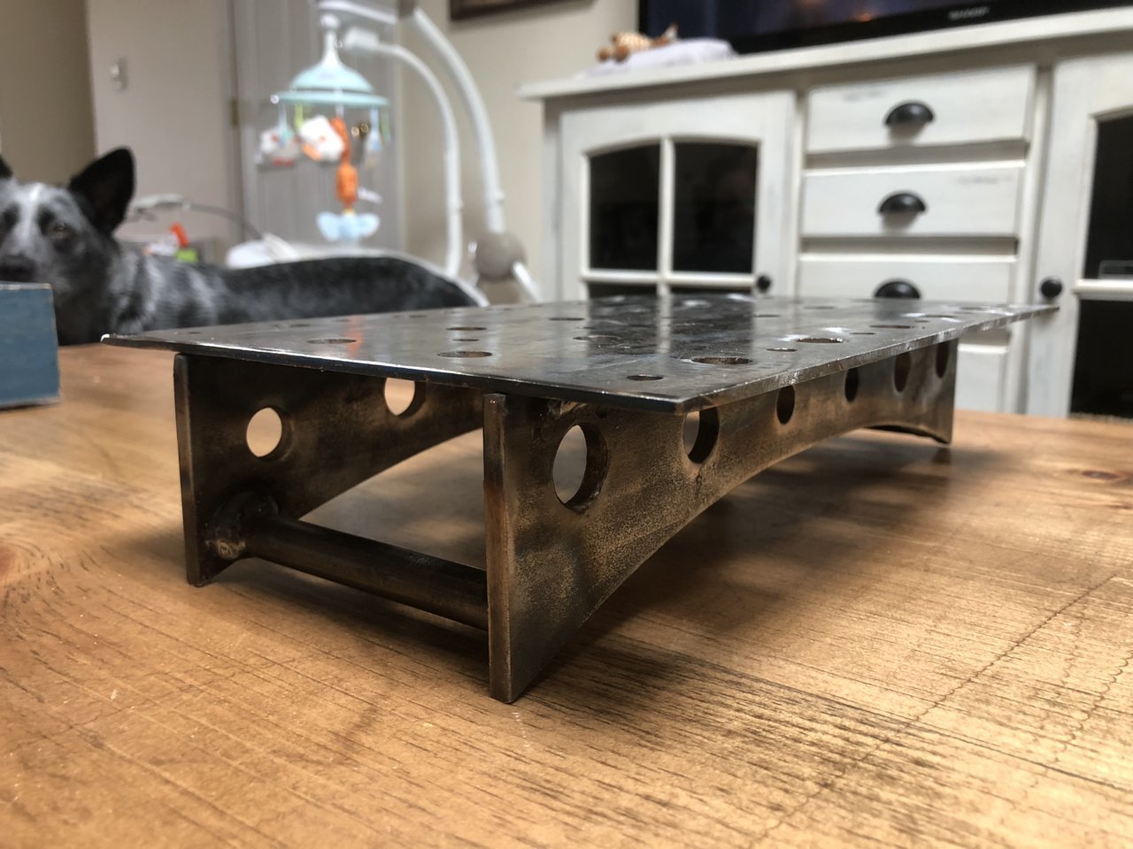

    Love getting projects out of my head and into the world. Tho not my idea, I fabricated it in my own fashion.. The plan is to have a spare tire mounted chainsaw mount, but can be used to mount just about anything. Was planning on spray painting it but after being happy with the turn out and wanting it to hold up to the elements on the spare tire I’m going to get it powder coated. Ideally wanted to do this out of aluminum but not setup for it yet, this steel mount weighs 5.3lbs

    Now that is pretty cool- I want to see the final product. I always carry a saw in my bed.

    Wow! You come up with some cool useful stuff. Nice job! :thumbsup:

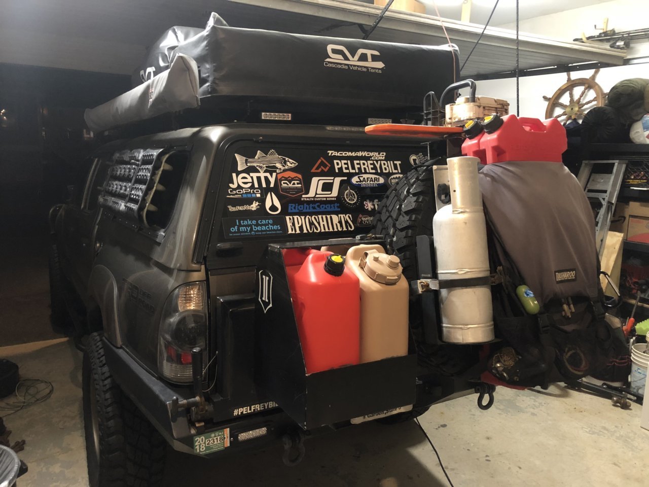

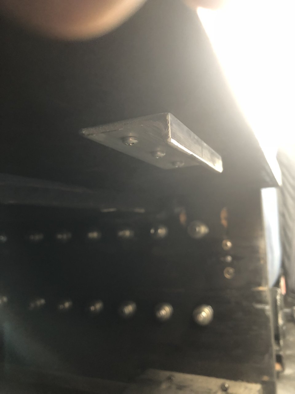

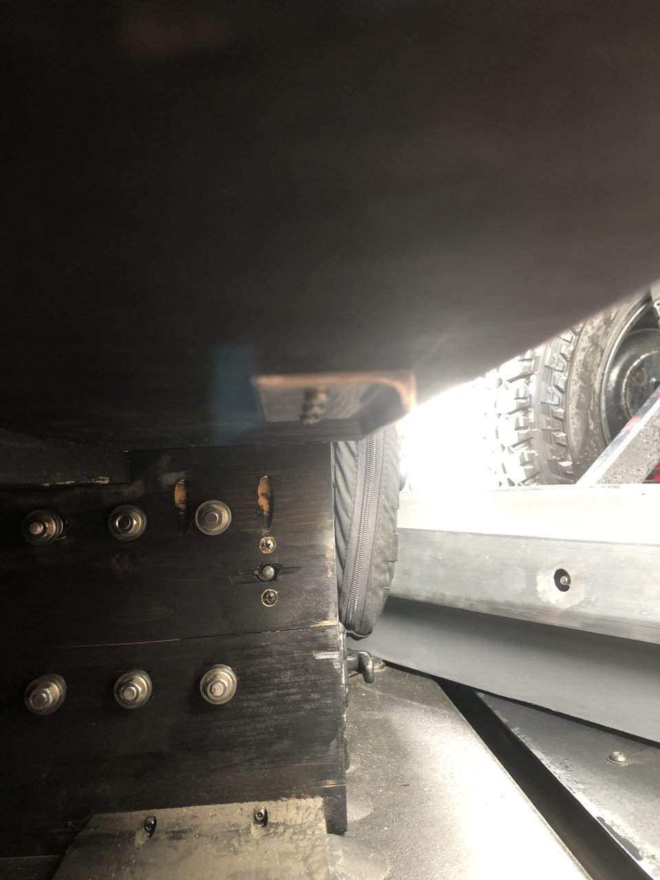

    Saw this post in the NE CL Finds and had a question. How is your fridge slide secured? It looks like you welded a giant tab to the front and ran a bed bolt through it. Anything else holding it? Picking up my fridge/slide today (spent yesterday chopping up my platform)
  20. May 29, 2018 at 6:28 AM
    #2480
    Wheelspinner
    Wheelspinner Coco Customs
    Jul 6, 2013
    #107741
    4,370
    Steve
    Northern NJ
    '13 4x4x4cyl
    I believe Chux has mounts that bolt to the slide then use two bed bolts to hold it all down. Not sure who makes them. I just welded two pieces of scrap plate to my slide and used two bed bolts to hold it down
