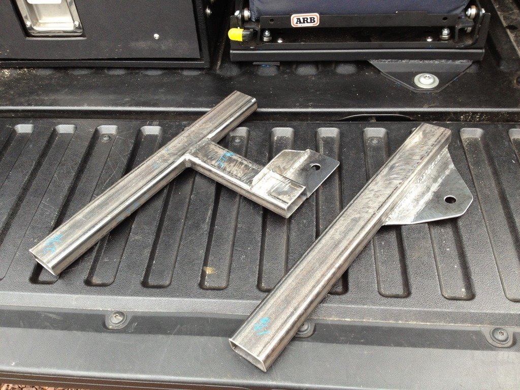

    There’s two brackets, front and back that both have tabs for bed bolts. @2012Taco was gracious enough to make them for me a few years ago. After seeing his, it’s exactly what I wanted! They fit like a glove to the configuration of the fridge slide that is super secure. I still tip my hat to his one off design. I just bolted the slide to the mounts, fridge to the slide and it was good to go. There’s a few inches clearance to the tailgate being closed and enough room next to it to store something and still have my 12v fridge plug in the bed wall without interfering anything. I dug through my build for the pic. Background of the pic is his truck, you can see his brackets aswell..

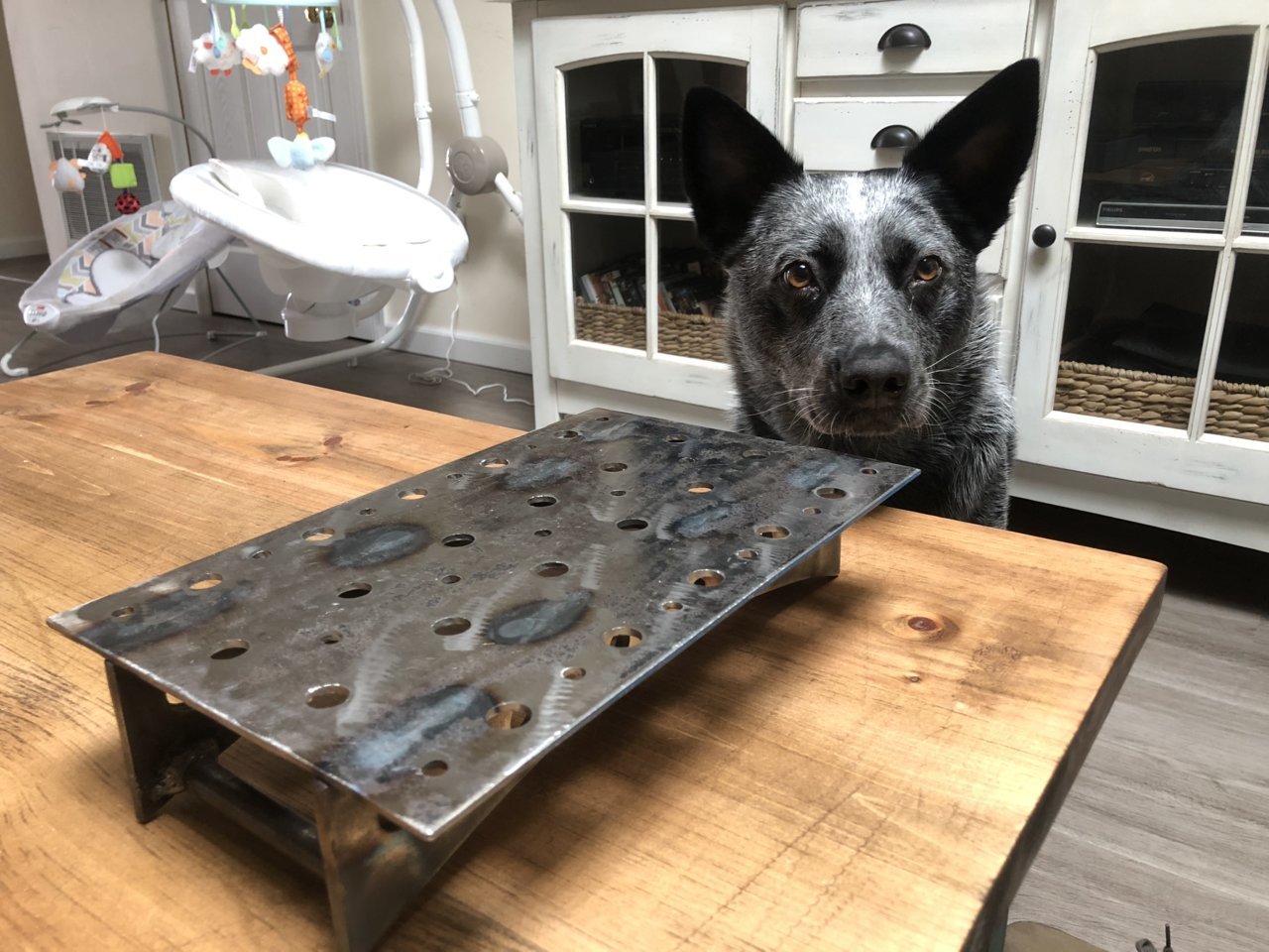

    Finally swapped out the IFS 10mm tack nuts with 3/8” flange nuts. Welding stick upside down was super tough. Pic befor I flap wheeled it..

    These are to fix the issue of the weld nut in the cross member that always breaks???

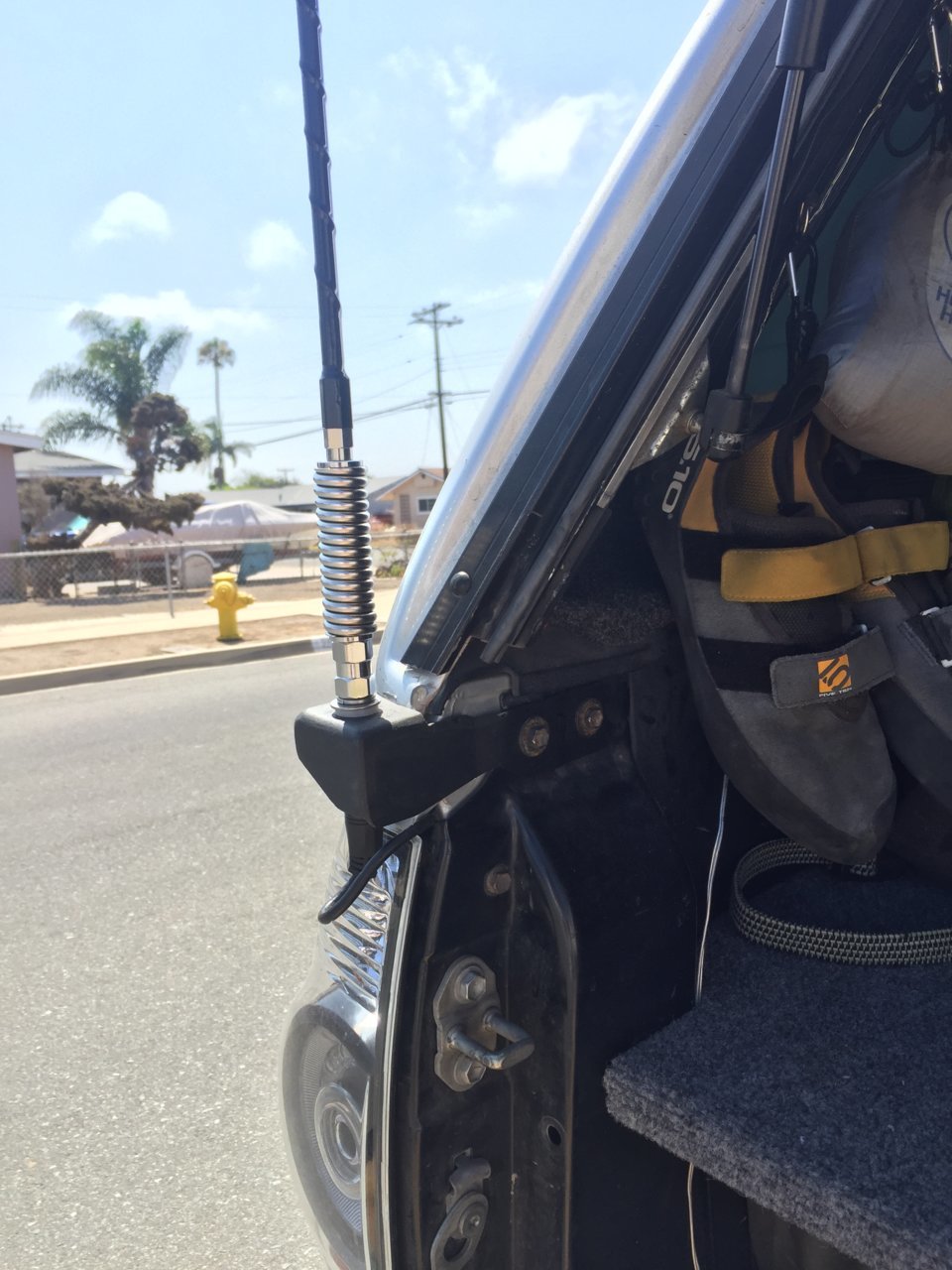

    How did you ground your CB? I have the same type of mount as yours and a 3' firestick but I tried tuning it and the SWR levels are way in the red.

    With a screw?
    I kid :p

    You have a pick of your setup?

    I tried testing for ground with a multimeter but honestly I had no idea wtf I was doing hahaha

    IS the hole large enough diameter on the mount? You don't want the metal stud touching it. That's why that white washer is on top, to center it.

    Actually I think its not large enough for the stud not to touch it. Ill go ahead and open it up a little bit and see how that goes. I sanded down the paint on all around where the stud mounts and its a lot better. But, my swr levels on channel 1 are 2.7ish and 1 on channel 40. So not sure what to do. Ill try making the hole bigger and see how that goes.

    Heres some good trouble shooting with the multi meter
    https://www.youtube.com/watch?v=SJgIeALow6c
    I have a firering antenna wire, not sure what difference it makes but I never had a ground issue. @chad_chinchilla I believe had issues with a ground and removed some paint from the mount to help the connection..
