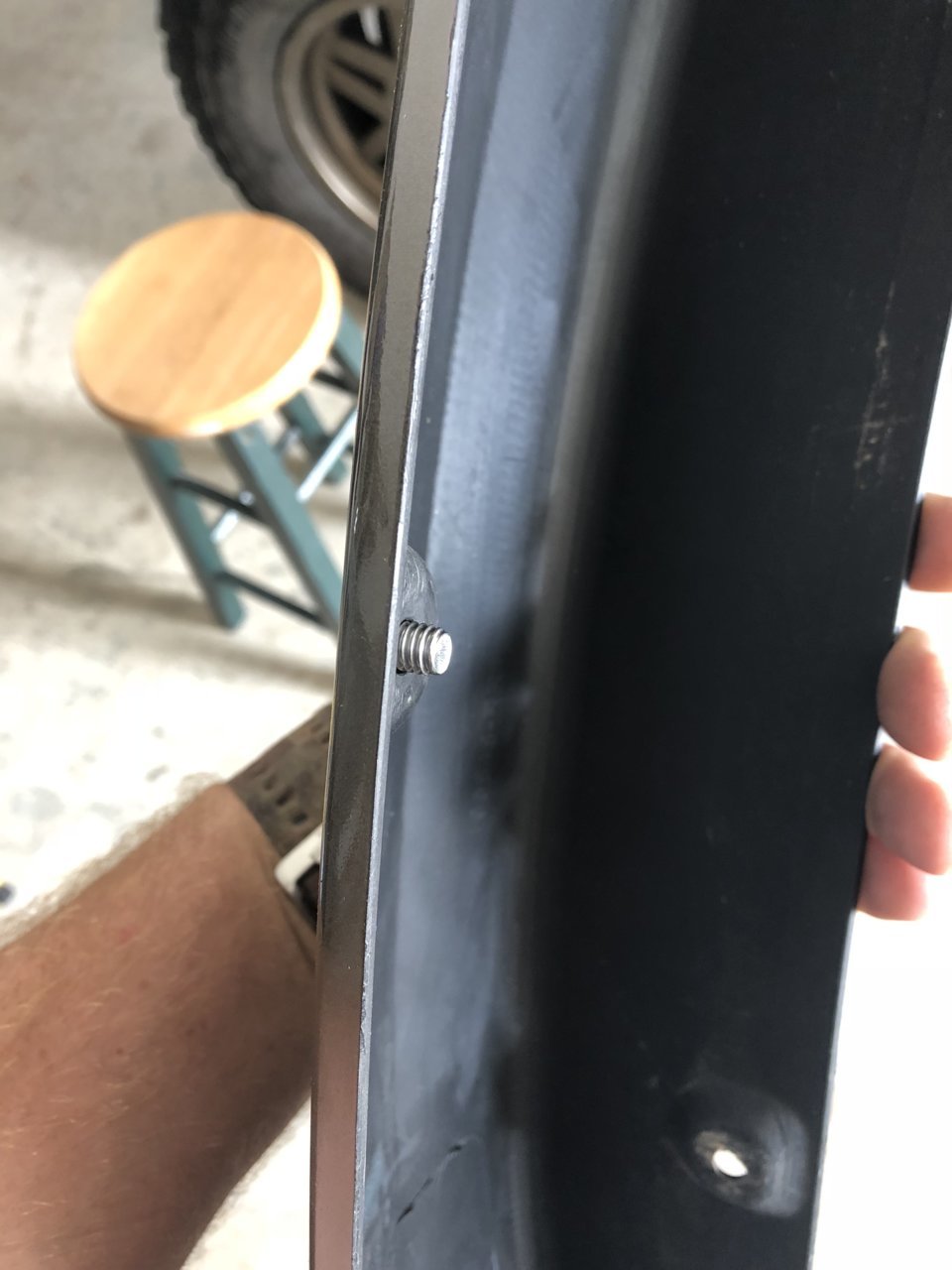

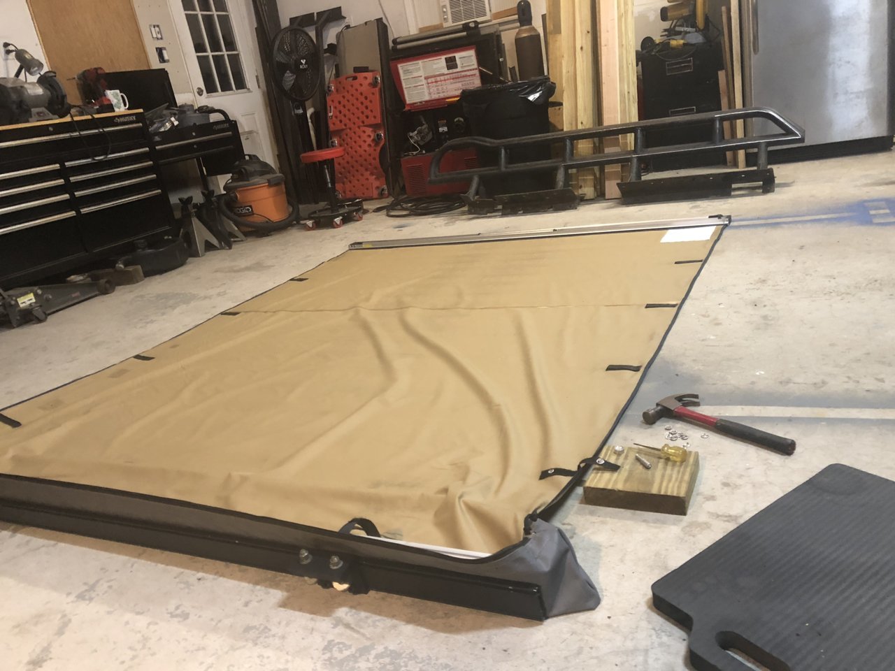

    Awning maintenance

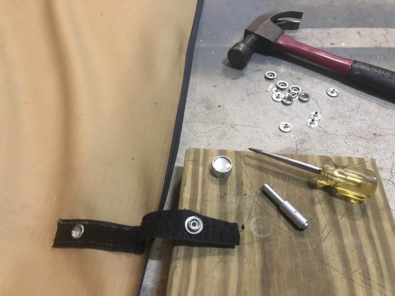

    Got this awning 4 years ago and with lots of use it’s showing it’s age.. Nothing a little TLC can’t fix. The velcro is shot that goes around the horizontal bars. Being sewn into the canvas I really can’t replace it that easily, so decided to add snap buttons to the velcro..

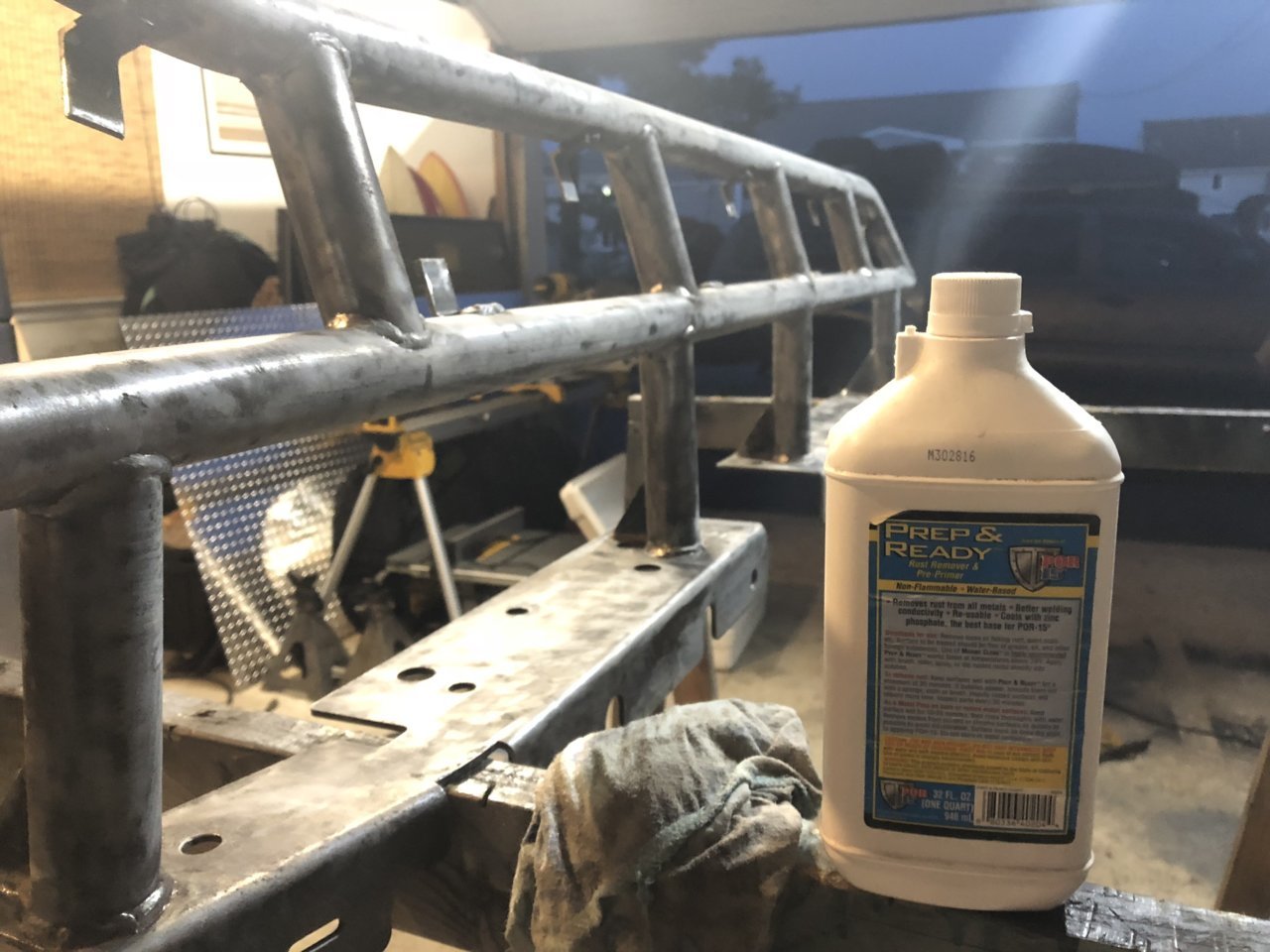

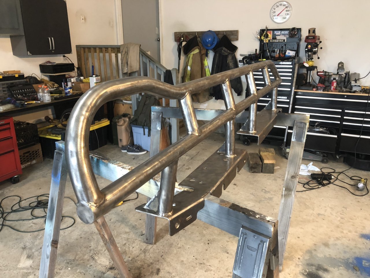

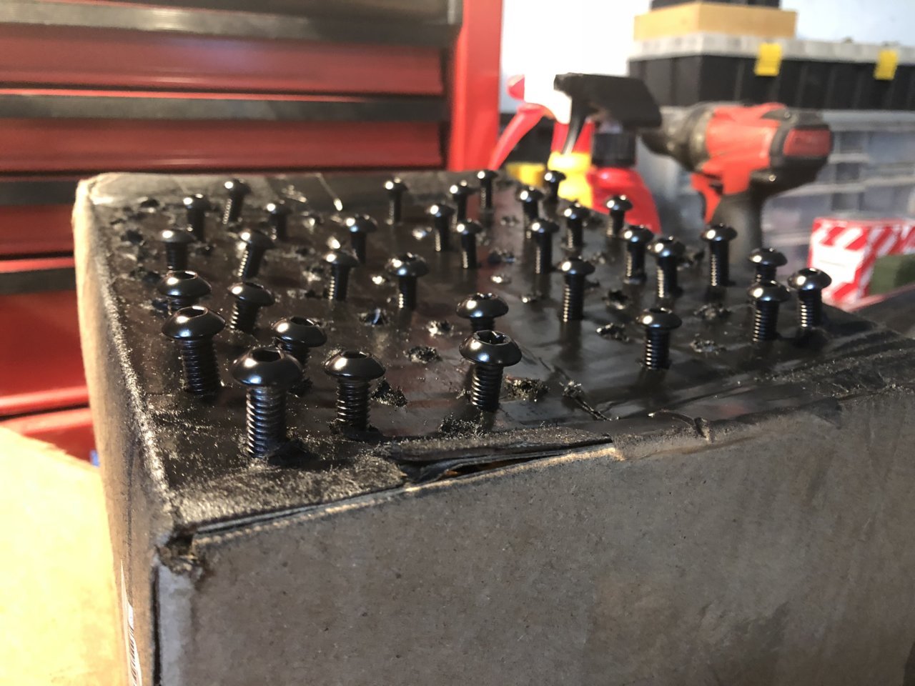

    Taking steps backwards to go forward...
    Making my sliders into family friendly steps.
    POR-15 delete.
    AC49F743-CE09-4257-B700-802F64375E67.jpg 0458F329-CDF8-4AB5-A53D-85EC36056373.jpg

    22,398
    GHOST
    Whatcha coating them with?

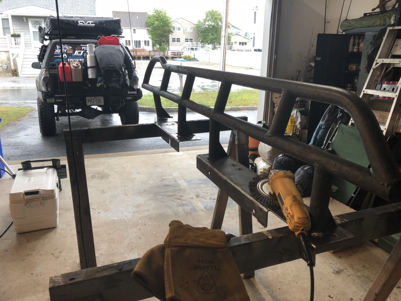

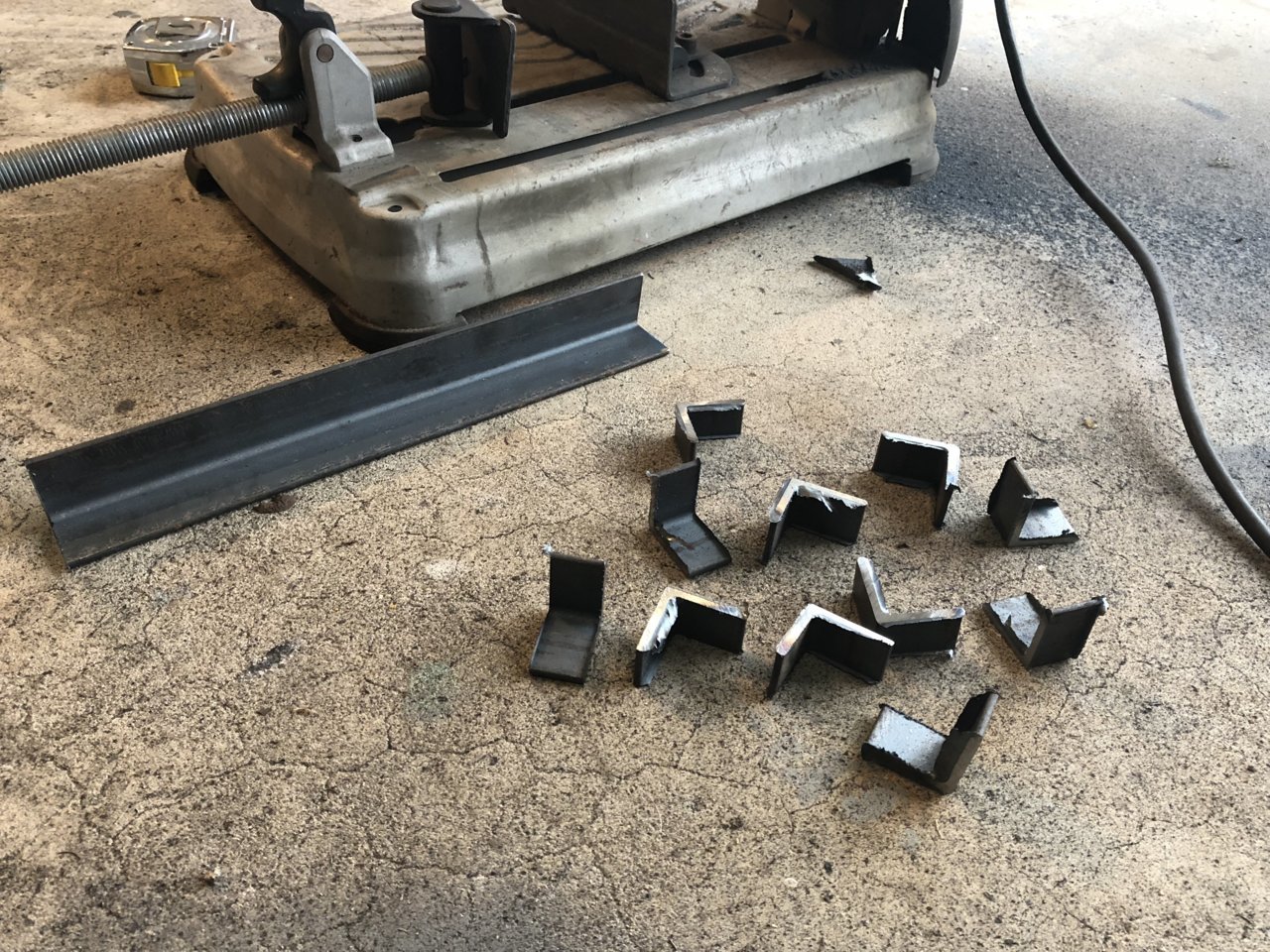

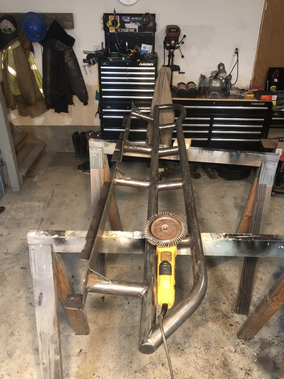

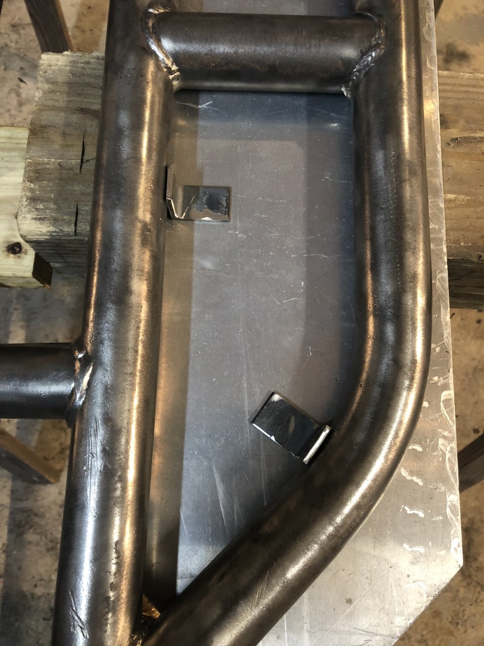

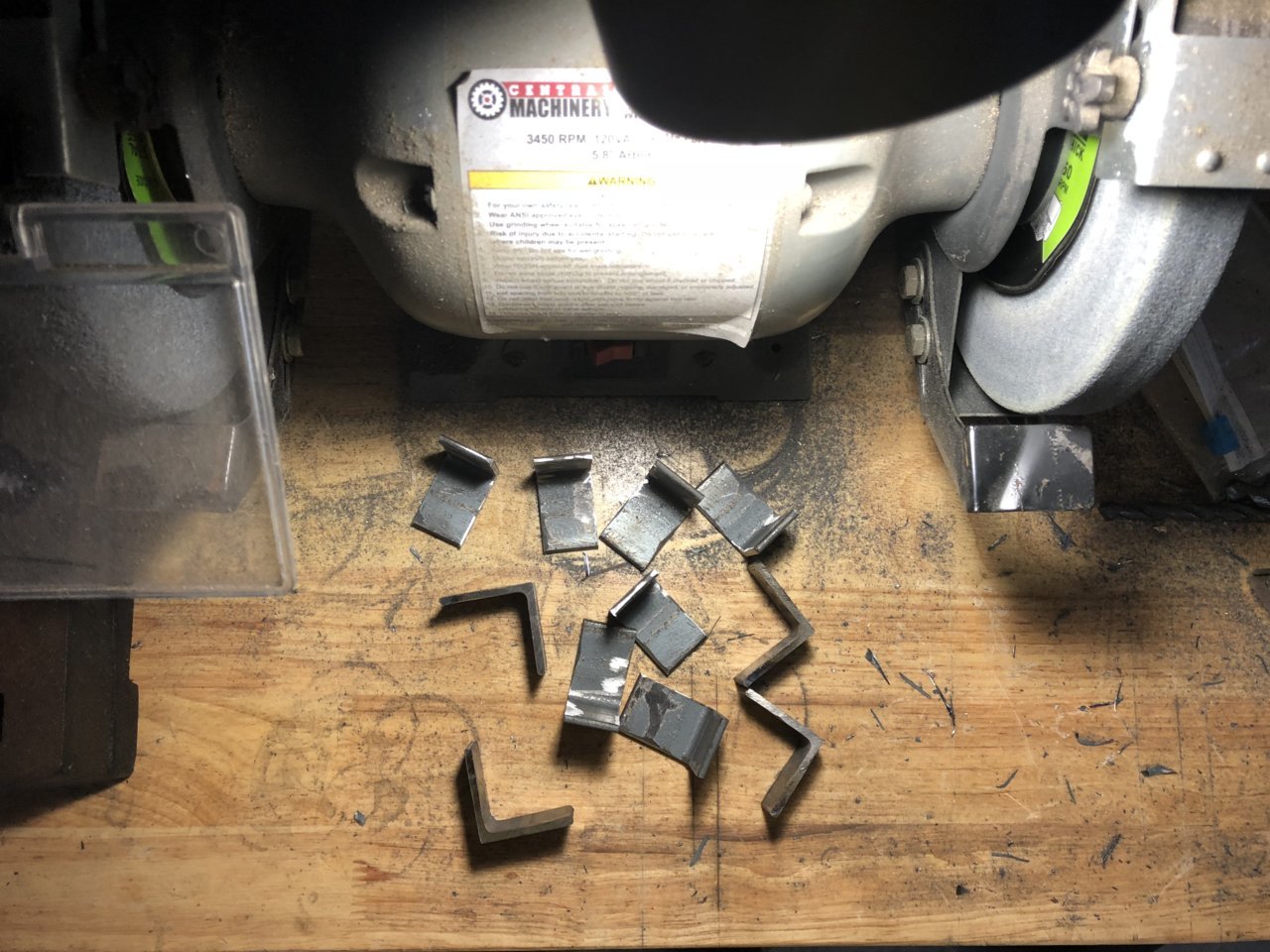

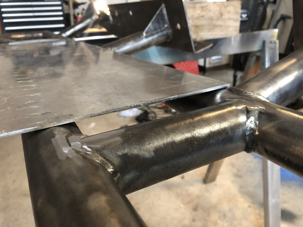

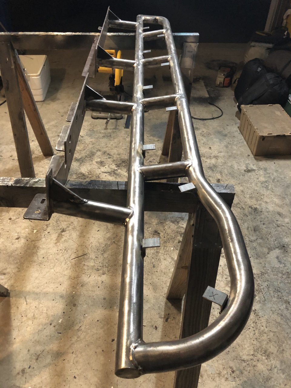

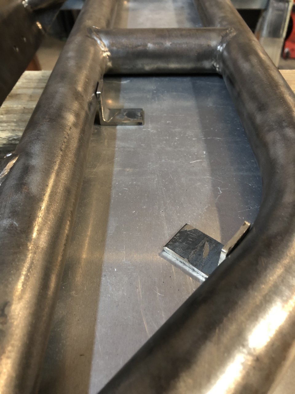

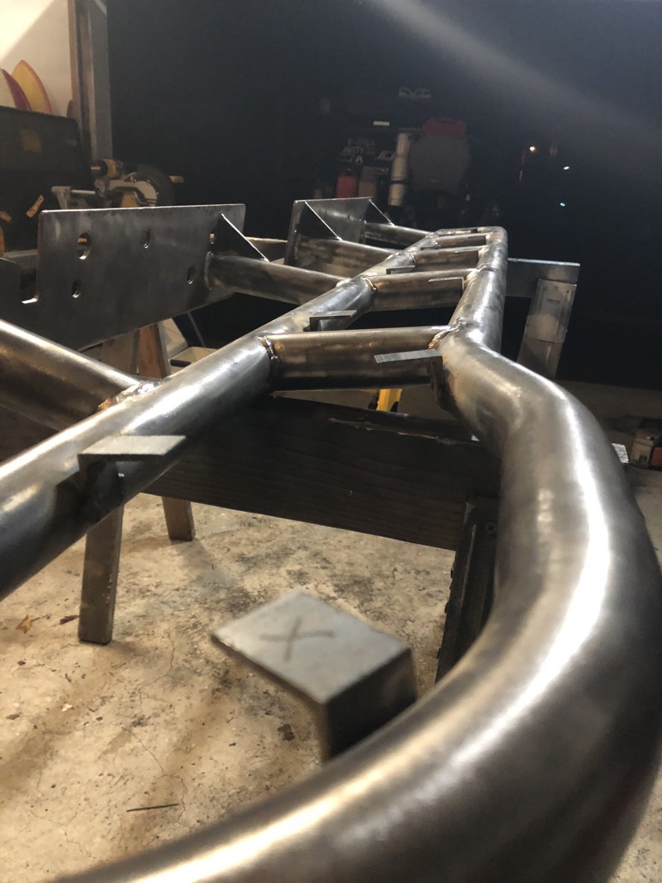

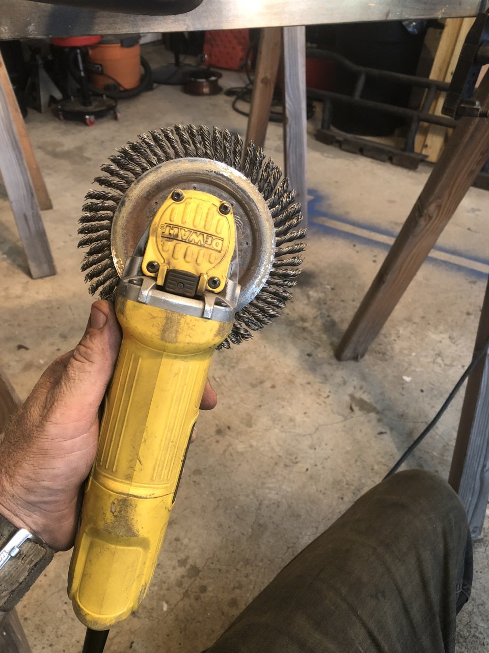

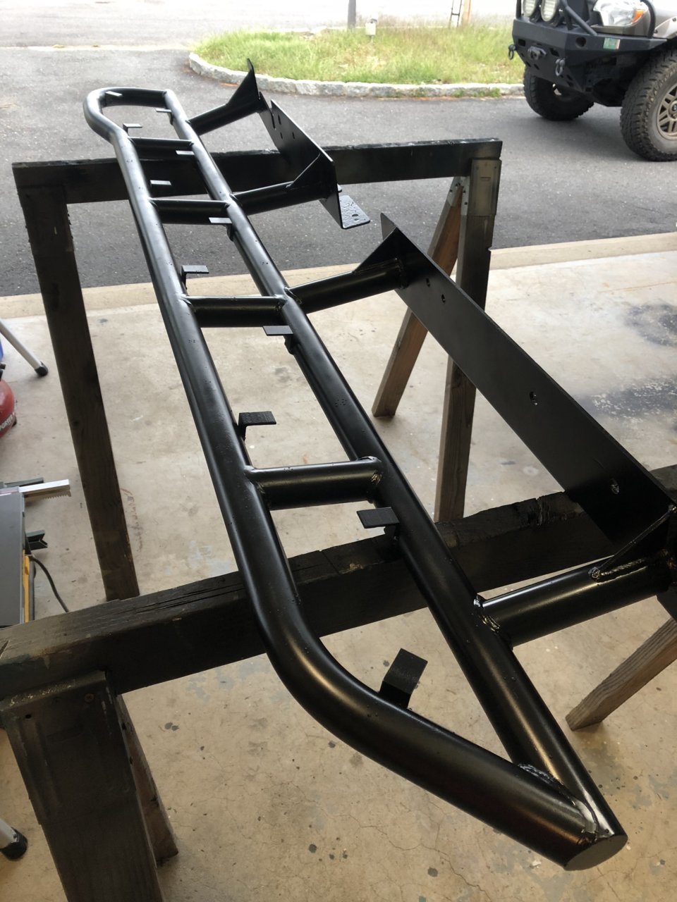

    Slider step progress..
    Wire wheeled the second slider today. Started to make the weld tabs for the sliders that the top plate would be riveted to. I made 11 total which is enough for one slider. Gonna tack them on tomorrow and make another 11 for the other side, than paint. Final step will be the template and final cut of the aluminum diamond plate.

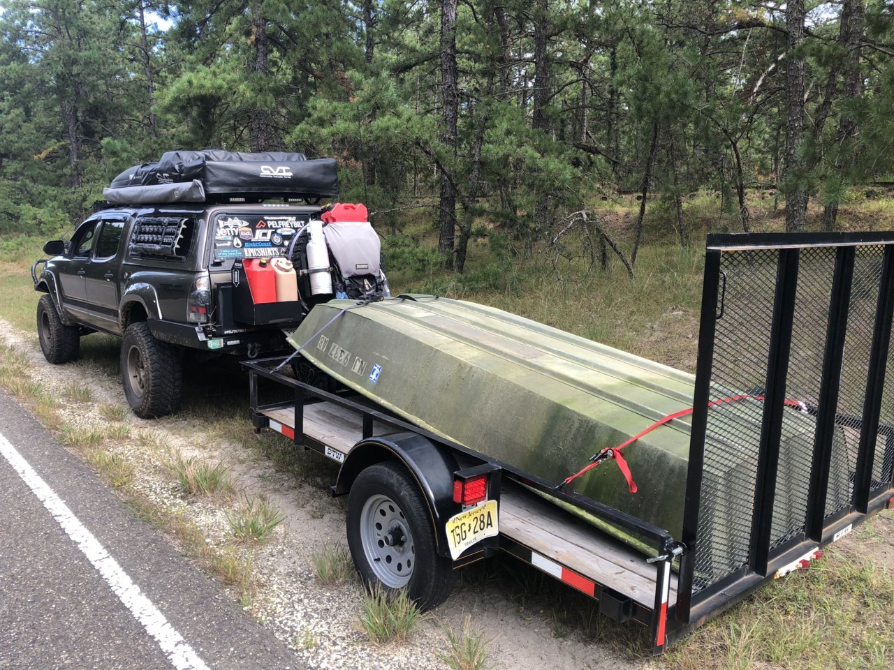

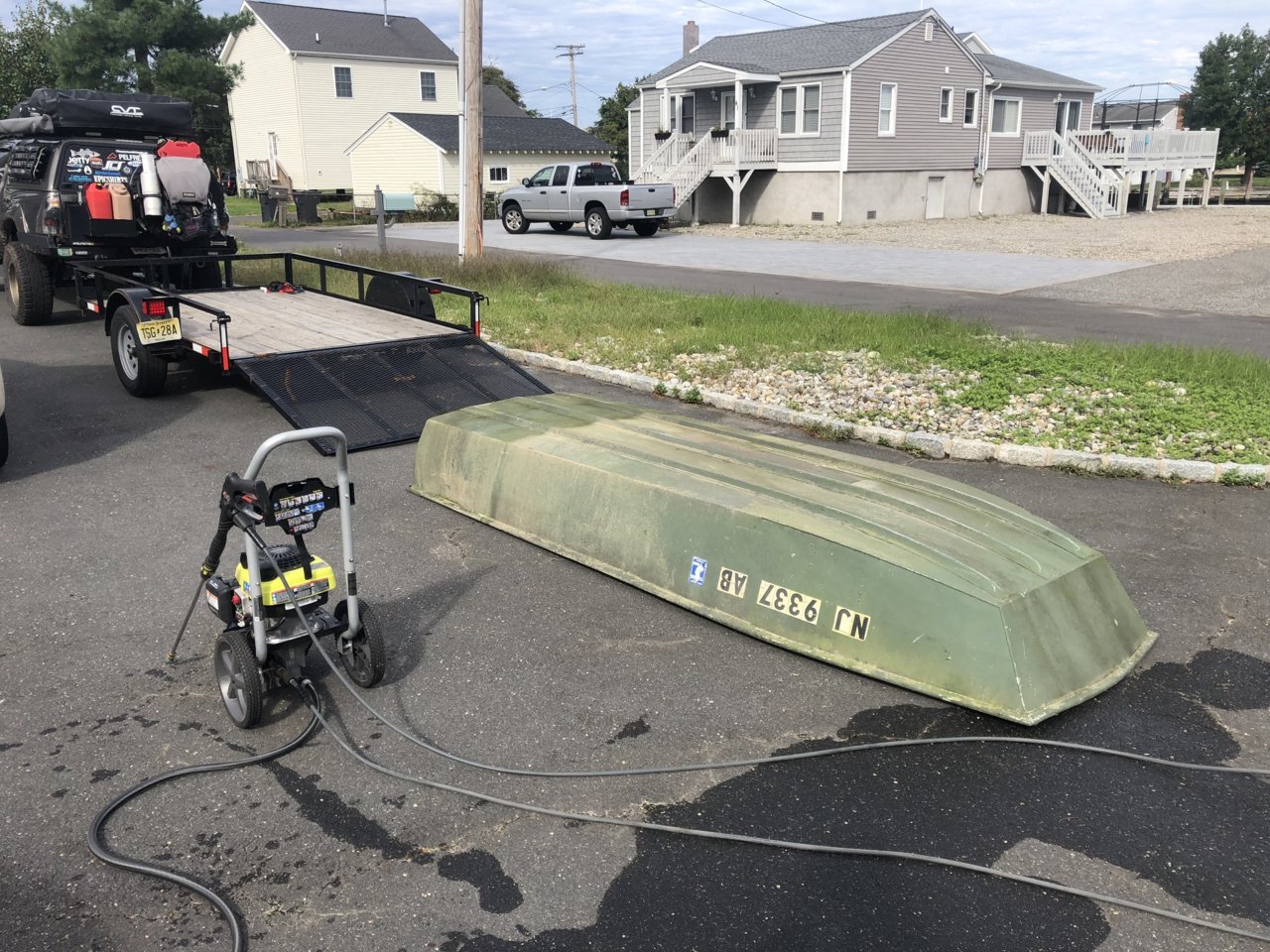

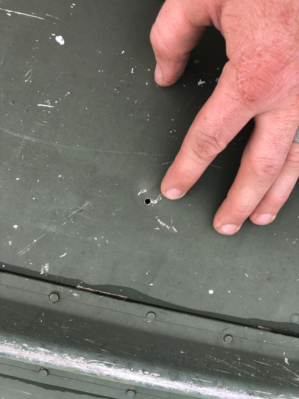

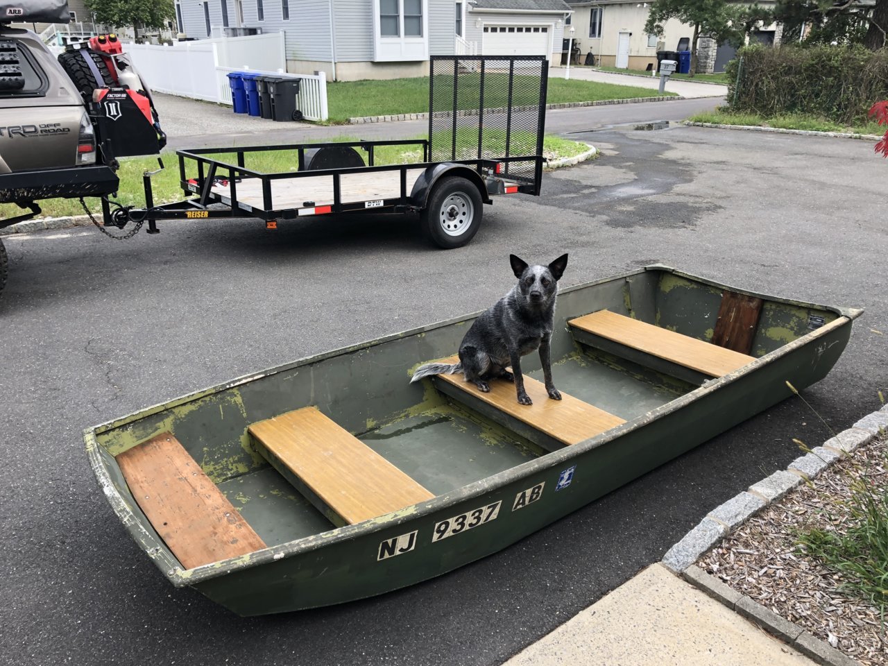

    Power washed the boat and found a small hole. Researching aluminum boat repair points to aluminum rod brasing as best fix. Gonna be a good time when this thing is sea worthy

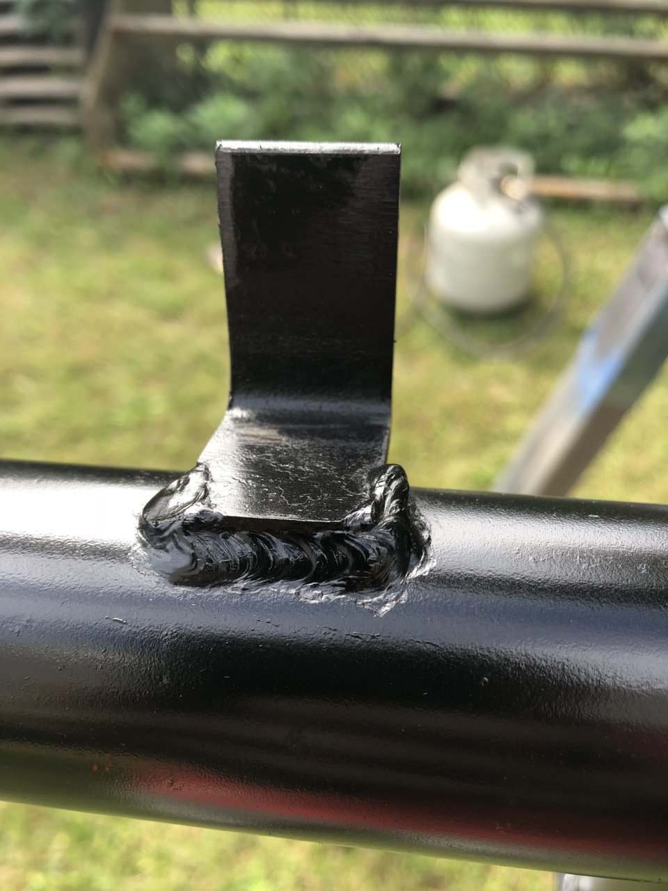

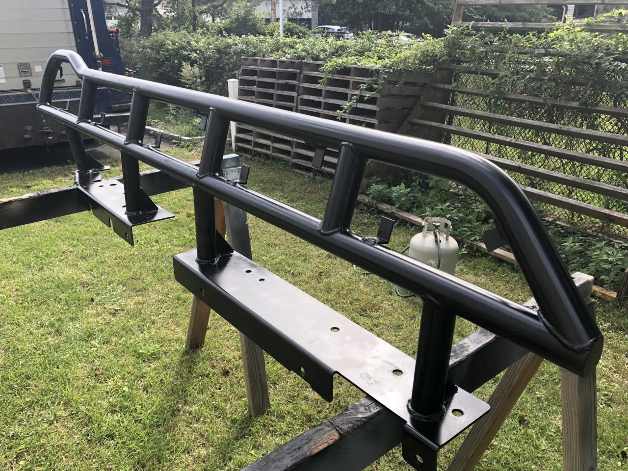

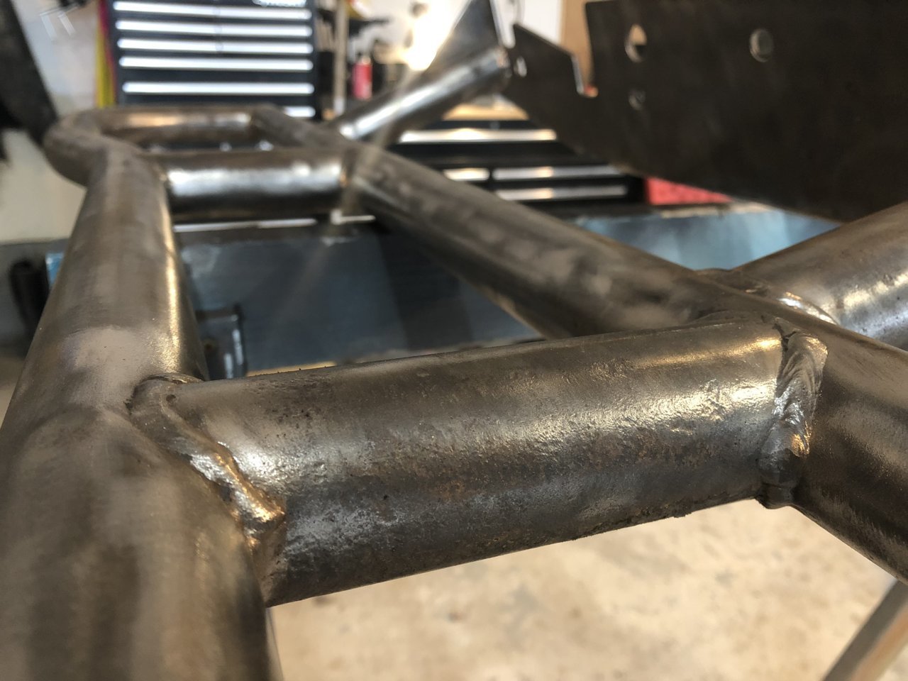

    Slider step progress continued
    Got the tabs welded on.
    My new (to me) mig is having issues so it’s down at the moment.
    Burned them in with some 7018..
    https://youtu.be/lt1a6oForrU
    0DD6C5FA-6148-4D4D-A3A0-8918E63780AA.jpg E6DF438A-6DA5-406B-B0F9-CF88C1FD6E7F.jpg
    Por-15 ready prep
    Went the extra mile and burnt off any impurities..
    https://youtu.be/YC8G9fIAs-M
    Really digging this VHT paint.
    Cans go quick but it lays on smooth, great hard finish to it, and it’s quick drying.
    CAC231EE-06FA-4A18-8DA3-E048FCA6714E.jpg AC956003-5370-4CC3-8FE8-4AF4E90041A3.jpg 17118426-C12C-4E75-92E2-EAA4C867C52A.jpg
