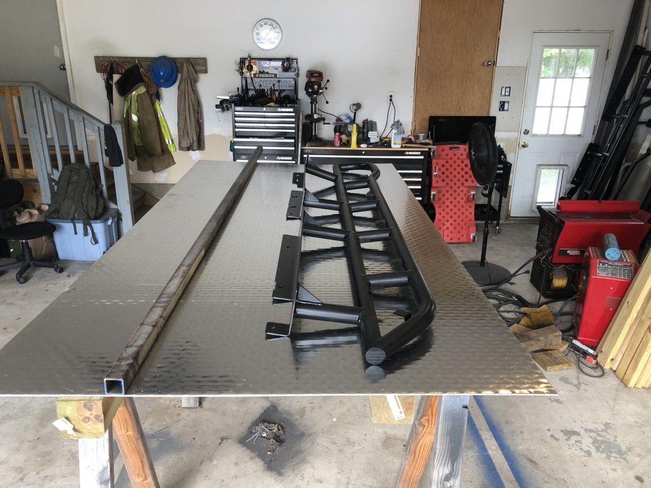

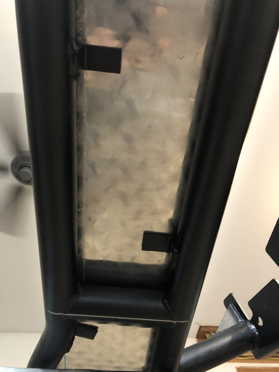

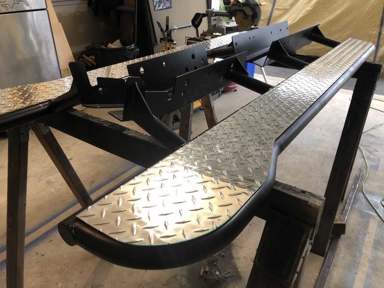

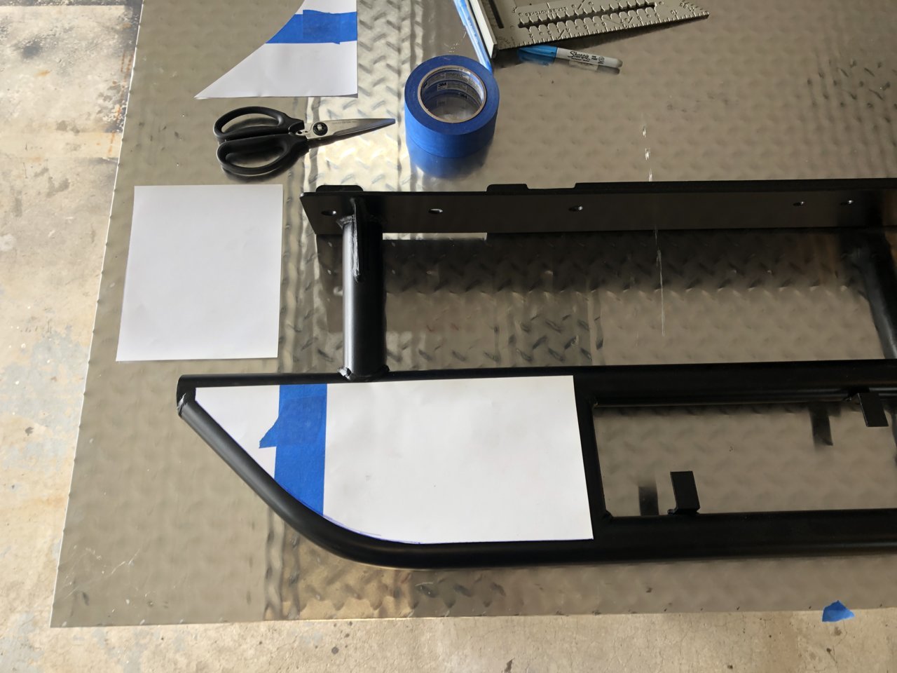

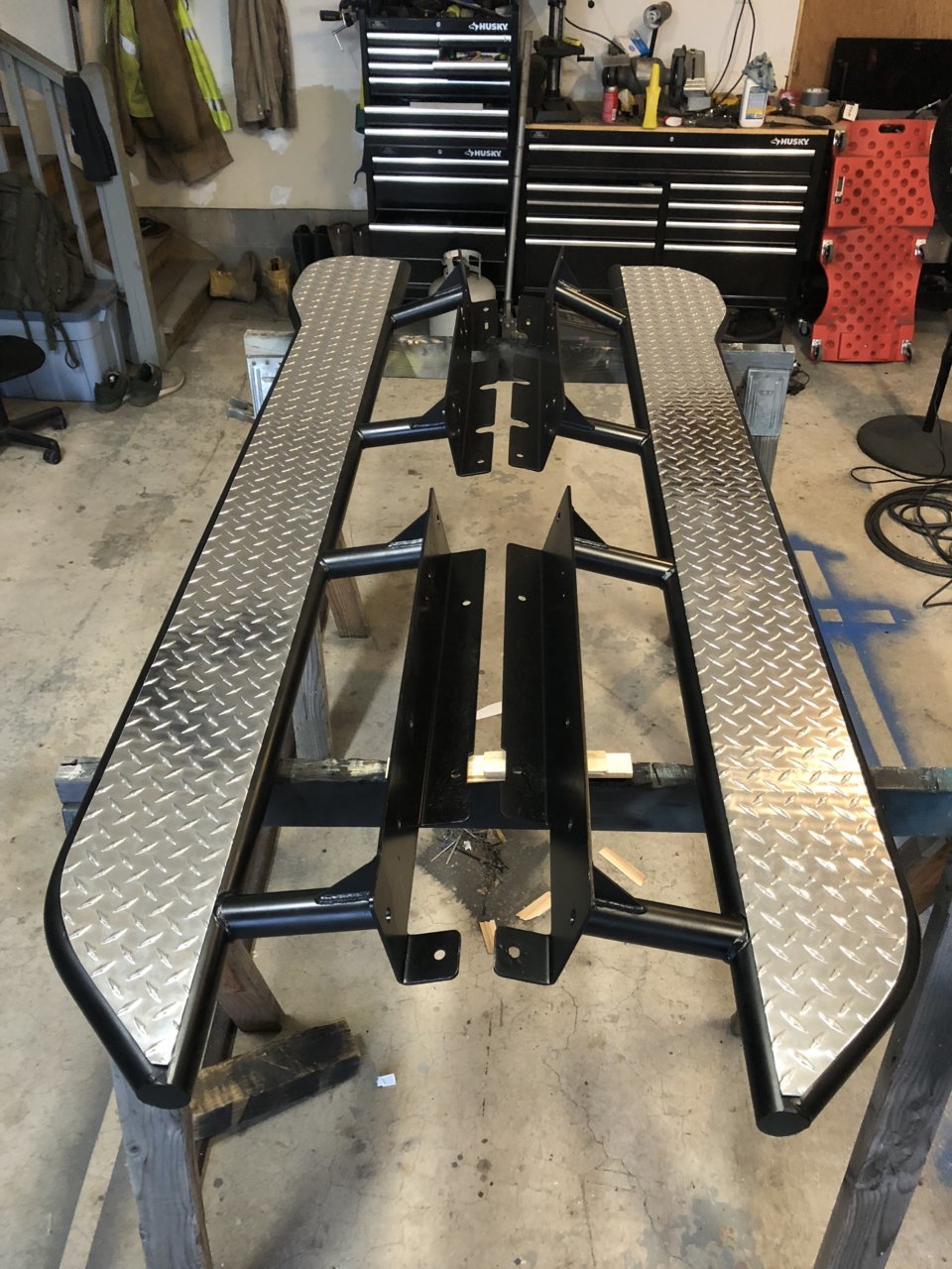

    Moar slider step progress

    Excellent work my friend. :thumbsup:

    Drop bracket lift and booger welds
    What did you use to cut out the diamond plate? Looking great homie.

    Thanx Bruh. Jigsaw big tooth blade

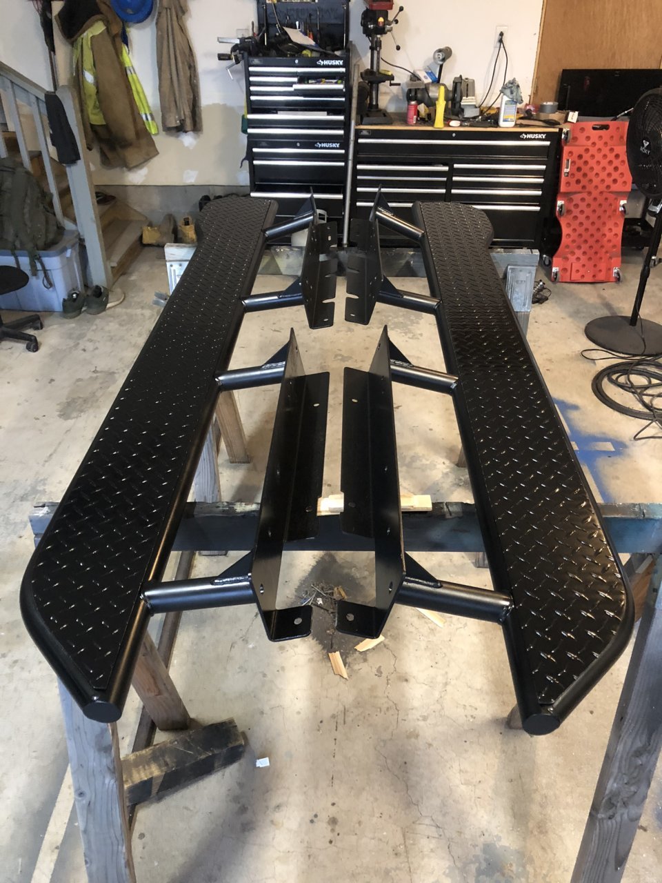

    Bekuz OCD
    Before
    After

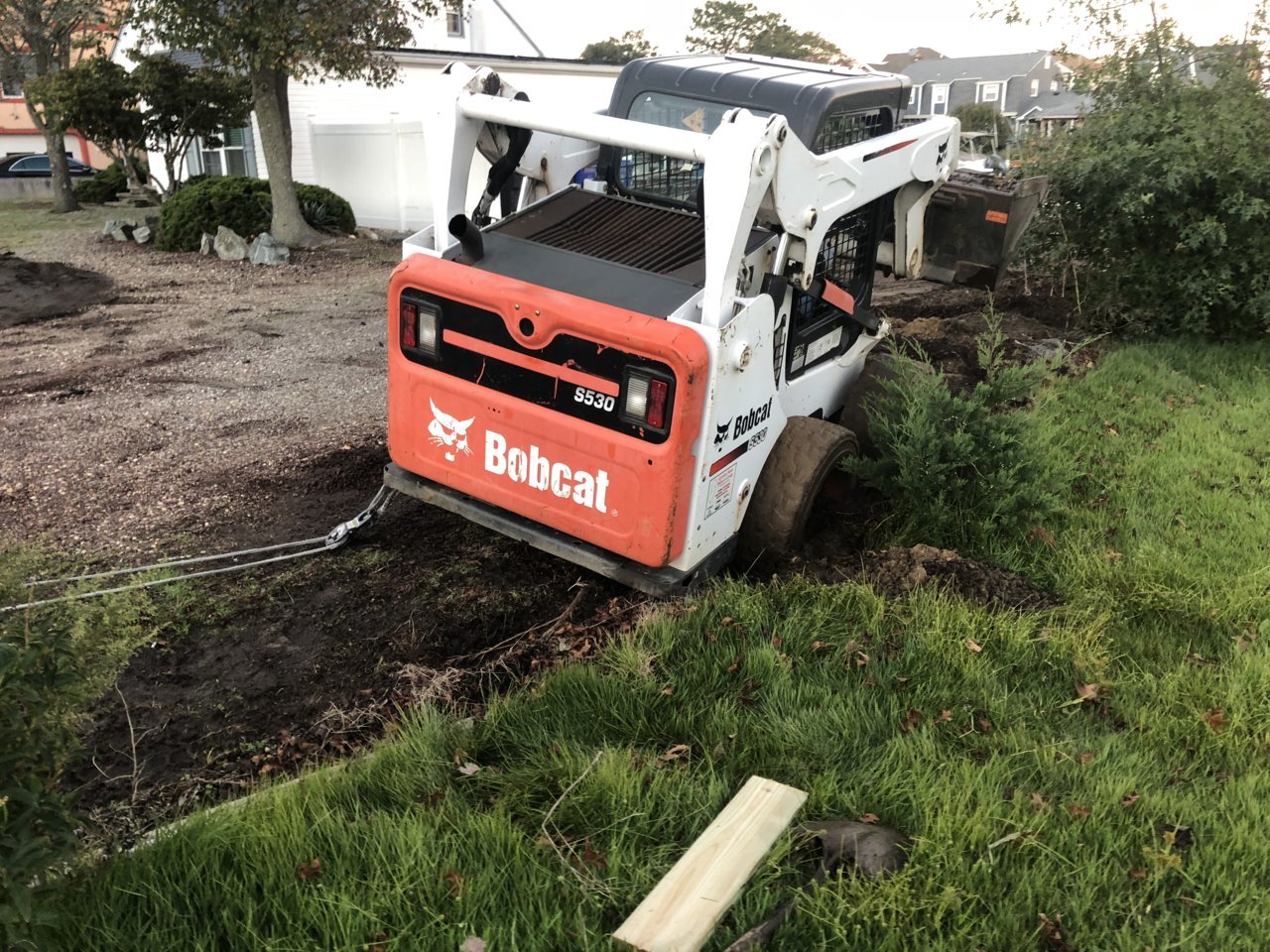

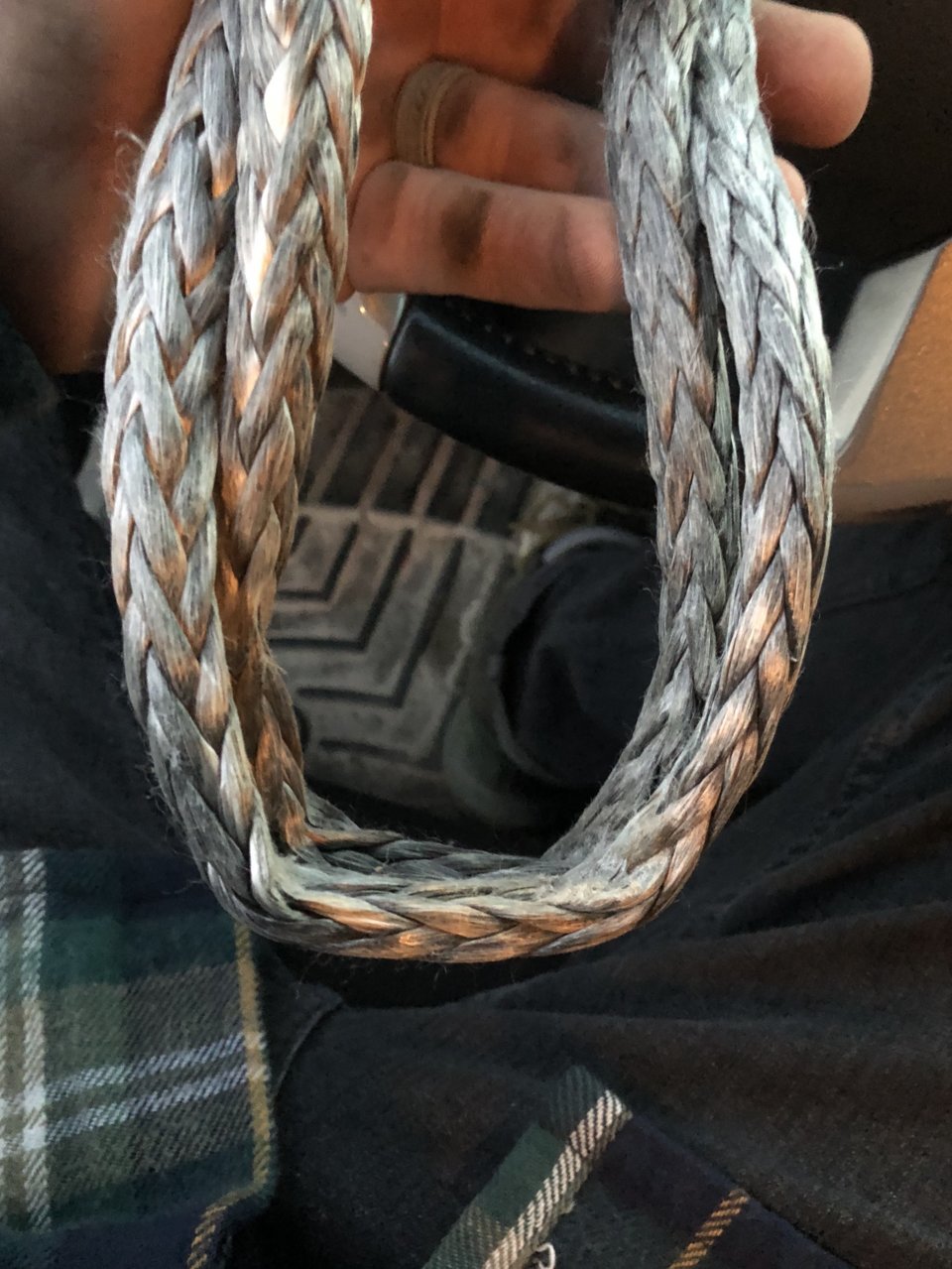

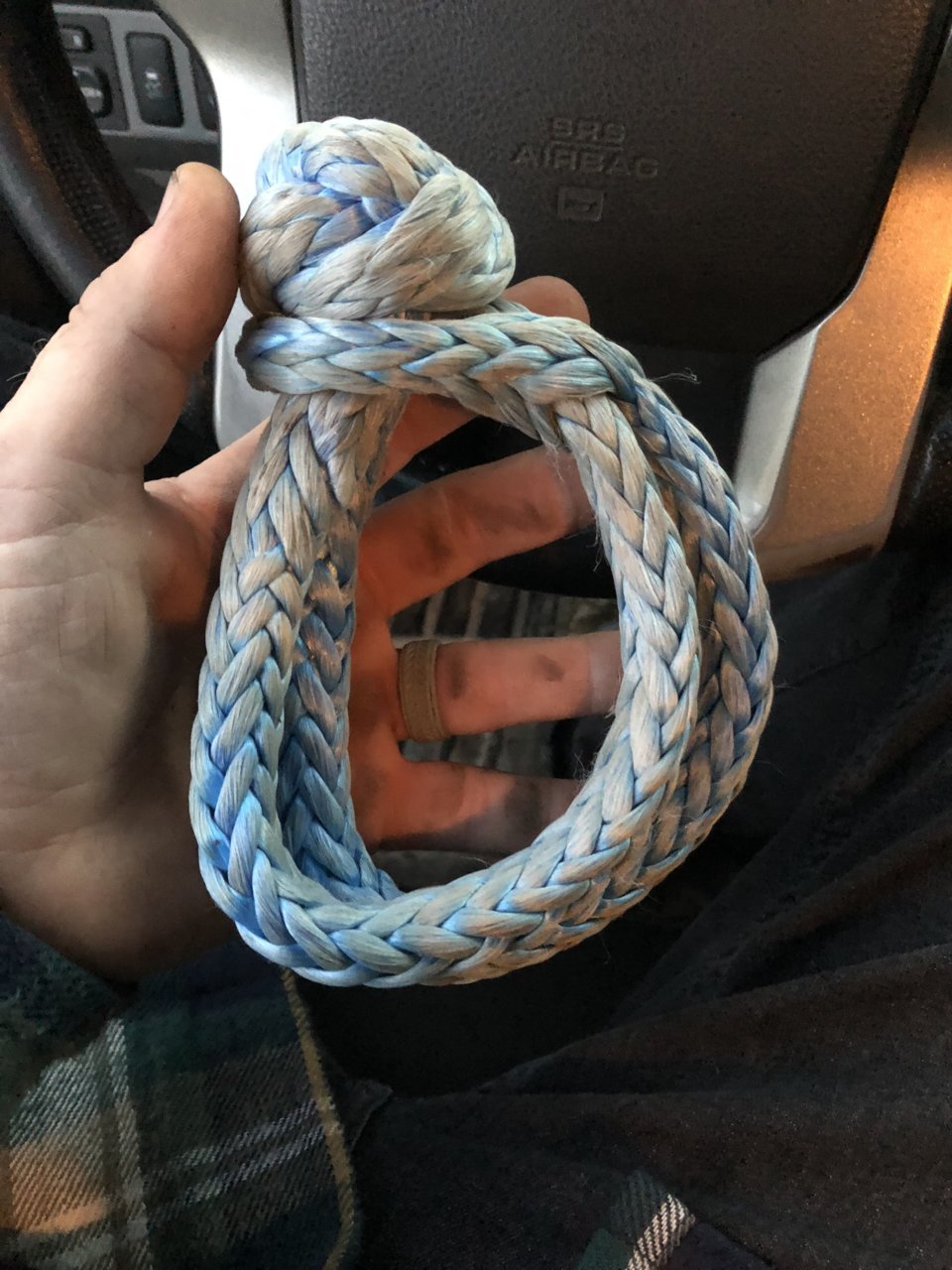

    Was walking the baby and pup around the neighborhood and saw a contractor stuck in a skid steer. Offered my help and went home to get my truck. This is the 2:1 winch pull was my go to. Ideally needed to go forward but there was nothing to snatch off of in front of him. The guy felt the need to offer me money for the rescue but I declined. Was stoked to see my hand tied soft shackle do work. The blue one was on my front bumper D ring, the silver was on the tie down point of the the skid steer that is just a cut out in a steel plate.. not a suggested anchor point for a soft shackle but it worked out well.

    You never got those soft shackles strength tested so I don't trust them...

    Oki next time we wheel and you stuck I won’t pull ya out :D
