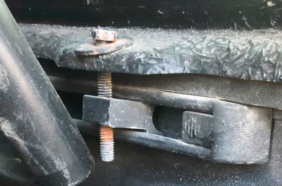

    First, I love your build and how you use your truck:thumbsup:
    I can't ignore the hardware misalignment here
    There are spherical washers that can make that sit flat, you have a fair amount of angle there, so one stack might not do it but you can double stack them. Then you get the clamping force without point loading on one side of the bolt head, it will apply pressure across the entire surface.
    https://www.amazon.com/spherical-washers/b?node=16410941
    Keep it up! I always look forward to what comes next :cheers:

    I know, the bolt originally bothered me when I first got the cap.. learned to live with it. It’s held up to so much abuse tho I’m not touching it as of now. Goal is to dump the cap and go flatbed/canopy.

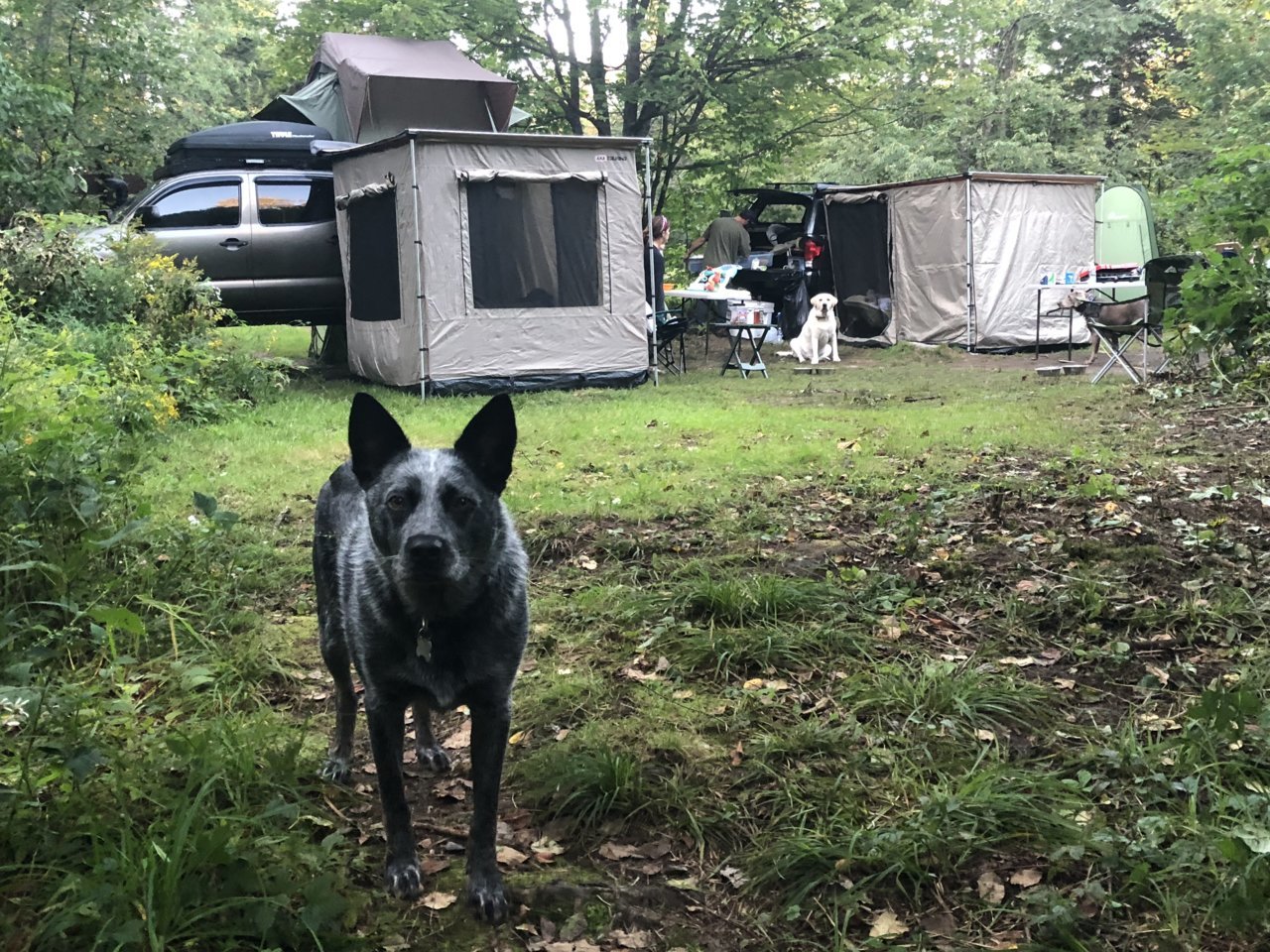

    I’ve always been set on a hard panel on the hood cuz no fuks drill all the holes. But just recently went camping with the fam and some friends, to fit us all in the site I stuffed my nose into the brush on the perimeter of the site. After camping for four days I realized that solar on the hood wouldn’t do me any good here cuz it was shaded the whole time. I had my awning room setup and noticed that the awning had sun on it every day. Thus creating the want for solar blanket. I want options to place it anywhere around the truck. Could still put on the hood at camp if I want.
