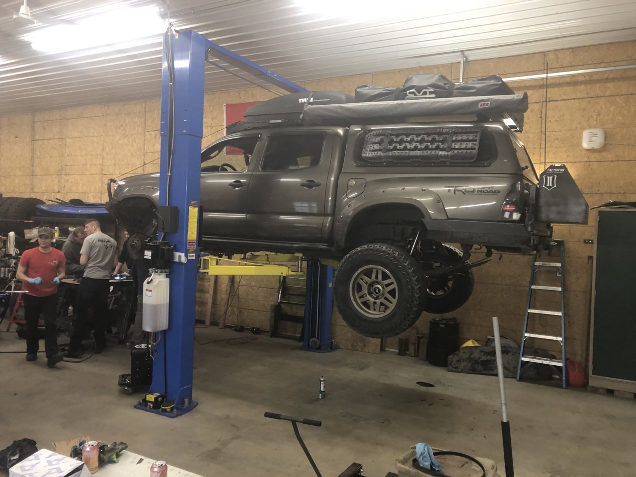

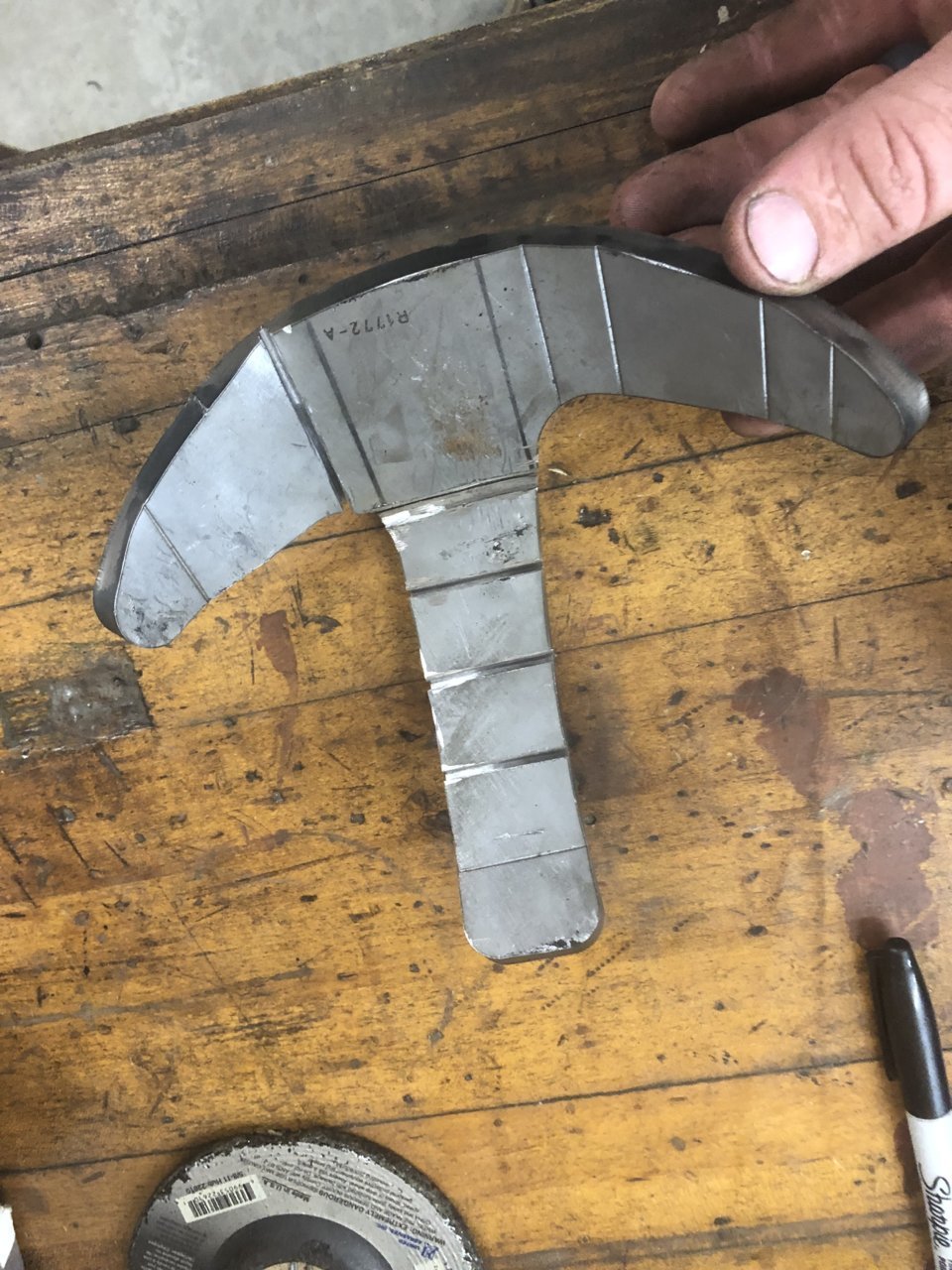

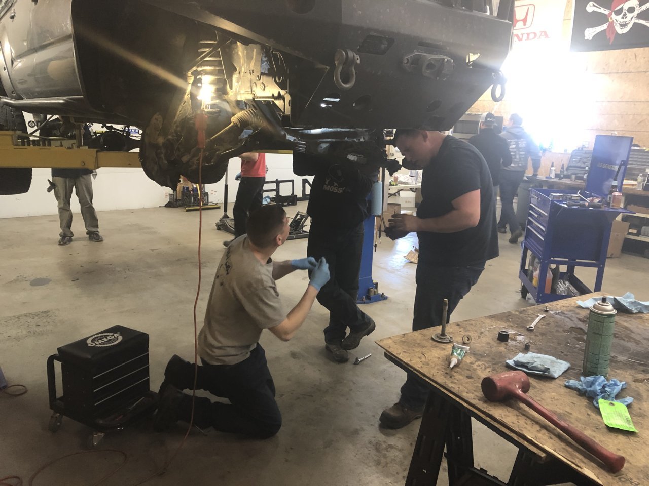

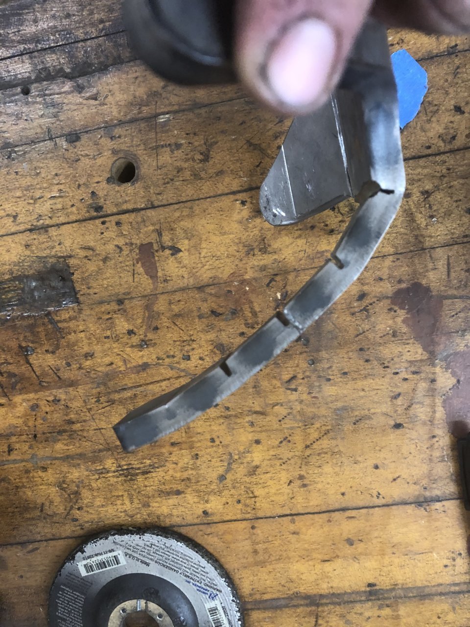

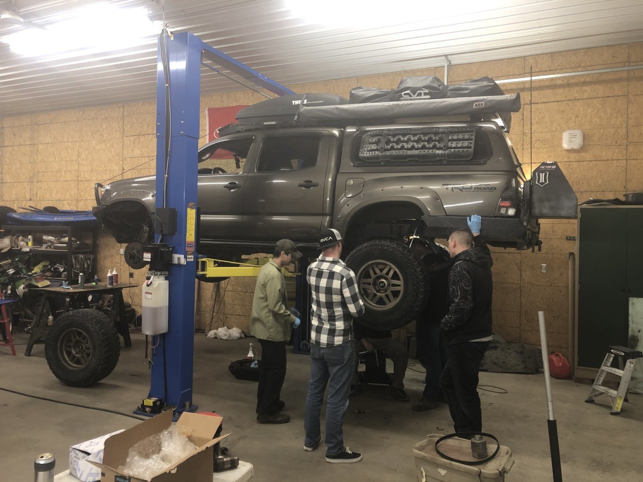

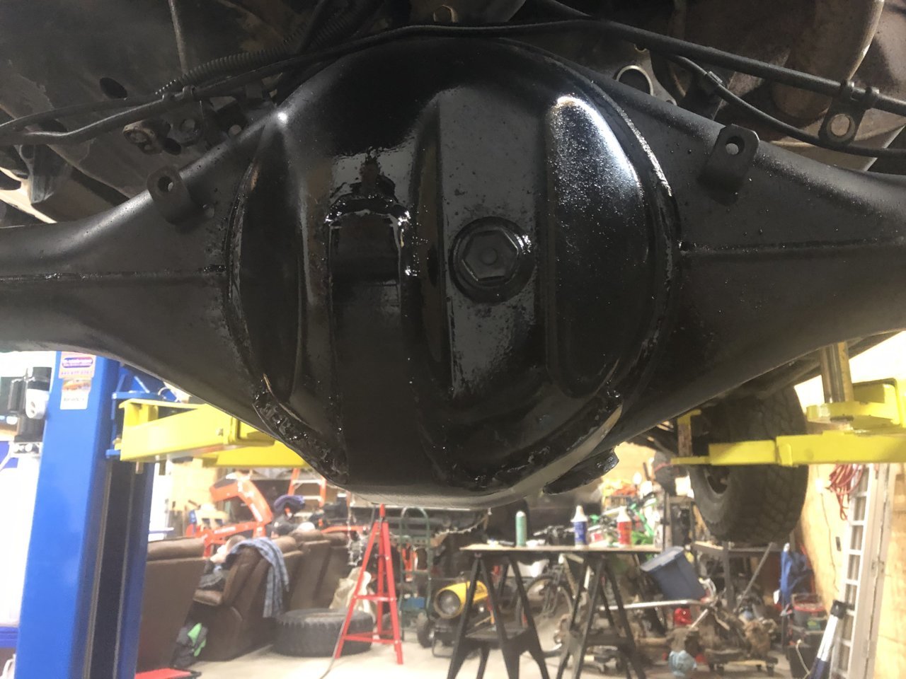

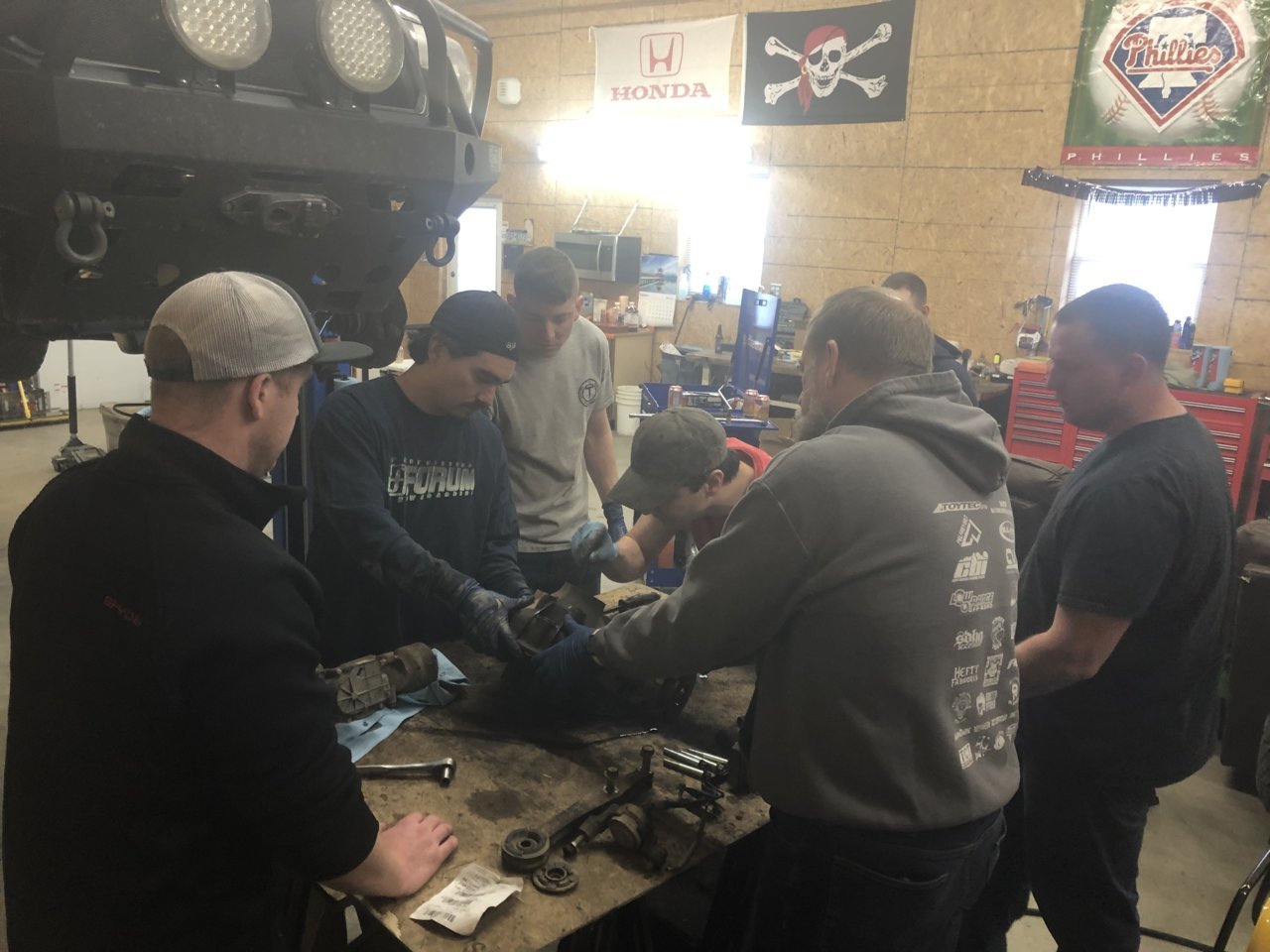

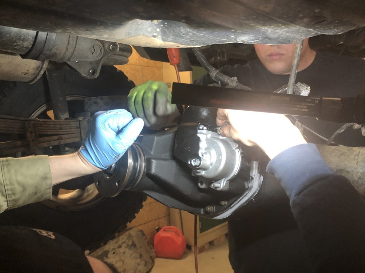

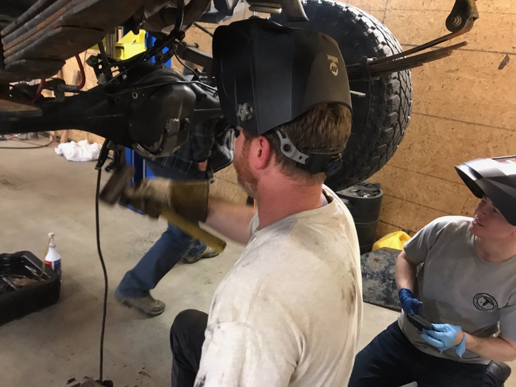

    Update:
    Been doing re-gear break in all week, couple hundred miles to go..
    Shout out to all who helped and BPF for time in the shop.,

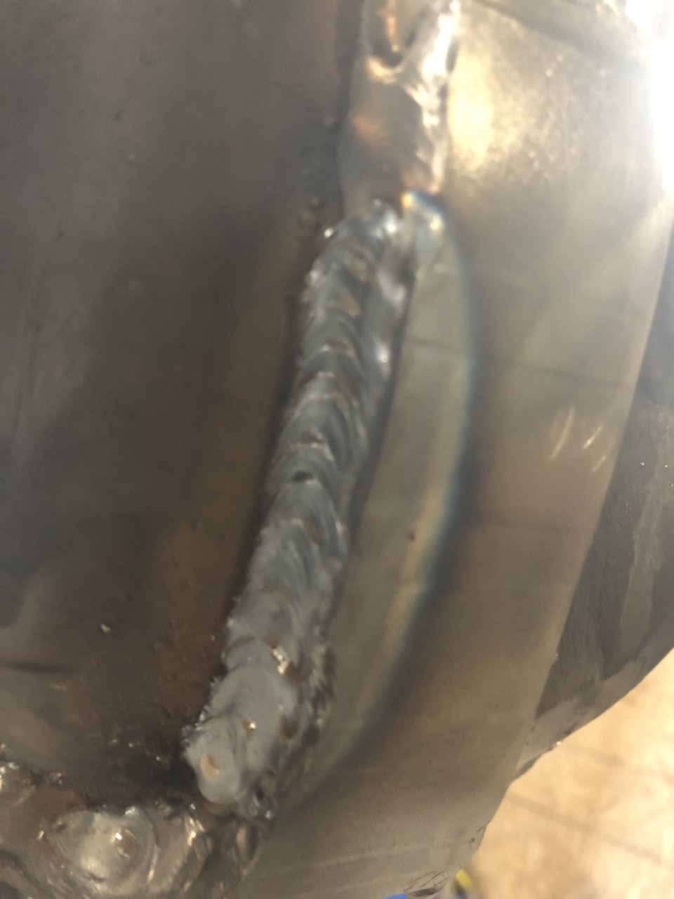

    Also nodded the mod. Picked up a Rough Stuff diff cover skid and made it work.. Fitment was way off so I put some relief cuts in it, prebent, welded, big hammered, and welded it to fit.
    D2282380-6E0F-4049-A65B-6A2EE5EB1ECF.jpg 2E8E5317-BFB6-4F07-A5E3-B26751C0EB5B.jpg 75611D6A-517C-49EE-B9FA-2A2A8EFD58CD.jpg 3C4EF09F-6C75-4066-A9C4-D7FD0DD4B146.jpg6958ECFB-7D71-4450-9931-358BC452768E.jpg F4C6E35D-DB22-4FF5-9B40-C6BC904B3733.jpgFD684414-F00B-41ED-A1DA-CF541910CE97.jpg

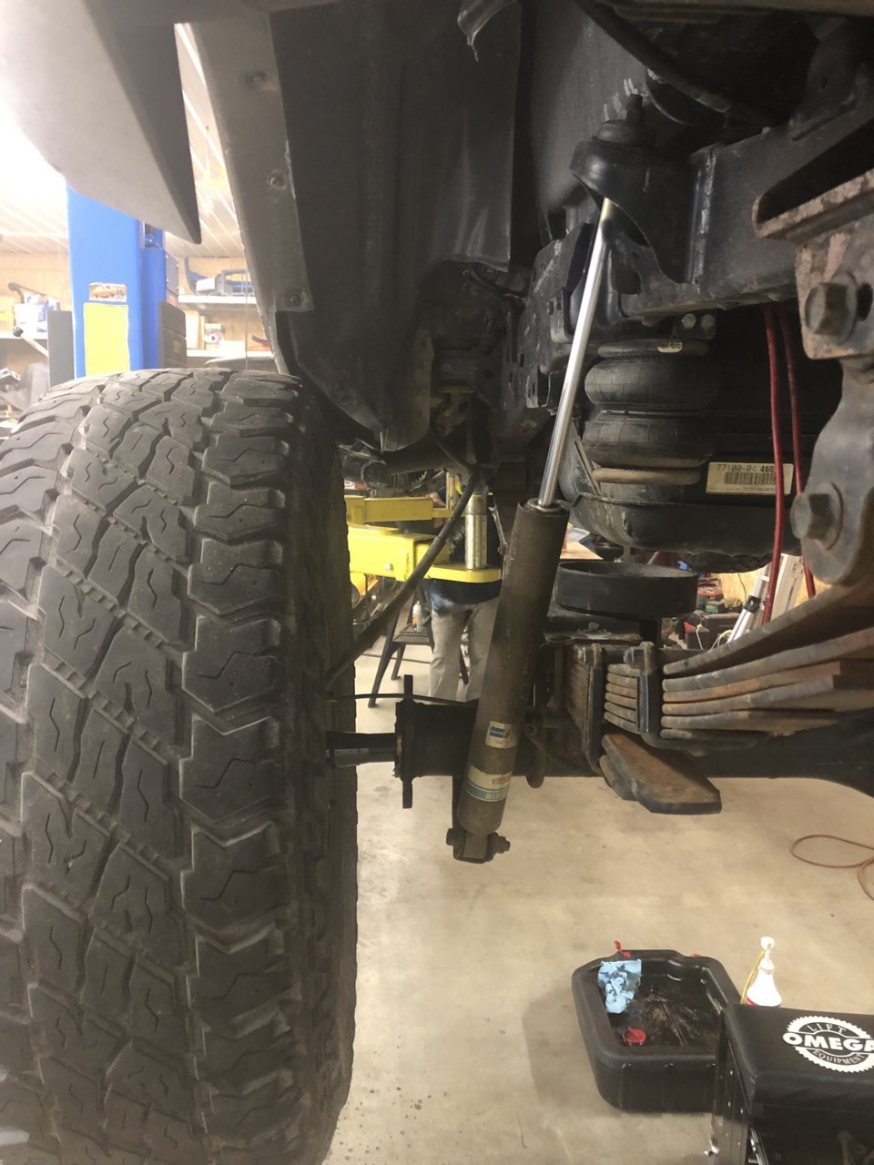

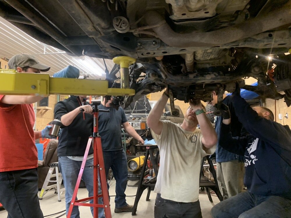

    Than time to put the rear back together with new E-locker actuator
    Didn’t even remove wheels :anonymous:
    027DFC7C-83F2-4ADF-943A-AD30D0BA61DE.jpg 9C687F4F-F39C-44AD-88E0-E0A03550A870.jpg 0EF7335B-13DD-4560-8DCE-6536D235E8DA.jpg
    Huuuuuuge shout out to @jrzyshore comong threw in a pinch :cheers:

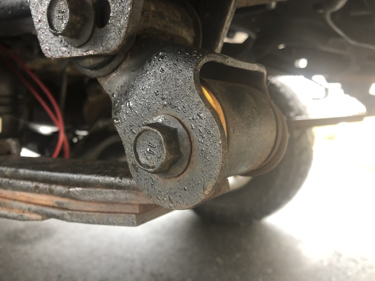

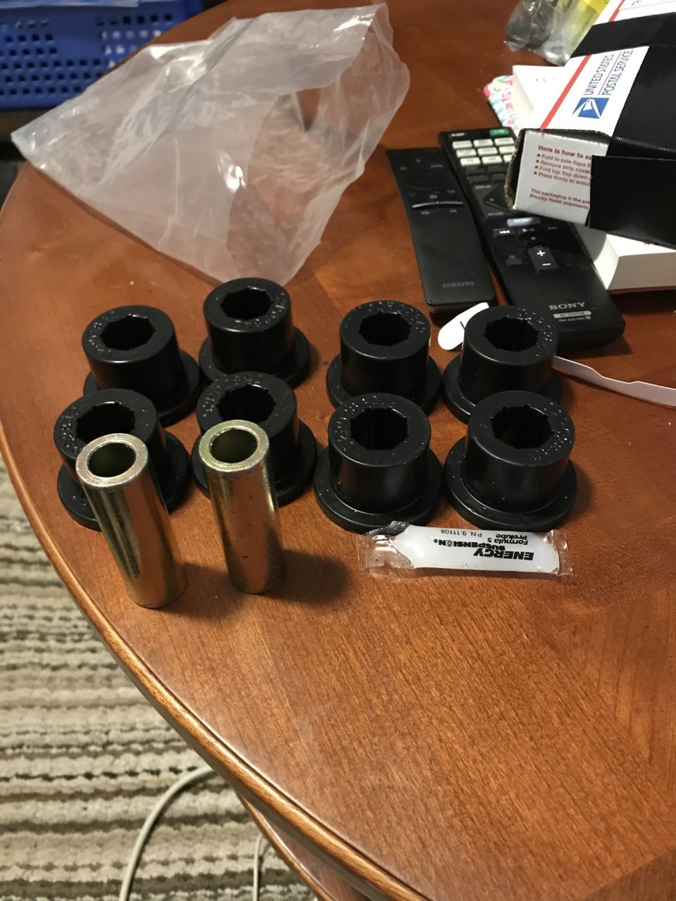

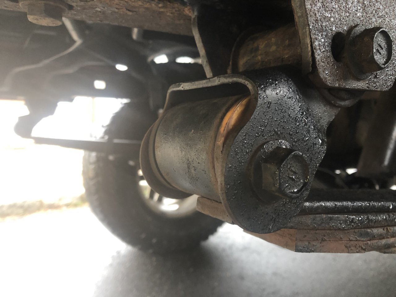

    Next up will be swapping out these leaf booshings..
    They woah’d out. The bolt isn’t even centered anymore.
    Driver
    Passenger
    inesshell and geekhouse23 like this.

    @EatSleepTacos had a set of these for sale!

    Heck yeah I do! I have enough bushings left to service the back bushings on each leaf pack.

    Mine ain’t that bad but they are due aswell

    This is what I have left for bushings if either of you want them. $25 shipped. You’d just need to reuse two of the sleeves.

    Do those fit the spring and the shackle? Chux can have yours, he needs them more than I do but if you have a link/part number for the kit I’ll save that for when I’m ready to swap mine.

    These ones are for just the leaf springs, because I stole the shackle bushings from it. This is the kit though that has all of them.
    https://www.amazon.com/dp/B00LSTUAQ6/ref=cm_sw_r_cp_api_i_rXcJCb4XAZVX2

    I am too, and this is what I put in them. Fits like a glove.
