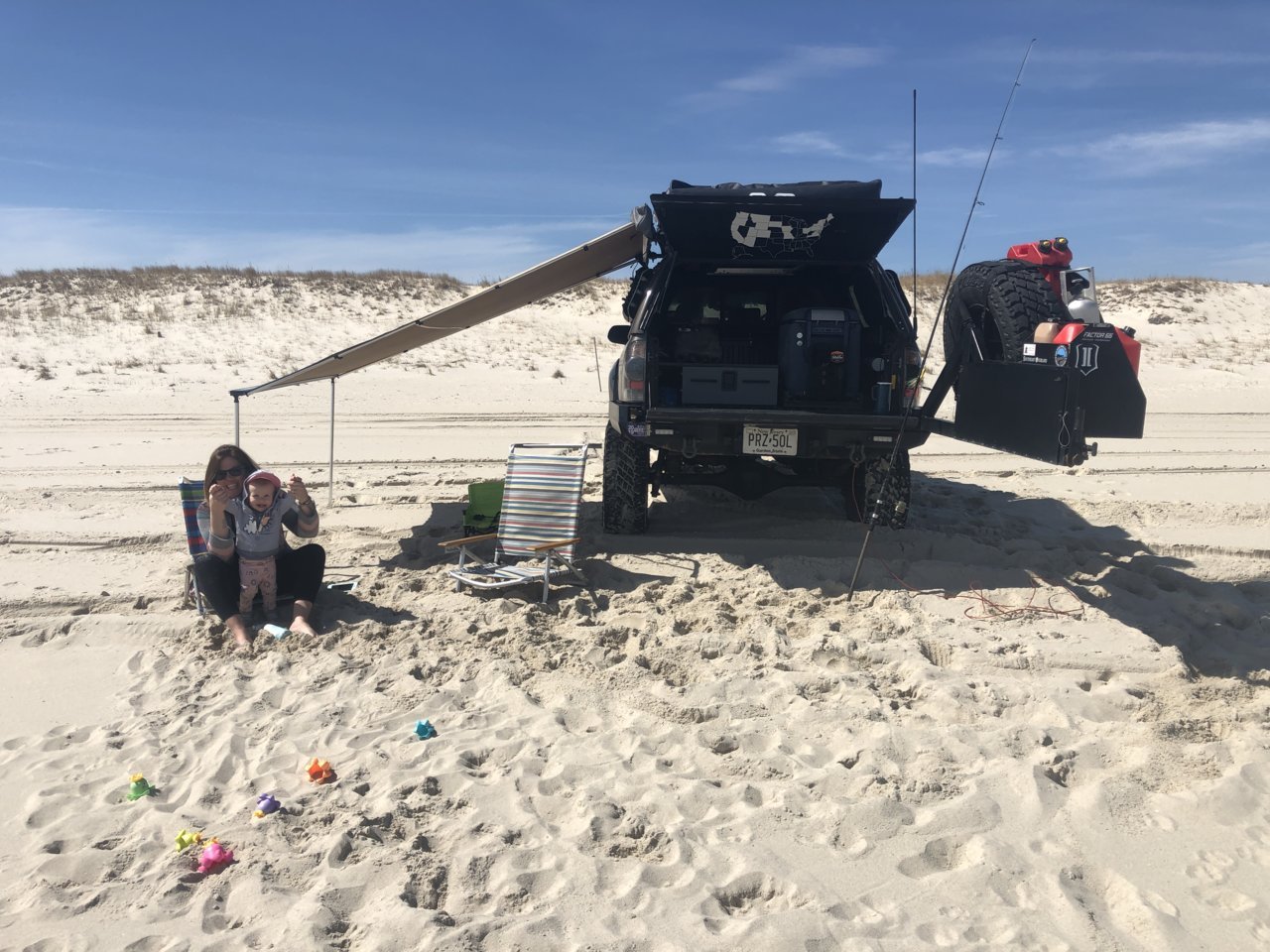

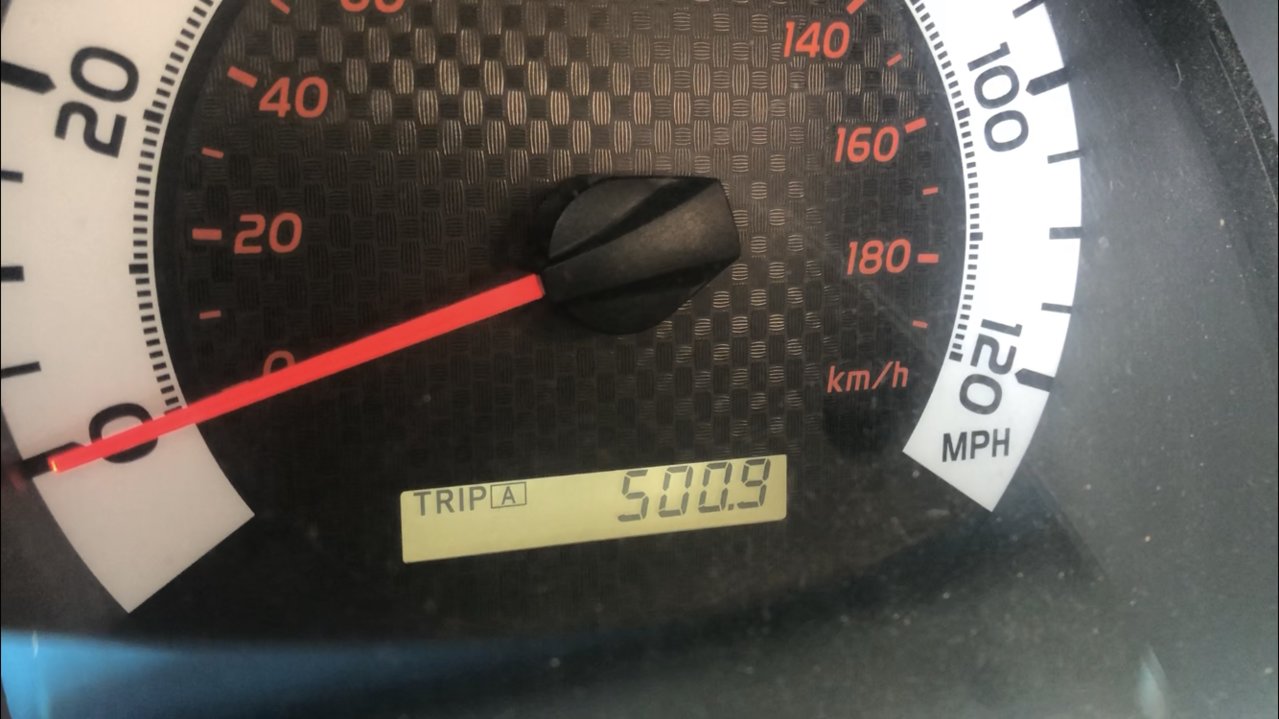

    New gears hit 500 miles yesterday literally as I parked on the beach
    E797EB1D-02CA-4A81-8FAA-F629F5B12313.jpg F3843C54-3945-4DEF-9A0B-E40AD013DD18.jpg

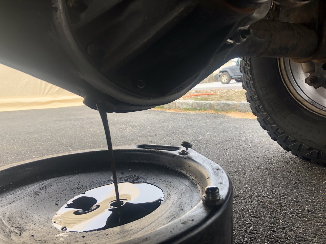

    Got home and flushed the gear oil
    87E68625-4D5D-4897-BCFF-B29C20207115.jpg 96C4CD72-FABA-40C0-B009-16091D955194.jpg

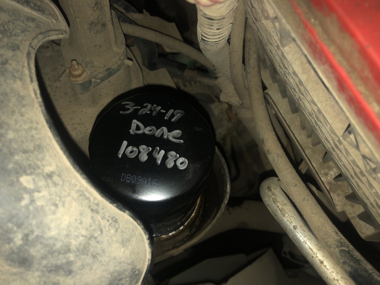

    Oil change as well

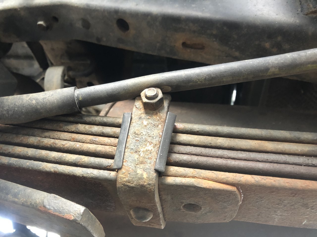

    Also I keep forgetting to address my e-brake cable rubbing on my leaf pack
    For now I’m going to add wire loom (prob double up) on the brake cable with zip ties
    Any other suggestions?

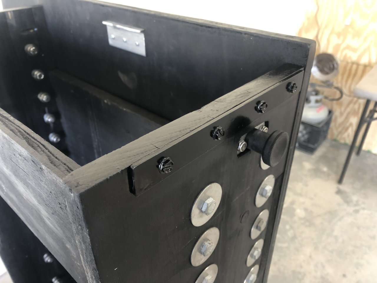

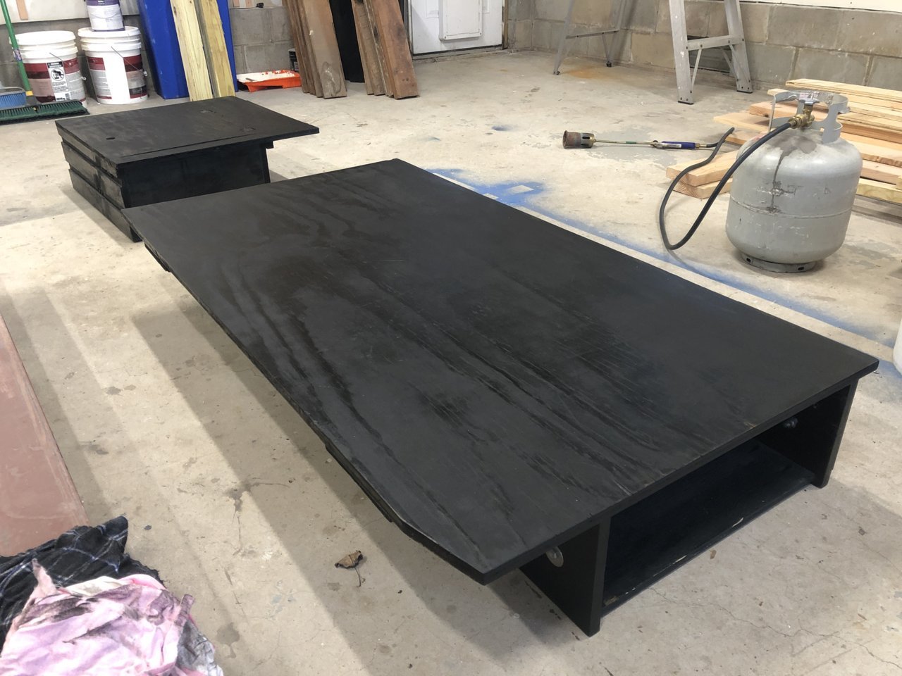

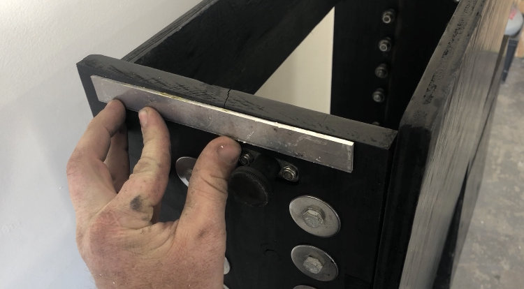

    While the drawers were out to reduce weight for break in period I fixed a crack with an aluminum bandaid and sanded, re-stained, and clear coated the drawer tops
    9932FD36-F0C2-44C4-8B8D-BCD109F5F3D6.jpg B2B8EE53-4ED5-4175-9225-338B7C625731.jpg 25327211-C358-4B9A-9DFD-44387C133C01.jpg

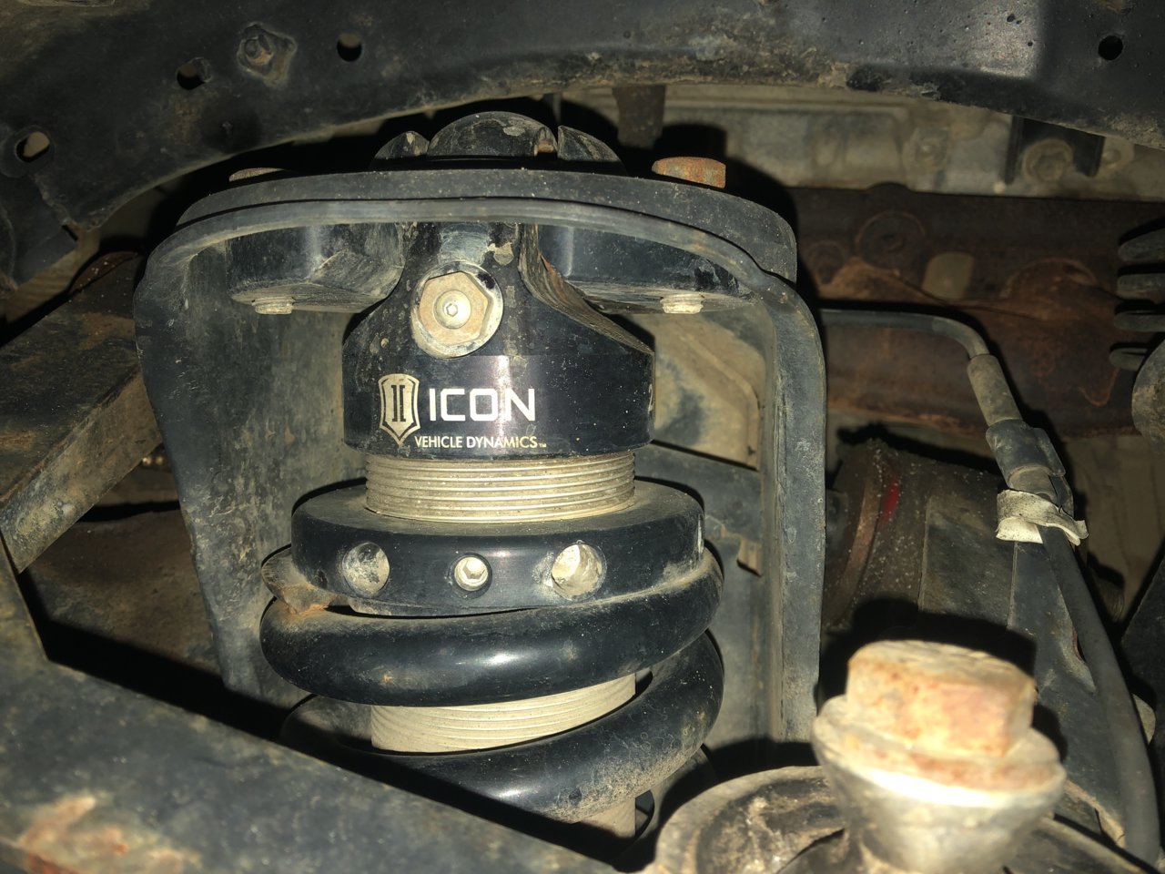

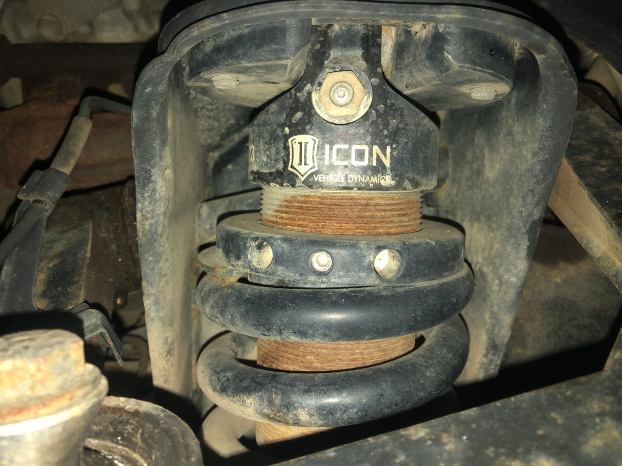

    Also was looking to crank down my icons a bit. After a trip to Canada, cross country, lots of miles on and offroad the front end could use some perk. My passenger side is hurting from beach life but driver isn’t so bad.. hit the threads with som PB to try and turn in a couple days
    Driver
    Passenger

    Zip ties are what I did for the ebrake cable. After 5k miles still there no issues lol

    Good ta know. Gonna double up the loom too anyway..

    You can get some fuel line/hose that’ll fit over the e brake cable and secure it with small hose clamps. Then it rubs that instead of the cable.

    I’ve been running wire loom on my e brake cable for 8 years. Still on the original pieces too

    I love this idea!! Any idea on how much weight these will support? Did you reinforce on the inside? I was thinking if I do this mod I’d run a flat 1.25” pice of steel with the same hole pattern as the track to bolt the tracks to. Acting as a long “washer” so to speak
  12. Mar 28, 2019 at 10:53 AM
    #2852
    Chux
    Chux [OP] Pura Vida
    Oct 1, 2013
    #113652
    6,234
    NJ beaches
    2013 TRD O/R Beach Buggy
    Click on my Build
    That would actually be a great idea..
    Something I would’ve done as well but I knew the mounts were Tred specific. If I was gonna do roto cans or any additional weight I woulda considered the flat stock washer. I just used the flat washers that came with the hardware to the track system.

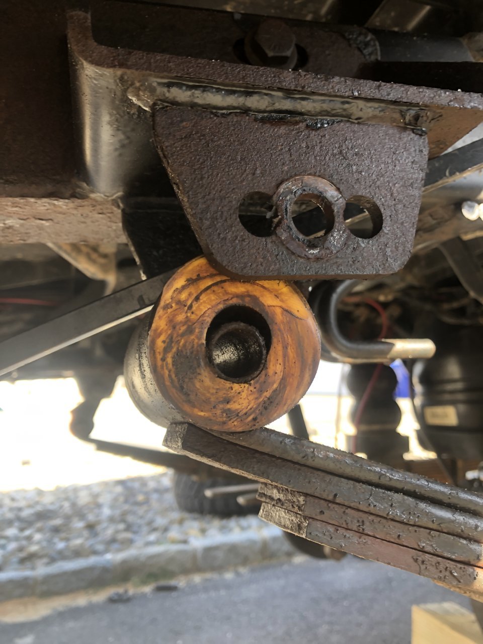

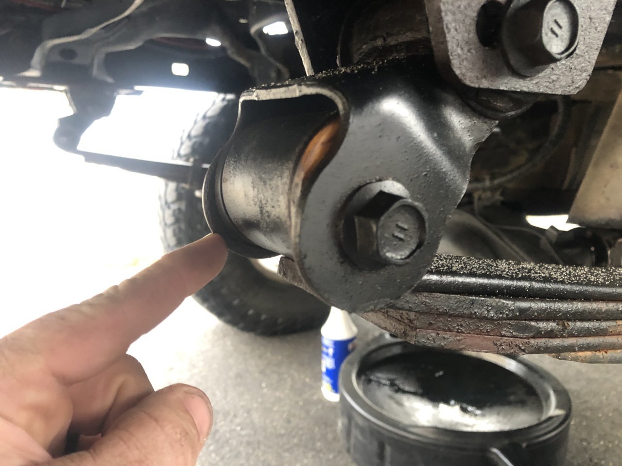

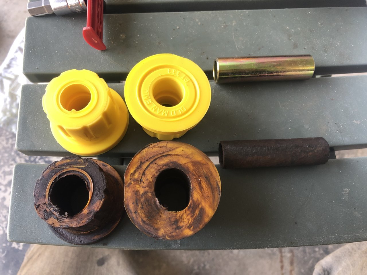

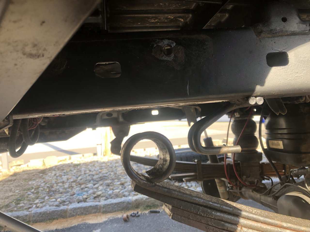

    Been wondering for days how my bushing swap was gonna go. After soaking the hardware three times over a week with PB I finally went in to see if I could actually unthread a nut.. One nut off led to another off which led to pulling the bushings and shackle flip mount.
    Bushings were definitely woah’d the fuck out

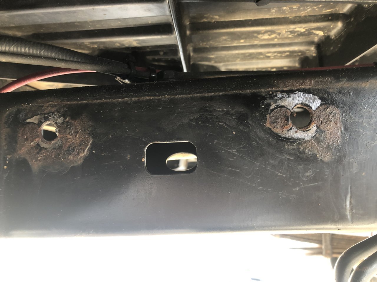

    It was wild to see the bare steel still shinny from grinding off the frame rivets to install the shackle flip. Thought for sure their would be corrosion itself on the frame but even that was clean. A bit of rust at the optional bolt holes but nothing to worry about.

    This makes me hopeful for my SOS to BAMF shackle hanger swap. Frame looks clean.

    And this is what failed POR15 looks like..
    https://youtu.be/P2DuVj7hkhk
    Plan now is to wire wheel the brackets bare and paint them with VHT chassis paint
