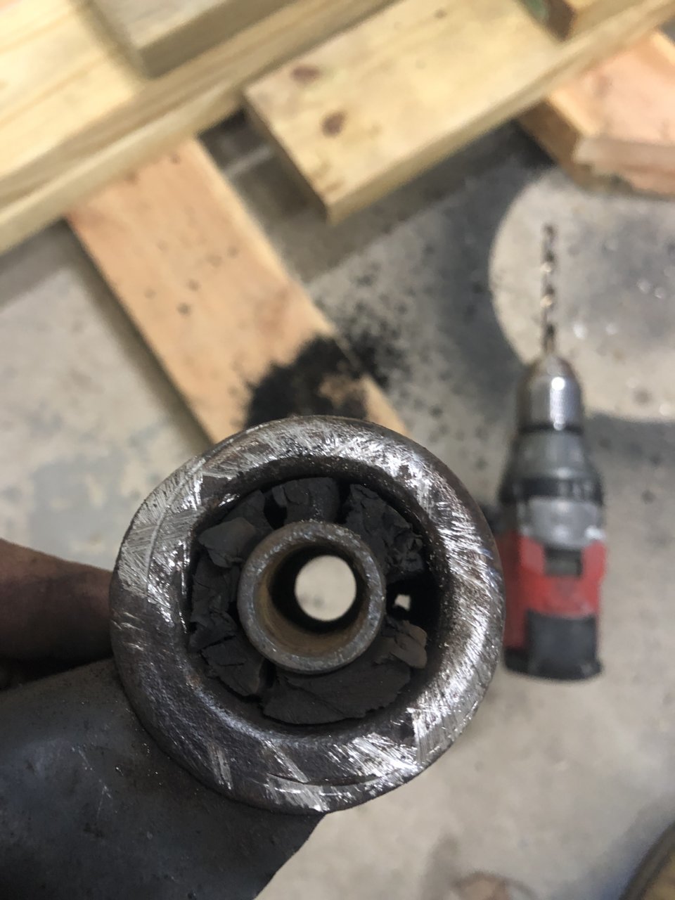

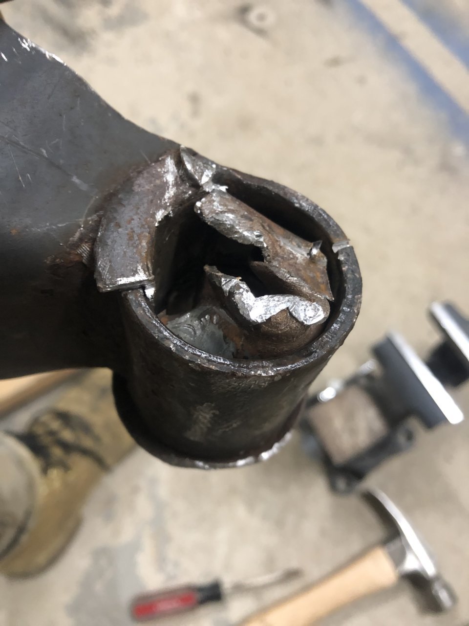

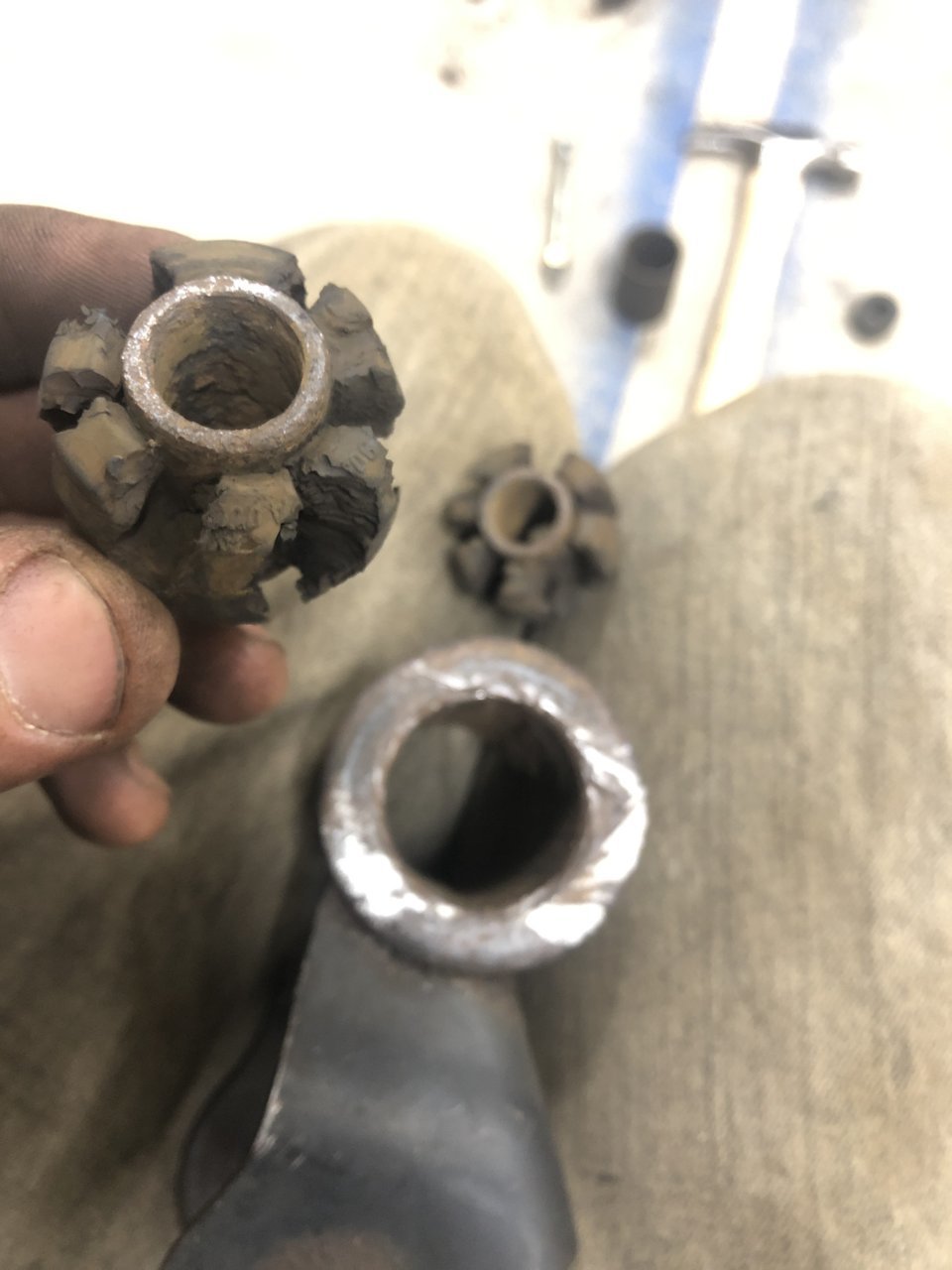

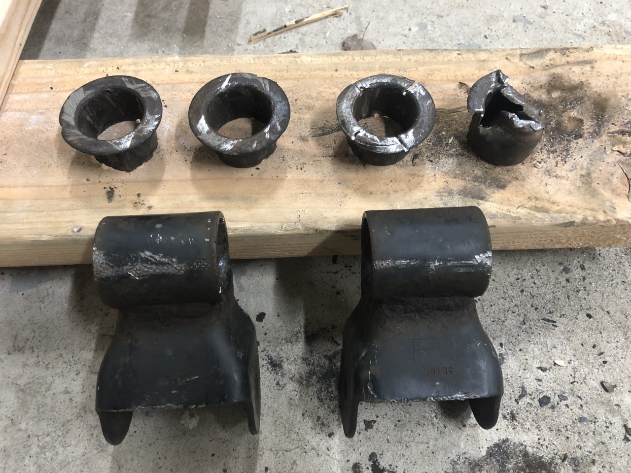

    Well hit the halfway point to booshing swap
    3hr job done in 3 days.. o_O
    Pulled driver rear spring bushings and shackle flip mount.
    I did need to cut the bolt to the stock shackle on this side.
    Faught with the stock shackle bushings and sleeves for a bit
    FAFFB8AB-C99B-4CFE-A552-24D6F827695B.jpg 6979B783-2BF7-4C48-B860-3C7C9AB224ED.jpg 525879FA-870A-45B2-91A2-97B61EBBA984.jpg 3CAD8C13-E2BE-460D-9819-C797E1B9CDCC.jpg
    (Above)
    Far right was the first one I did. Spending a lot of time smashing the sleeve in. Next to that made some minor cuts and noticed the inner seam, with a punch and hammer I quickly knocked it out. The next two on left I didn’t bother cutting just went right after the center seam. A little tough to get started but if you keep working the seam with a blunt punch they will jump right out. Key word is out, the two sleeves are already separated so work each side in an outward direction <—| |—>
