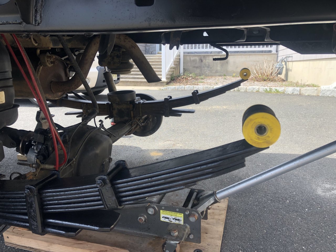

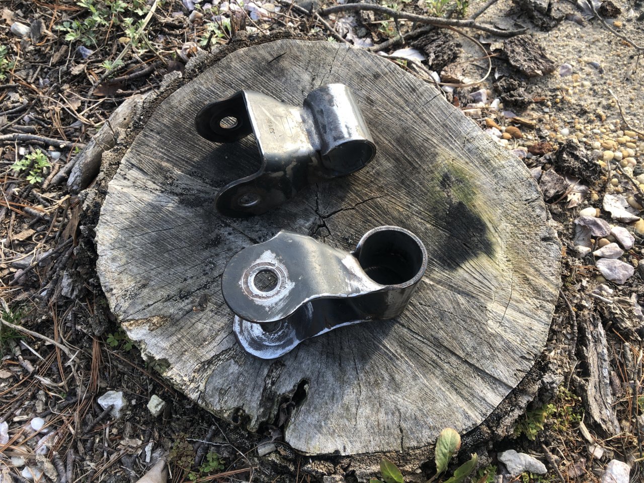

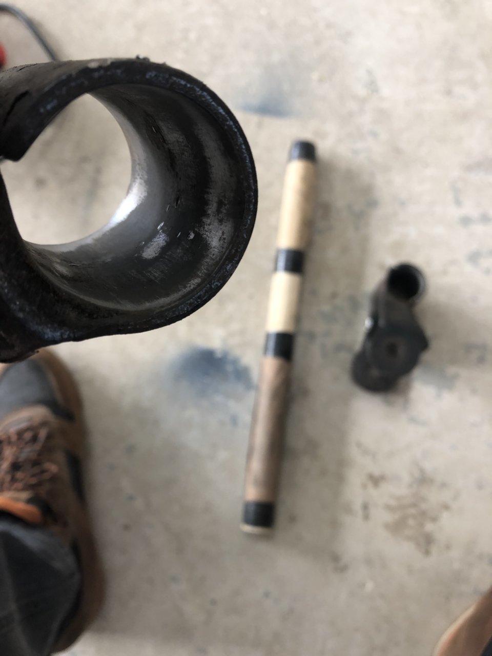

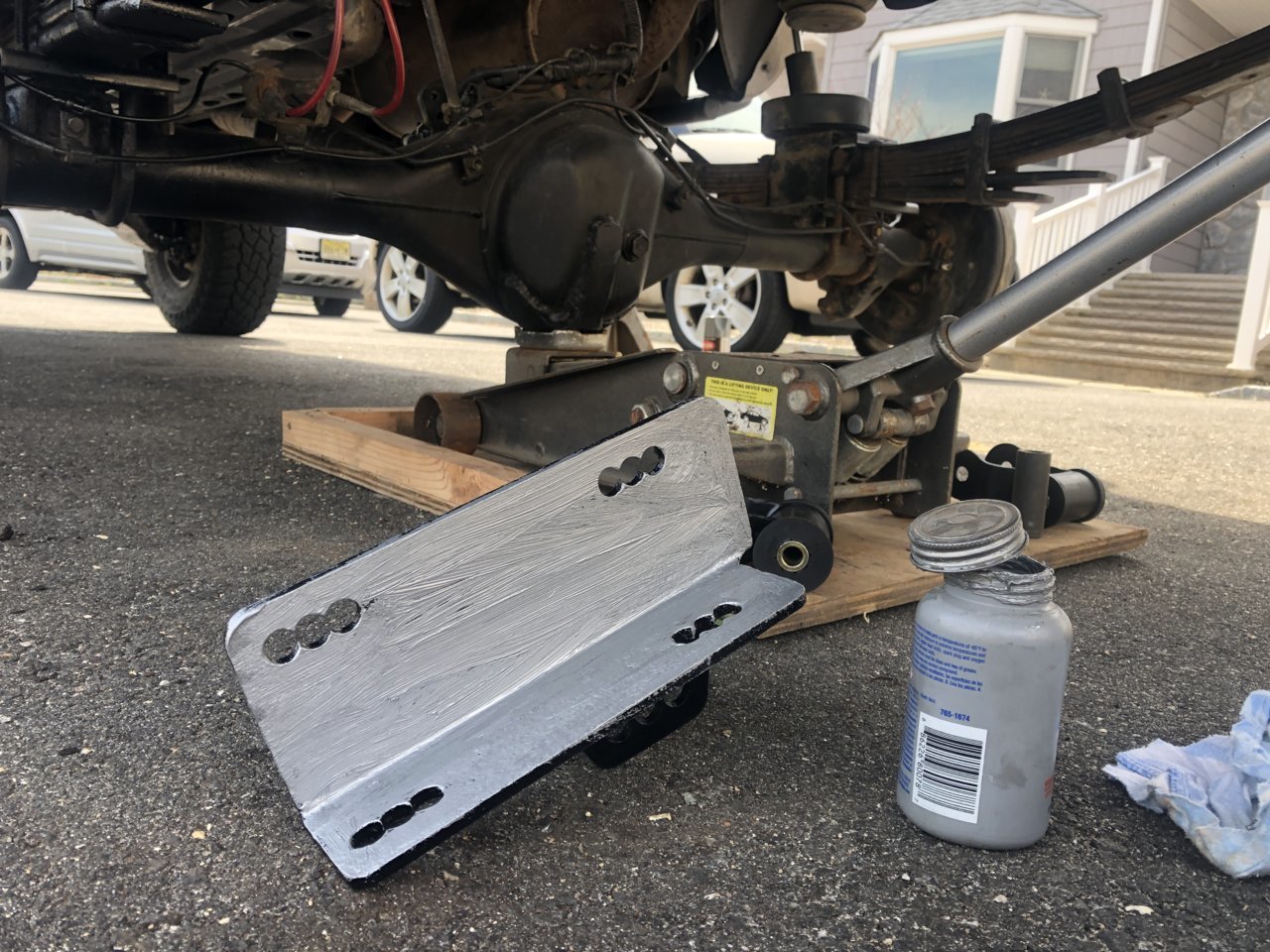

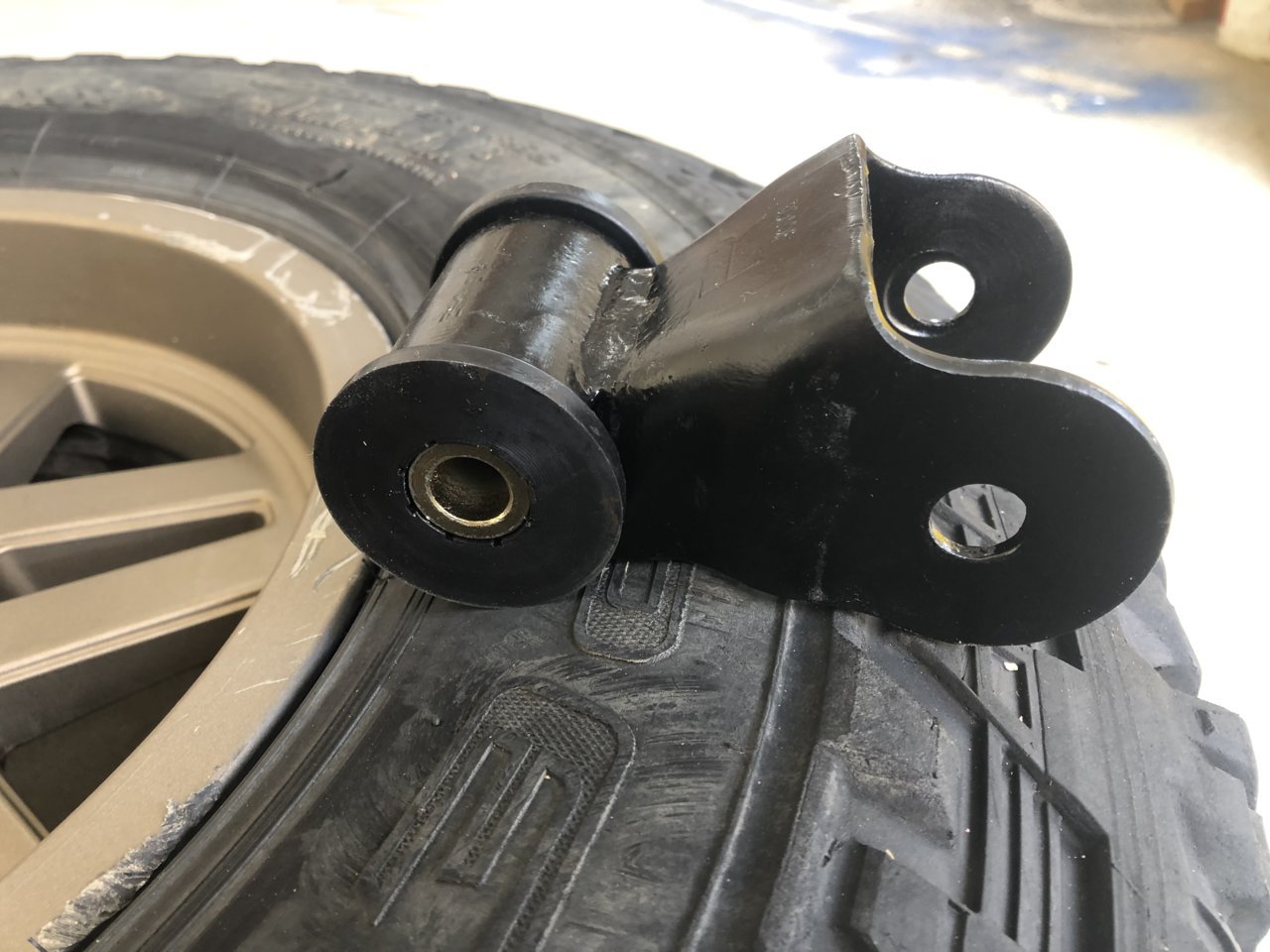

    Rise and grind

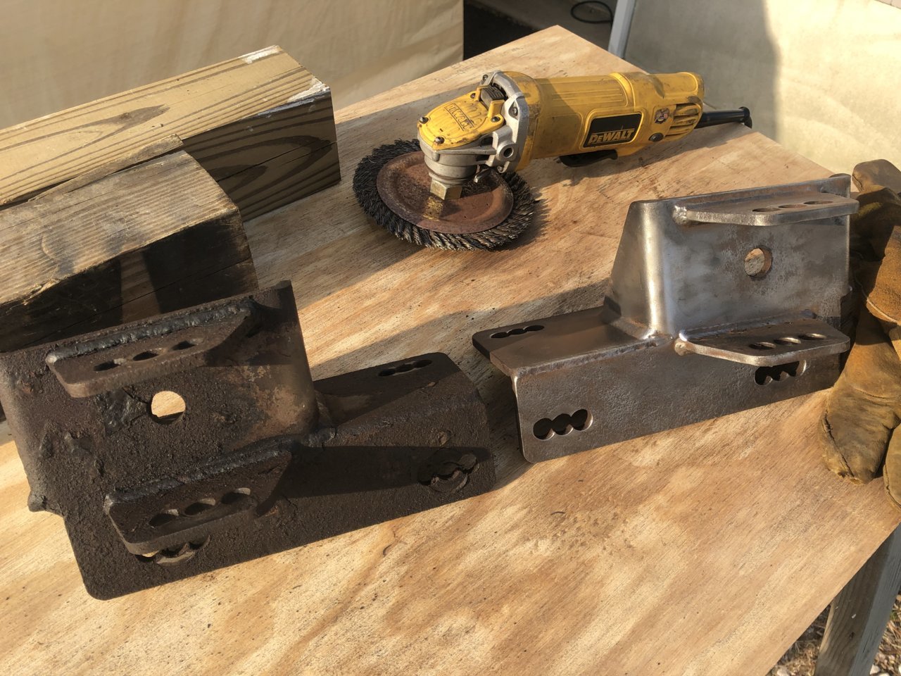

    Getting ready for paint
    07E9E326-C2AD-4985-BD9A-B8F73140641D.jpg D72689C1-085F-4066-AF17-6B70061FA2B2.jpg 9B0A6983-11AD-4925-9B60-6767A5AFAF50.jpg

    Just a heads up

    Yeah... $300 for those is way too much. I’ll say they are far superior over the OEM ones but no way are they worth it at that price...

    I was in at $150..now I'm out at $150/piece

    I don’t see the archive shackles listed separate from the hammer hanger kit, how much are just the shackles?
    4xinnovations has some, too.
    geekhouse23 likes this.

    ATO has greaseable shackles

    I see what you mean. If you’re interested I’m sure he can sell you just the shackles. He also offers a $20 discount for tw members.

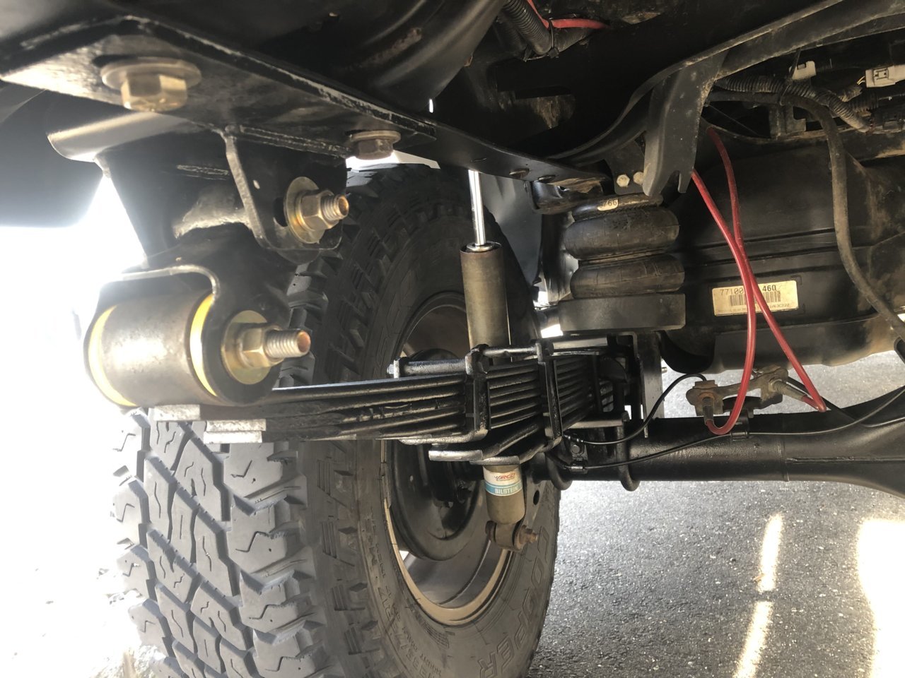

    I see you have the Bilstein B110 and the Dakar AAL- I have the same spring setup. My question to do your shackle flip is do you need a limit strap or does our spring setup limit the B110 from full extension? What length break lines did you go with?

    I’ll let chux answer that for you, but I’ll mention that in my case with b110s and a shackle flip, the springs limited the down travel before the shocks ran out of travel. But the uptravel had to be limited because the compressed length of the shocks was too long. I needed to extend my bump stops.

    I've got Timbrens - wonder if that'd work. Good to know.

    It would, uptravel barely needs to be limited.

    I have timbrens also, but still used a hockey puck mounted to the stike plate as a bump stop extension.
