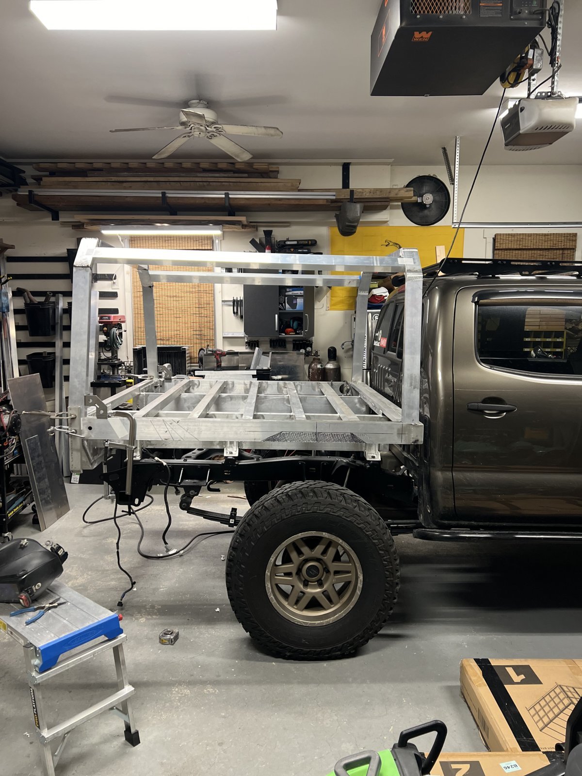

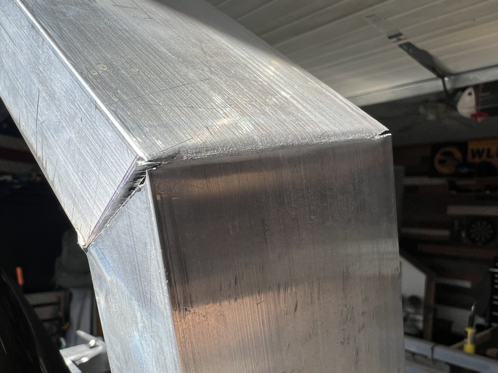

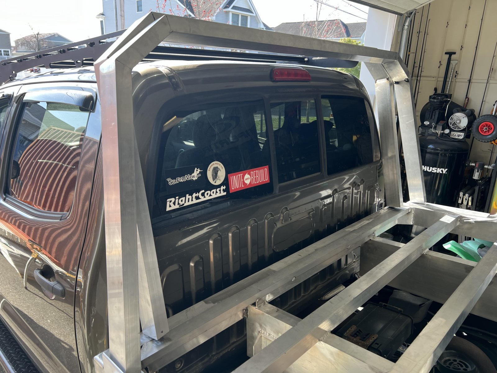

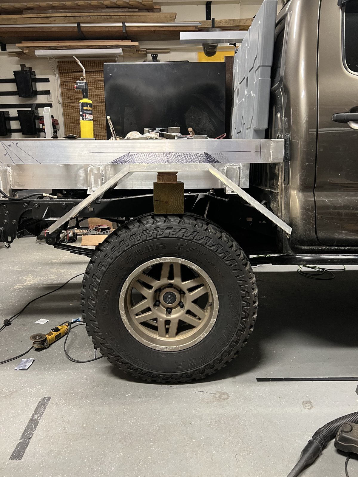

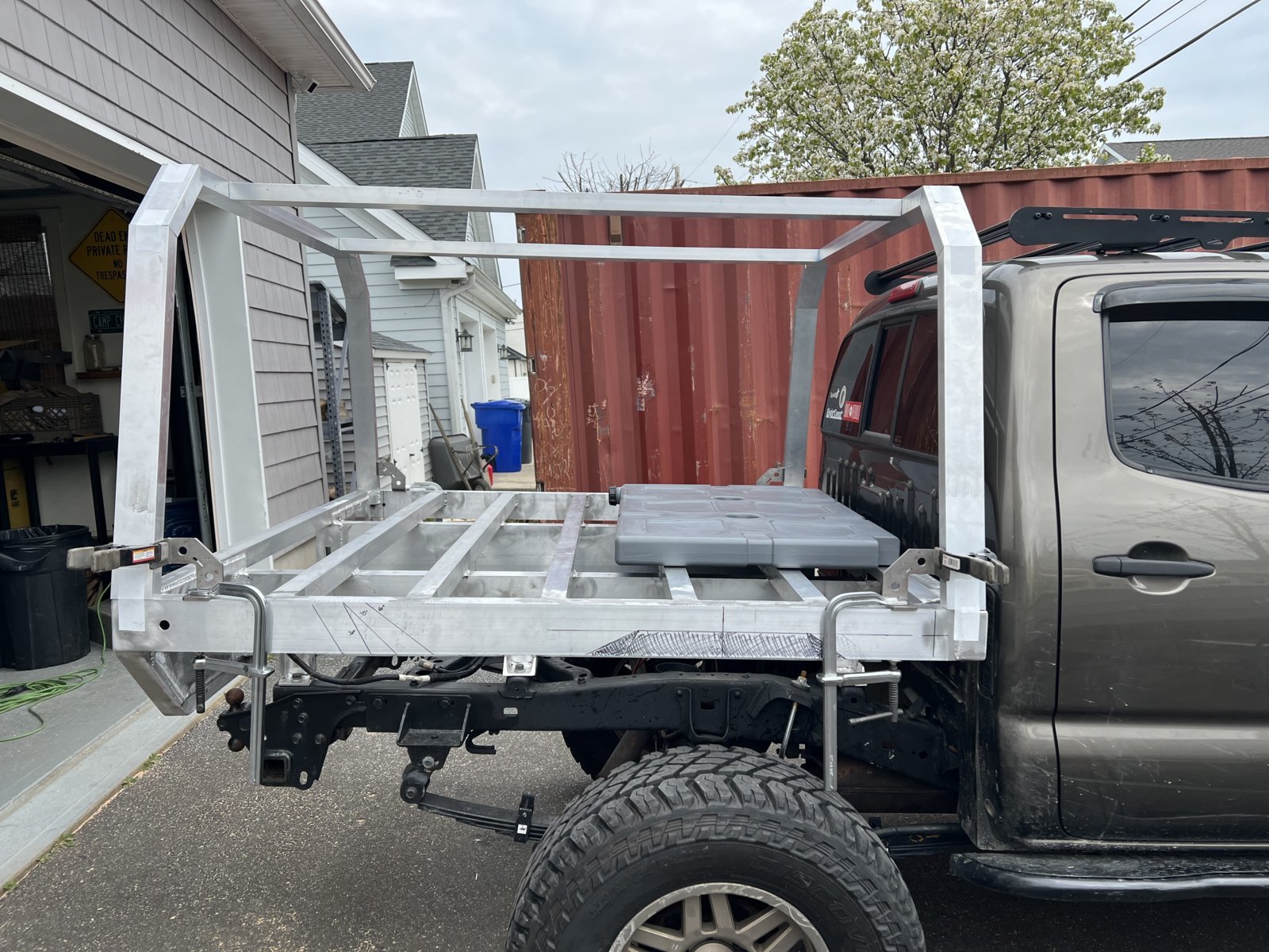

    This rack design kicked my stubborn ass. I wanted to pull off the design as one full piece of rect tubing… I mocked it all up with 2x4s to figure out what angles and lengths I wanted, then transferred the angle cuts needed to the 12’ piece of 1.5x3”. First attempt was off, the bottom ended up wider than the flatbed by 2.5”. I took that into consideration and bent another 12’er and it ended up wayy to small landing on the edge of the flatbed. Both attempts had cracking at the folds of 22.5° that didn’t sit well with me. I tried to heat it up super hot and even tried to drill out the two ends of the bend for relief but didn’t help. I said fuckit and decided to just make the whole thing from individual pieces..

    What series aluminum are you trying to bend? I hear 6061 doesn't like to be bent, but 5052 does

    Not sure. I don’t get that far with my metal supplier..
    I really wanted 2”x3”x3/16 for the rack and they said we only have 1.5”x3”x1/8 close to that dimension.. I just said sure I’ll take it..

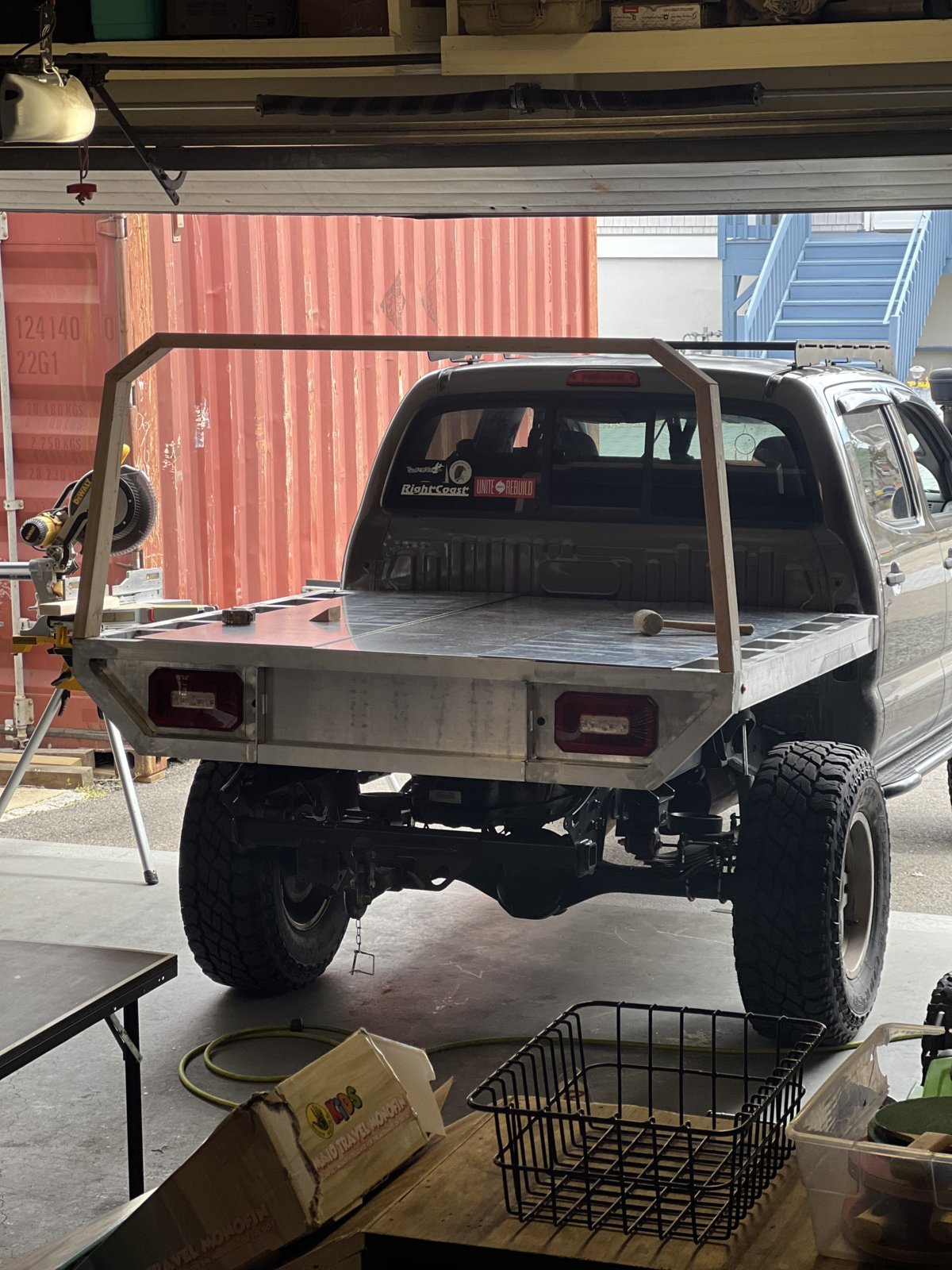

  10. Apr 19, 2024 at 9:49 AM
    #3110
    Chux
    Chux [OP] Pura Vida
    Oct 1, 2013
    #113652
    6,246
    NJ beaches
    2013 TRD O/R Beach Buggy
    Click on my Build

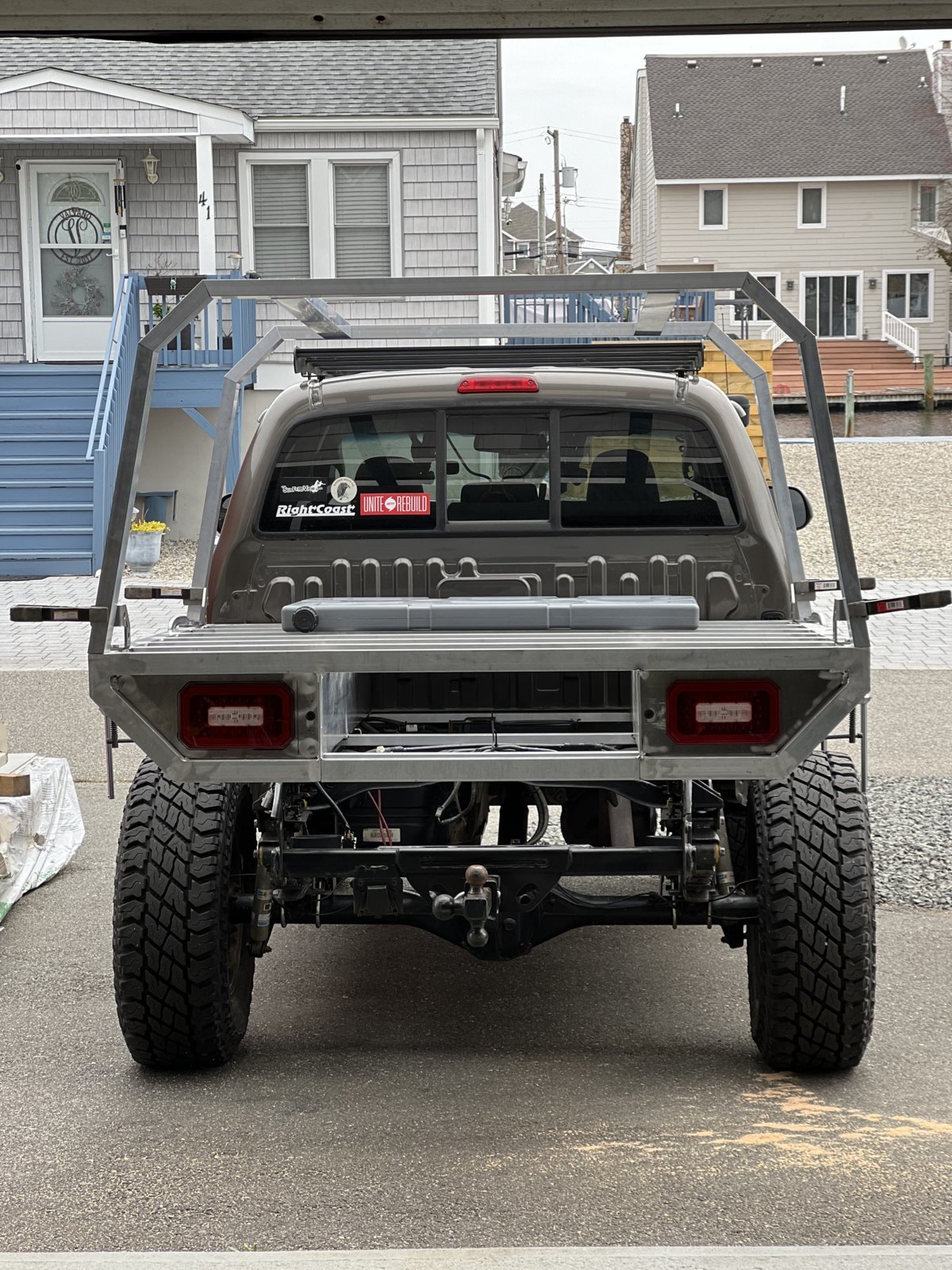

    Weird how it’s so close to a full canopy build but I’m not going that direction to save time.. Yet I’m still not done.

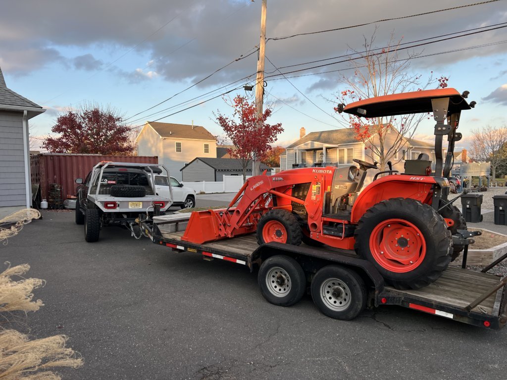

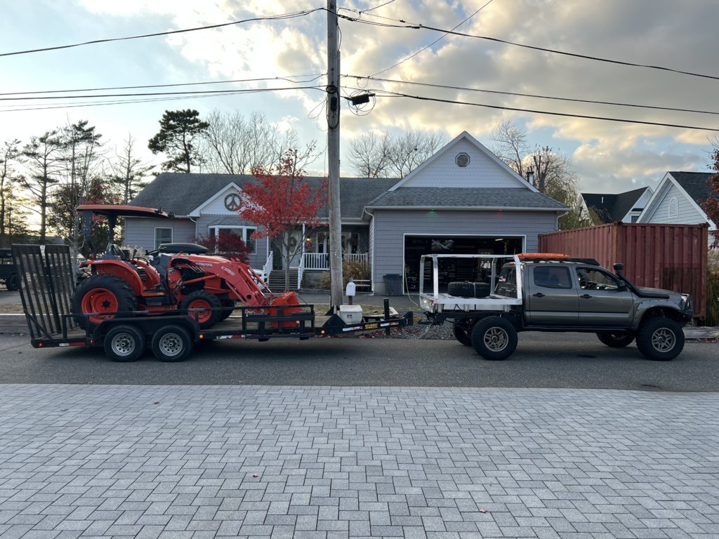

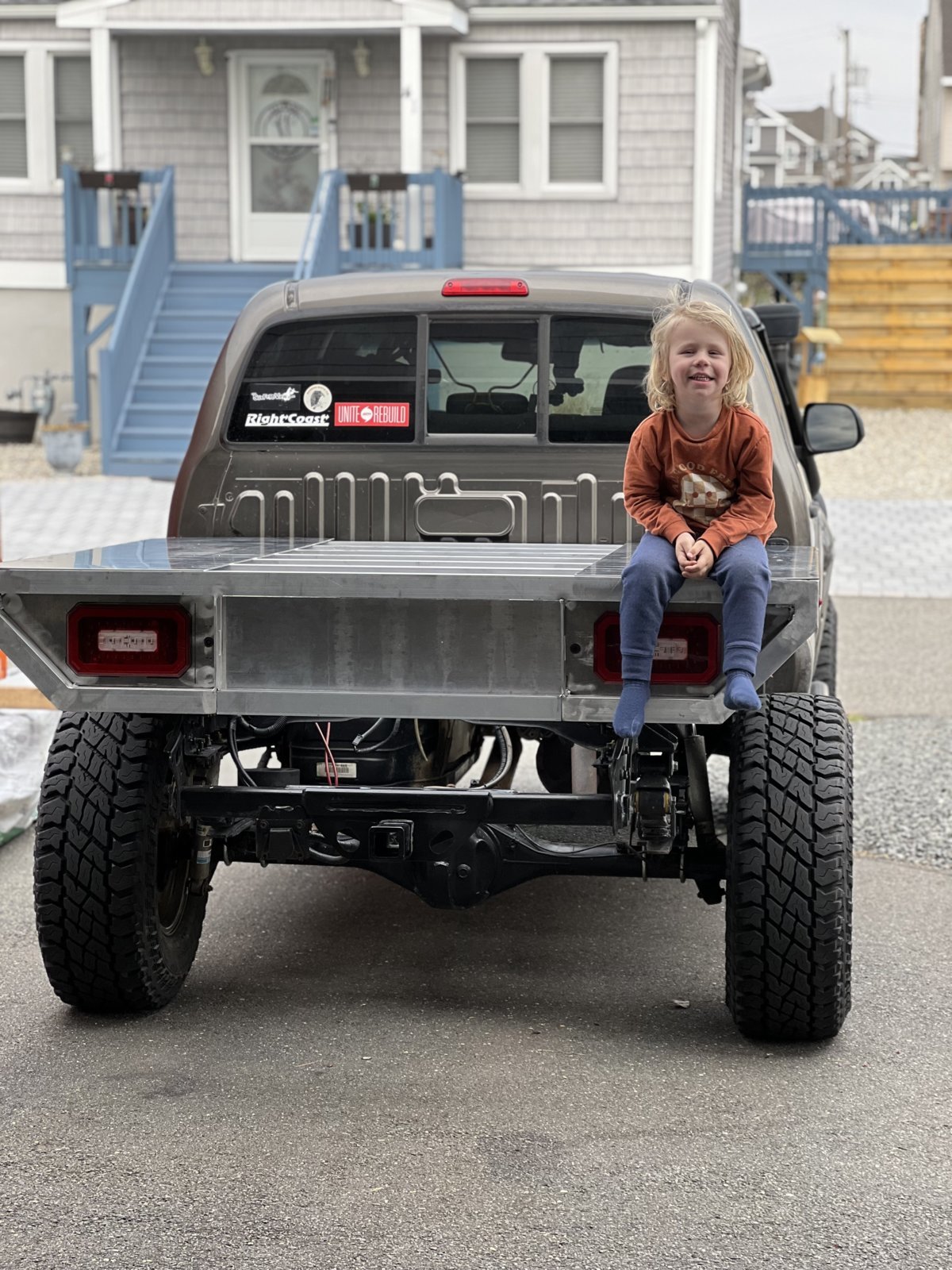

    New toy
    Nimble9, POOLGUY, fatfurious2 and 2 others like this.

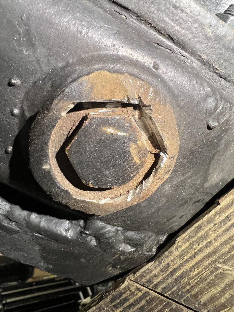

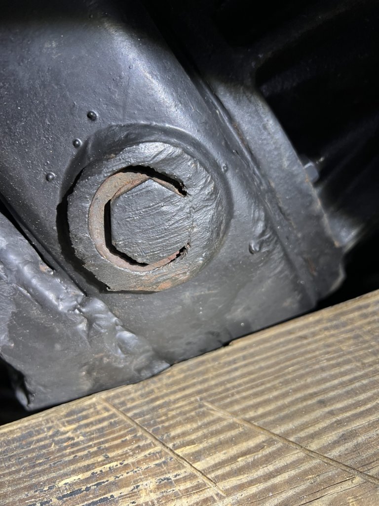

  12. Dec 3, 2024 at 12:42 PM
    #3112
    Chux
    Chux [OP] Pura Vida
    Oct 1, 2013
    #113652
    6,246
    NJ beaches
    Click on my Build

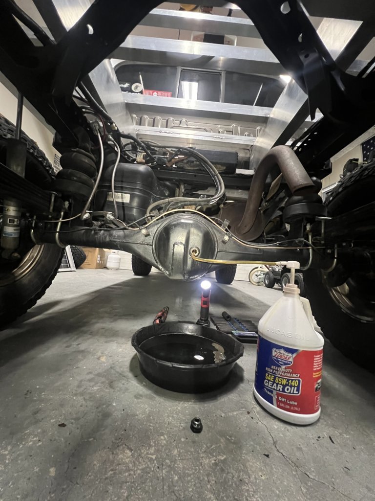

    11/27/24 Front and rear diff flush for reference
  13. Aug 4, 2025 at 12:51 PM
    #3113
    Chux
    Chux [OP] Pura Vida
    Oct 1, 2013
    #113652
    6,246
    NJ beaches
    Click on my Build

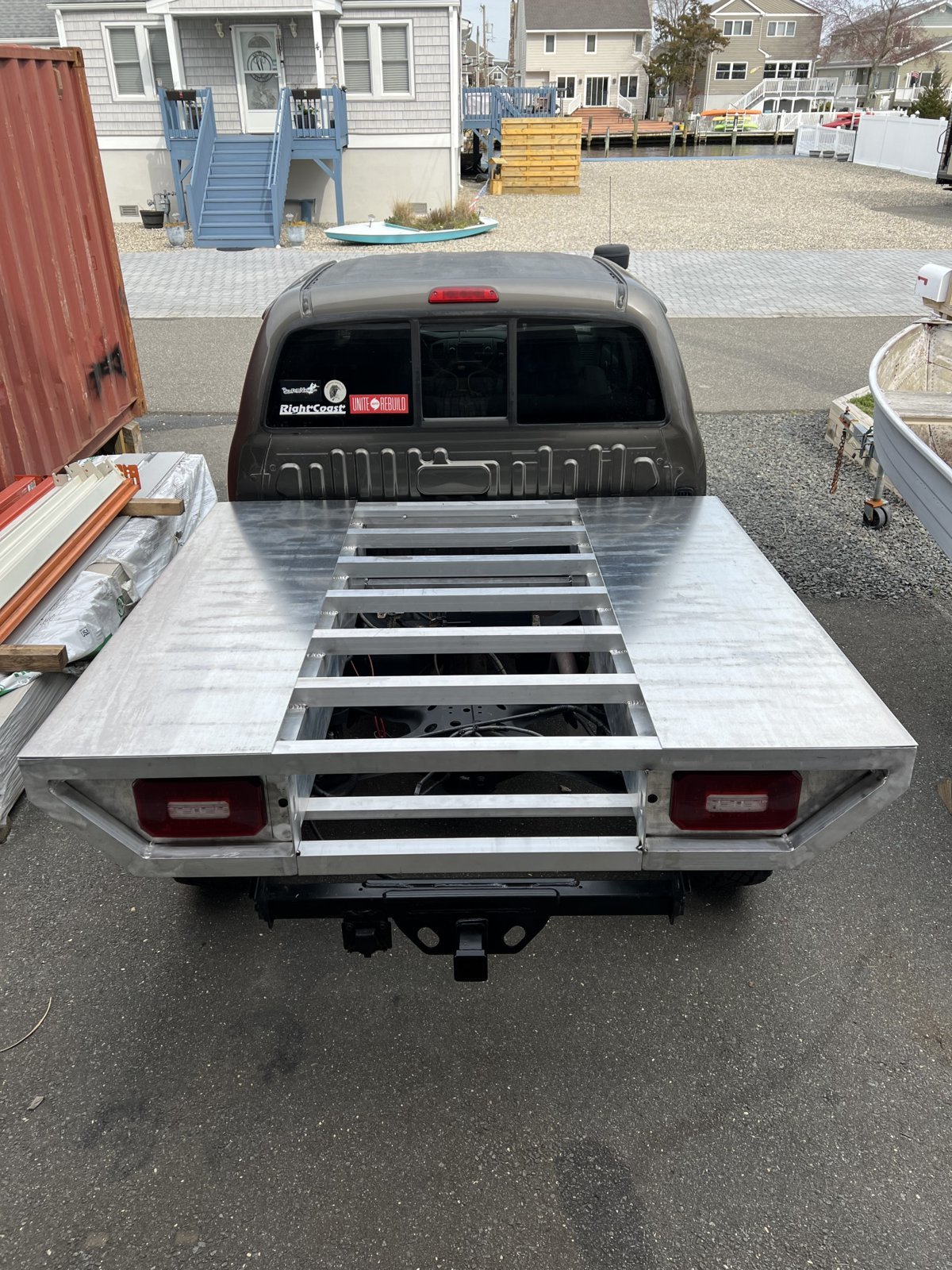

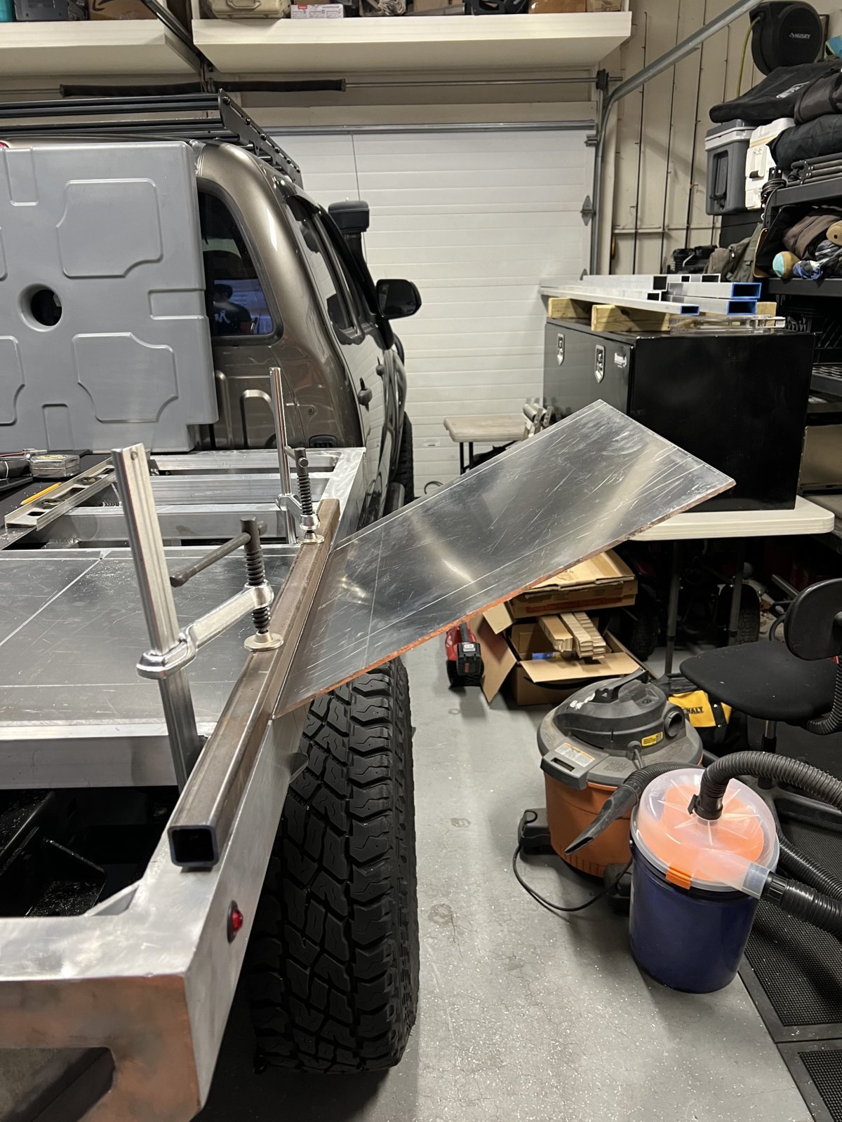

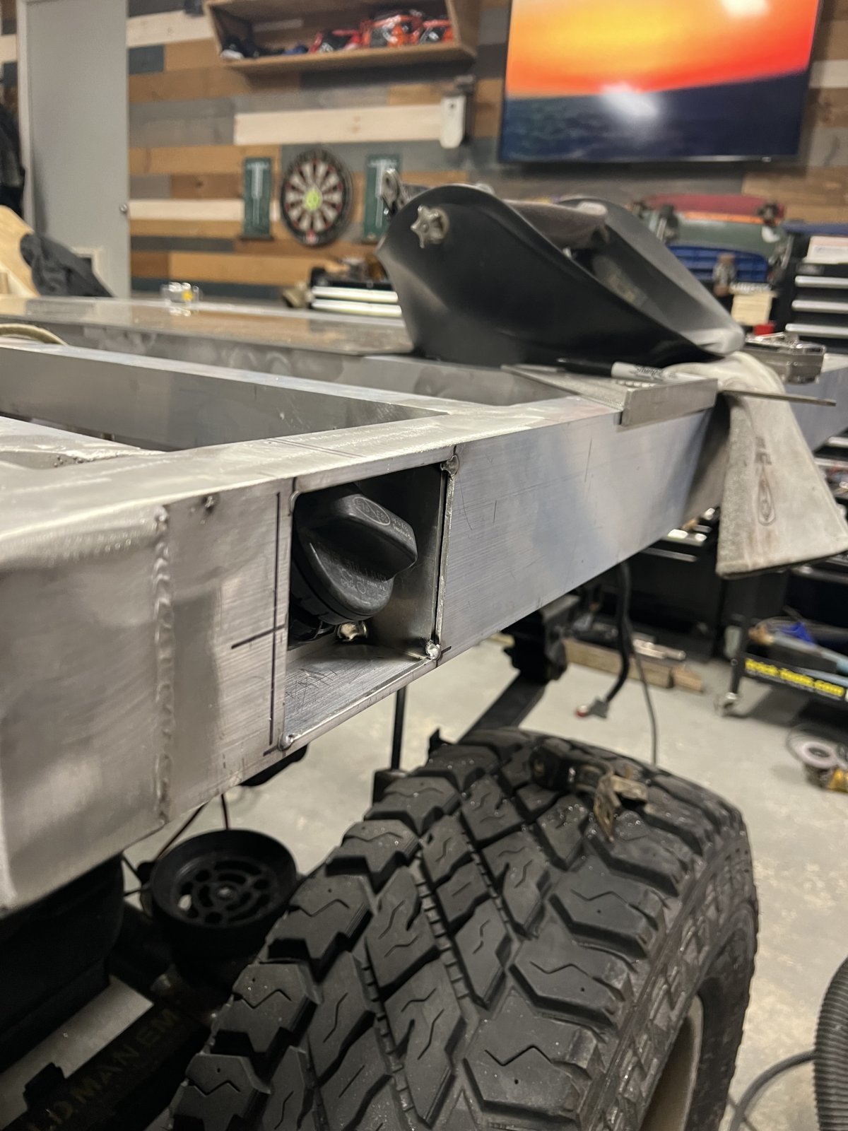

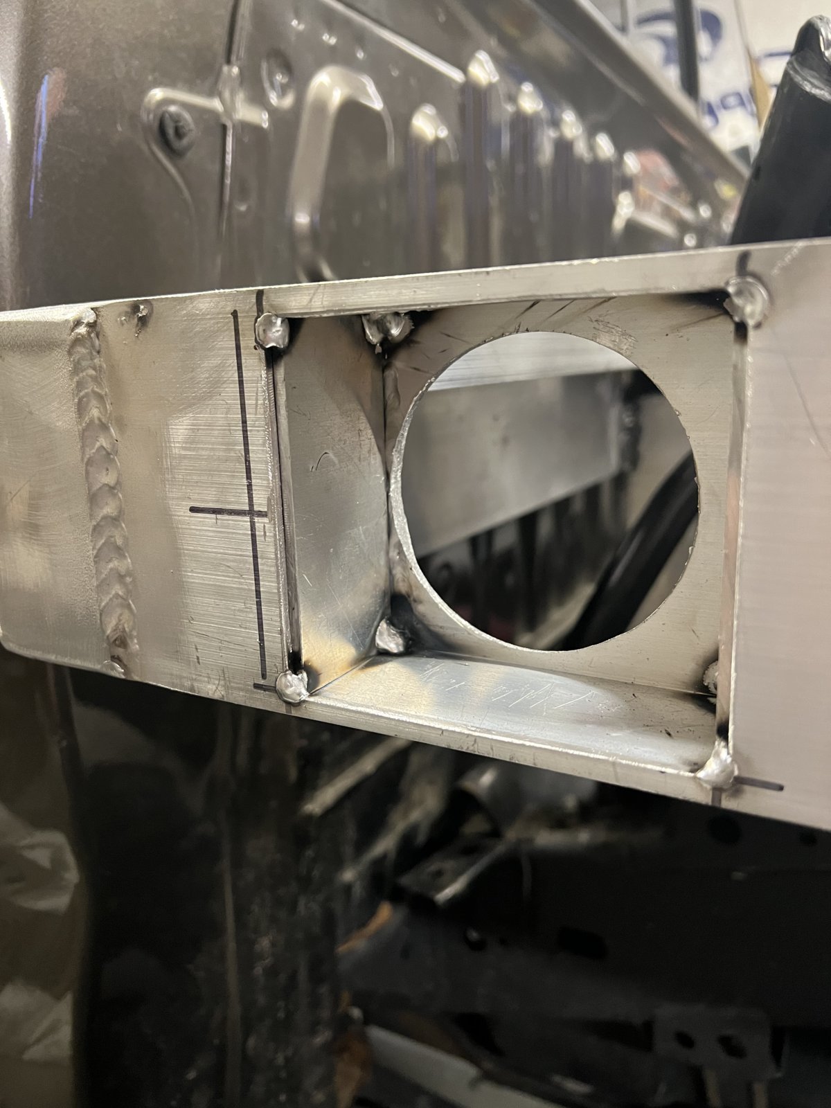

    Haven’t been on TW in a while but chipping at some progress..
    POOLGUY, Nimble9 and Drainbung like this.

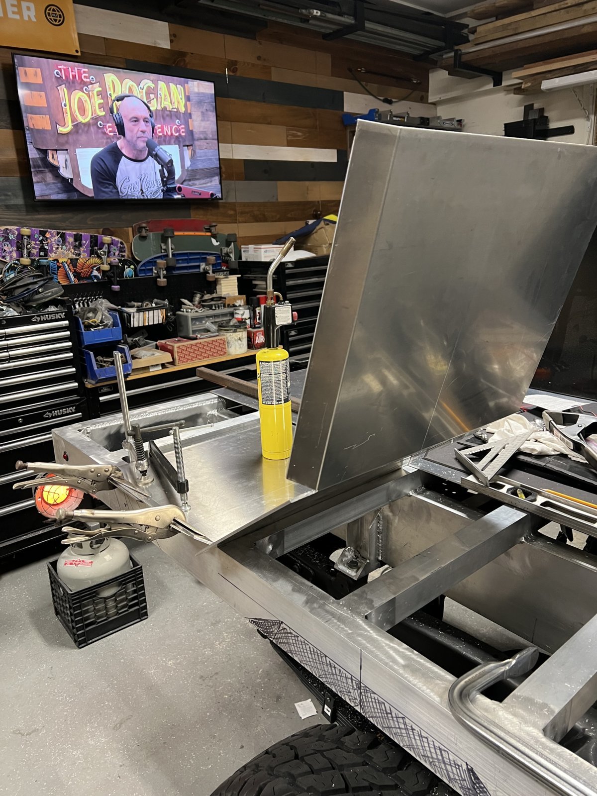

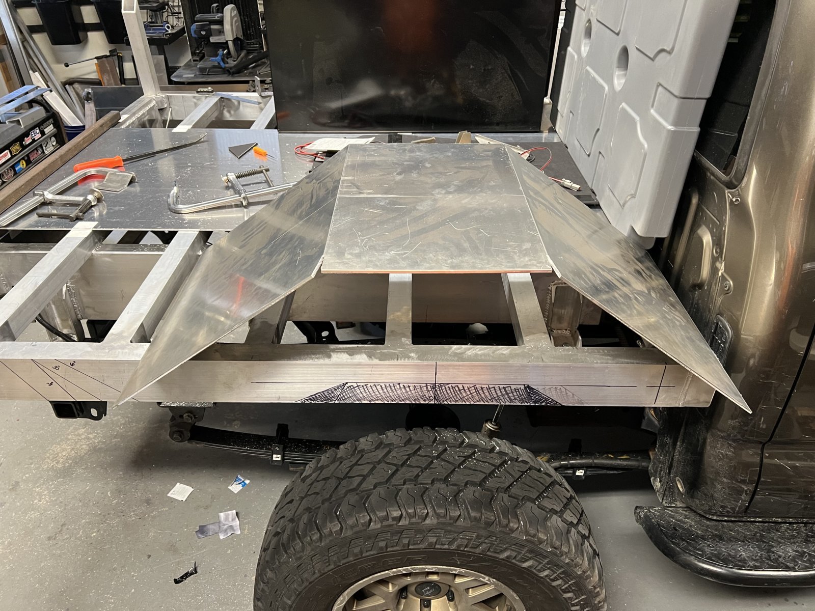

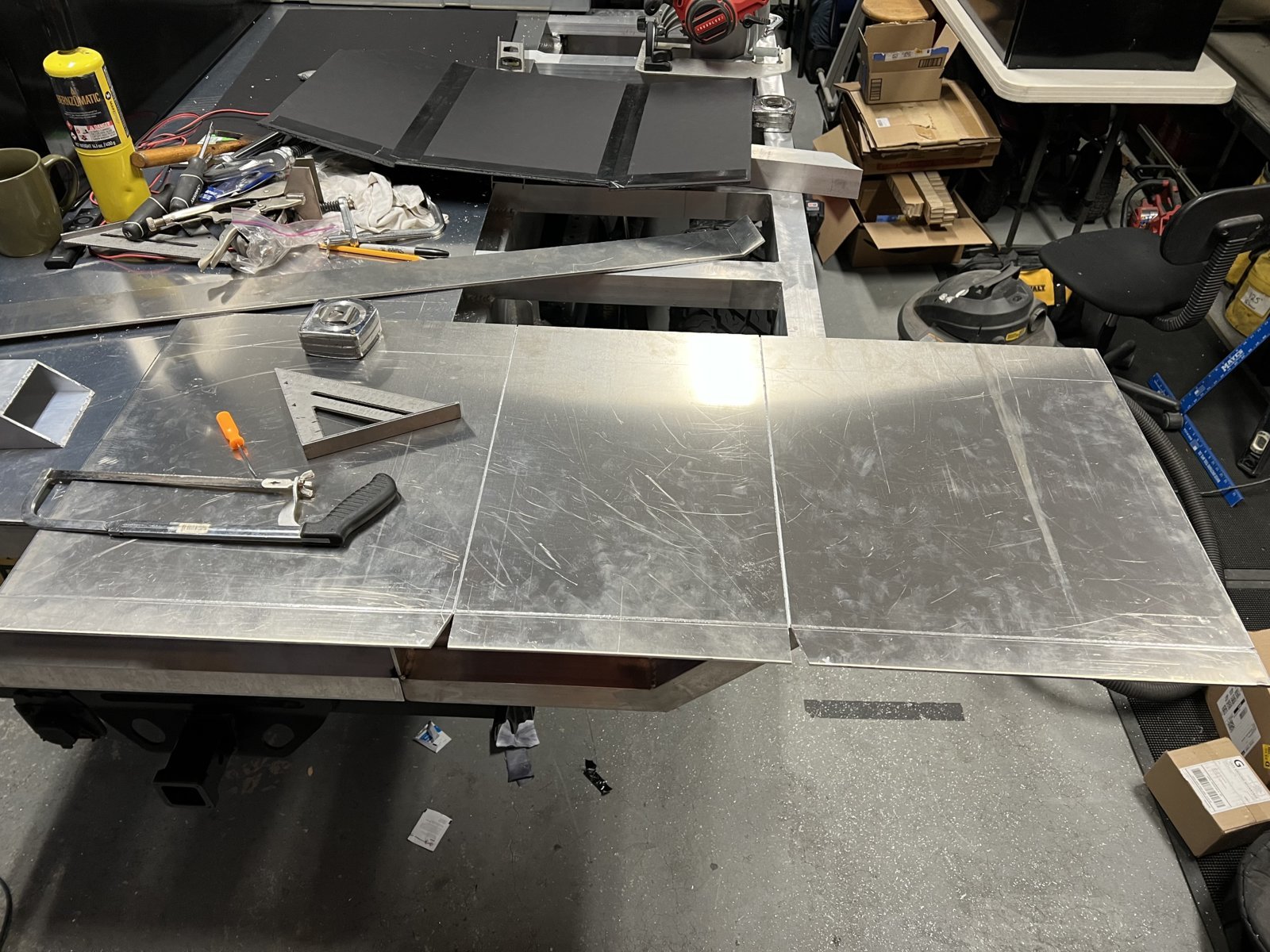

    Trundle drawer progress
