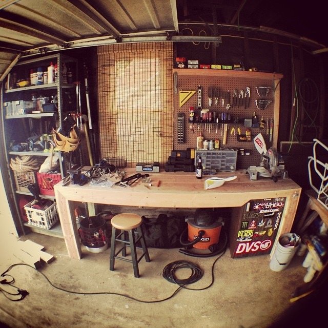

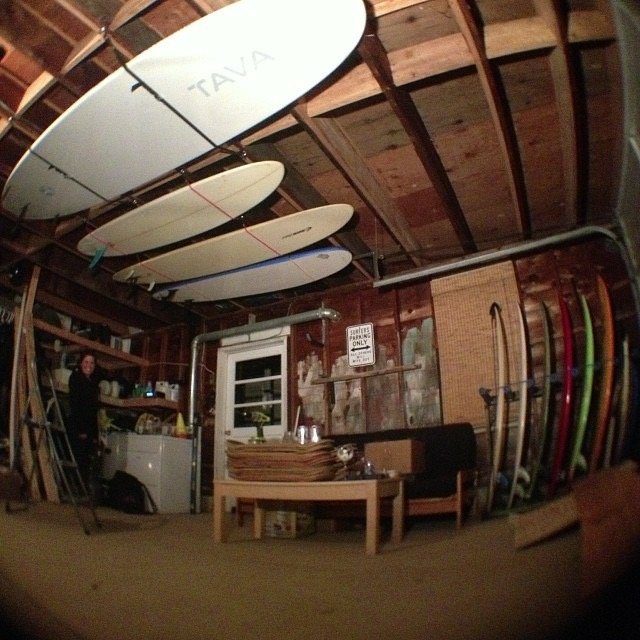

    My house I just moved from had a 2 car garage that was awesome as a workshop man cave. I made a work bench, built shelves, had a futon and a coffee table and stored all you need to store.. was glorious. This is when we first moved in

    dude!! do you build boards and decks? that is an awesome garage

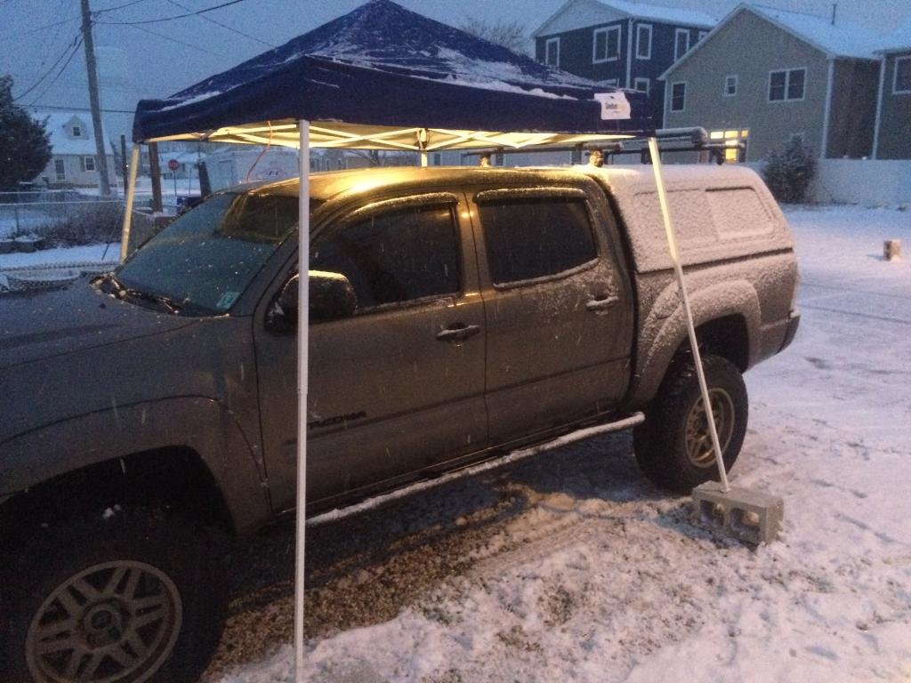

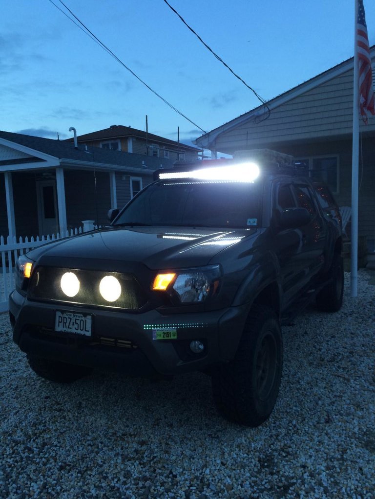

    Haha it gets pretty cold. Today wasn't so bad tho, got the light bar finally wired. Last thing to do is make the fairing. I ordered 2'x4' black plexi glass to make it. I've been taking pics along the way of installing the rack but don't want to post anything till it's completely done. Heres a teaser :D

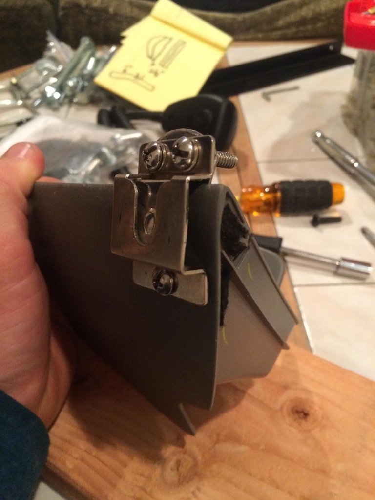

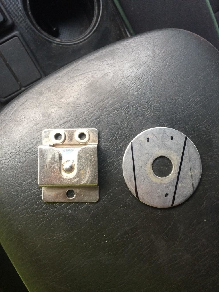

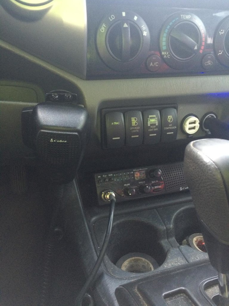

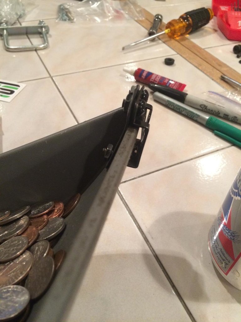

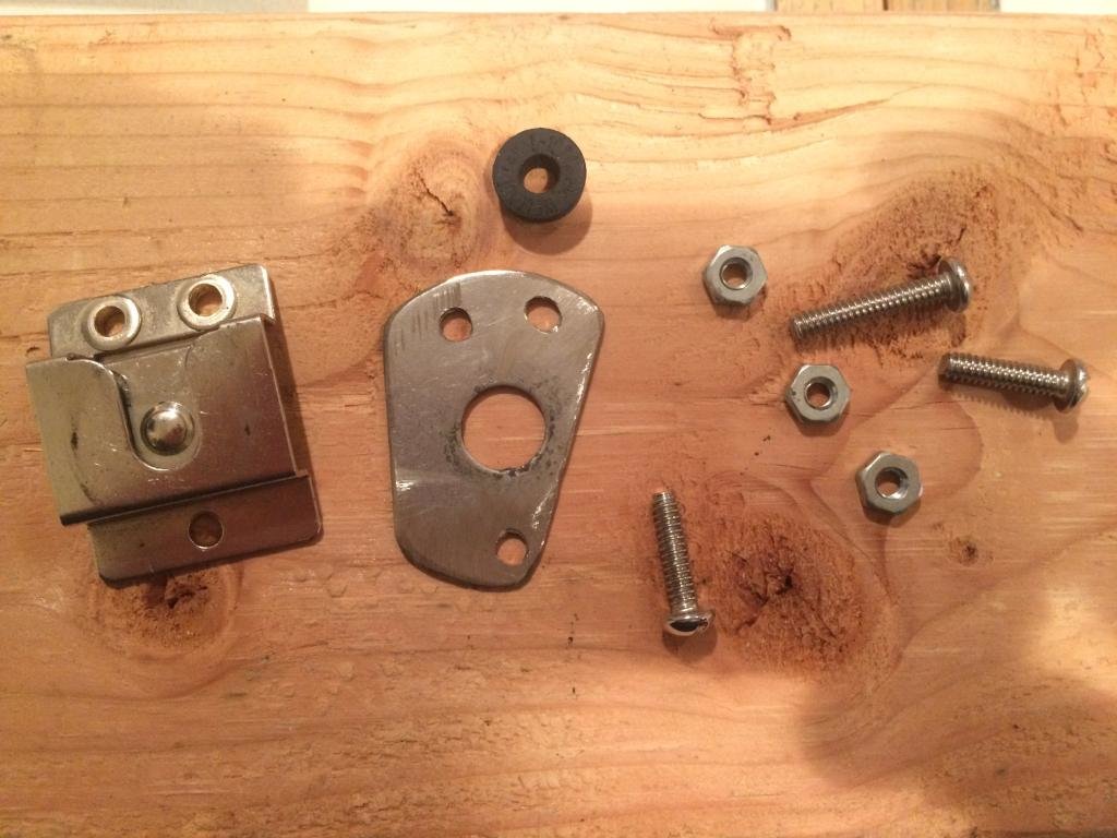

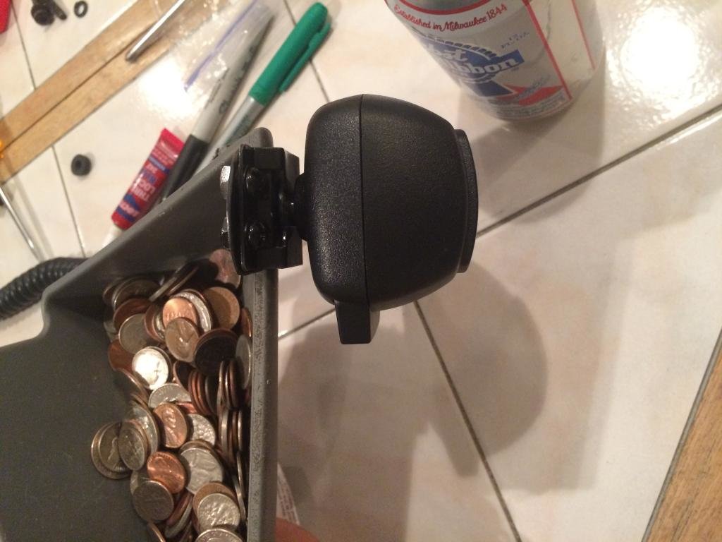

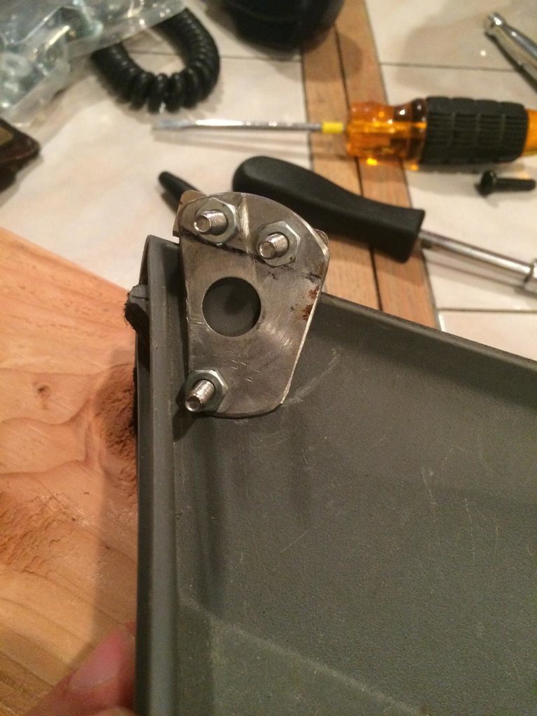

    Wanted to post a fun easy DIY "coin tray cb mic bracket". Ever since I installed my cb a while back I kept the cb mic in the cup holder because I didnt know where I wanted to mount it. Recently after a trip wheeling it occurred to me the perfect spot to mount the mic would be in the right corner of the coin tray. I held the mic in that spot for the following few days and decieded that I wanted to make it a permenant spot and just needed to figure out how to do so. After a couple thoughts, I picked up a washer and it all fell into place. Took some pics of the install thinking others might want to do the same.

    Awesome work as always Jay! :thumbsup:

    Mic mount looks good, I've been searching for a place to put mine for 3 years now lol, I just leave it dangle in the shifter console and it sucks but I'm too lazy to come up with a creative mod like yours :)
