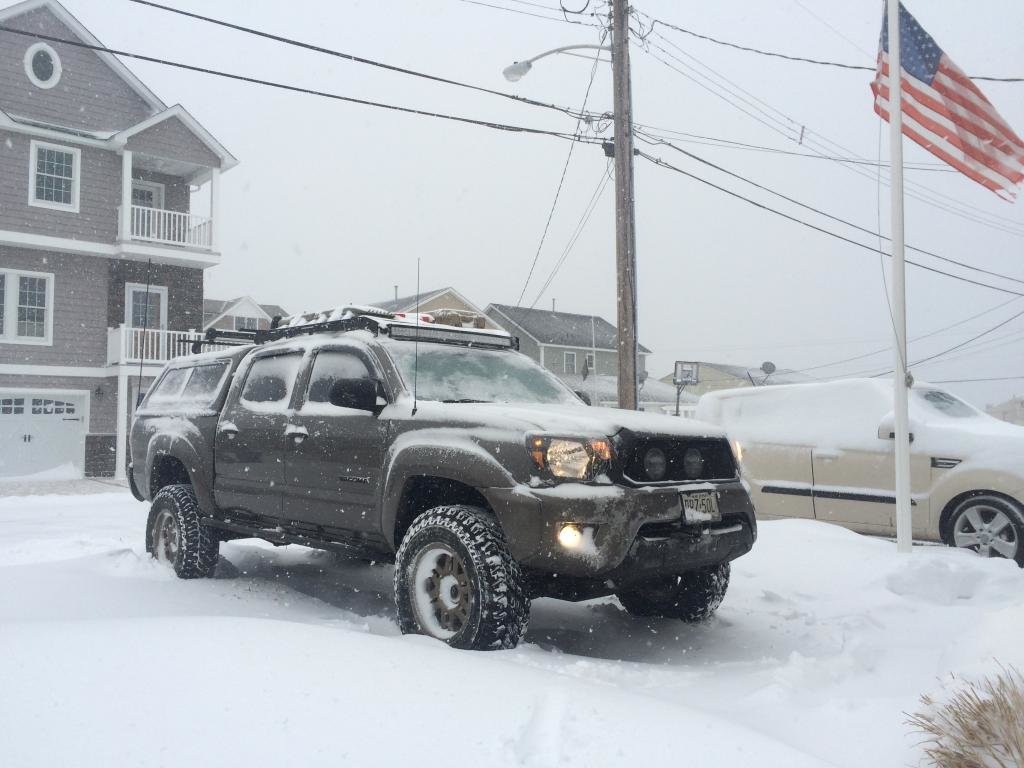

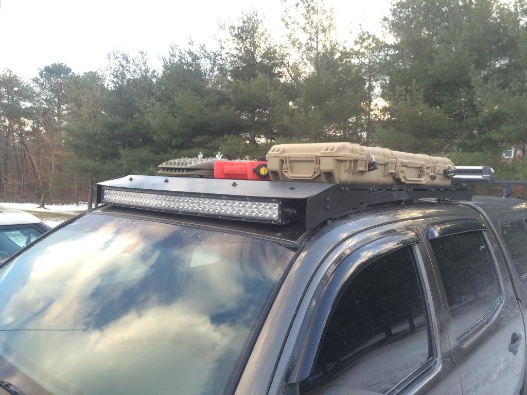

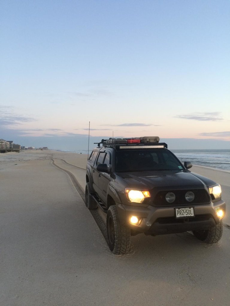

    Finally able to make the fairing today. As of now the rack build is done, although I was messing around with some ideas to close off the space on either side of the light bar.
    87260A57-B40F-4AE6-B233-422BB847731B_zps_d68f4b8e9373e6a0c353acd9d18f9b035aa15ff0.jpg
    I will post up all the pics soon.

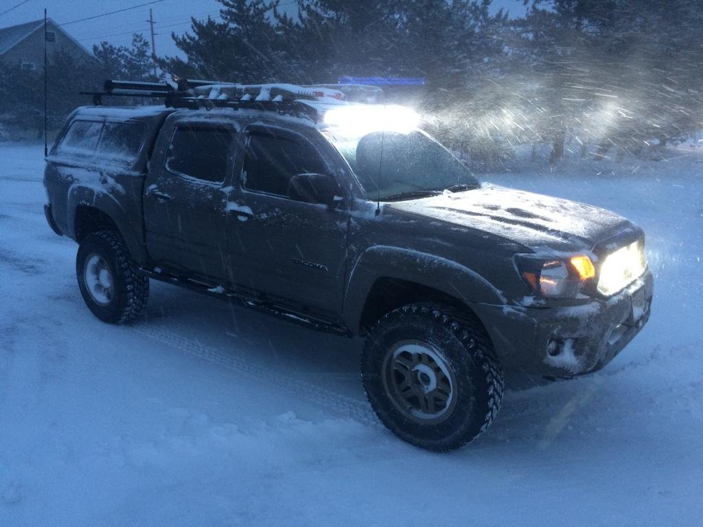

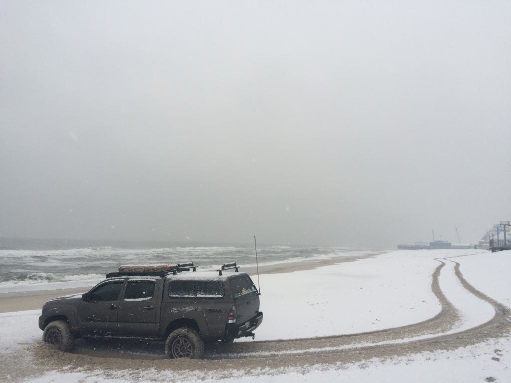

    Some of my favorites

    I started off with intensions of keeping the weather stripping. I marked and drilled holes for the bolts but when it came time to install (in the cold and dark) I was having trouble finding the tapped holes with the bolt. I drilled bolt size holes in the weather stripping, not realizing the spacer would sit on top and add bout 3/4" to the height off the roof. So in frustration and wanting the slim line install I ripped them off and bolted it down :anonymous: I did fill the tapped holes and spacers with RTV before bolting down for a weather tight seal. With lots of snow and rain the past weeks I've had zero leaks in the cab. If I was to do it again I might try to cut a hole the size of the spacers in the weather strips (bolt size hole was a little tough cuz of the rubber rib going down the center of the weather stripping) but I'm overall happy with the install and won't unbolt it to fuss with the weather strips.

    Honestly the best thing to do is to cut the weatherstripping into sections to fit between the standoffs. Much easier than cutting holes and gives the same look. Just add a little rtf underneath to help hold it down.

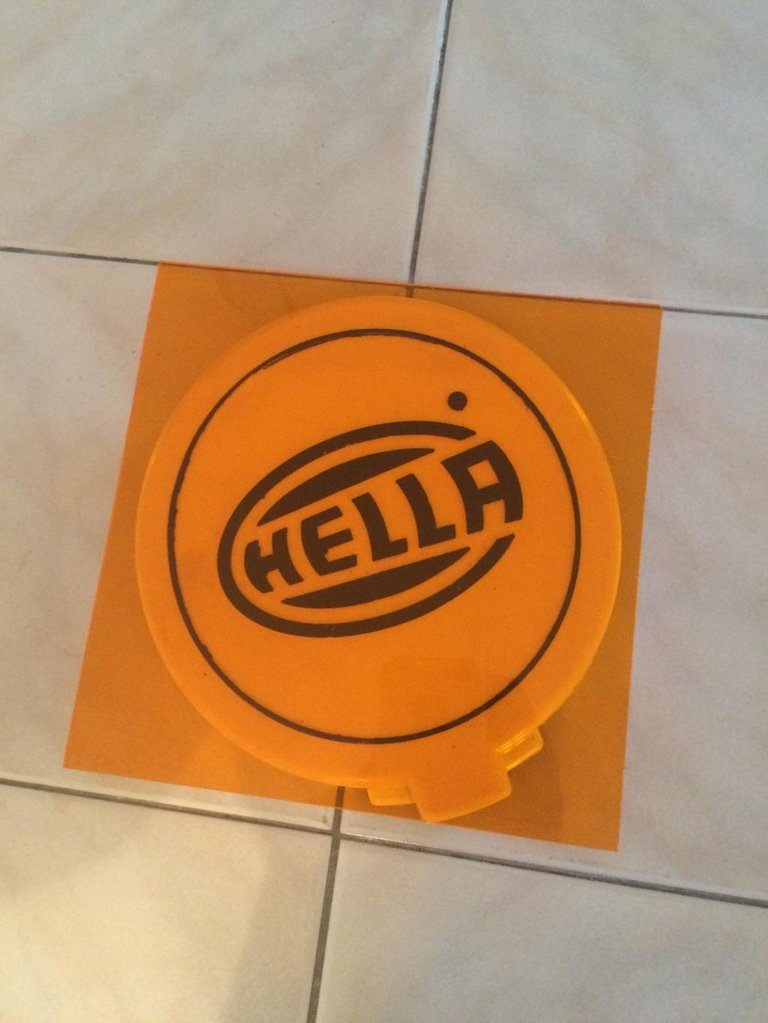

    Just got my next mod material in the mail :woot:
    84A23815-94AB-4495-A3B7-2ABEDF0A4C02_zps_bd04d949233824b55771ac84976186086e36f037.jpg
    The plan is to turn the rock shield into an amber lense for my Hella grill lights

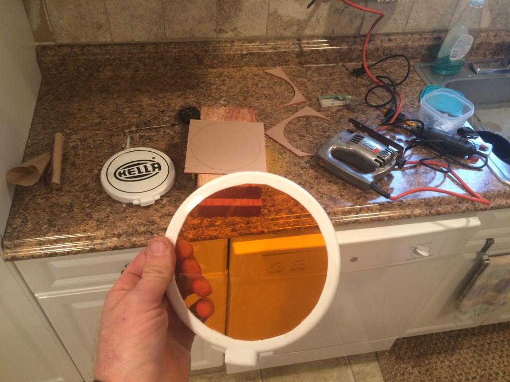

    Took my rock shields and turned them into Amber covers for my Hella grill lights
