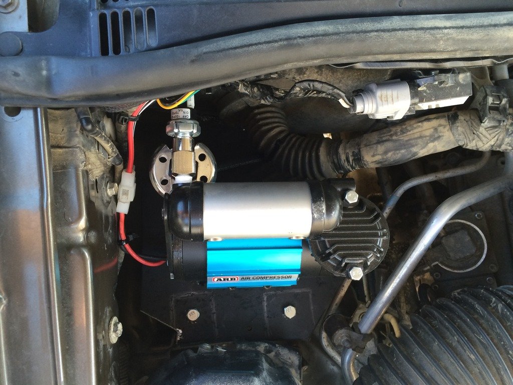

    Where did you install your compressor? I can't seem to find the location in your build, but I could be missing it. Good looking truck bud...

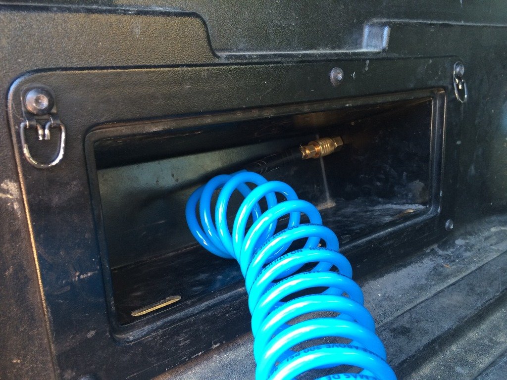

    As most I've seen I put it under the hood on the passenger side. But I've always wanted air supply out of the bed so I ran an air line to the driver side bed cubby and added a quick connect on the wall of the cubby.

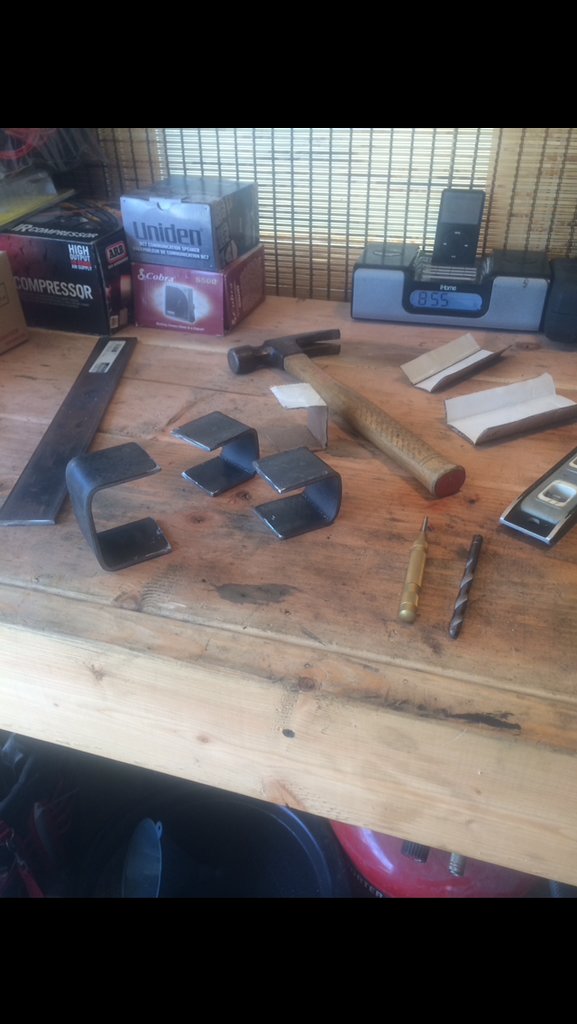

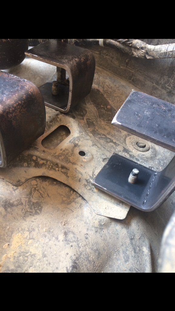

    To mount it I made a sort of mounting table using 3 threaded studs that were already in that mounting location. Two are the same height and the other is an inch lower. I just bent up some flat steel with hammer and table vise and made the heights at (2) 2" and (1) 3", and fashioned a small table top to be bolted to the legs. This should give you a flat close to level surface to work with.

    Thanks. Unfortunately that location is a no go for the sport models or at least a 2013 sport.
