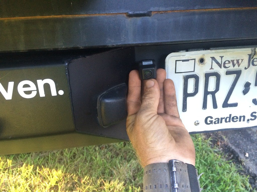

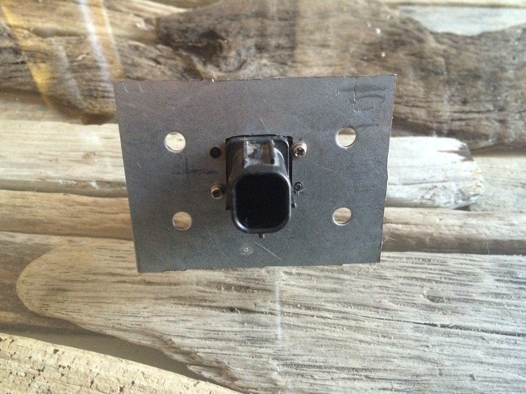

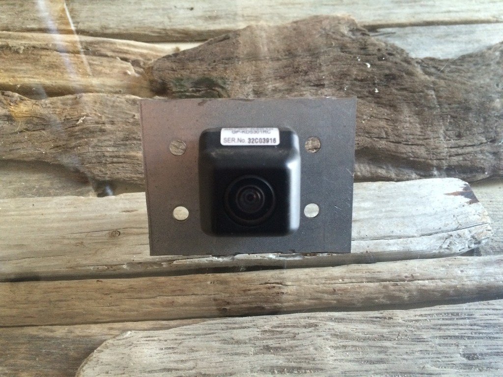

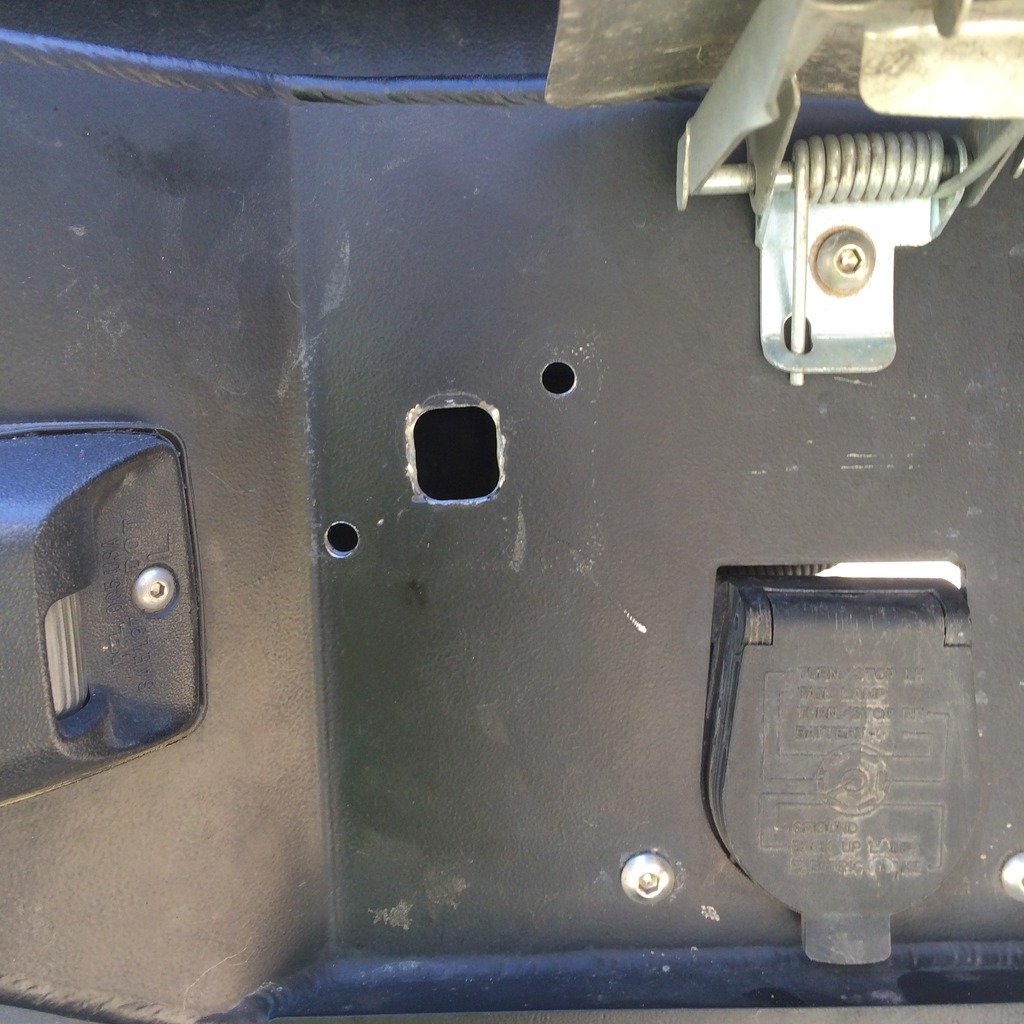

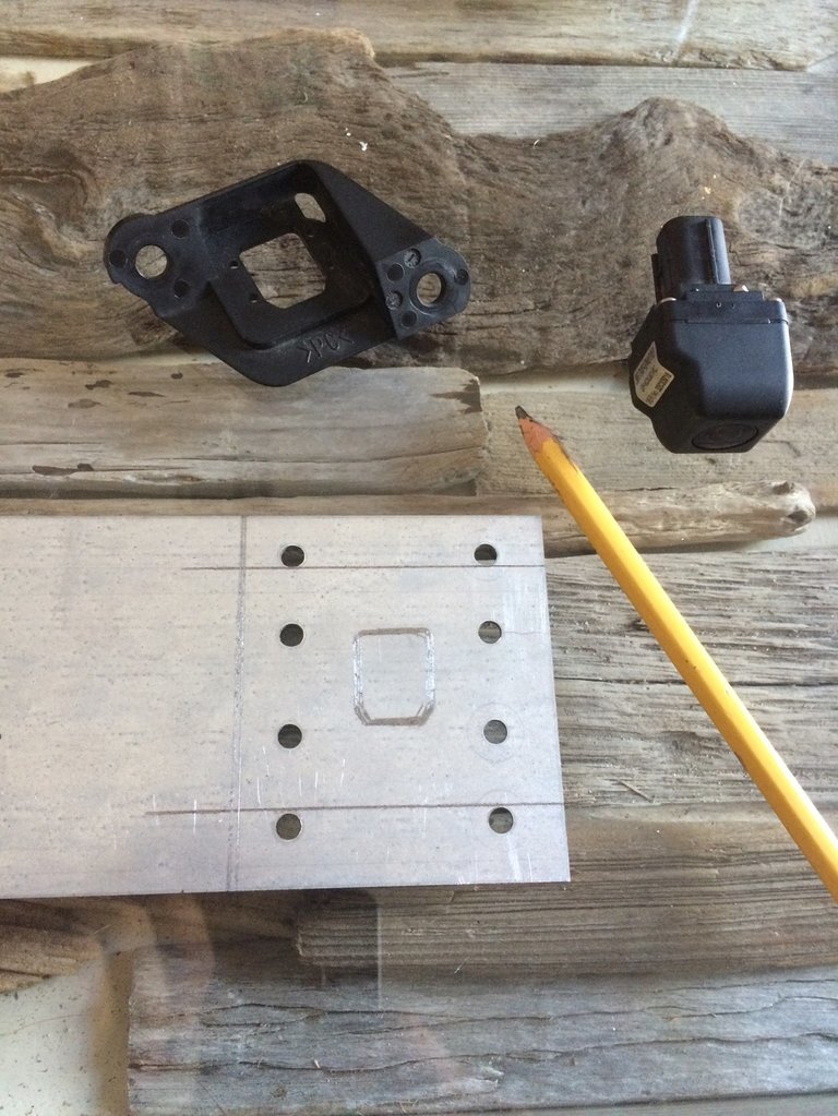

    Been thinking bout the rear view reverse camera relocate on and off for a while now. I had an idea and just started putting it into motion. Heres some pics
    DAA966E5-6FE4-4603-8430-F11B4E63E17C_zps_784f02d77b26cd9cb2205172de7aee765c6f6f06.jpg
    39E656F0-2415-471C-BFC6-E504B243A1E3_zps_162cc18b5128046a8bac5695e851f221010c4493.jpg
    8586F672-CAE0-40BF-8720-1CE407893196_zps_e2c00236c280fee43f6e1db3a238b67f02316757.jpg
    AA98B483-0C29-4ECF-945B-D293BBCA2F4C_zps_624260edb28c111e8bc8bf393f98873864b2c06b.jpg
    20A1F12D-9A60-425D-BBF3-3CF2E23B5D7C_zps_eeb03829fd72aaadf5c5a2e308423fbe29719d9c.jpg
    After fitting the camera in, I measured and trimmed more of the plate to clean it up and it's now drying from paint. Next I need to drill a 3/4" hole to fit the backside of the camera in and 4 more smaller hole to screw it to the bumper. The harness doesn't need fussing, it reaches with actionable slack to plug back in.

    Are you attaching it to the bottom of the tire gate? Or is it attached to the bumper itself. I wired mine up this past spring, wasn't a stock one but I put it at the bottom of my licence plate, and made it so I could switch on anytime in was anticipatin of an eventual swingout.

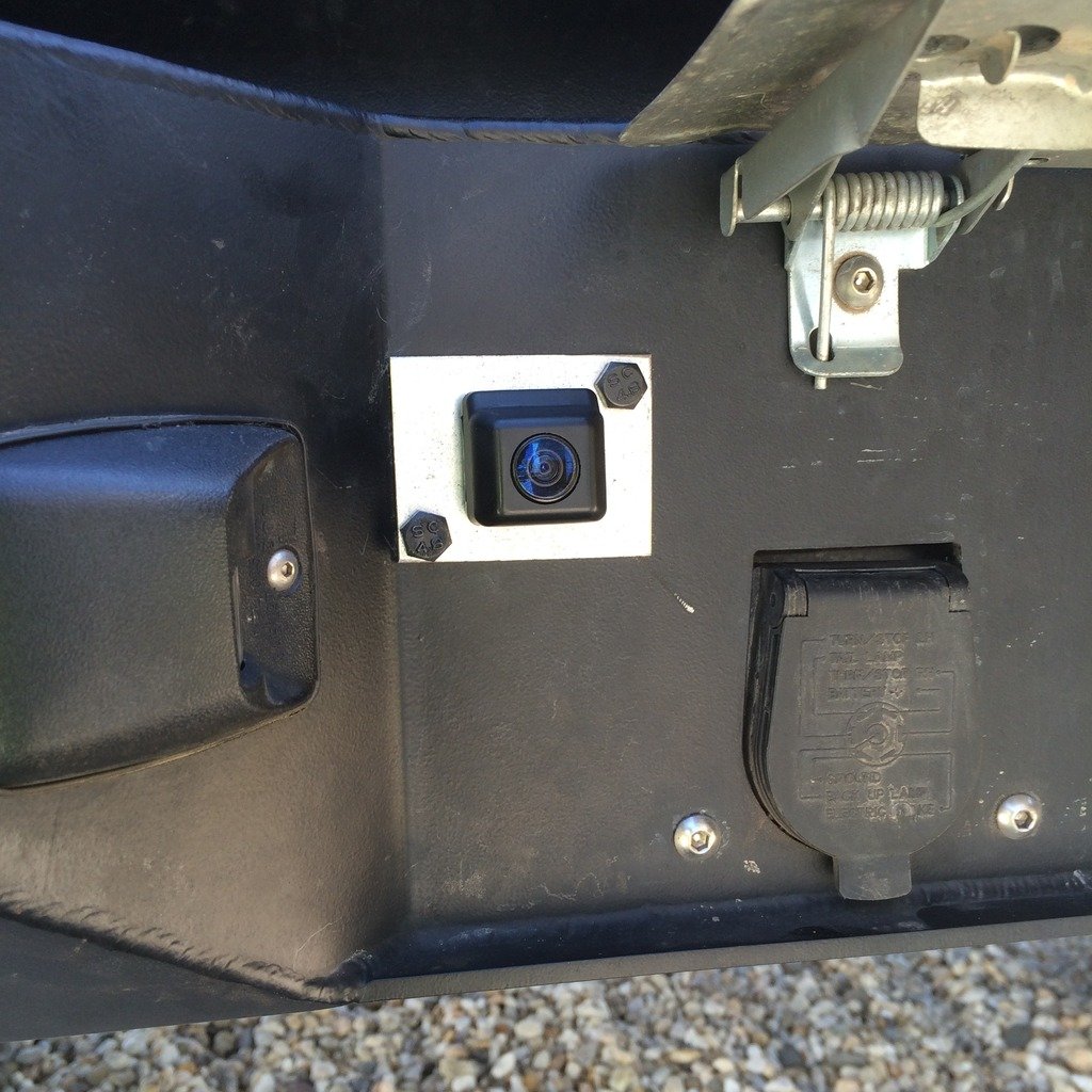

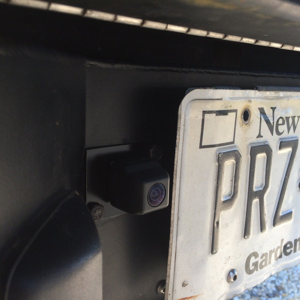

    Finished up my OE rear view back up camera relocate with my @Pelfreybilt bumper today. Made a new mounting bracket for the camera, drilled and dremmeled the bumper to allow the back of the camera to slide in, and the harness was plug and play in this location with some slack to zip tie out of the way.

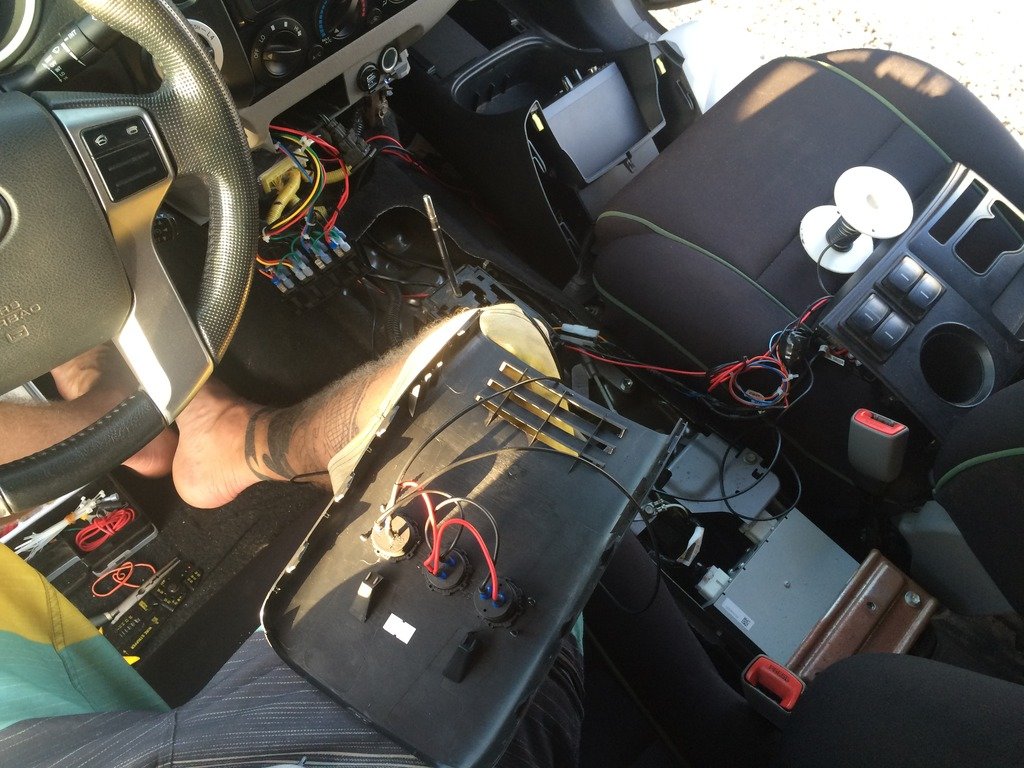

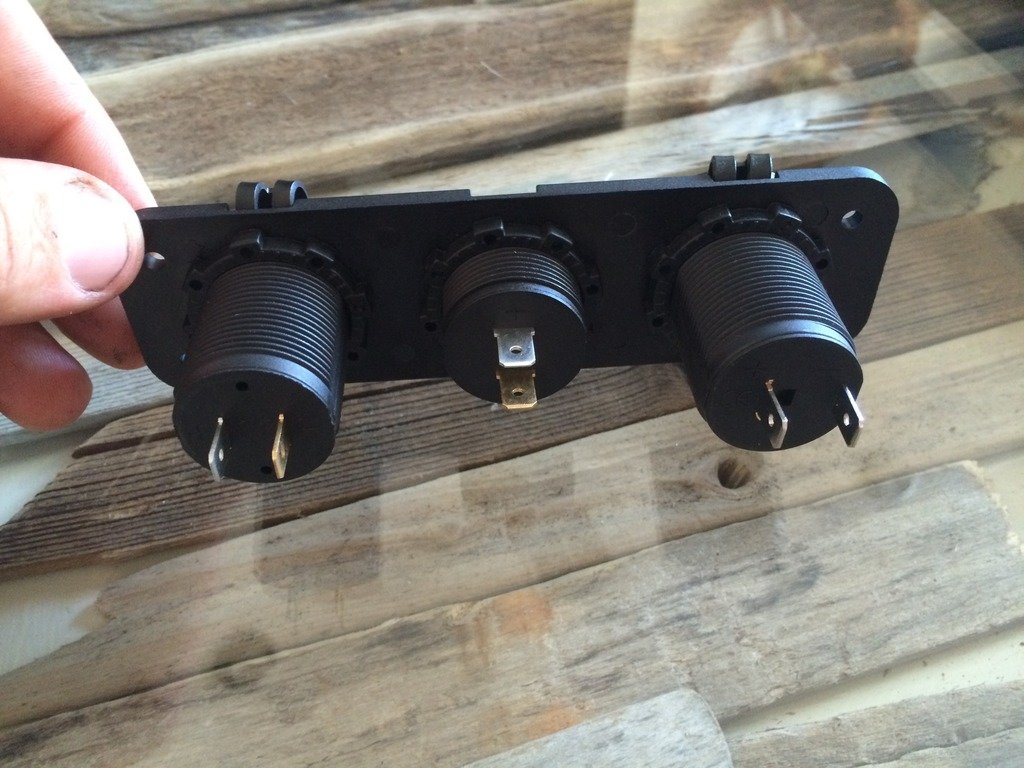

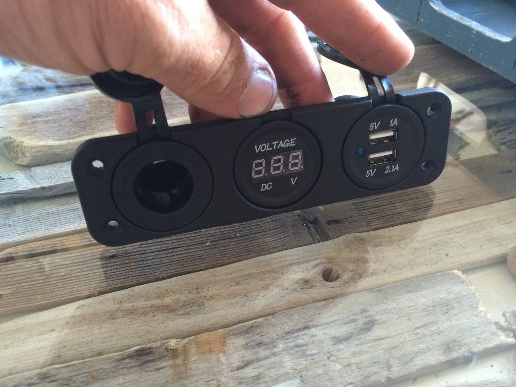

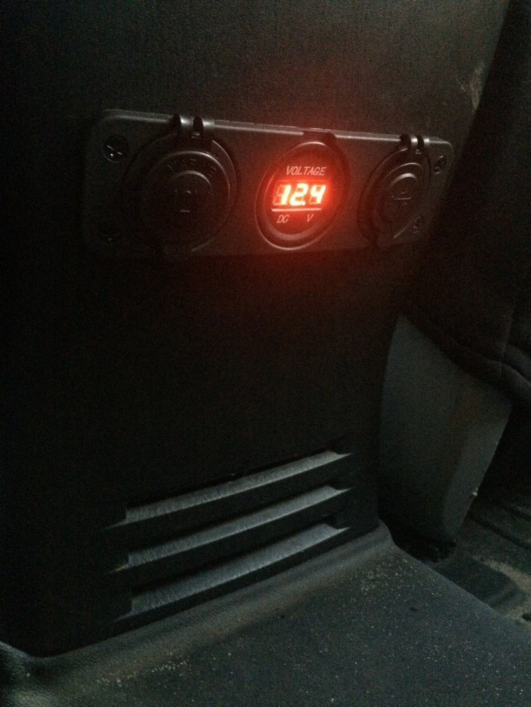

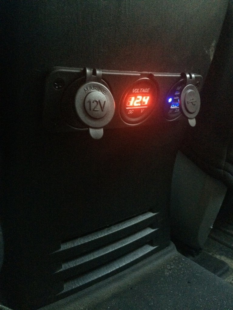

    A simple mod I wanted to do turned into one of my favorite things I've done to the truck. Simple, cheap, and multifunctional... So clean it seems it should come stock.
    First off here's the link - https://www.amazon.com/gp/aw/d/B00T7TTK6K/ref=yo_ii_img?ie=UTF8&psc=1
    I wanted to add some always live power outlets on the backside of my center console as I've seen on @JLink 's build. I got the how to information from him and went on Amazon to get a power outlet or two. I came across the outlet set including the volt meter and thought it was a good option. Now that it's installed turned out to be a great option! There's now additional charging ports for any device all the time, future outlet for fridge/freezer, and all along the way I can monitor how the truck battery is doing. Here's the install photo dump
