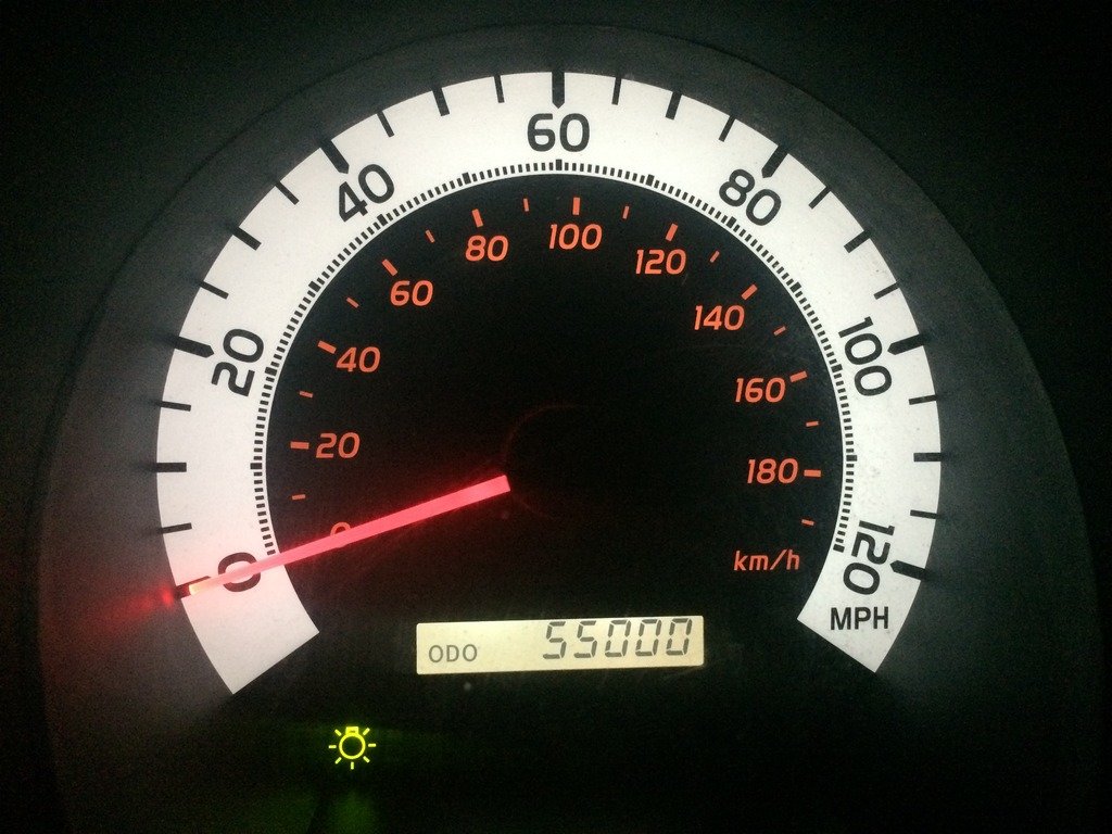

    So many adventure miles

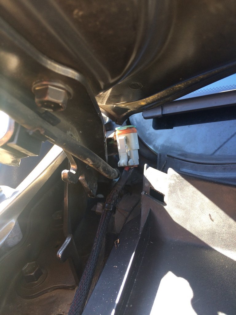

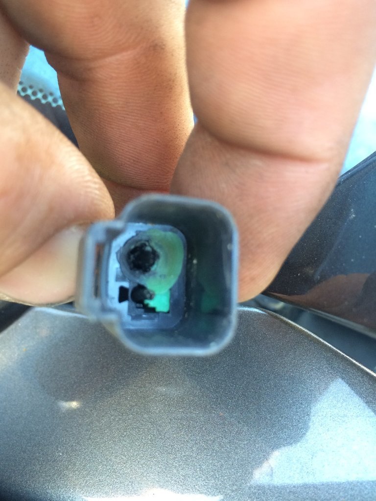

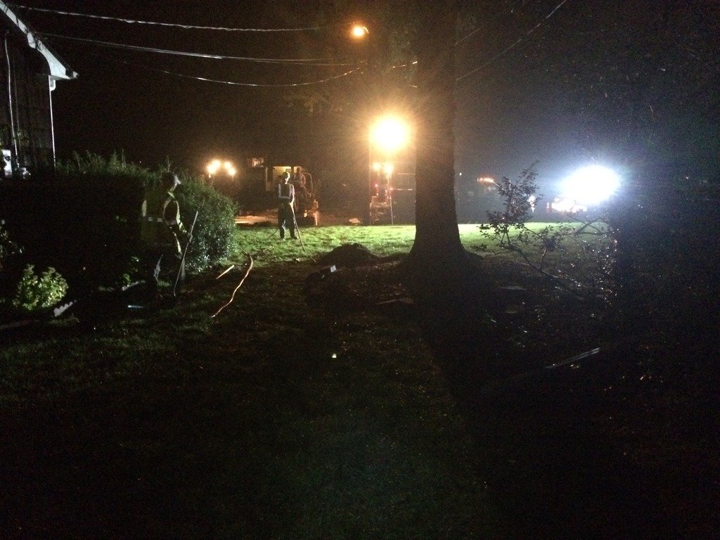

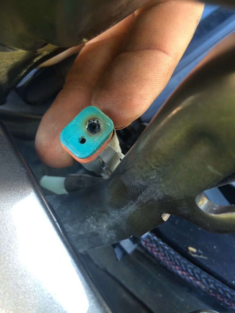

    Speaking of electrical, had an emergency call out at work Friday night and for the first few hours I was using my light bar to light up the yard better. Kept checking on the battery but around 9.6 volts my battery wouldn't start the truck. I had already shut the light bar off before trying to start the truck, jumped the battery then went to turn the light bar back on and it wouldn't turn on.. Tried to trouble shoot a few things, but needed to put it off and keep working. I just now had a chance to look threw the harness and found a melted quick connect. It's the connection from the light bar wire to the harness. I'm not sure why it failed there rather than the fuse.. I have a 20amp fuse in the blue sea block now, maybe it to much :notsure: That was the first time I ran the light bar for a long period of time.

    What haven’t I changed?
    I'm still afraid to run my light bar for an extended period of time, even with the upgraded wiring harness. For me the issue is two-fold. First, those quick connectors are probably rated for 25A max and I think your light bar pulls around 33A. Second, after a few minutes of running my light bar I noticed that the cable coming out of the light bar was a little warm, so I just don't trust any of the wiring past the 10awg wires. Maybe one of these days when I get the time and motivation I'll pull everything apart and run 10awg from the light bar straight to the relay/battery and skip the connectors. Unfortunately, this is just a result of using the new 5W LEDs instead of the older 3W ones. More light output, but also more power draw and they didn't go back and examine the side effects this would have on the wiring.
